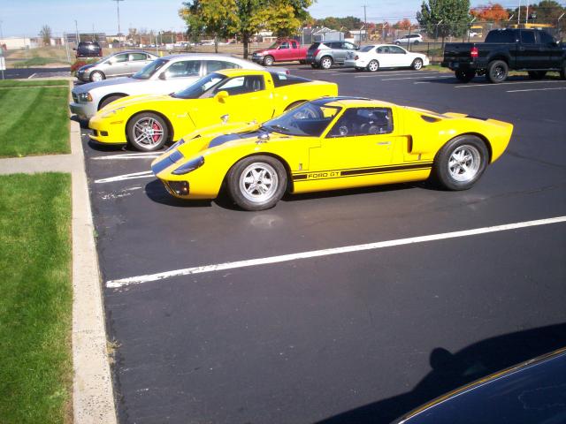

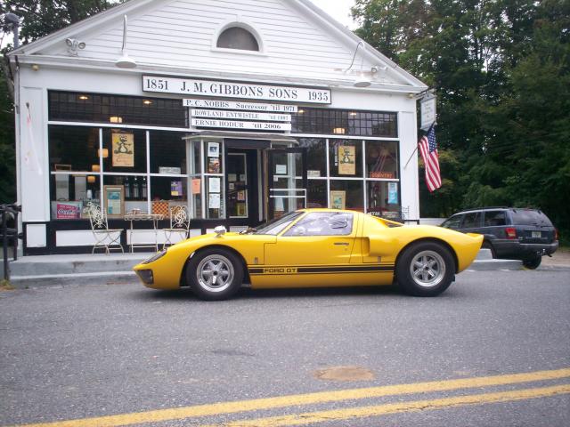

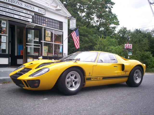

I was blasting around the western Massachusetts hills today and had to stop for something cold & refreshing, when I got this idea :idea: for a picture.
I think it look good so I thought I'd share it...

Nice photo, I think we need to get a camera truck and film 875 going through the twisties of New England. That would be AWESOME !!!!!!!!!

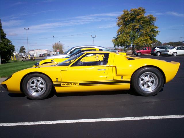

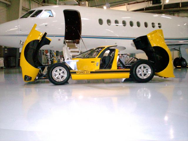

Took a few more pictures today of a couple of "Gentlemans Toys"

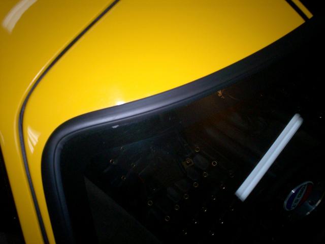

Windshield molding... Hmmm... Available to non-Tornado owners? Price?

You can easily purchase a seal from your local auto glass installer.

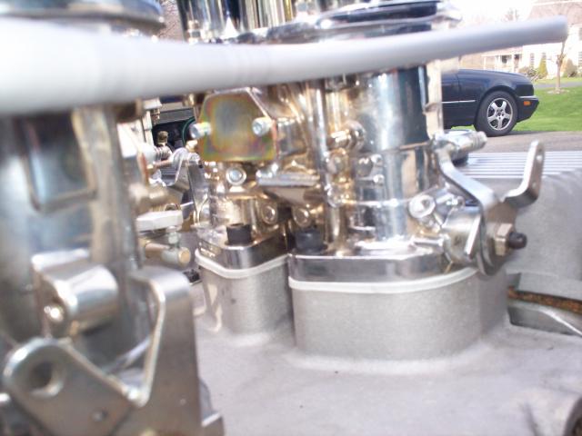

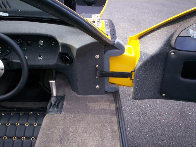

Well its been a while and today it was nice outside, so I finally decided to get around to the fwd. door close-outs.
This seals out airflow around the door quite well
Left side is identical.
Also pictured are freshly installed IDF heat insulator gaskets. In addition to installing these I lowered the floats 1mm to 11mm.
Took the car out and shut it off without first turning off the pumps, no percolation.
OAT is 60 deg. F.
We'll see how this works out come July.

Scott - How about a run-down on how you did the inner doors and panels...
It looks like the doors were almost carpeted or lined with some sort of gray material... I like it!! ((but then - I like your whole build! :) ))
Hi Randy,
The doors, dash and spider are painted with black/white speckled trunk paint.
The GRP inner door pockets and trim panels as well as the door end closure panels and check straps are included in our "Complete" kits.

Very nice Scott, your car is one of my fav's. I can't believe how light the car is. I love the pic of your car next to the plane.
Where did you get those IDF heat insulator gaskets from? Also did you polish those carbs or did you buy them already polished?
