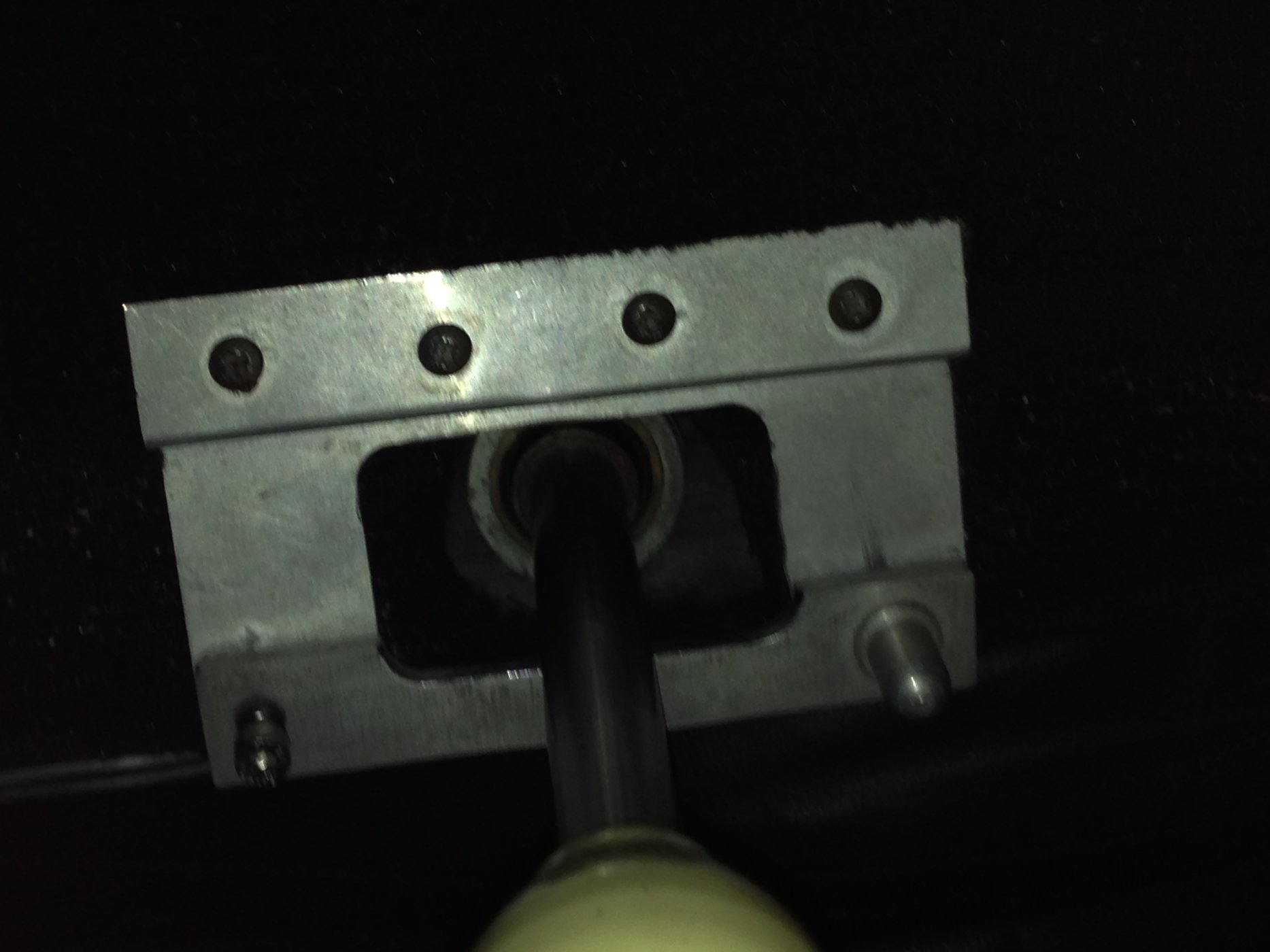

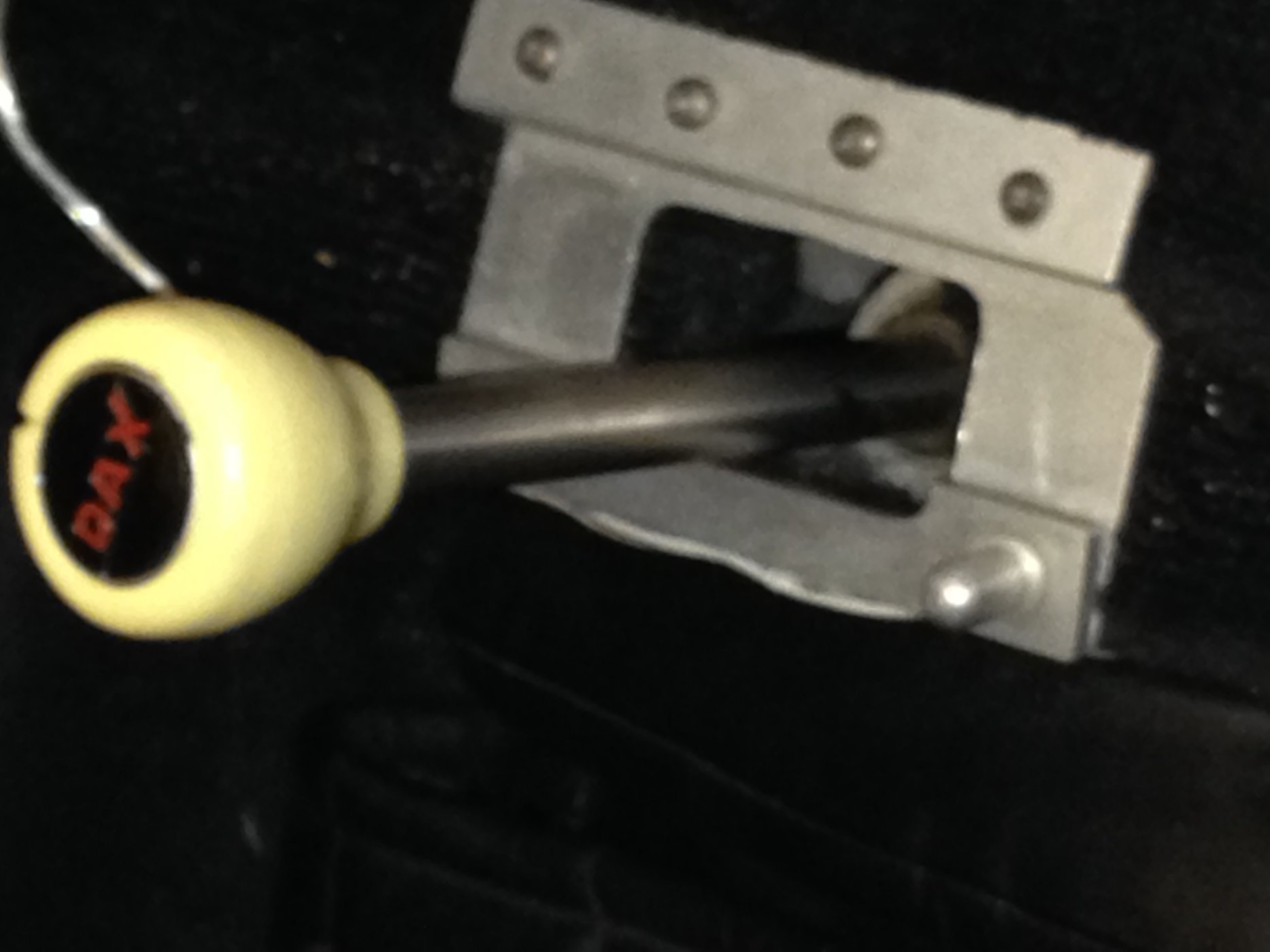

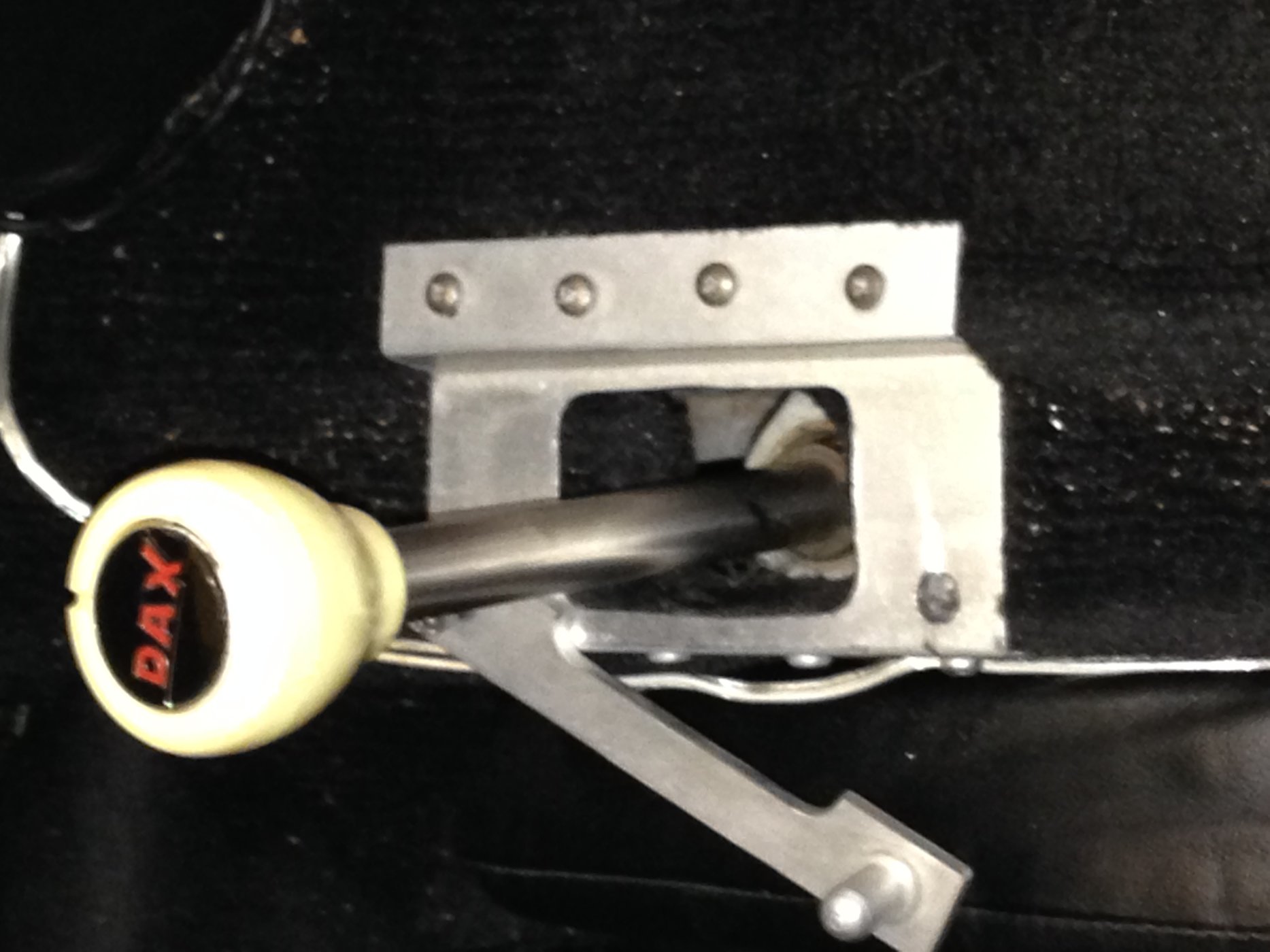

Ian Anderson
Brian Magee made one on my car
Simple aluminium bent to follow sill shape
Hole cut in middle
And a lift over spring held gate
I’ll take pics

thanks Ian. That gives me some idea for something I might be able to knock up. Or have a chat to Brian.

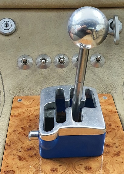

Eddy McClements
This is mine - it's a UN-1, so same shift pattern as yours. I kept the overall look of the original GT40 lockout with a lift-up mechanism, though of course reverse is left-and-back on the UN1 instead of left-and-forwards like on the ZF-equipped cars. Still need to polish out the *machining marks, but I was just testing for fit, function and alignment.

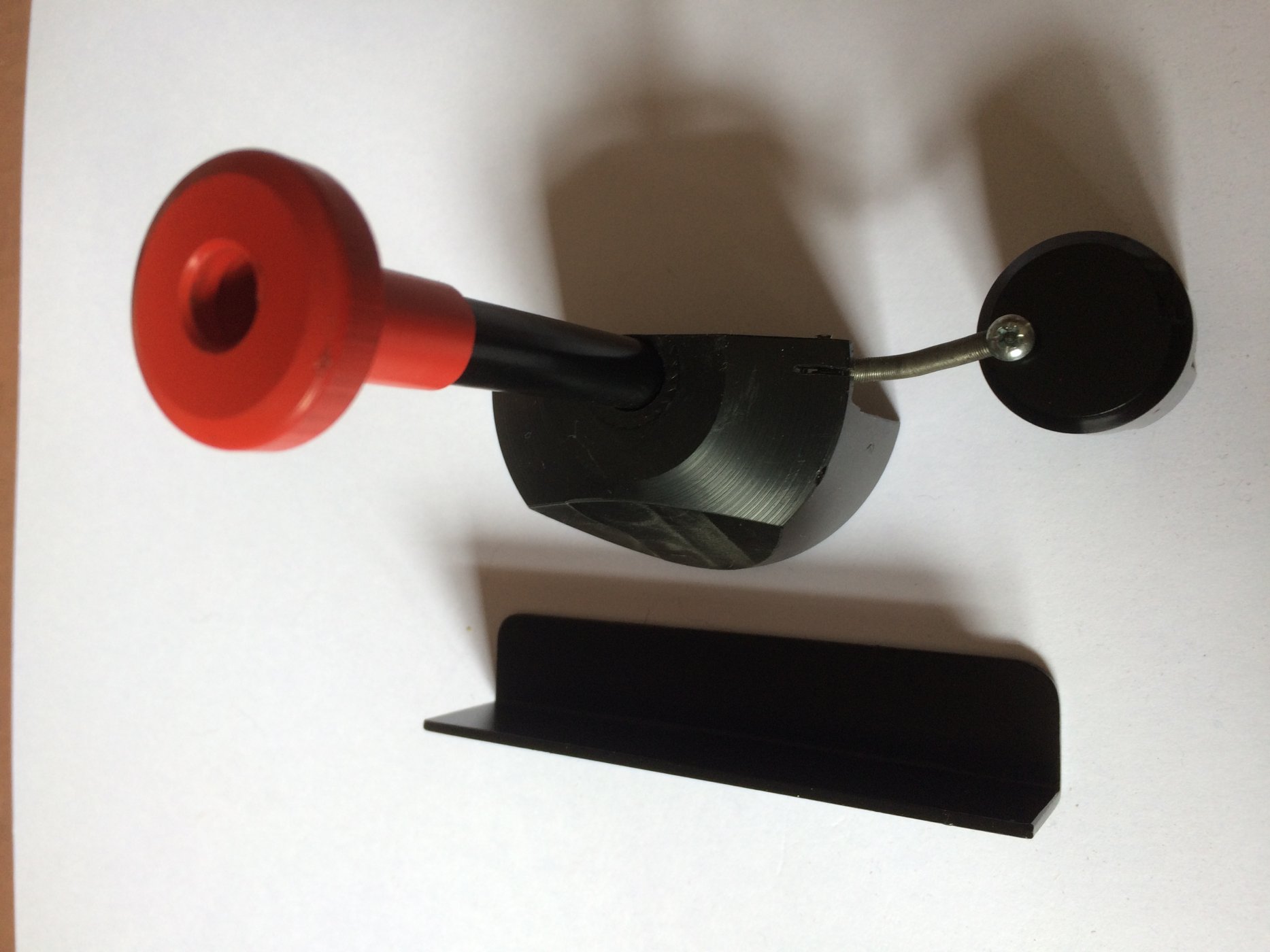

I have the same gearbox in my lotus europa and made this, inside on the left is a black nylon spring loaded block that stops the stick to go sideways, the little pin on the side can be pushed forward 1/2" the free the stick, when I go back to first the spring pushes the nylon block back into position. btw I can use the stick and the pin with 1 hand
