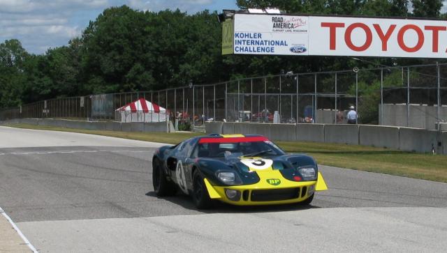

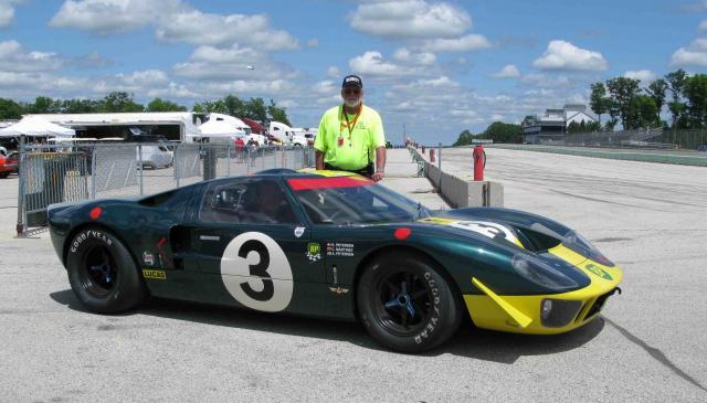

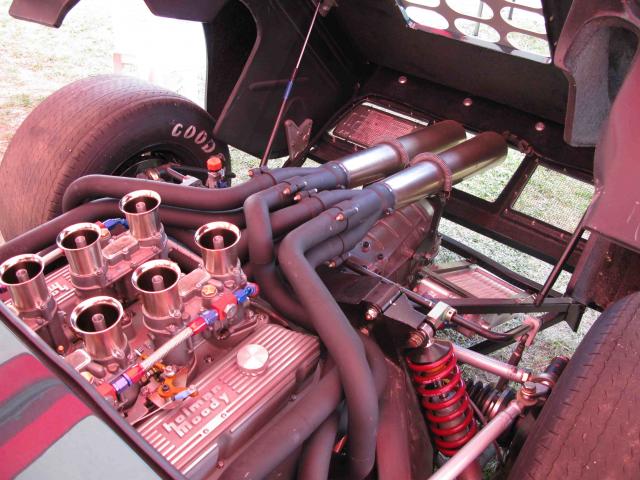

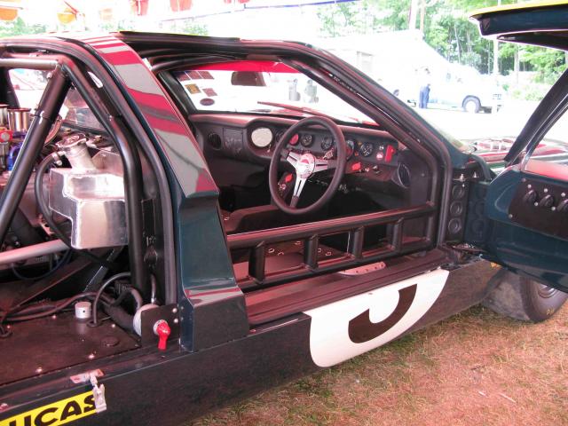

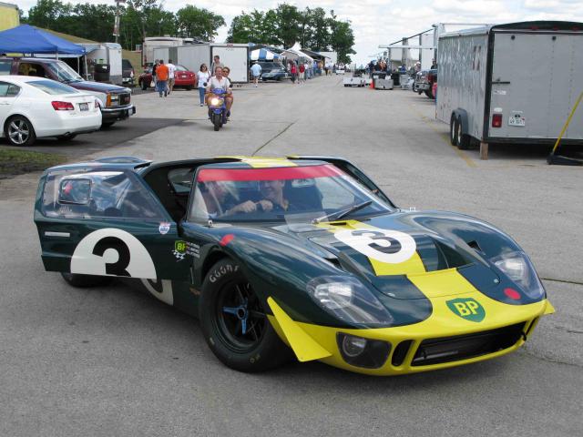

Oldtimer:
Mark does a good job of describing the virtues of the standard Superformance GT40. But if you want original, you need to check out the not-so-well-known Superformance GT40/R.
The GT40/R is a near-exact copy of the racing GT40s, and is in fact intended for racing (it is approved by HSR and SVRA for historic racing and is the official promotional car for HSR). Unlike the standard SPF GT40, the GT40/R has authentic right-hand drive (left-hand drive optional) and right-hand sill rod gear shift w/ period correct hardware; no a/c; Gulf-car style round driving/fog/turn signal P/1075-type lamps (exclusive ‘R’ feature); built-in six-point rollcage; Gurney bubble; FIA-approved emergency power cut-off switches (interior & exterior); Shelby registry as a GT40 and Safir GT40 competition registry; exclusive race-model continuation VIN number: i.e., GT40P/2xxxR; even a race-grade wiper motor (works at speeds over 150mph). It also has a period correct and functional aerodynamics package, including front canard wings, hood wind diffusers, and a fully-adjustable rear spoiler. You can buy a roller, ready for your own engine and transmission, for about $79,500.
As an alternative, you can buy a ready-to-race, Olthoff Racing prepared GT40/R, for about $119,000. For this price you get a ZF 5-speed transmission by Quaife and a 302ci race engine built by Holman Moody, builders of original Le Mans GT40 racing cars and engines. This package also includes twin fuel cells (FIA FT3 Certified); fire suppression system (FE36 – FIA approved); six-point competition seatbelts (FIA approved); FIA tow eyes (front & rear); megaphone racing exhausts; authentic wood shift knob w/ GT40 emblem; quick-release race steering wheel (D-shape), black suede & GT40 emblem; race-grade brake pads & fluids; and race-grade sway bars.
The first of the GT40/Rs arrived only last month in time to be shown at the Road America GT40 Reunion (some photos below, including one with GT40 legend Brian Redman checking out the GT40/R). And later this month, Dennis Olthoff will be competing the BP Racing GT40P/2090R at the Vintage Racecar Weekend at Watkins Glen.
While there are other reproduction GT40s that are a percentage or two more exact than the GT40/R, the price differential is a disproportionate 200-500% more. For example, a Holman Moody-built GT40 will set you back well over $500,000. So if you want something very original, with an original chassis number, and is licensed by Safir to be called a GT40 continuation model, take a look at the GT40/R.
Alan
