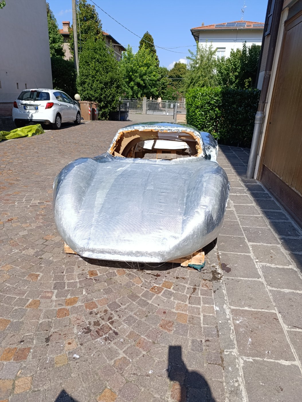

Hello everyone,
My dream is to build my own car....

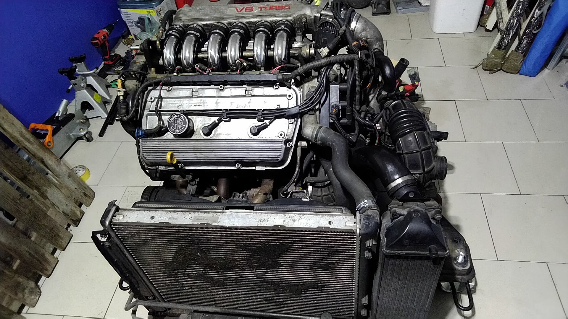

I would like to build a locost style chassis but designed by me, Alfa 2.0 v6 turbo engine and 33 Stradale body.

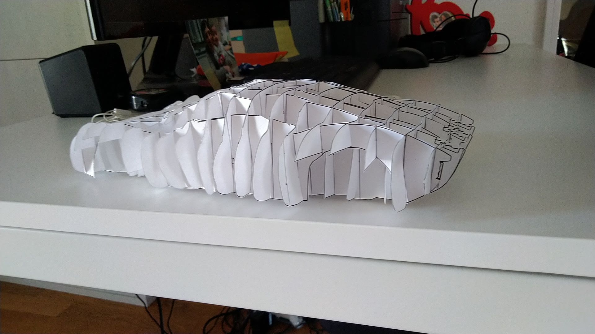

In 2020 I downloaded a cad of the body around the web, and created the sections.
In December 2022 I started the adventure....

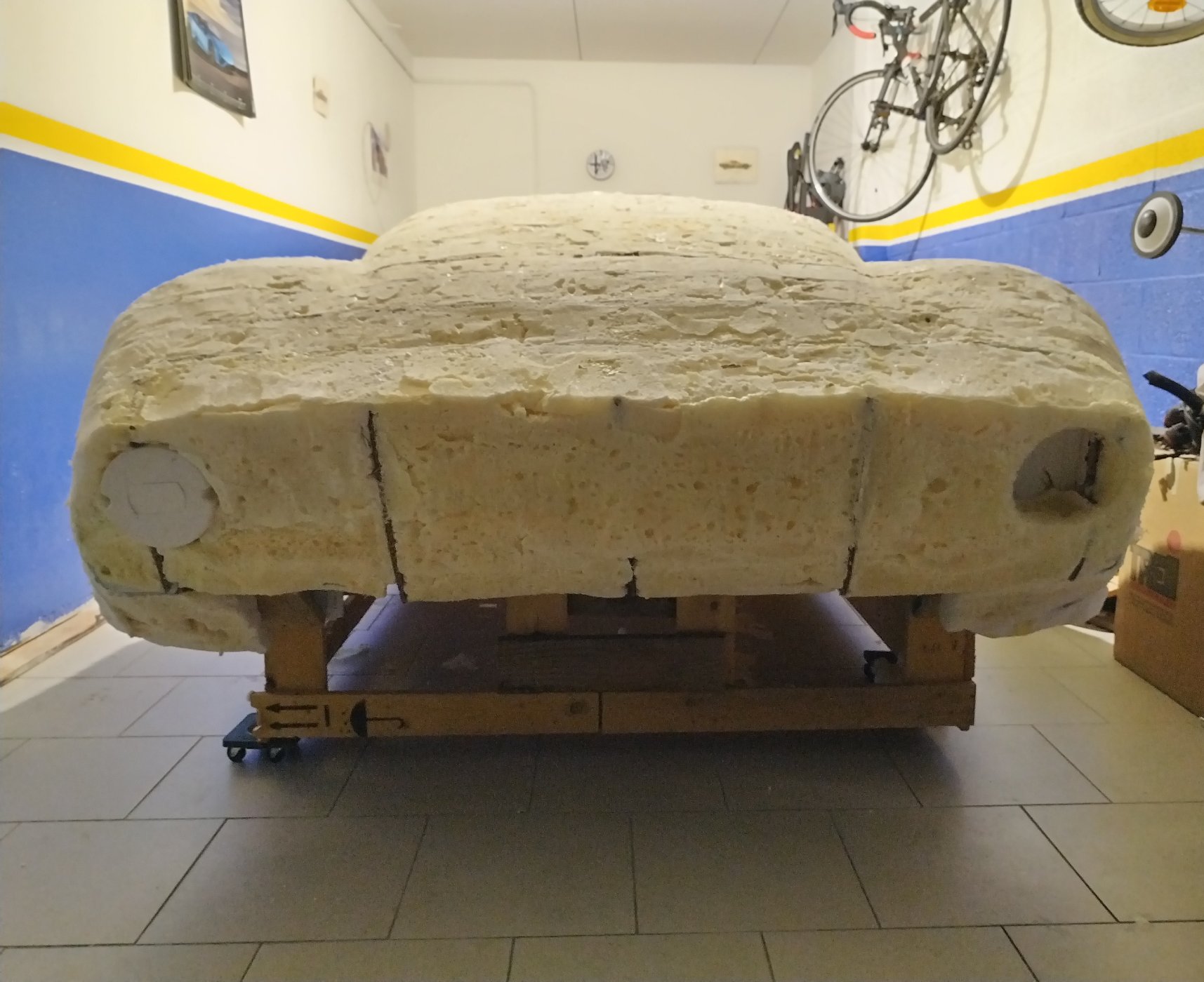

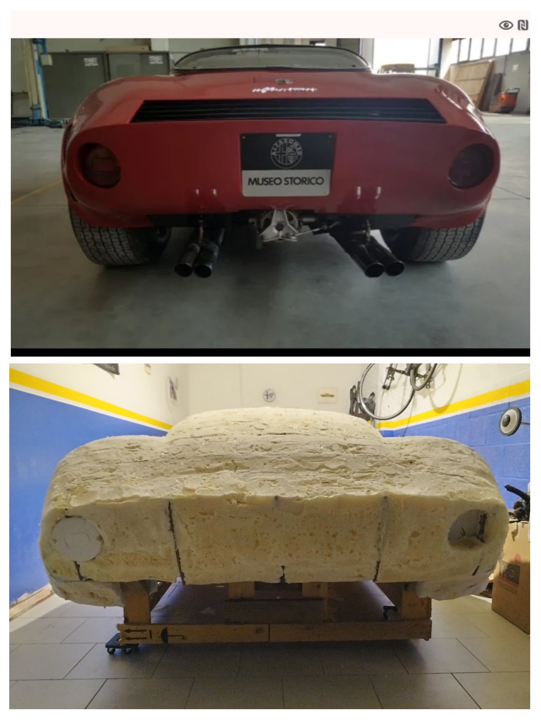

All OEM parts are like a unicorn
I will use Lexan with rivets to copy the shape.

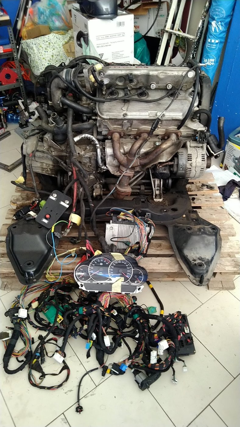

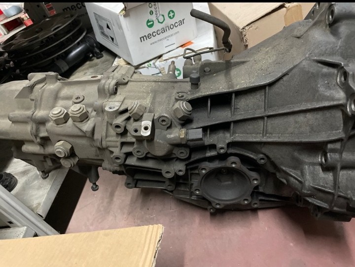

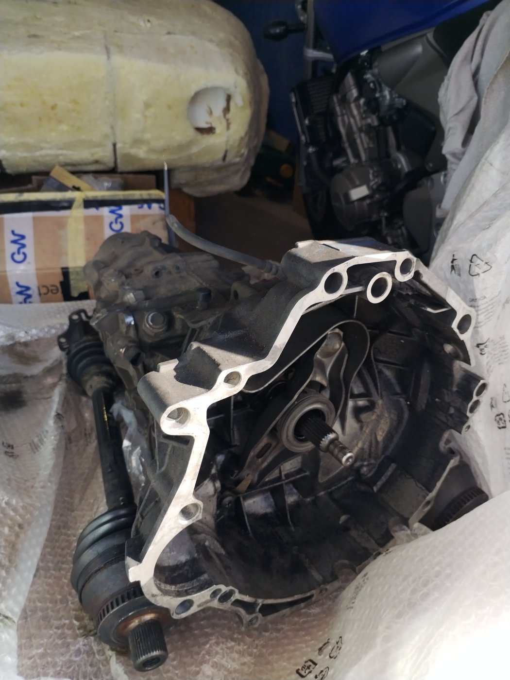

Now I've MX5 Uprights and I'm searching for an Audi Gearbox, in particular the 012 box from the 1.8 turbo A4 fwd

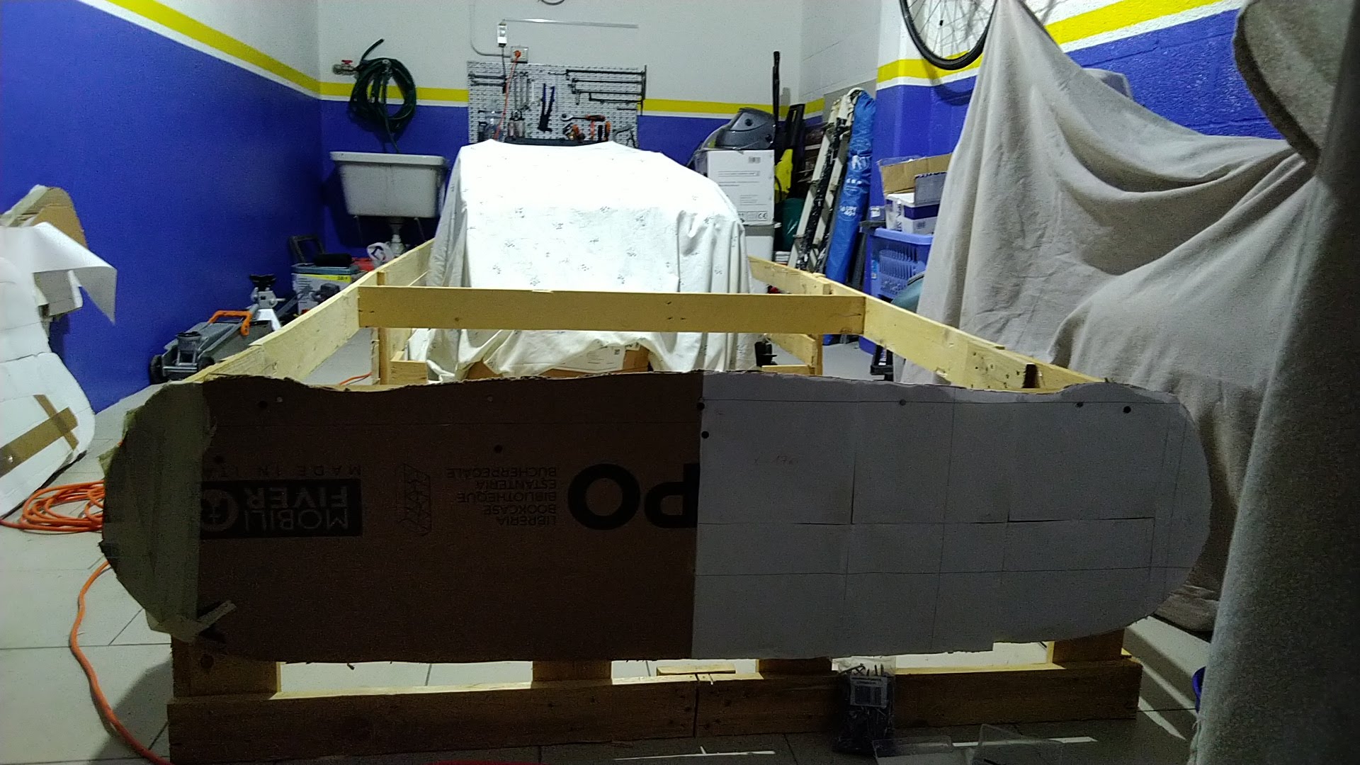

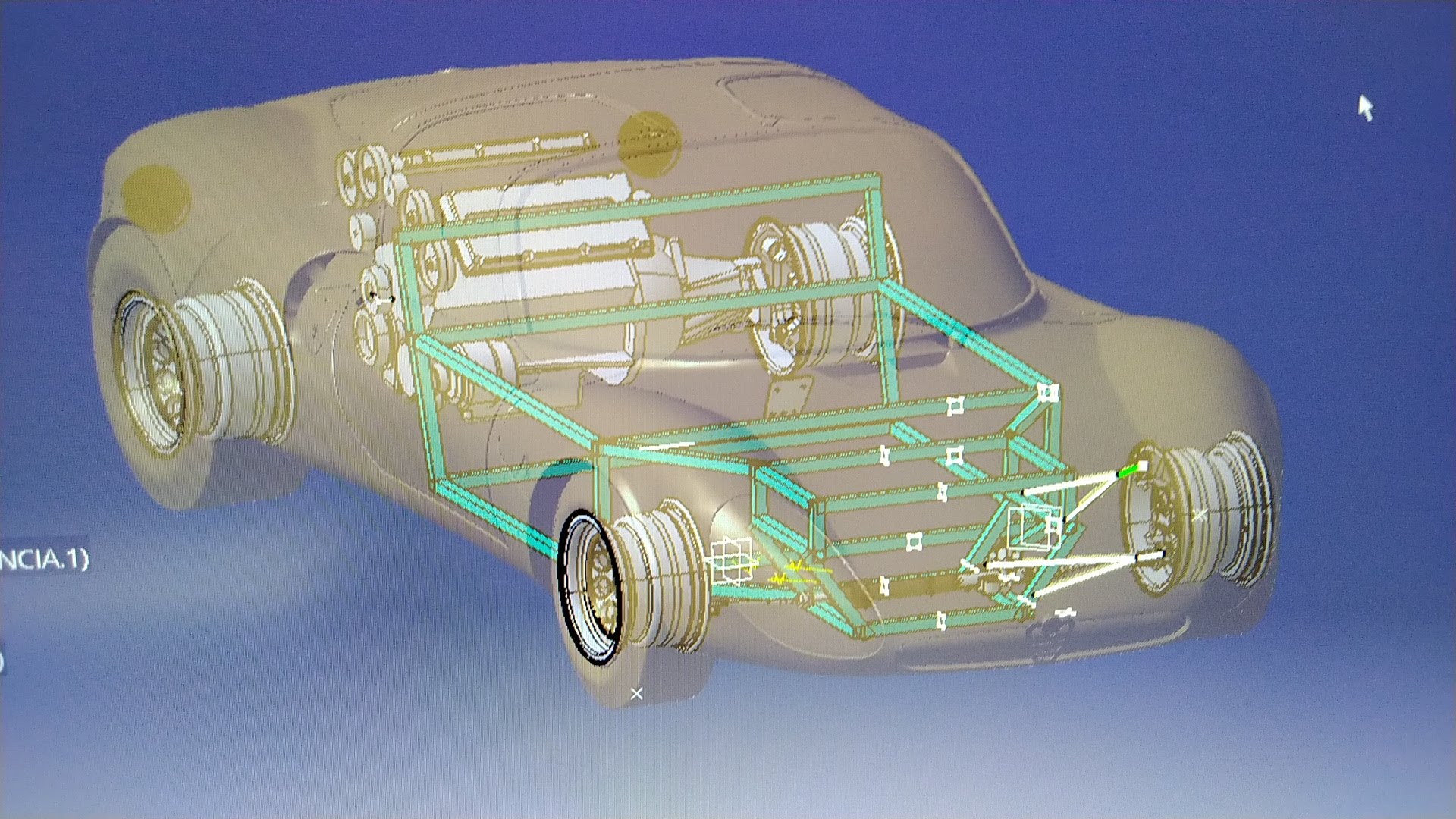

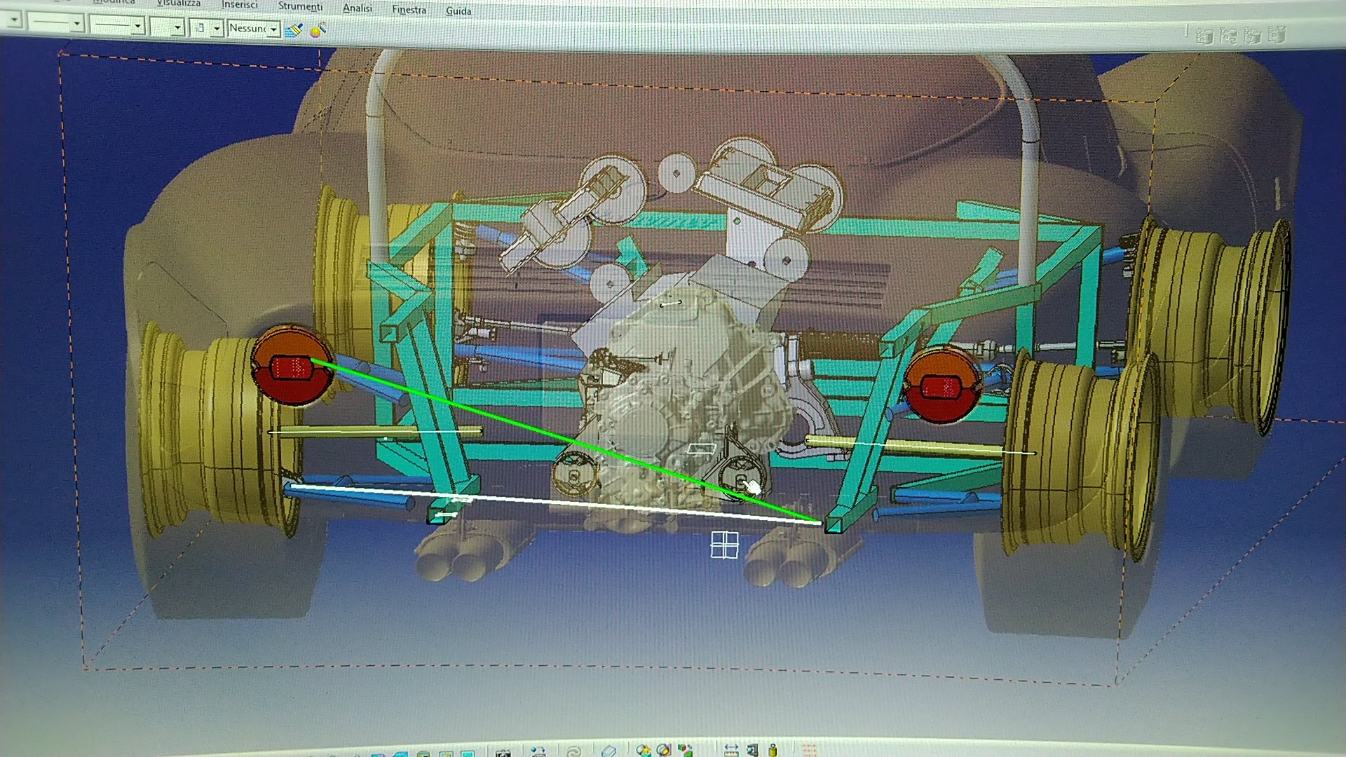

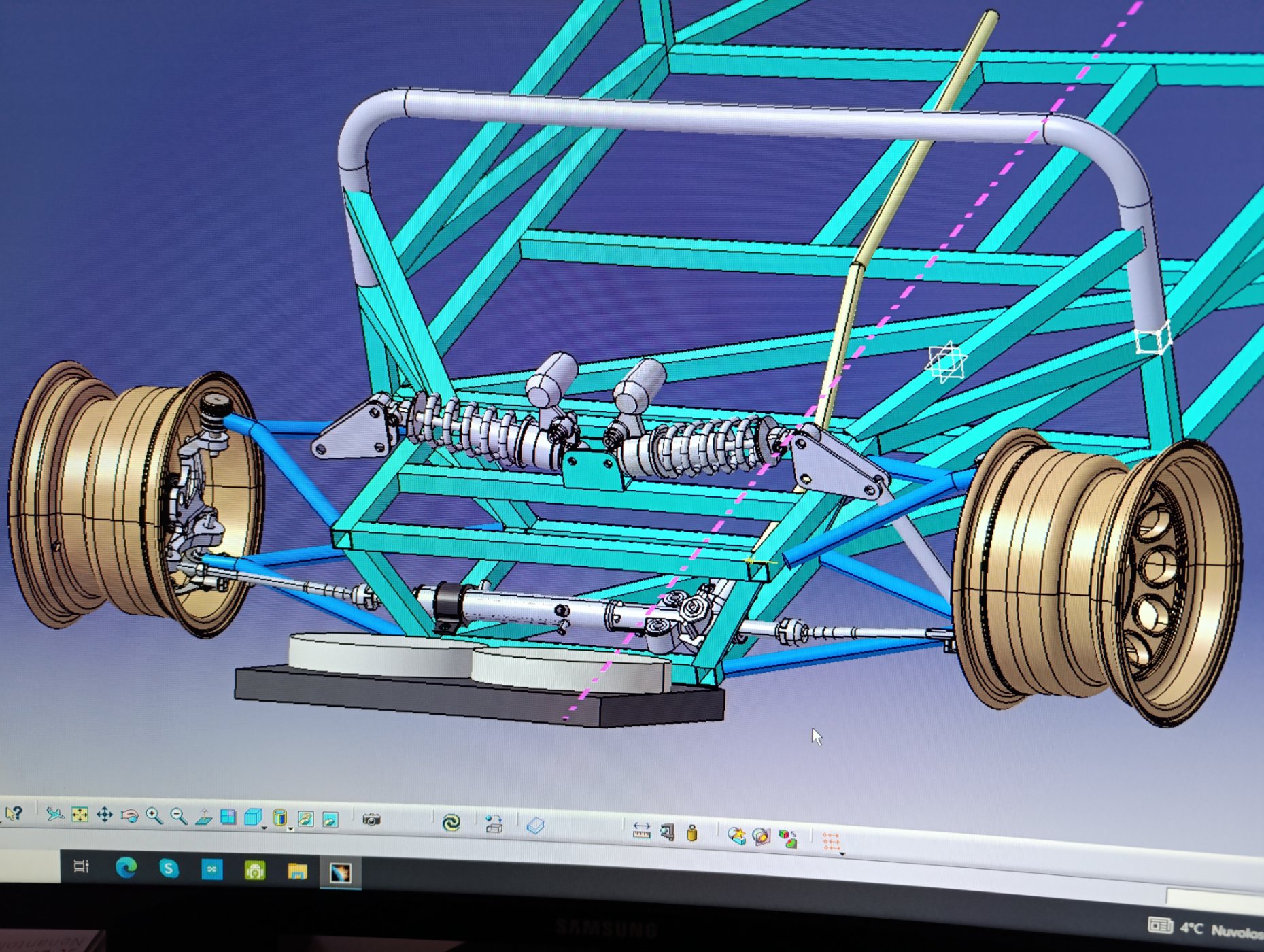

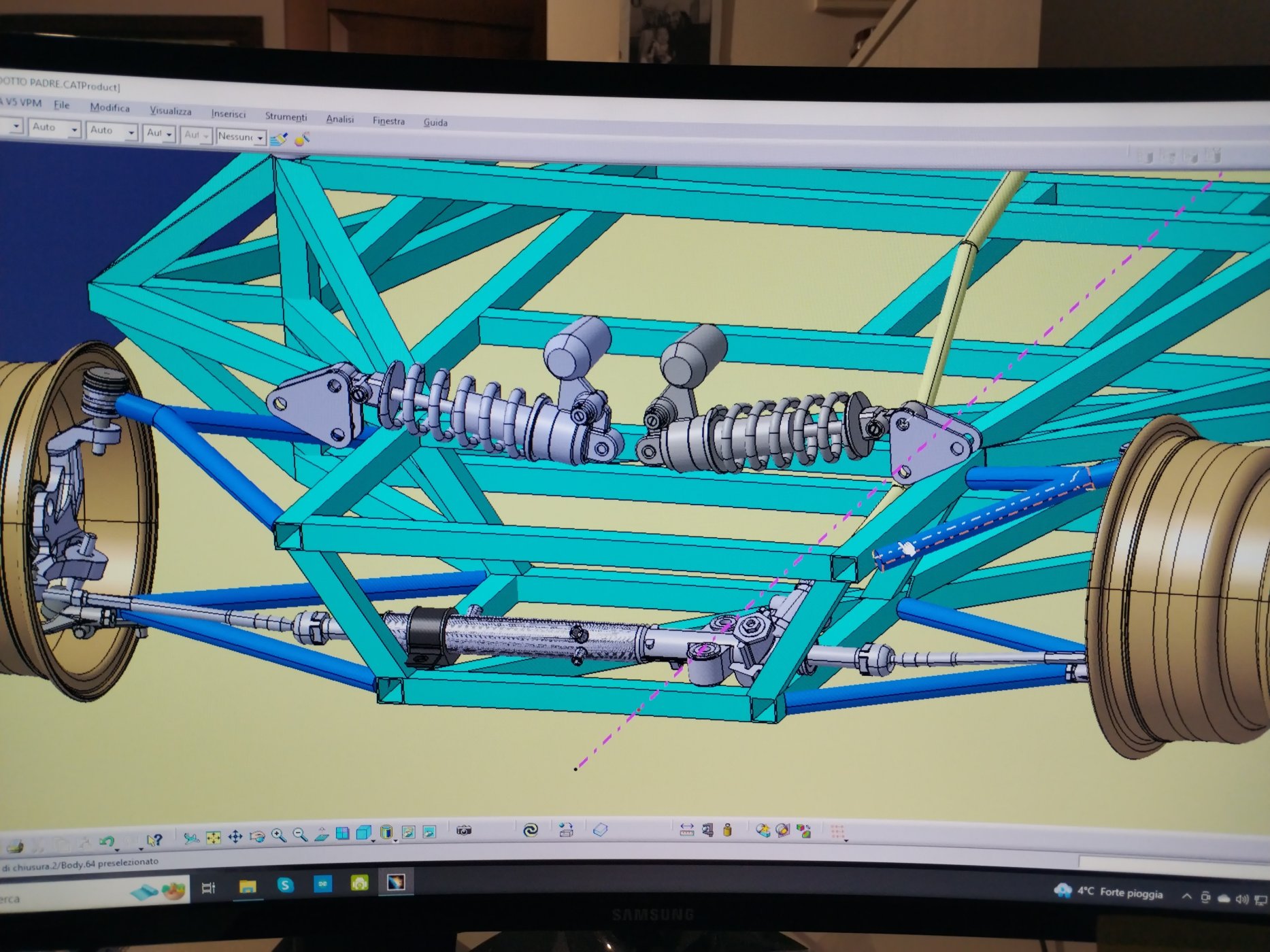

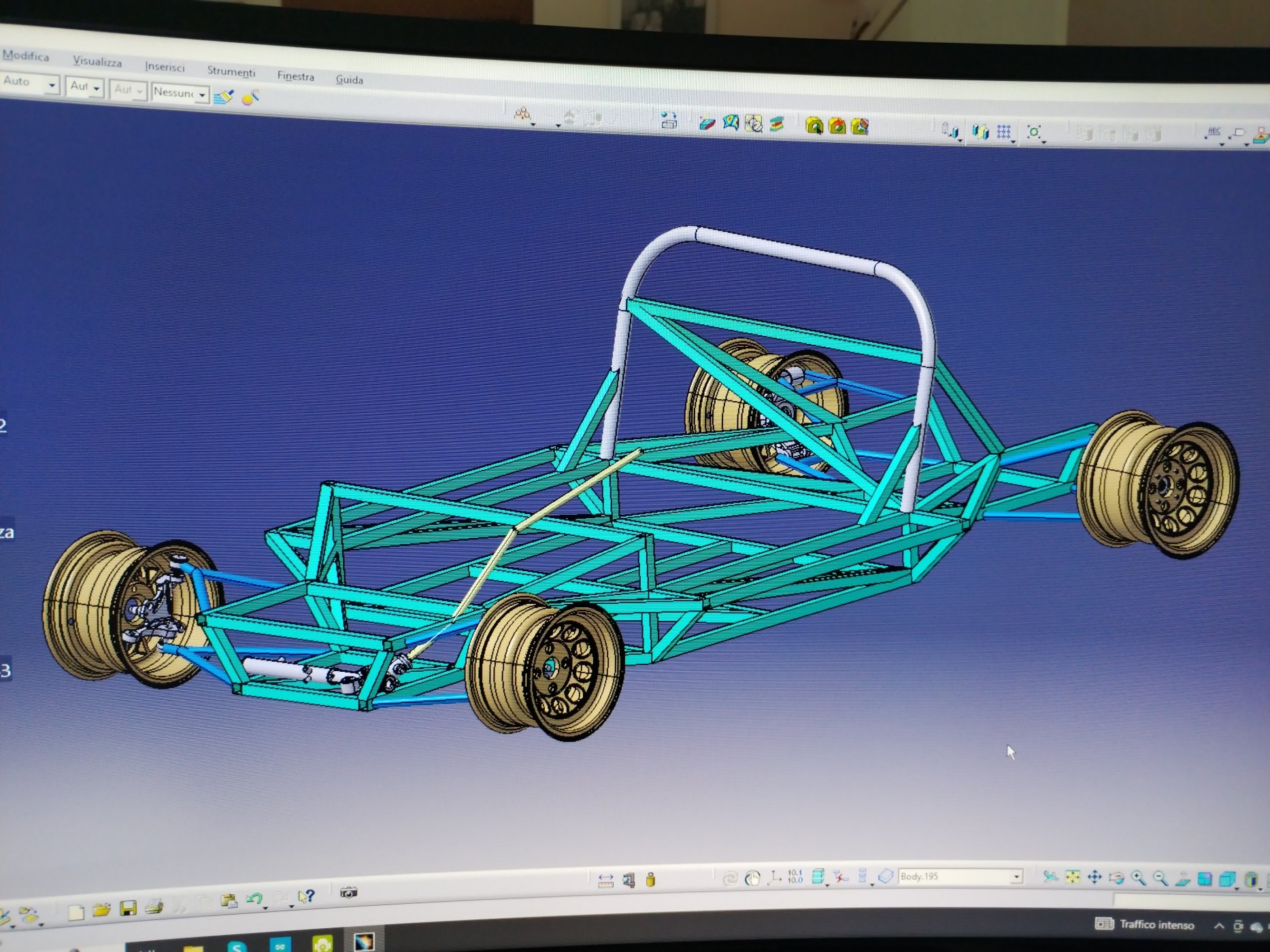

Hi, I'm very proud of your interest and your response because I had seen the construction of your Lola T70 years ago, and from there I decided to build my dream car from scratch! I was very inspired by you and being a process engineer I tried to think how to achieve a decent level of quality with fewer steps than yours...I'm still working on it!
About what you say I agree with everything... the decision of the components to use and the ground test in the garage with the pieces, in my case was replaced by a Cad project in which I inserted the bodywork, the engine/gearbox, the hubs, the steering box, the wheels to define the layout (DMU, digital mockup).

As noted by Fred - ergonomics are crucial. These cars were often designed to minimize frontal area and mass, and often had zero crush space ahead of the front axle. So there's literally no wiggle room inside if you stay true to the original design. Depending on your stature, that could be a make/break issue.

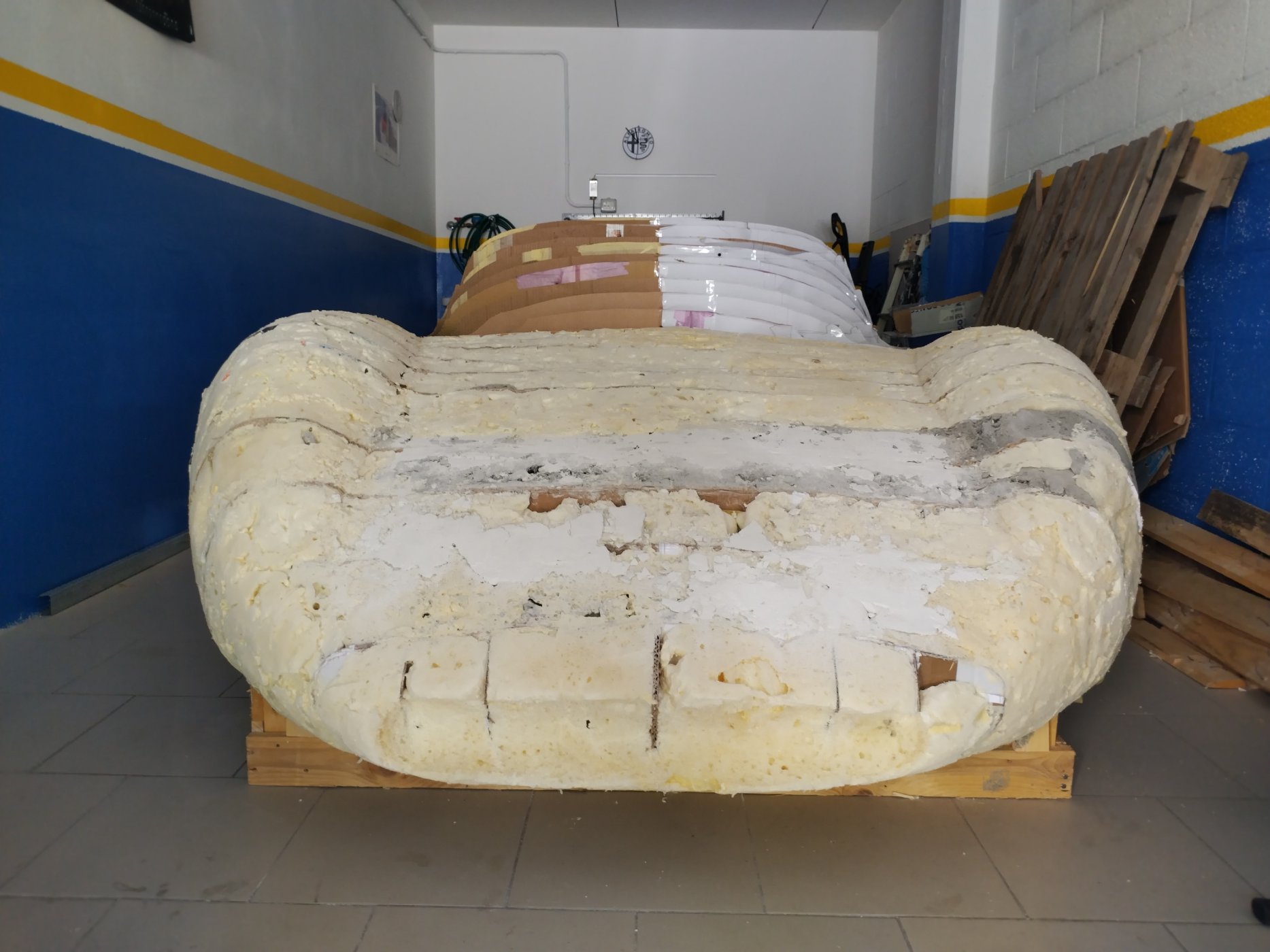

luckily for me I am 1.72m tall and I think I fit..after the body construction anyway I will try to check, and in case to make some changes to recover some cm..

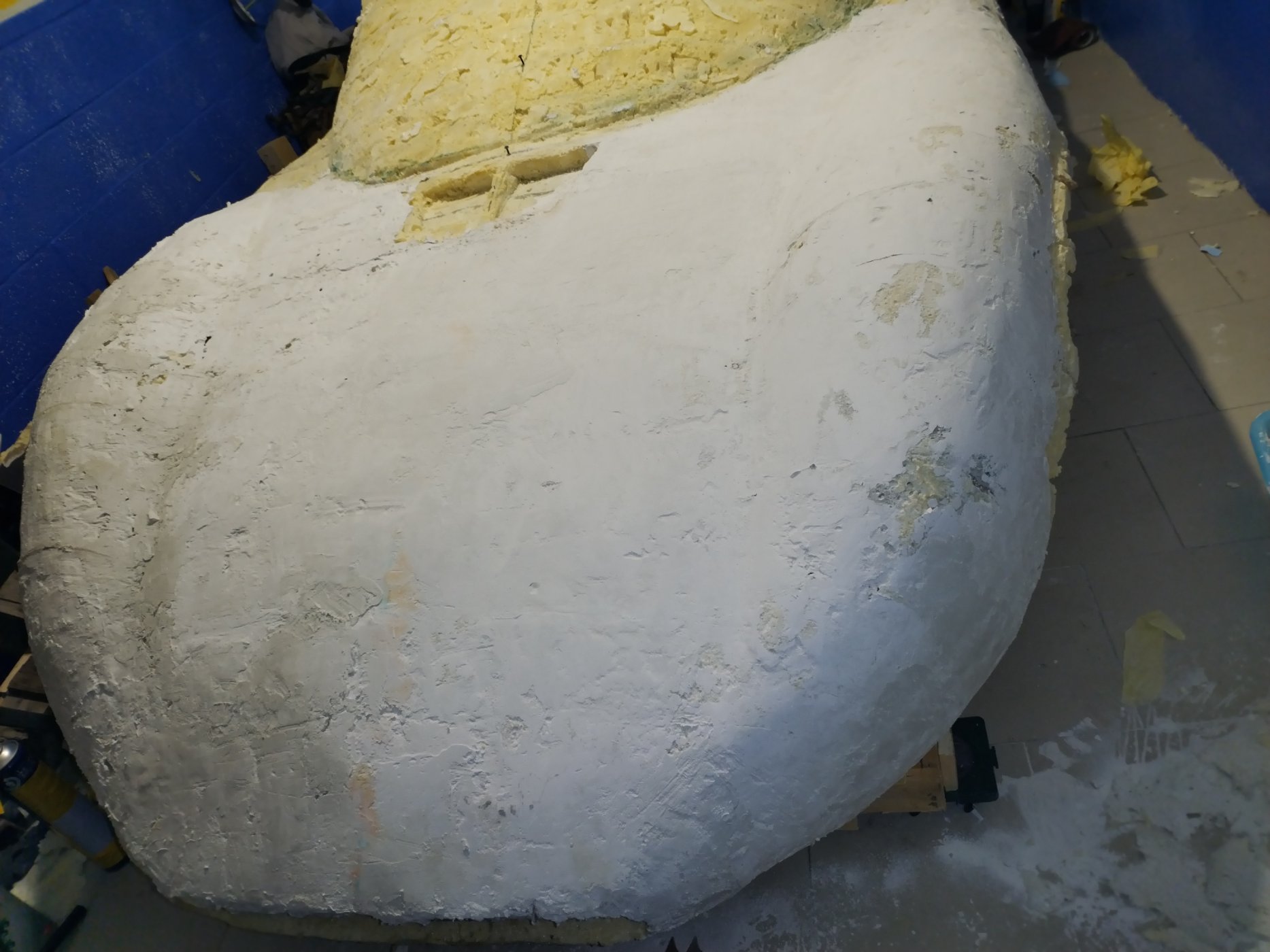

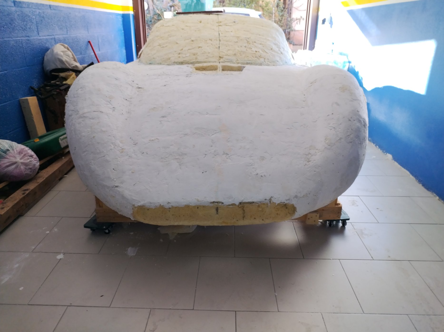

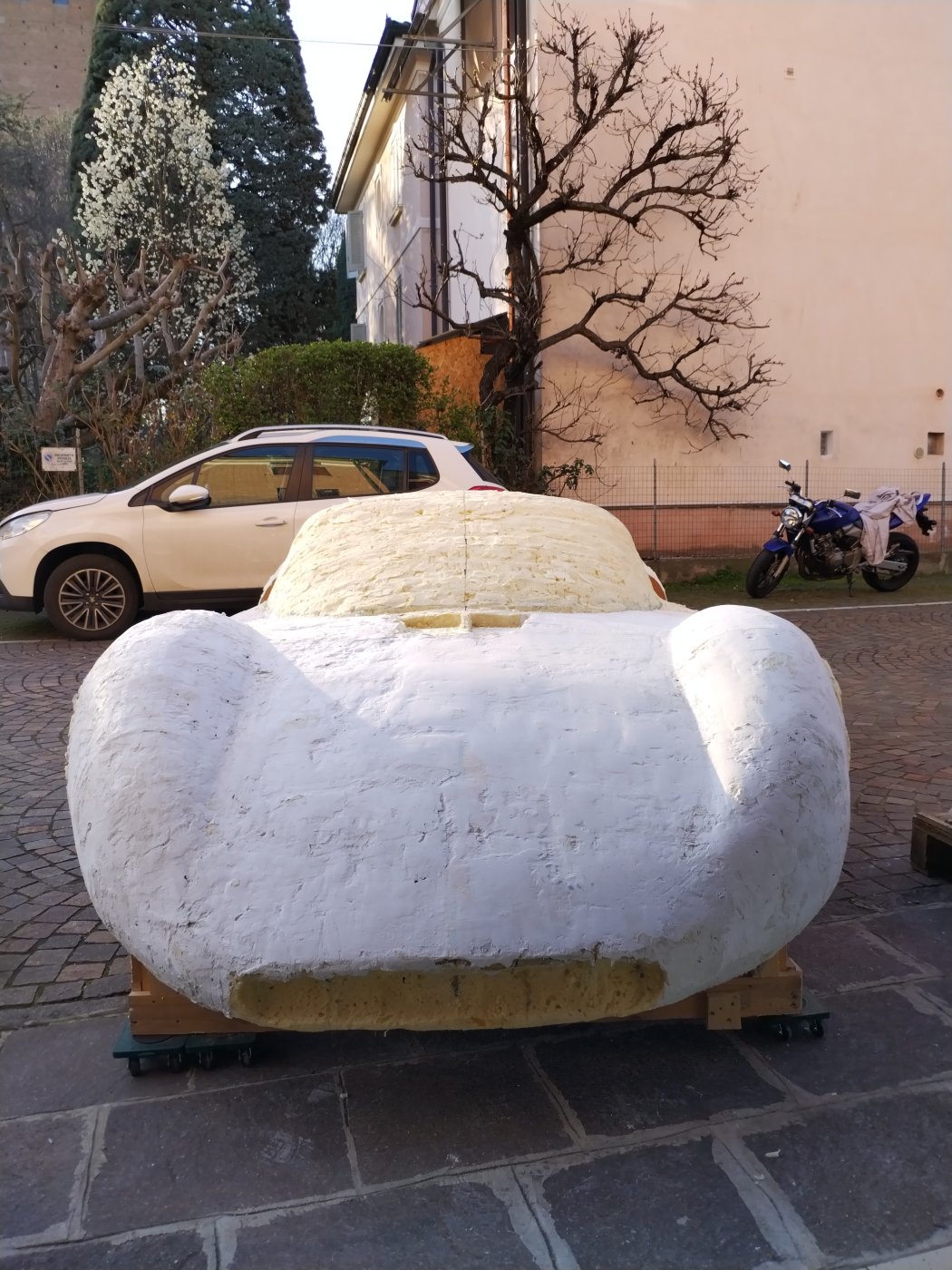

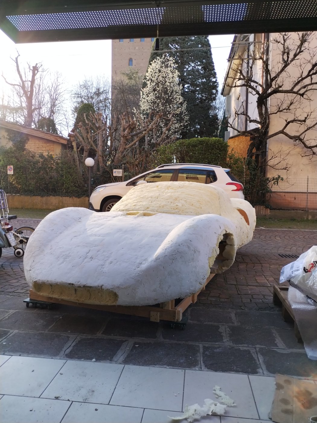

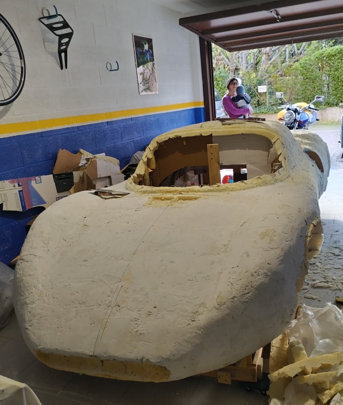

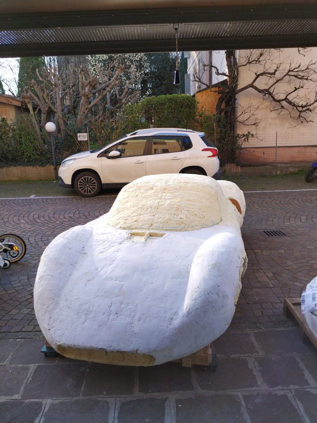

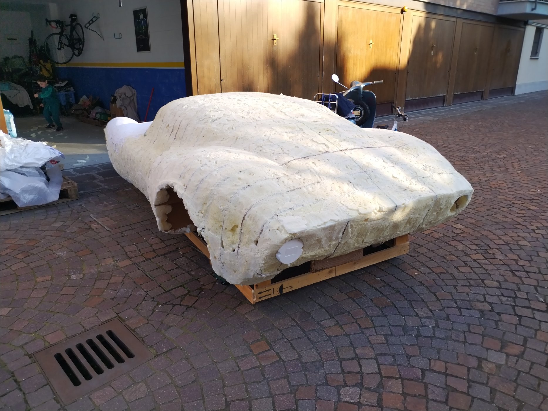

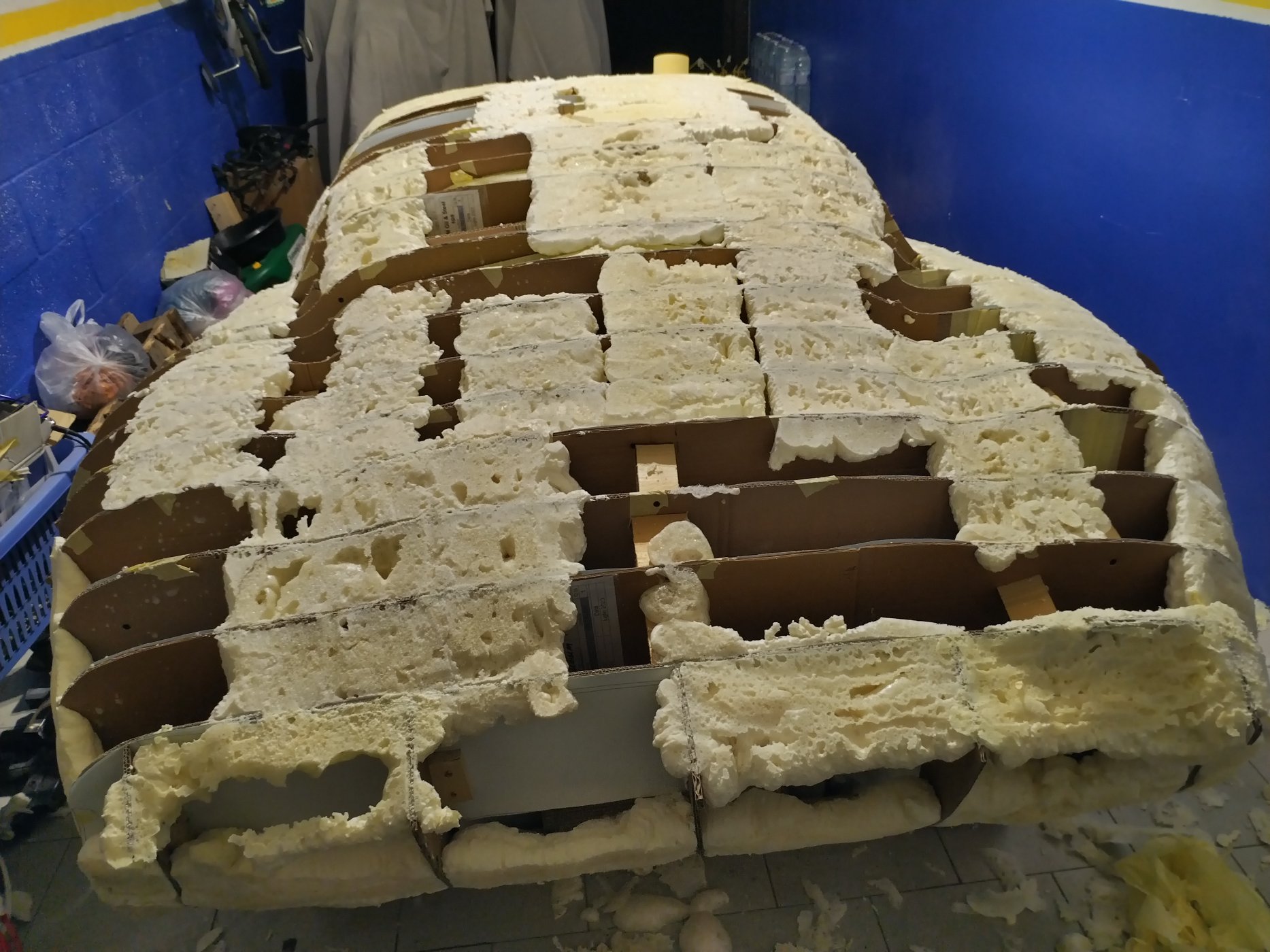

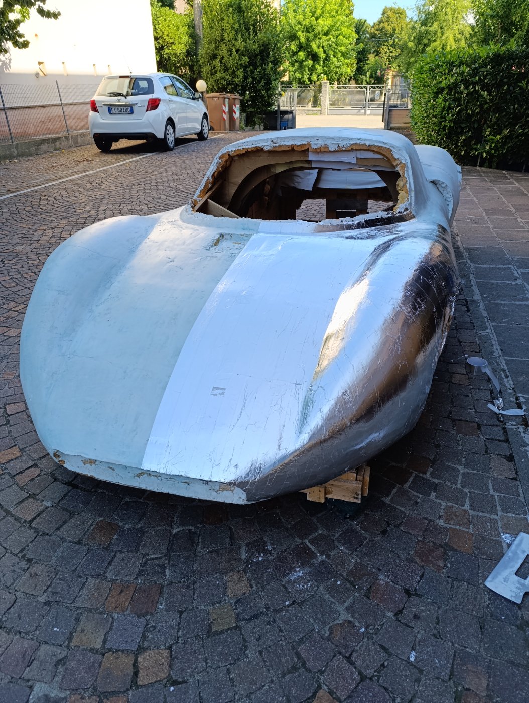

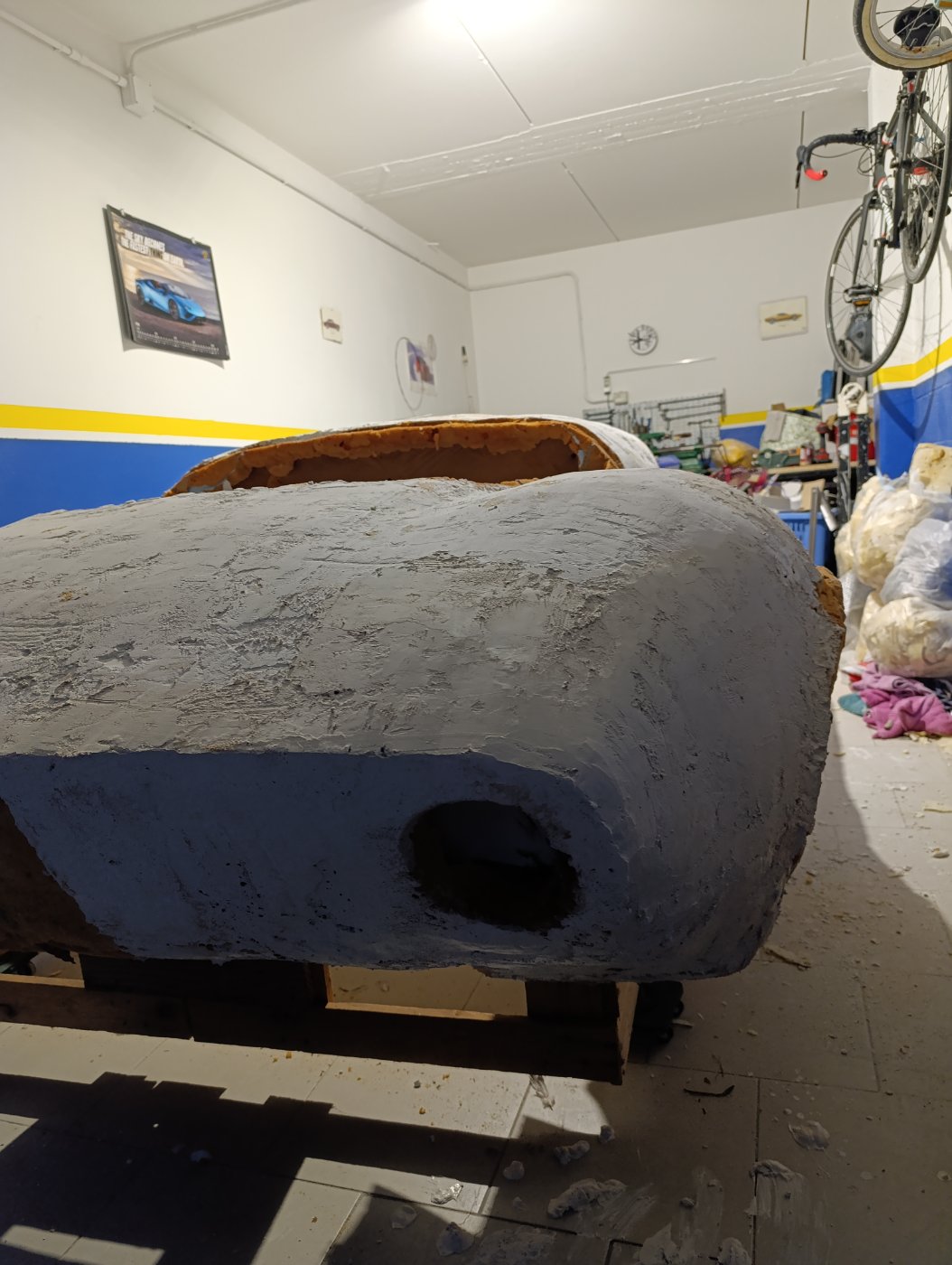

Next step is to fit the filler around the complete model and to smooth every curve..
I will use Wall plaster because is cheap and I know how to use it
Chris Kouba
I used drywall compound- specifically what we call "10 minute mud". It dries very quickly when applied thin, and remains clay-like and shapeable until it dries- almost like modeling clay. The regular drywall compound seemed to take forever and was not shapeable while drying. I'd highly recommend the 10 or 5 minute versions. If you're applying thickly, the timing isn't really accurate.
It's also pretty cheap too!!

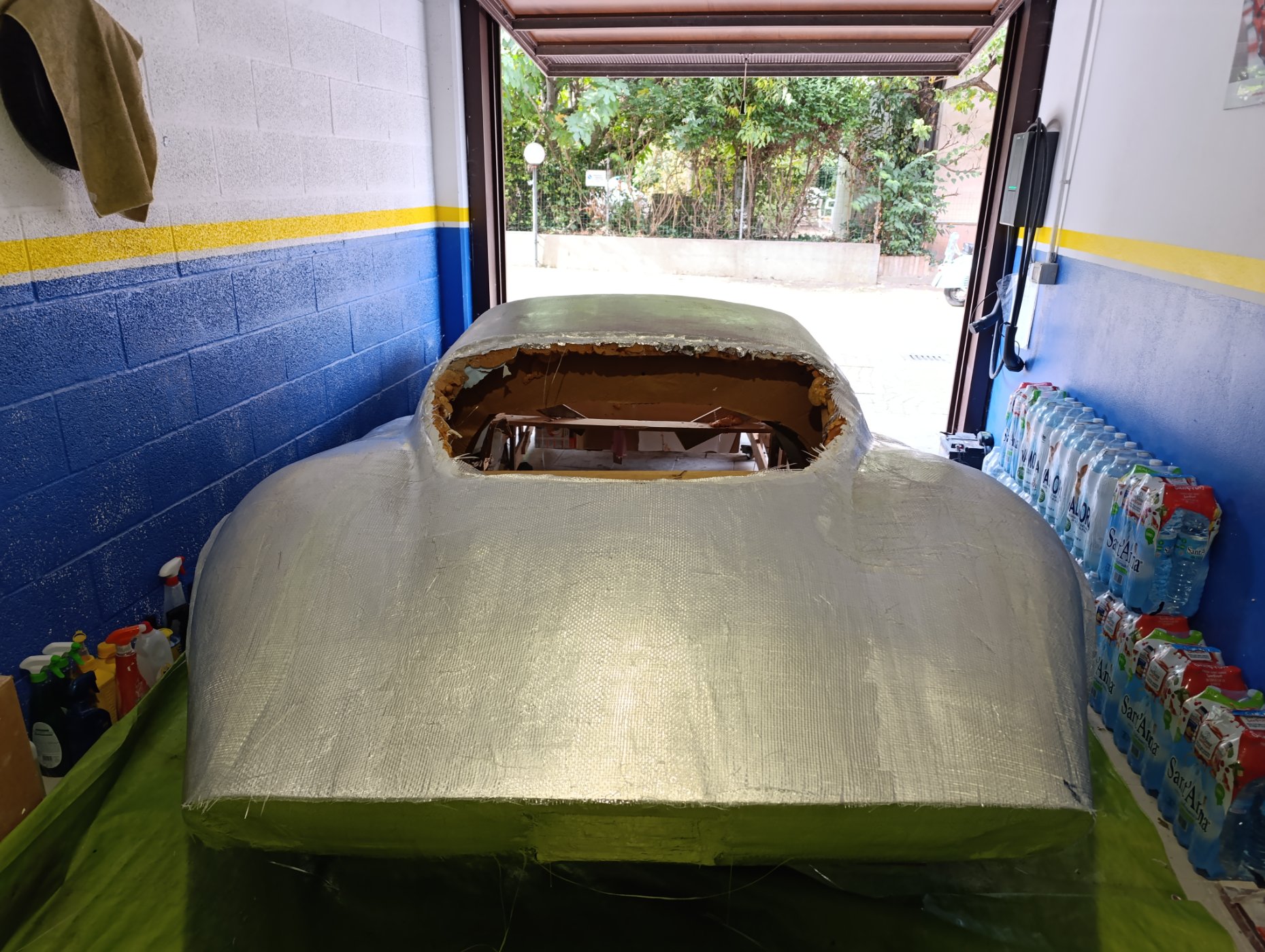

Update.
I opened windscreen and rear glass in my model, but I decided to not insert holes for headlights and side windows because this closed areas are useful to create jig for shaping Lexan in that zones.

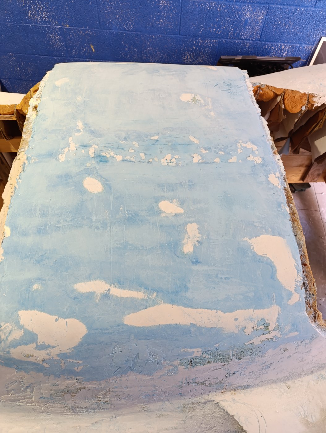

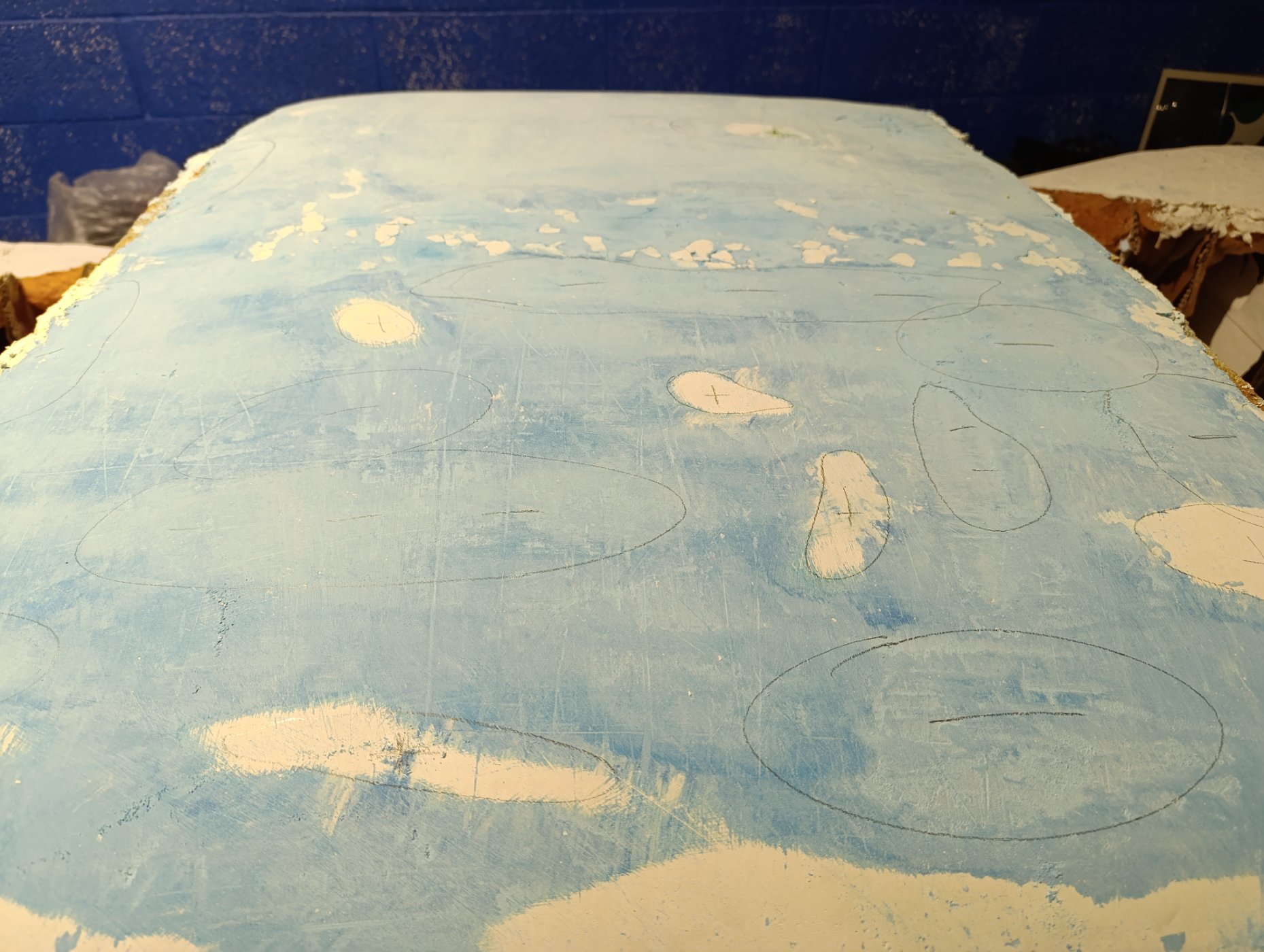

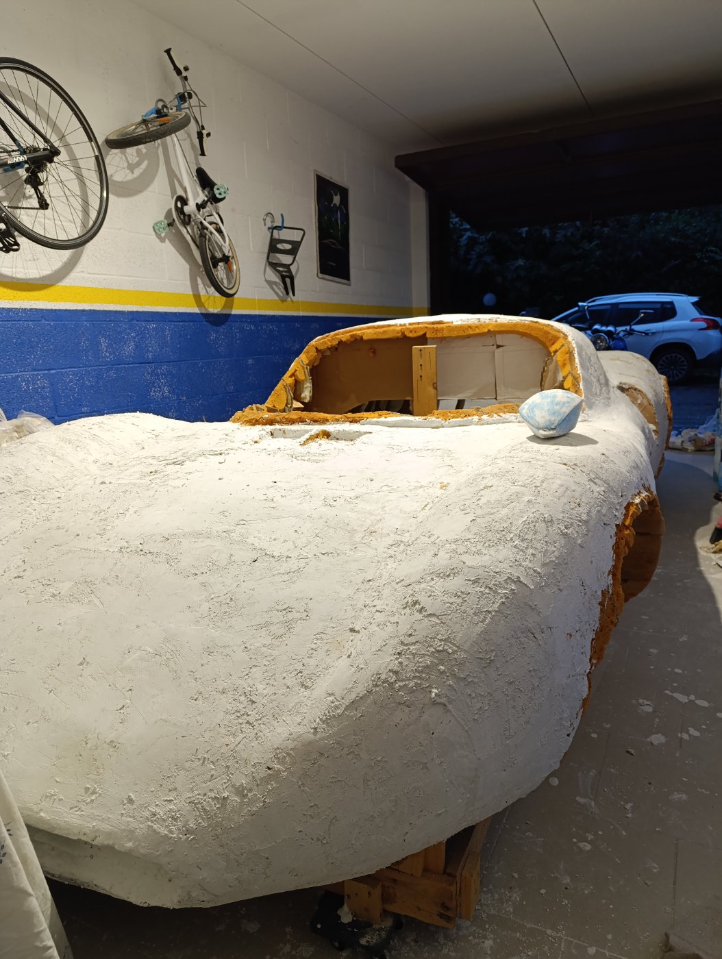

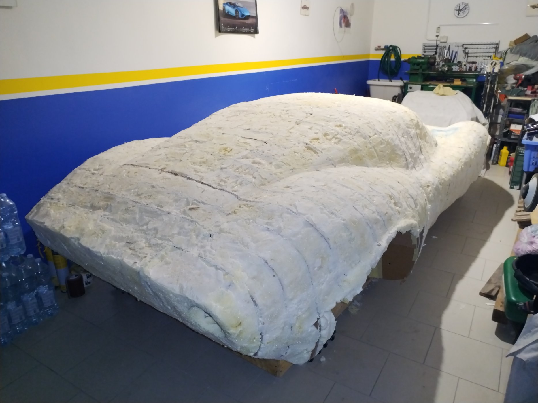

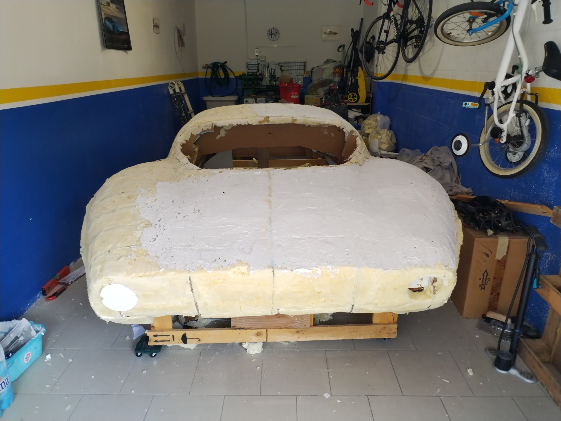

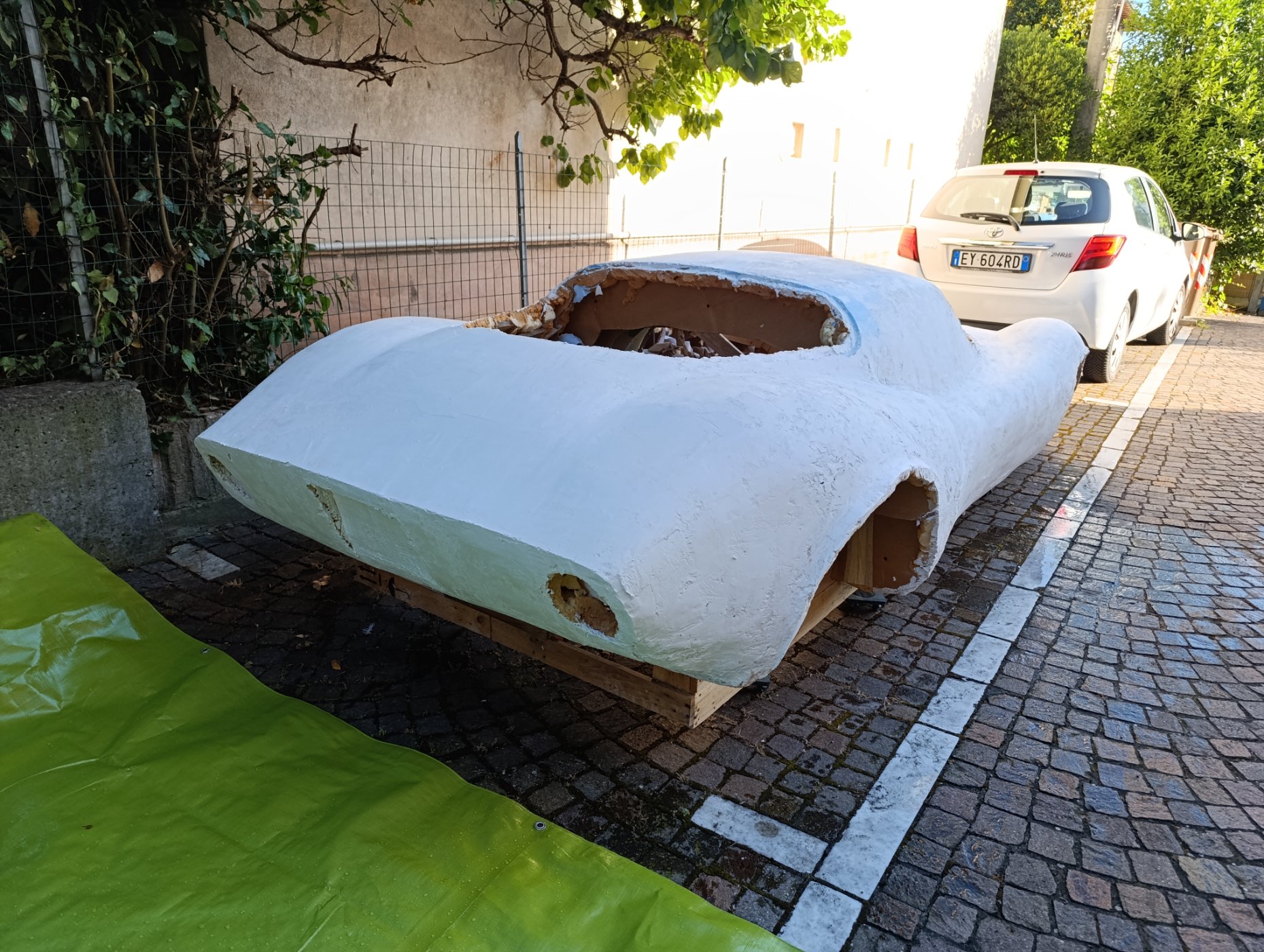

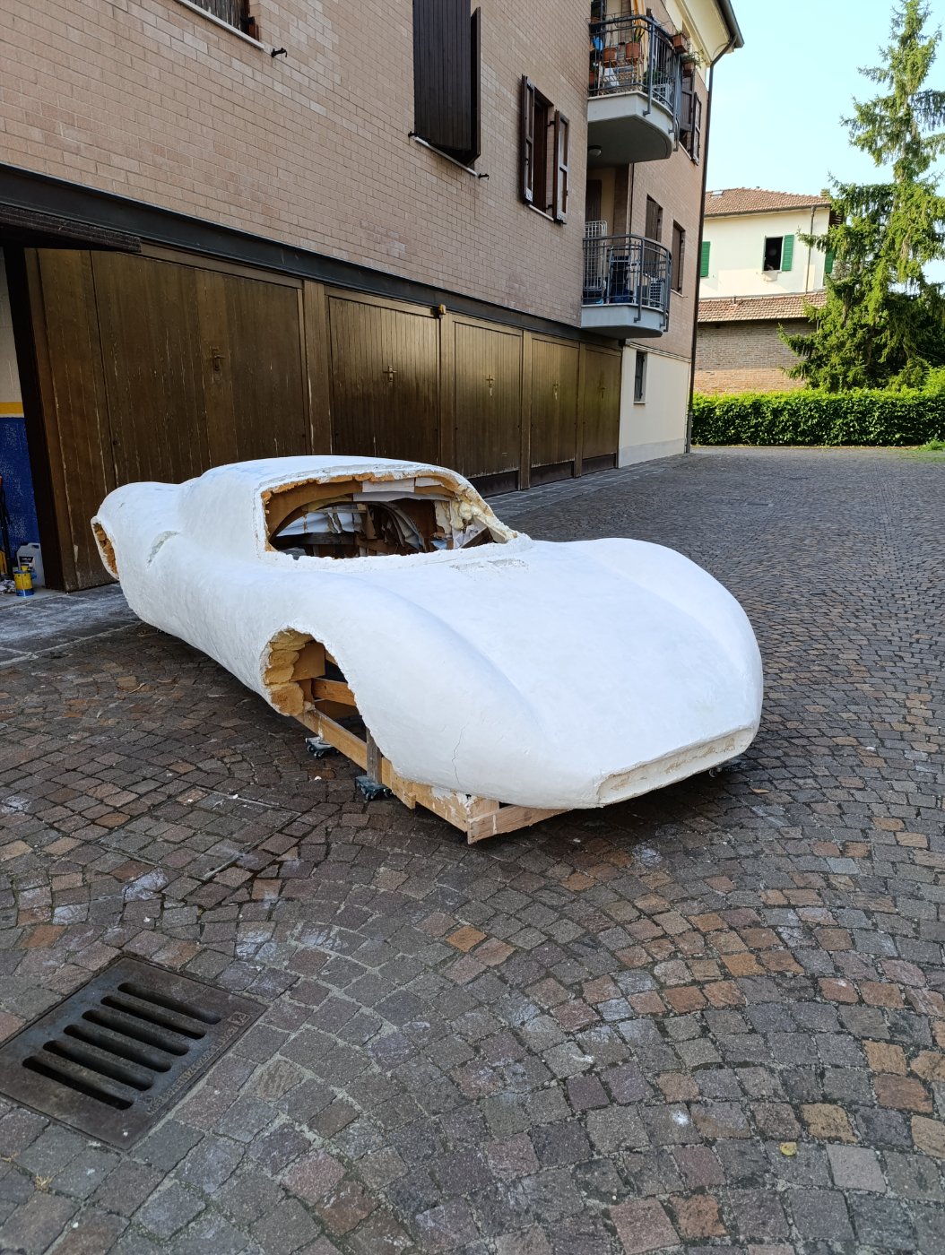

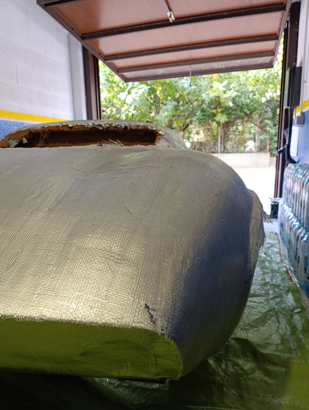

During these holidays I had a few hours to dedicate to the project. The current phase of the physical project is that of smoothing and refining the surfaces.
In the photo you can barely see it but to get an idea, I gave it a coat with finer compound that also allows me better workability (so far I have used scagliola plaster, hard, coarse and quick-setting) and I added some concentrated colorant.
After having smoothed it properly, the result was this:

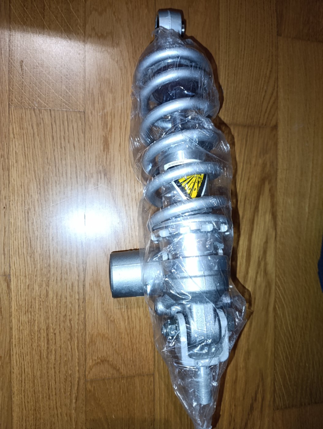

In the meantime, the virtual counterpart is also growing, in which I am drawing the details of the push rod and which has also encouraged me to buy two rear mono shock absorbers of the Yamaha R1, which for their characteristics of adjustability and elastic constant should be right for me.
