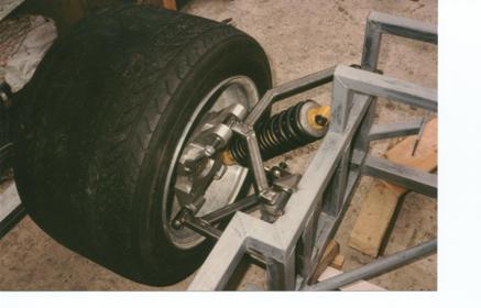

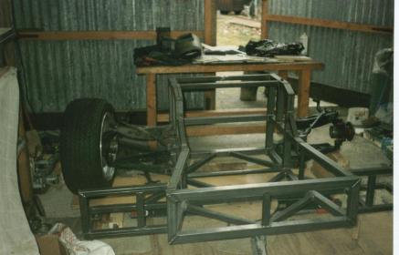

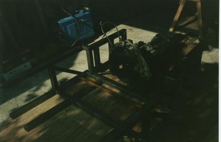

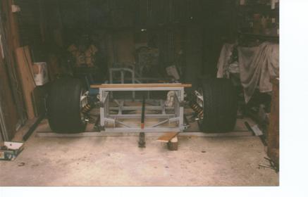

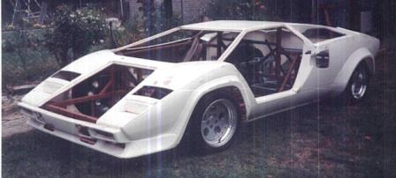

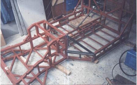

I agree, I also get a lot of ideas form pictures of other peoples builds. I have step by step pictures of the build so far, I designed and built the frame myself, all I bought was a shell. Here are some of the pictures.
Front suspension is from a Renault 30TX, at the time it was too hard for me to design the front susp. The rear susp is my design, unequal wishbones, independent with one SPAX coil/damper. I bought the cast uprights to accept Renault 25 bearings/spindles/driveshafts. Using a Renault 25 UN1 Gearbox. I recently moved my workshop from the UK to California, as a result, I did not bring the temporary Renault V6 2.6 litre engine from the donor car cos I want to use a BMW V12. So if someone needs a V6 engine in the UK (Wembley area), please contact me. BTY, cost of moving a 20 foot container was about $5,000USD incase someone is considering relocating.
I have not worked on my car since 1994 and am just getting back into it now that it is here in sunny California.

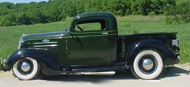

I am planning on useing a 5l v12 bmw in a 38 chevy truck project.
Can anyone help with any Ideas on engine management, Shure i would like to run Fuel injection but carb would also do for this project.(the engine did not come with computers) Also the trans, is their a way to run the 5 speed auto stand alone ?
Thanks, any help would be great...
