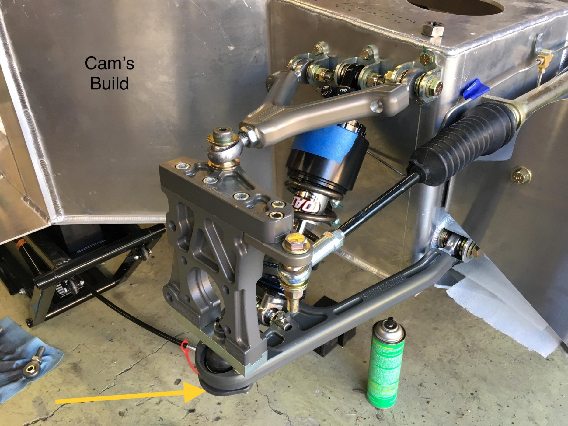

Hi Cam,
Have a question for you, I am installing the ball joints and mine look similar to yours and wondering if you had to trim the edge of the front ball joint plate down to clear the rotors? It mentions this in the manual and wonder if you had to do this adjustment.
I have included this pic of your suspension with a yellow arrow pointing to the area of concern. Thanks for your help.
Hi Cam,
some balljoints need to be cut, some don't, depends on the manufacturer - different ones have different over-hang.
