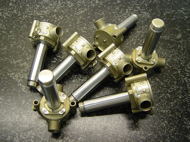

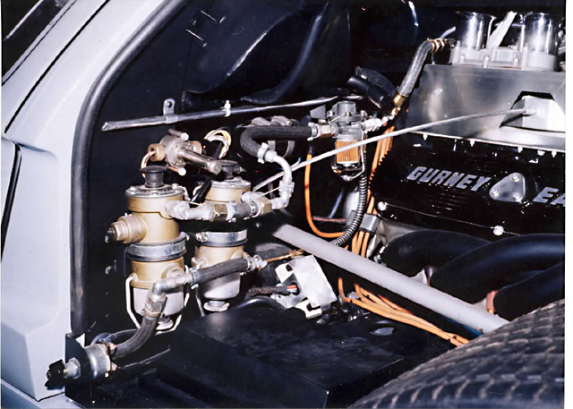

I have been asked about the fire suppression system.
Here are the same Graviner probes which were fitted to the Gulf cars. Most people have never seen these as they were removed and not replaced for various reasons.
The reeds in this type of probe can be calibrated and the units are fitted between the SW pumps and aloft on the inner engine bulkhead to cover the Webers.
I will also stick a couple near my fuel system to be sure.
I have a mate looking into a modern controller for me.

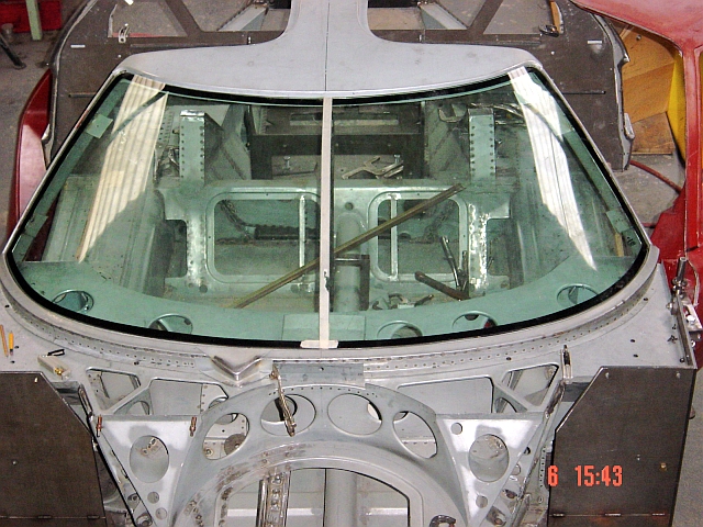

The original screens fit !
I saw this as a major milestone as the fitting of this piece accurately verifies the dimensions from the surveys with the drawings.

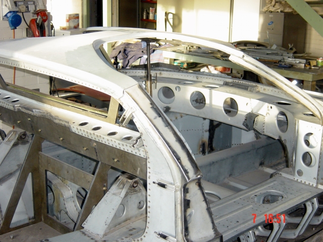

The jig assemby went well and the doors were also trial fitted at this stage to check the roof spider.
Everything fitted snugly again.

As the screen is really the key to most of the geometry, it's a major piece to go in and we knew we had two that fitted original cars.
Ray and Steve took a lot of time trial fitting everything. We made a fibre-glass screen but the only way to know for sure is to tack everything up and gently drop in the glass.
There is really not much room for error with this thing because it is all thin metal and one can't just drop a blob of bondo on to correct anything if it's out.

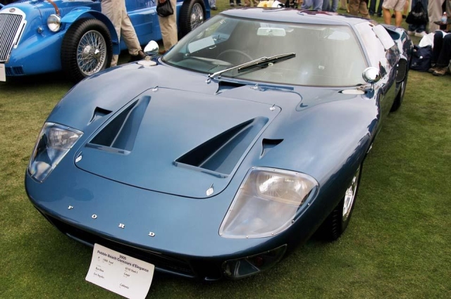

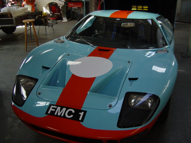

James, I'm curious. Being an "original" in all regards, there seems to be a lot more curvature to the screen top and bottom and thus to the spider and the front valance than the average replica. Is this the result of the camera angle or is this a fact? I have trawled the gallery for a similar angle shot of a replica but to no avail.
JimmyMac
re: Jimmymac & Alistair's Cars
Keith,
It's a fact in my opinion, the screen has more curves than most replicas.

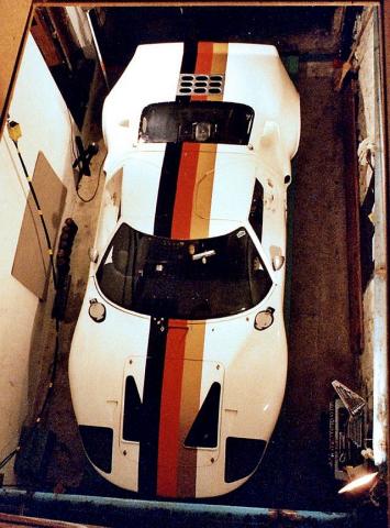

The pictures of a '66 original and P1107 might correspond to the profile of the one you see in Alistair's car above.
P1008 has the same screen fitted as we checked our templates of the A pillars and front valance on this car when it was in Mirage for the rebuild into it's MKII livery.

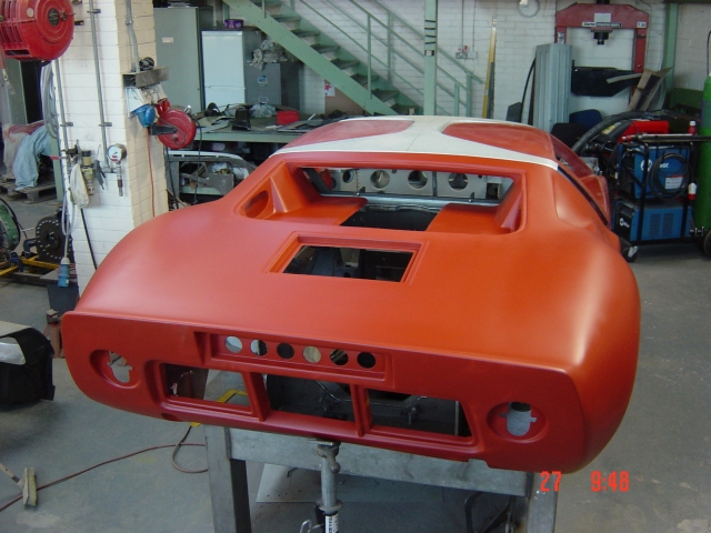

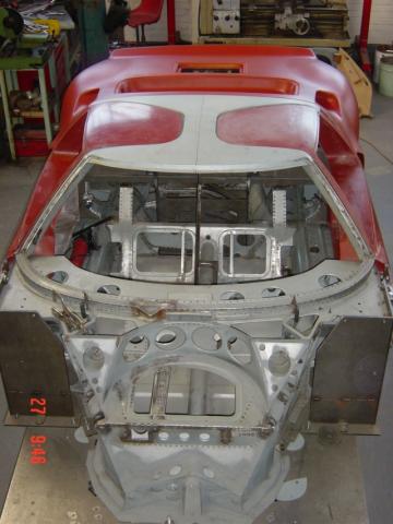

An original rear clip and doors fit rather well.
I now have to draw up layouts for the complete equipment fit-out and I am busy measuring up the positions for the original bracketry including those for for the fuel pumps, fispa, coil and ignition electrics.
