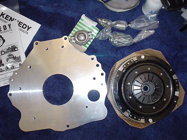

I know a lot of forum members have had positive experiences with Kennedy, but right now having just returned from Parcel Force to pick up what I thought was my order, I am not happy. I am VERY glad that California are 8 hours behind the UK, as I might have calmed down by the time they come into work.
On the 20th February I ordered:
- a flywheel and clutch to suit a Ford 302 Windsor engine for the Audi gearbox
- a starter
- I specifically stated that I DID NOT need the adaptor plate, as I already had one
On 10th April I received an email saying that they had shipped my order and $1157 had been charged to my credit card. I was quite surprised, as I had been quoted $335 for the flywheel, $342 for the clutch and $135 for the starter. Even with a worse case with USPS Airmail, I could only get the figure to total $1035.
Now I know why. See the picture below. Kennedy have sent the adaptor plate and there is no starter. So now I have two adaptor plate and no starter. Needless to say I will be phoning them for an explanation as to how they need to go back to school to read :mad:

Despite repeatedly telling Kenndey in emails the size of the input shaft of my 01X, they said sure it will fit... by measurements it won't, so I guess I will now be looking for an 016 to replace the 01X, as now I have the adaptor kit for the 016... my weekend has just gone into freefall.

You're right about the 01X. I knew I was taking a risk when I did it, as thier's was for a 5000 and mine was a 01X. However, as I had already one of their plates and had mated my box to it and it fitted (bar one hole misalignment by a few mm) I decided to take the chance.
Yesterday after finishing the lights I decided to slip the bell house casing on anyway just to see. It fits. I turned the crank and the flywheel/pressure plate does not interfere with anything inside. Now being a little bit more rational this morning, I will wait until the full box is back and see if I can play around with it. In the meantime I am going to to see if I can get a drive plate for my input shaft, as Kennedy's plate is only a Sach's unit anyway.
I guess what I am most dissappointed by is the complate lack of listening to the customer. I could not have spelled it out more clearly in my set of requirements. At least the situation may be recoverable in one of three ways:
1/ get an 016 and be the test mule of Stu's gearset
2/ wait for the box to come back and see the fitment and if it works get a new driveplate and pilot bearing (I didn't like thier roller bearing anyway)
3/ speak to Fran and Chris about their adaptor
