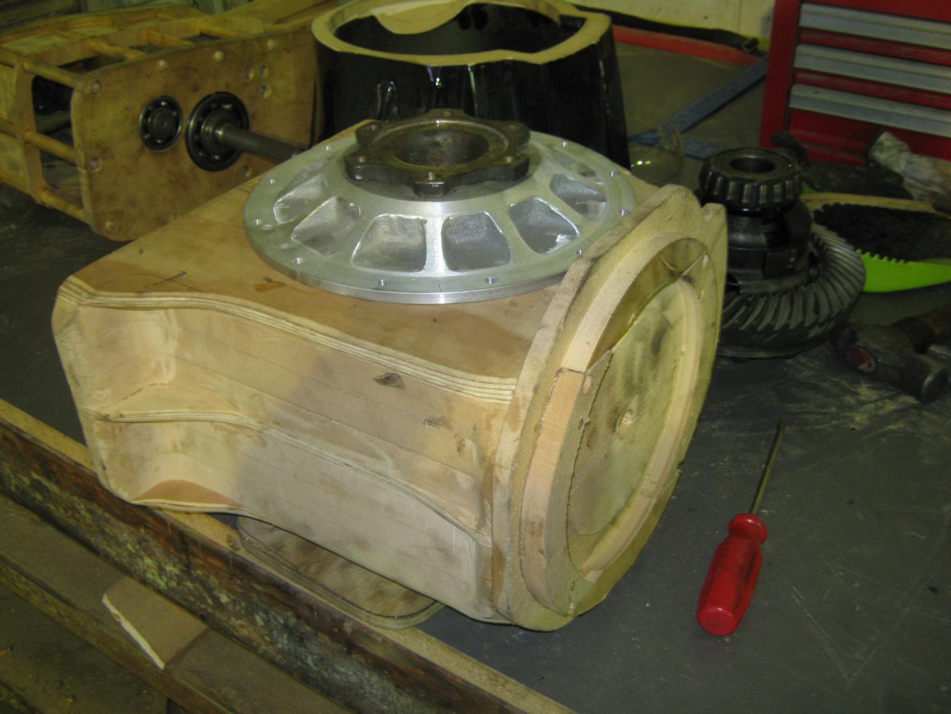

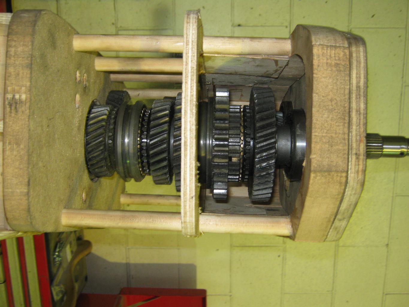

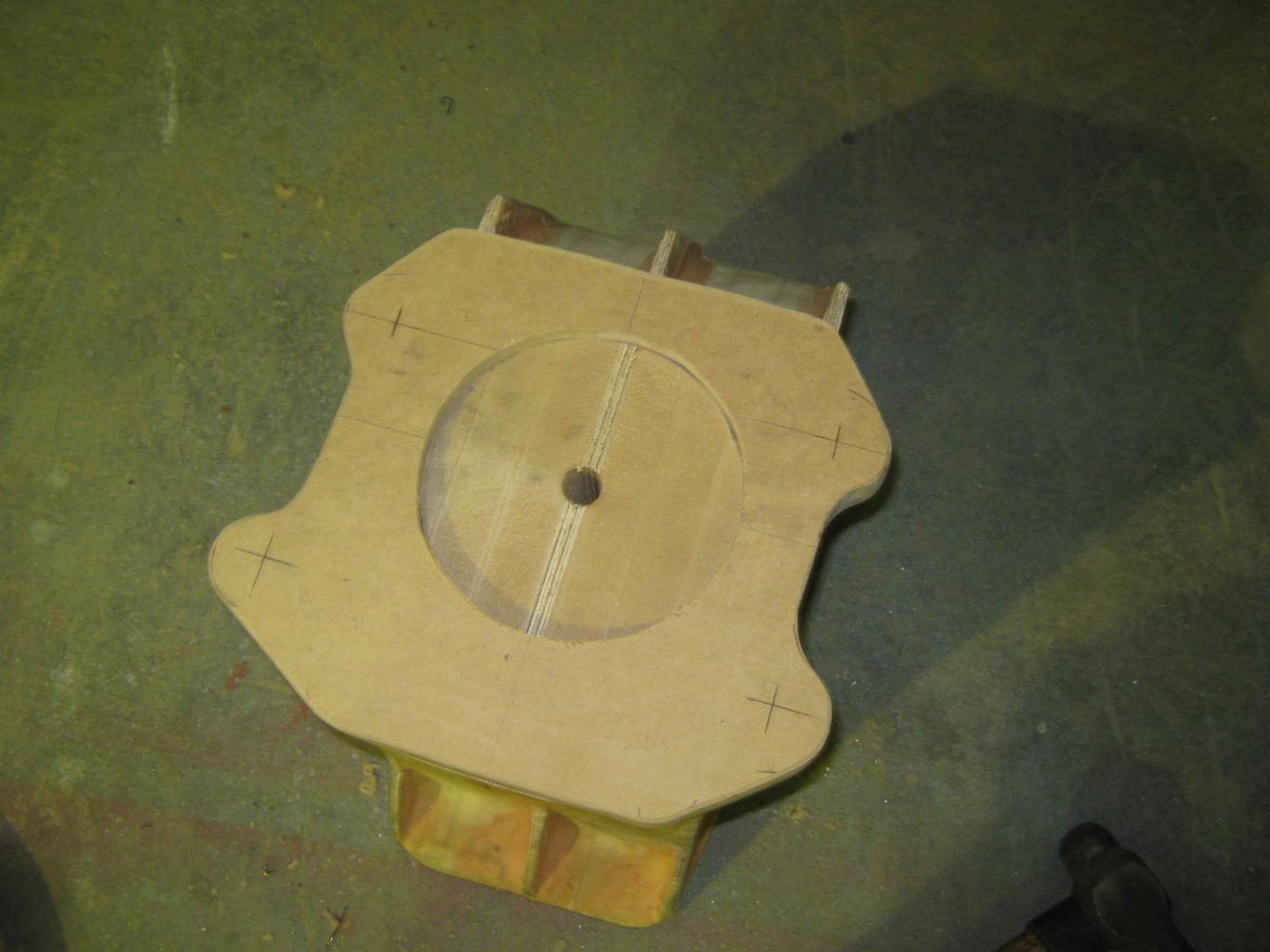

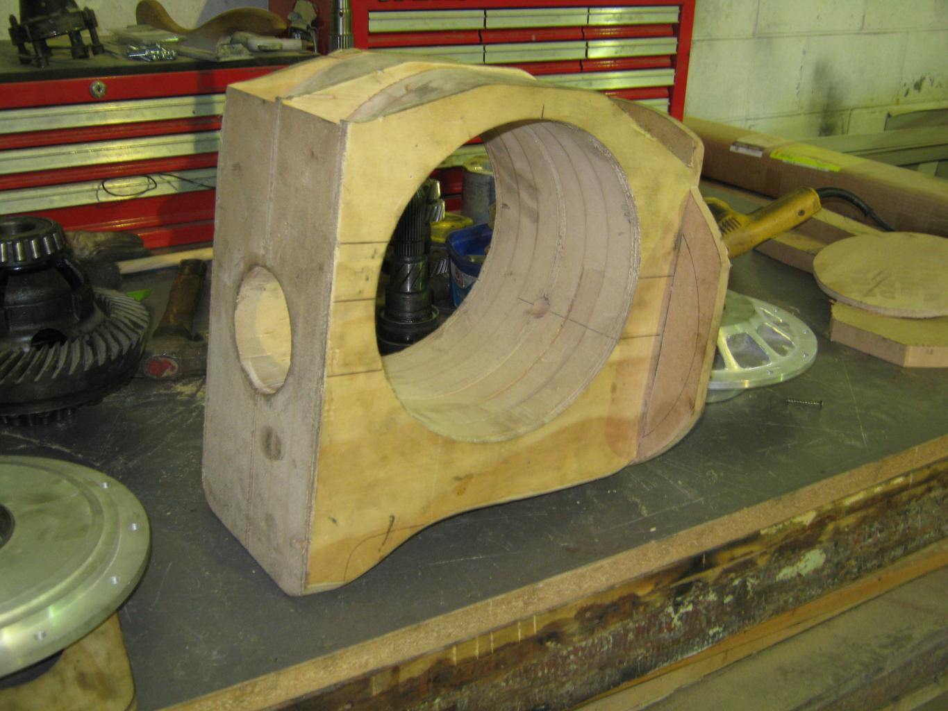

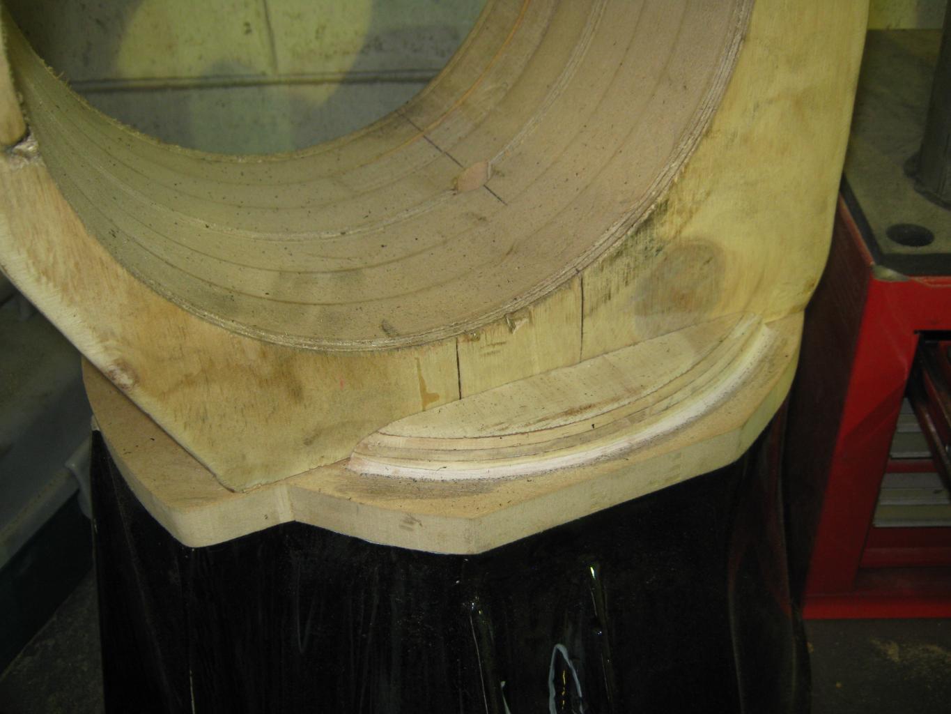

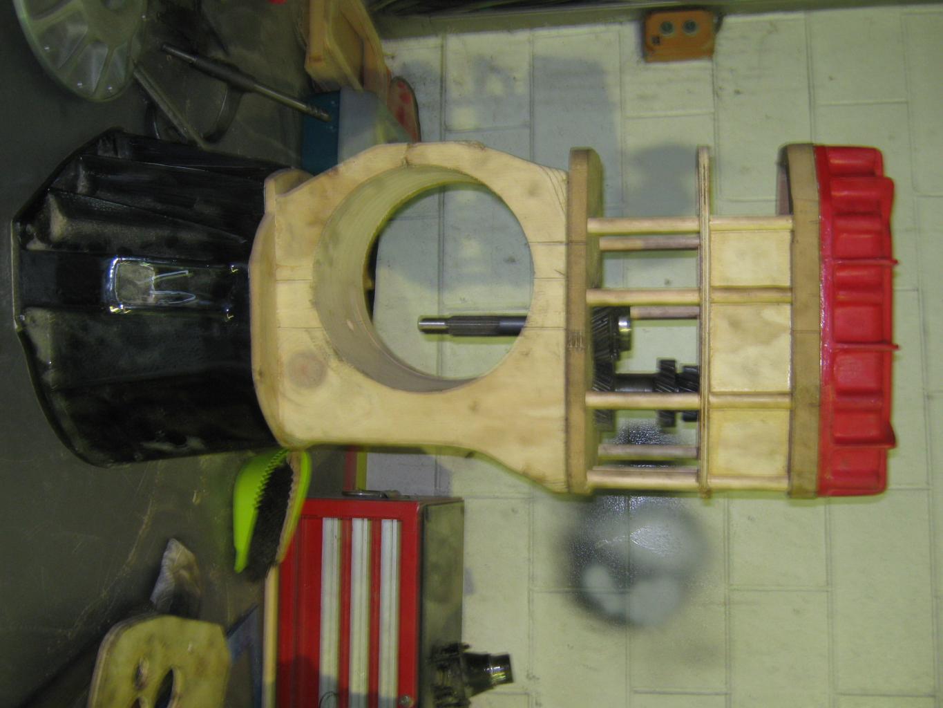

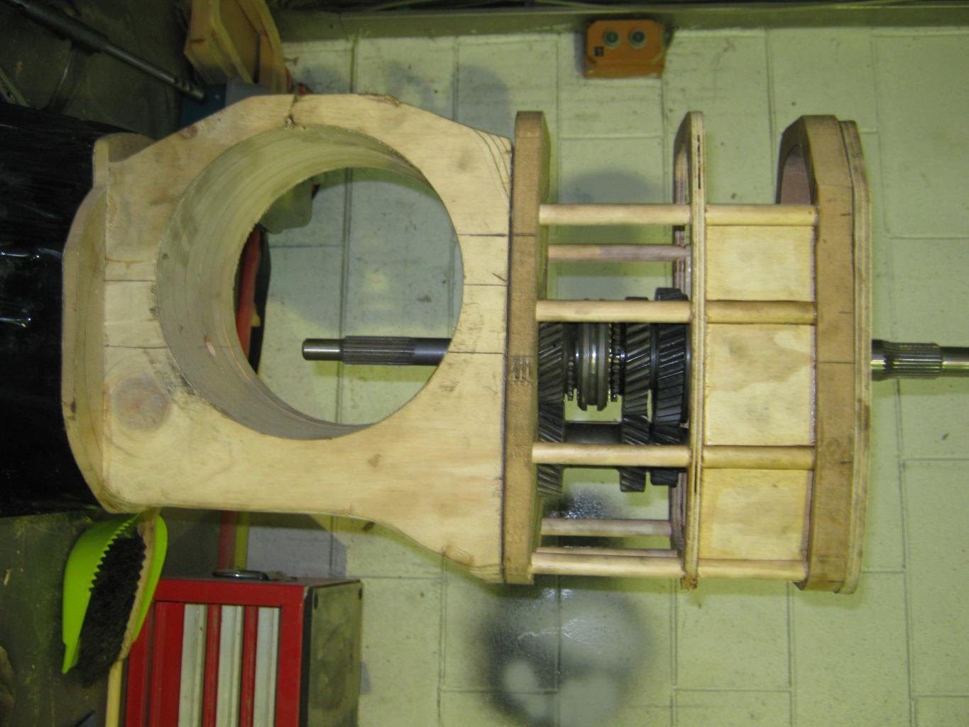

Did a couple of hrs in the work shop today working out selector positions and fitting the reverse idler shaft and gears. I'm now at a crossroad, Casting the diff housing is a given but I'm now thinking for fabricating the gear case. the plan is to laser cut the end plates that hold the bearings then using tube cut to precise length and studs that will sandwich the end plates and then fill in the casing flat plate. My thinking is that the end plates and studs do all the work and the side's main purpose is to hold the oil in. That is a very simplistic view and obviously the side's as such also provide a great deal of the strength. The other option is to continue with the mould and cast the main case. anyway I have taken some photos and hope you can get a rough idea as to where I'm heading. Cheers Leon.

The amount of torsional twist that will be applied to the gearbox case is highest in the lower gears, hard to visualise, but it is there & slightly compounded by the QC gears. saw a graphic example a few years ago when I stripped down a Richmond T10 from an NZV8 with a straight cut & dog box conversion, you could 'see' the taper wear on the layshaft gear teeth to the point of going thru the hardening. Those cars only had 10" wide tyres & ~450hp, imagine what it would have looked like with ~15" slicks & ~700hp:)
So I would suggest casting & include some 'ribs' preferably on the diagonal to brace the casting.
I noticed mention by someone on the ZFQ/RBT thread recently that De Lynn is intending to use a 4 point dyno to analyse the Griffin prior to production, perhaps looking for similar deflections etc in the case design. Its always going to be there & becomes more of a problem with more torque input, depends more on how it affects the operation/reliability of the transaxle in question.
Thanks JacMac, this is the kind of feed back I'm looking for. So you suggest not just running ribs around the case but also from top/front to bottom /rear. the tubes that the studs run through will provide the lateral ribs and I always intended to run 3 ribs around the case vertically.

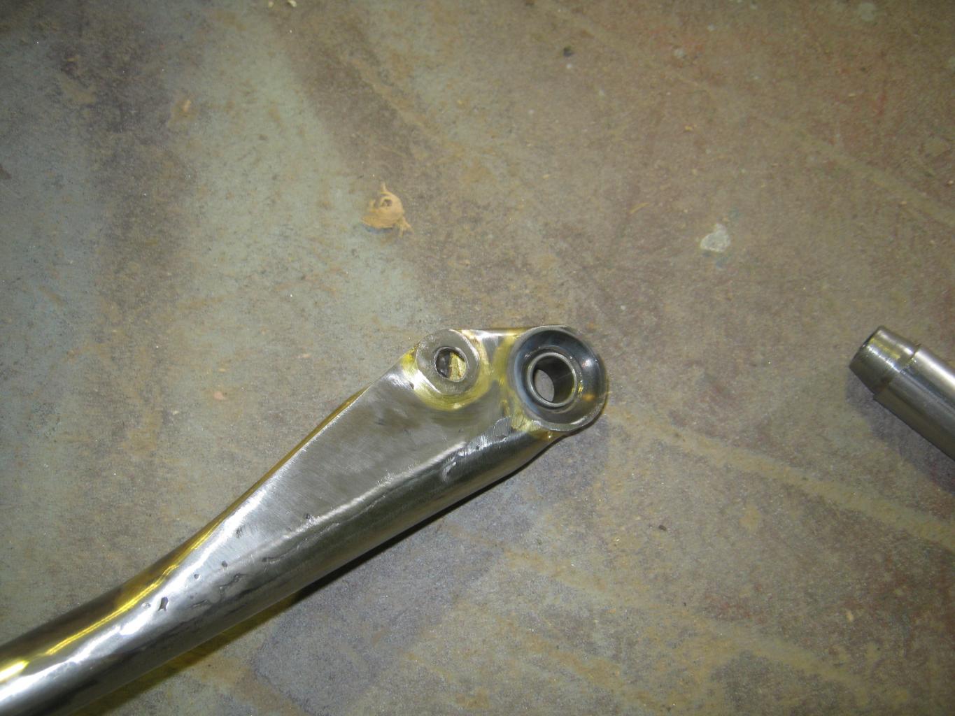

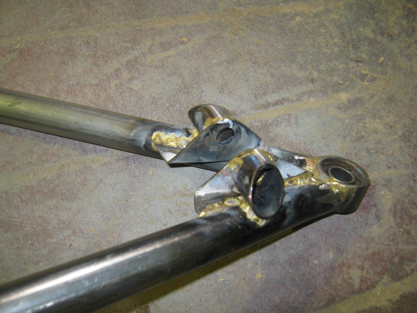

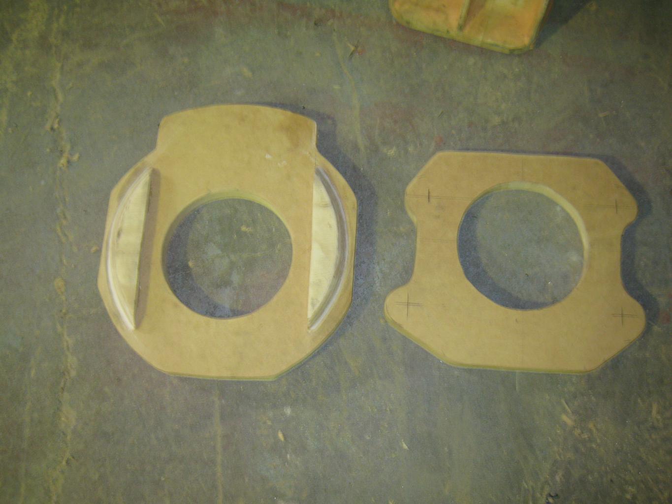

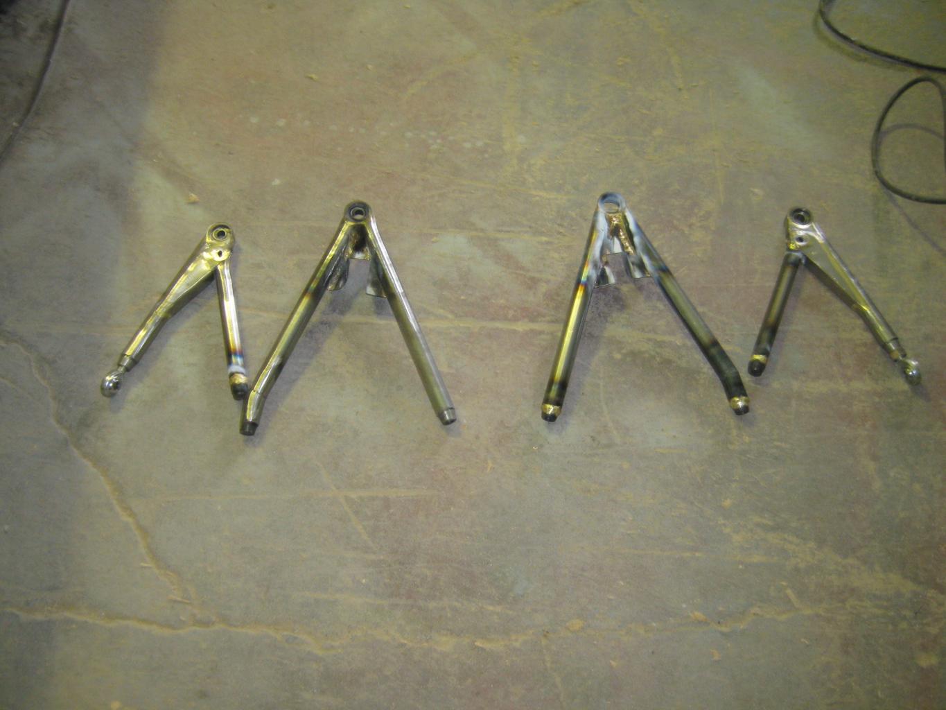

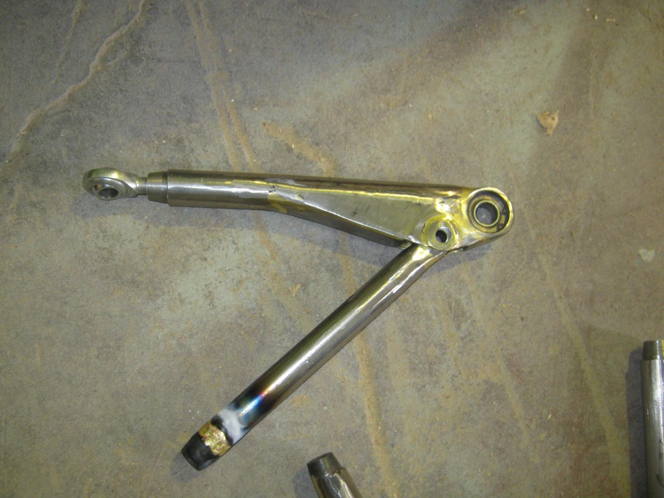

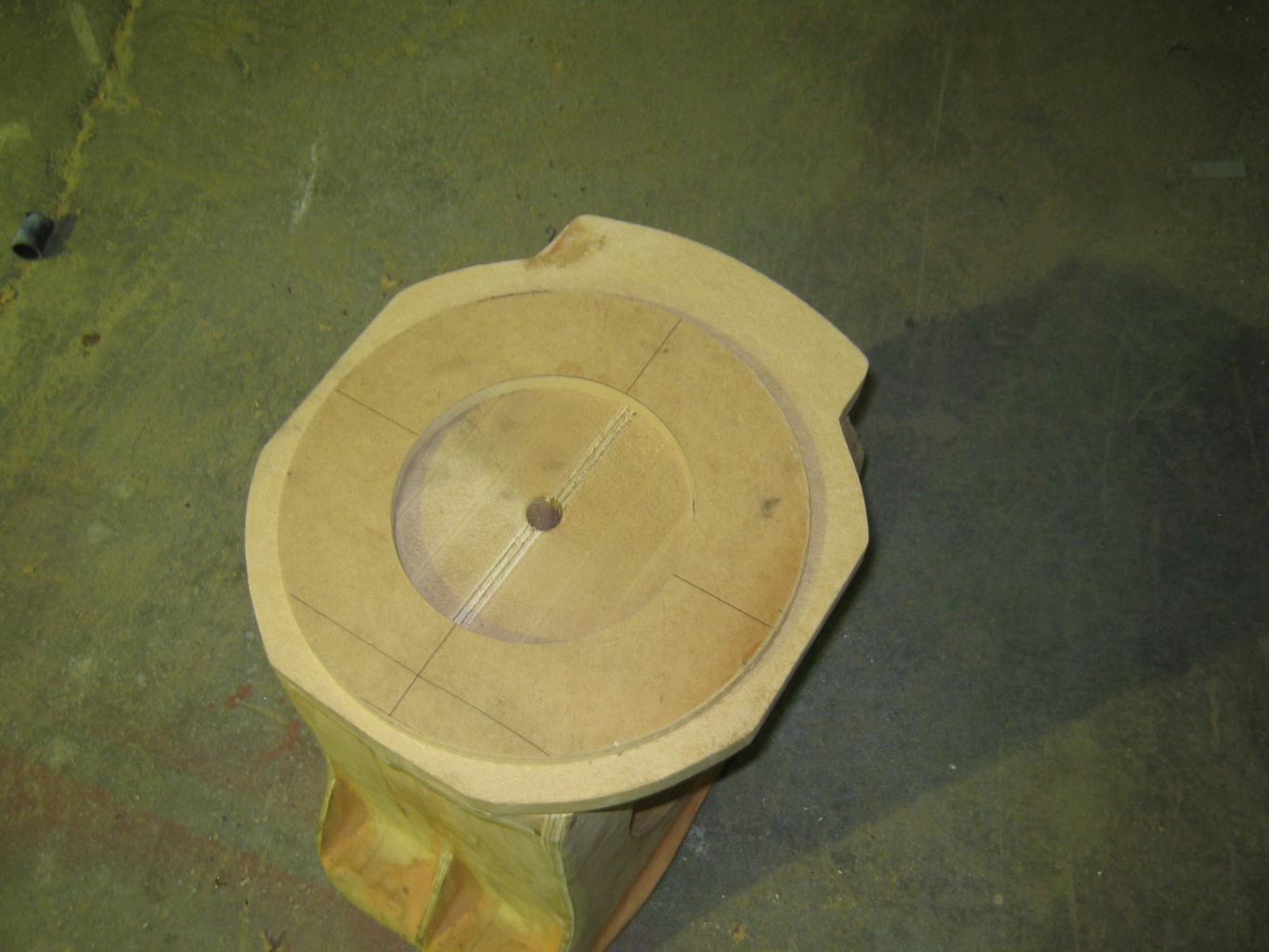

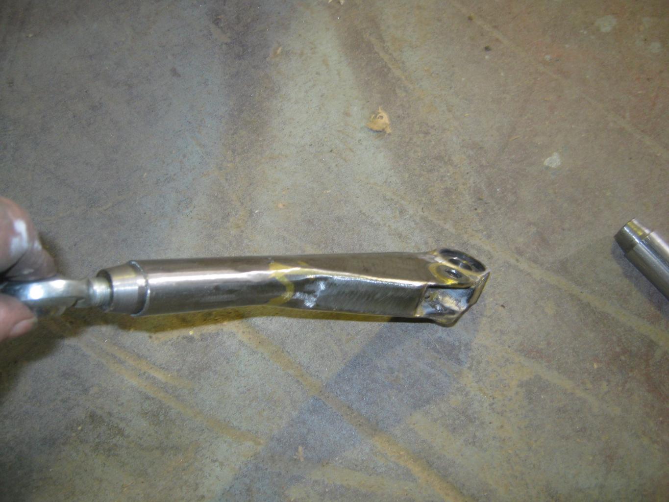

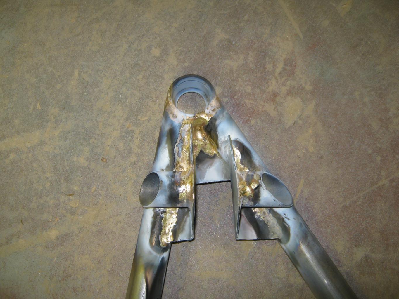

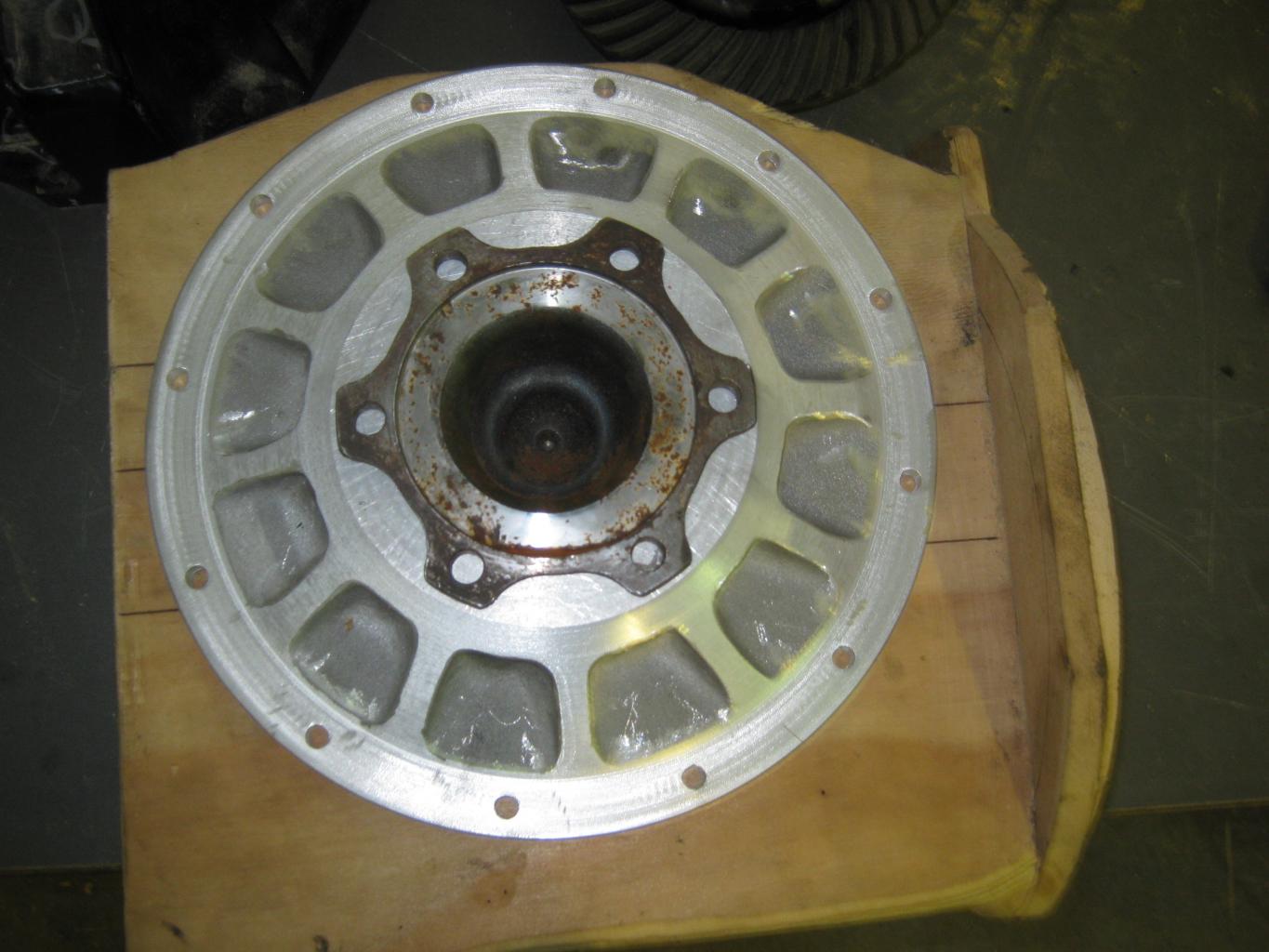

More time in the workshop this week, I have changed the mounting plate on the front of the diff section. I have made it a separate piece so I can cast different mounting adapters on the housing, I will now make a Ford/GM style mounting plate so the T/A can be bolted straight to a stock Ford/GM bell housing. I also made the left side top front suspension arm today. Again I'm changing the front arms to better suit the tub and also to be more authentic. As I work through this project I find myself becoming more obsessed with small details and scrapping things already done because it just isn't right in my mind. when the front is done I'll put some photos up, I also need to start on the brake mounts etc. Just keep plugging away. Cheers Leon.
I have spent the last 2 days in my workshop and have a little more progress to report. I finished the lower and upper suspension arms for the left side and now need to machine and fit the stub axle in the left side upright. The arms now need to be blasted and painted. I have not decided whether to go HPC, 2pack or powder coating, Leaning towards 2pack as I can do that myself, another option is to Nickel Plate them. I have seen some done this way and it looks like chrome without the ill affects of chroming and cheaper any thoughts gladly excepted. I have some photos and also photos of the 2 different mounting flanges that I can cast into the diff section of the transaxle, Will do one for the ford B/housing as well. I'm now off to work for a month so no progress for a while, Cheers Leon
