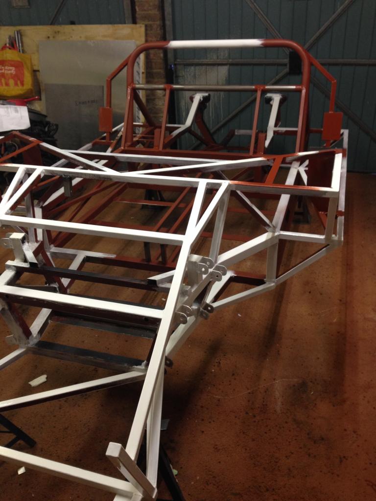

Very nice progress! I like the way the chassis is turning out..
Interesting- in the first photo you can see the words "State Trooper" on a piece of sheet metal. They don't have states or troopers in the UK, so this must have come from over here....
It looks like the rear bumper cover off of a Crown Victoria police cruiser..
Good eye! :thumbsup:
I've order 2.5 litres of a white semi matt / silk metal paint and yes I know it will take 2 - 3 coats but even though most of the chassis is always covered, I wanted a more personal touch !. At least I'll be able to see the oil and dirt marks ;-)
Mine is mostly dust grey at the moment. :)
NickD

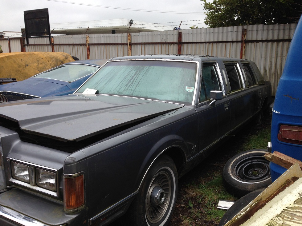

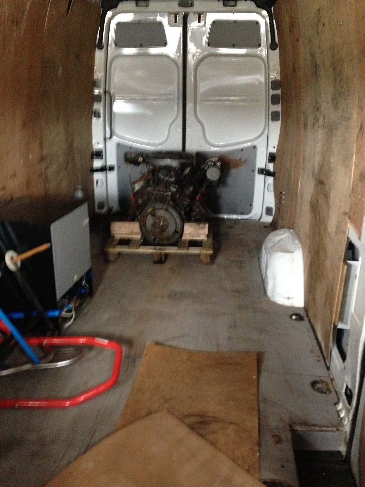

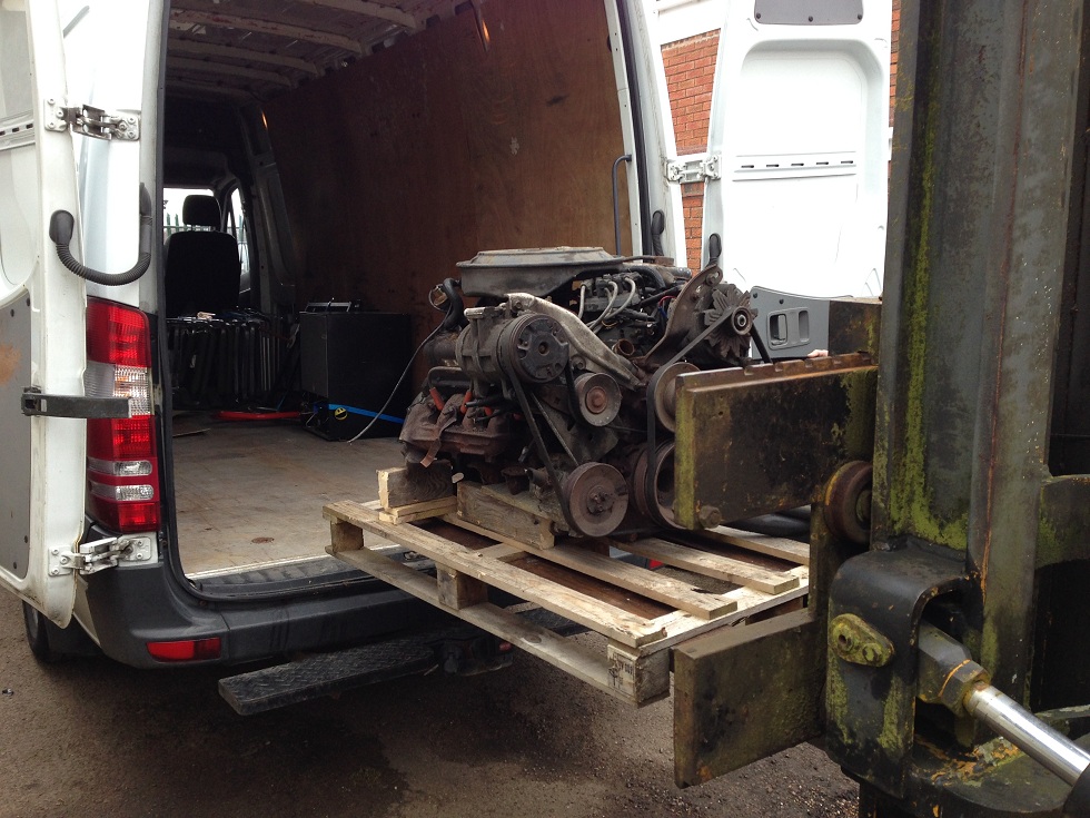

A day well spent Yesterday collecting the Engine which will one day form the core of my 40.
The donor - A 1986 Lincoln Towncar stretched limo - Stock 302 with 84K miles on the clock, engine on the pallet and finally on its way home.
The next time this engine is behind me and I'm in the front seat, it should be powering me along ;-)
Strip down awaits.

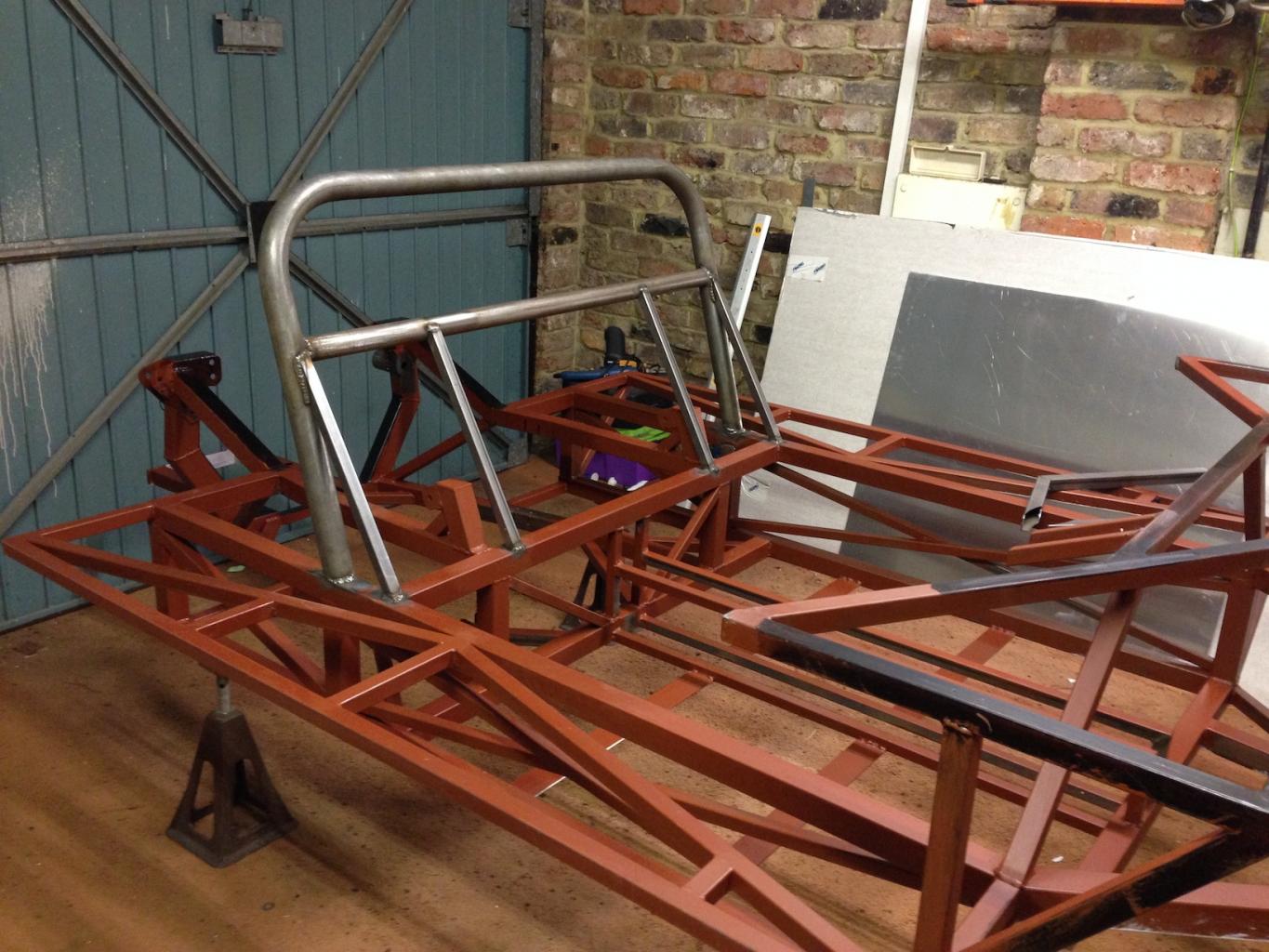

I think I can finally see some light at the end of the tunnel which should mark the end of the first phase - completion of the chassis build.
Spent the evening wrestling with the roll hoop and some of the adjoining components, takes some doing to get that welded in place when your on your todd. With the addition of the rear Stays in the next couple of days and a few final bits here and there, should finish this phase by Sunday.
NickD
Paul,
Its not a patch on yours bud. give me about 12 months and I'll be happier with it. Had the bloody grinder literally blow up in my hand last night - I think air tools from now on ;-)
Nick.

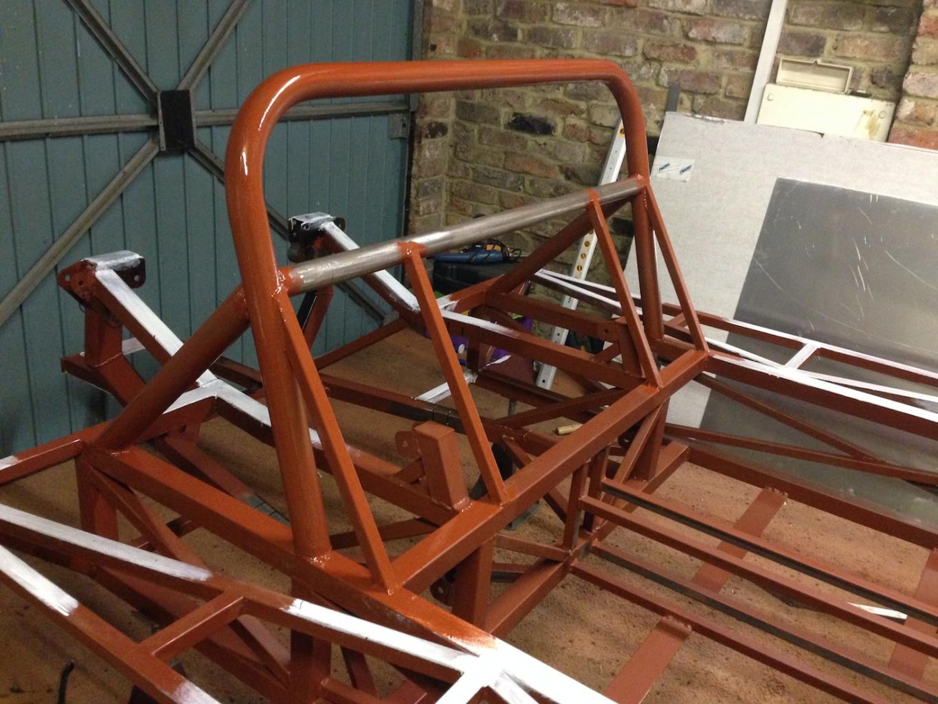

Don't normally work on the car on a Friday night but felt I just had to break the back of the last serious chassis job.
Have now got the passenger cabin roll hoop rear supports in place so excepting a few bits and bobs, I reckon I'm still on schedule to complete the chassis build by Sunday night.
Saturday afternoon always reserved for copious amounts of beer. Even with a project as demanding as this, one has to stay civilised !

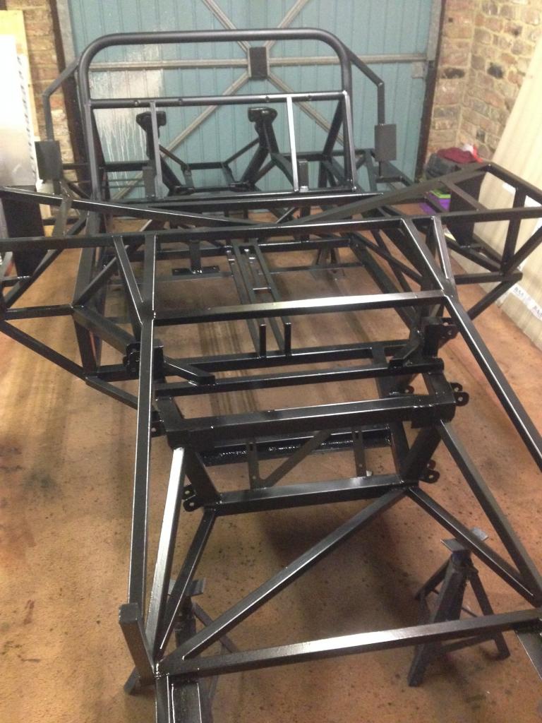

Been a bit quiet on the build front what with Mother's Day etc. almost completed the chassis paint and just began to hate it in white, so it's going back to satin black. So that's the best part of 8 hours work wasted. ;-(
NickD
Well after what I recon to be about 80 hours of work, about 60 of which were productive, I can finally say that the Chassis is now done.
Taken, 2 months part time but I'm well chuffed with the result. Biggest benefit is I know exactly how she is built from top to bottom.
Next task the floor pan and panelling along with brake lines.
A big thanks to Darren at GT Forte for the great kit and support and everyone else with comments and advice to date.
