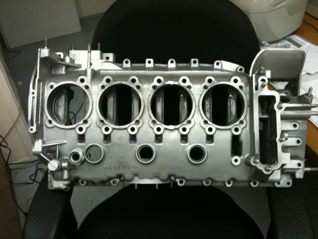

I don't know if this is of any interest but I have started to make a flat 8 engine for a 908 replica by wire cutting two 2.6 6 cyl crank cases and welding them to make an 8 cyl crank case. Case now welded and we are setting up to line bore and surface the decks prior to crankshaft manufacture.

It´s a chain driven overhead camshaft. The holes are just for the oil return pipes, for this three should be plenty.
The camshaft case could be made up the same way as the crankcase(weld is done in the center of cyl 2).
The more interessting question is, what about crankshaft and cams. Need to be done on a on off basis.

My cams are in work as we speak, crank should start shortly once the block has been fully machined. We manufacture horizontal fan bits already so i will modify the design for these shortly to allow for the longer crank case etc. Mecanical injection pump is being stripped and readied for reco.
Tom, we trialed about 3 blocks to get the most accurate way of fixturing to allow for the shrinkage of the magnesium while welding. Shrinkage between bore centers from one end to the other varies by about 0.1mm so nominal design components work OK. Yes the cam boxes are manufactured the same way.

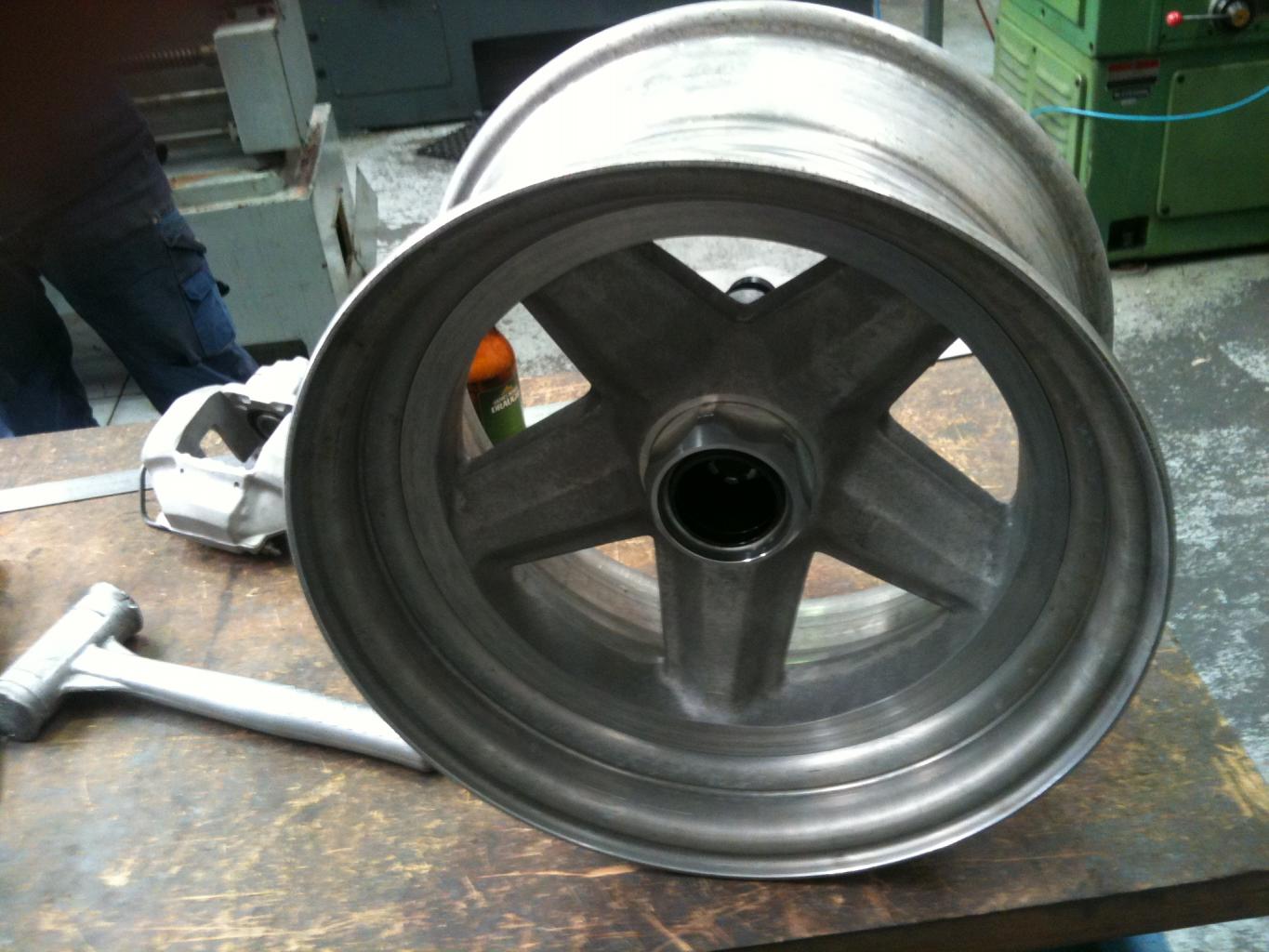

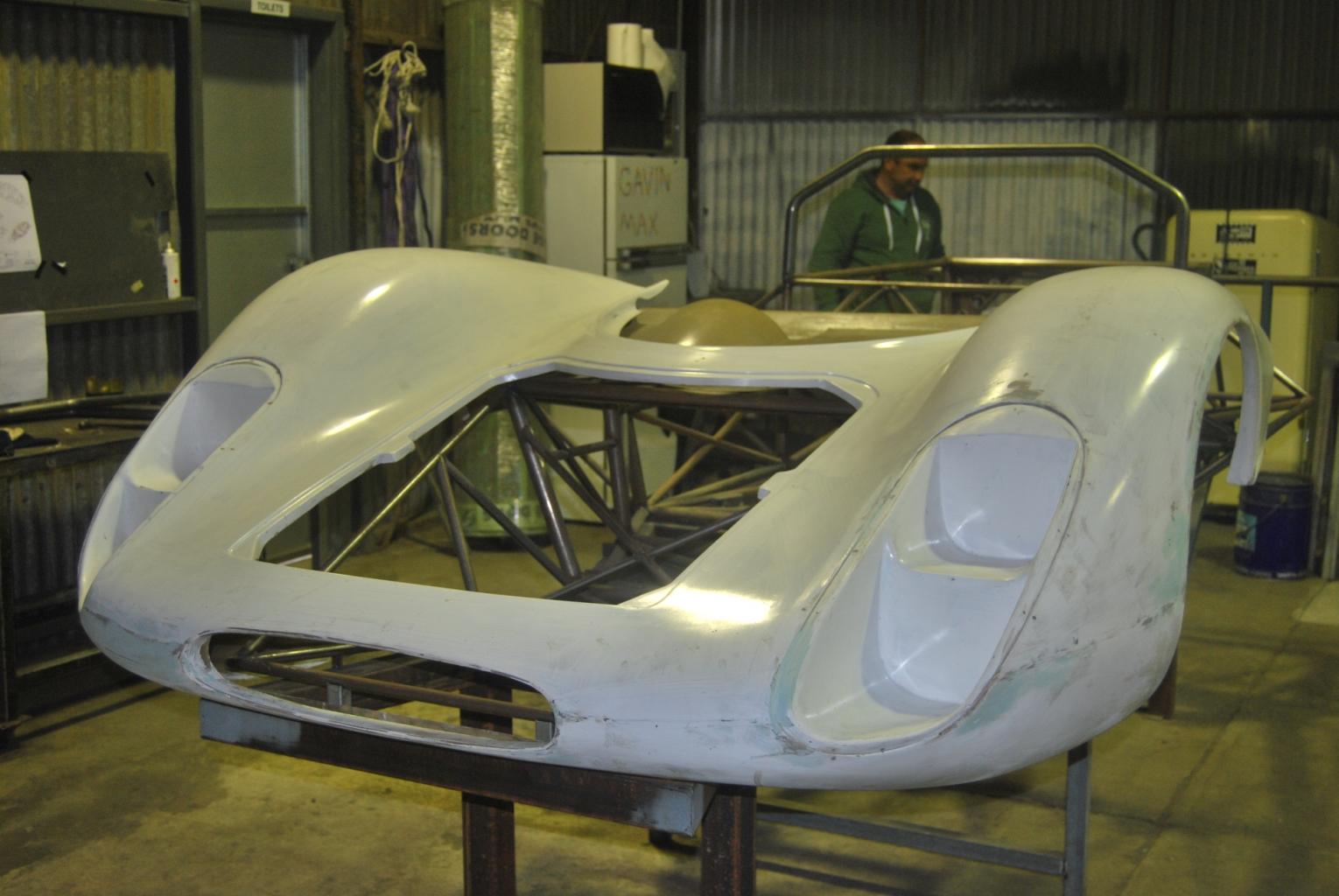

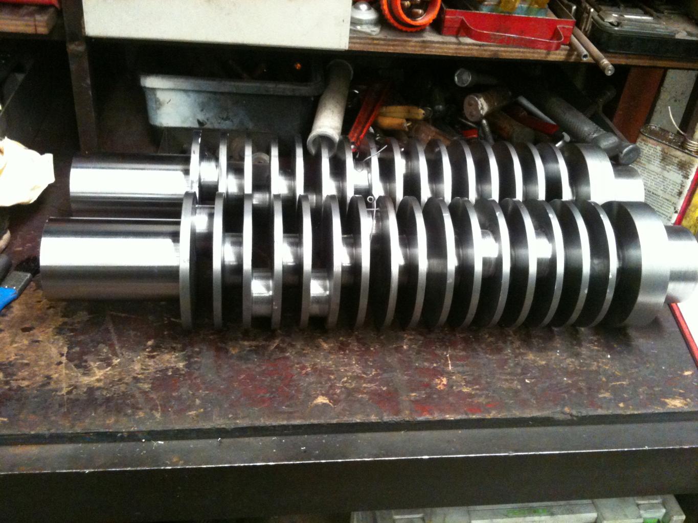

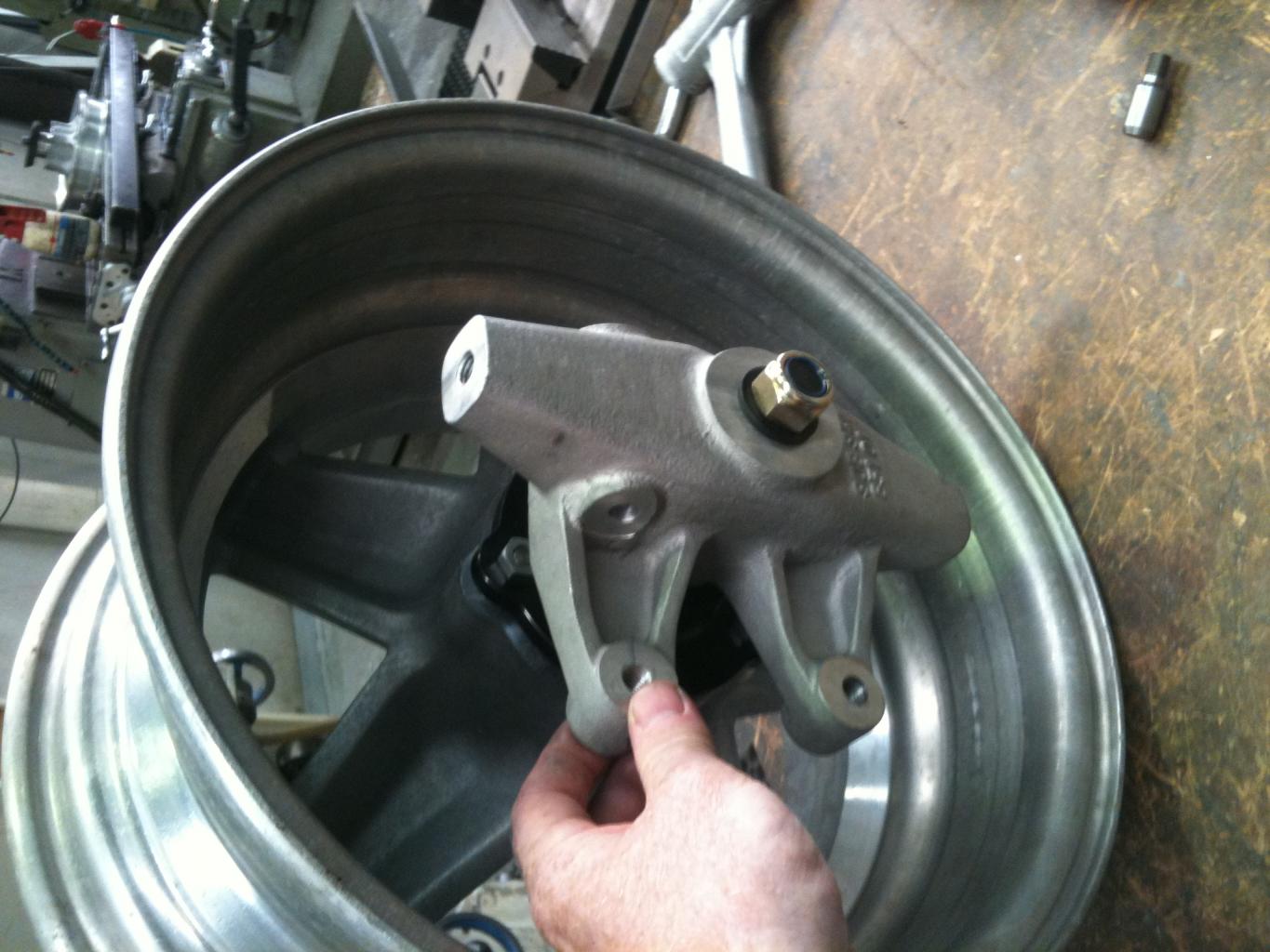

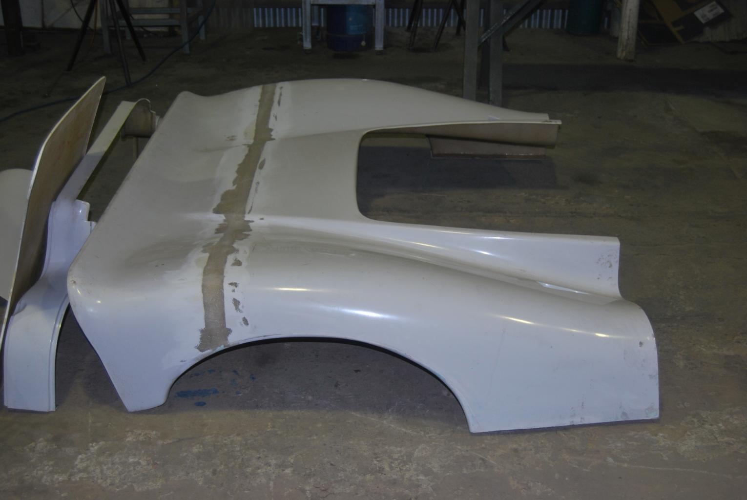

FYI crankshafts nearly completed, chassis about 85% . Short tail body, wheels, uprights etc all done..... bit more of a long term project than first hoped.....
