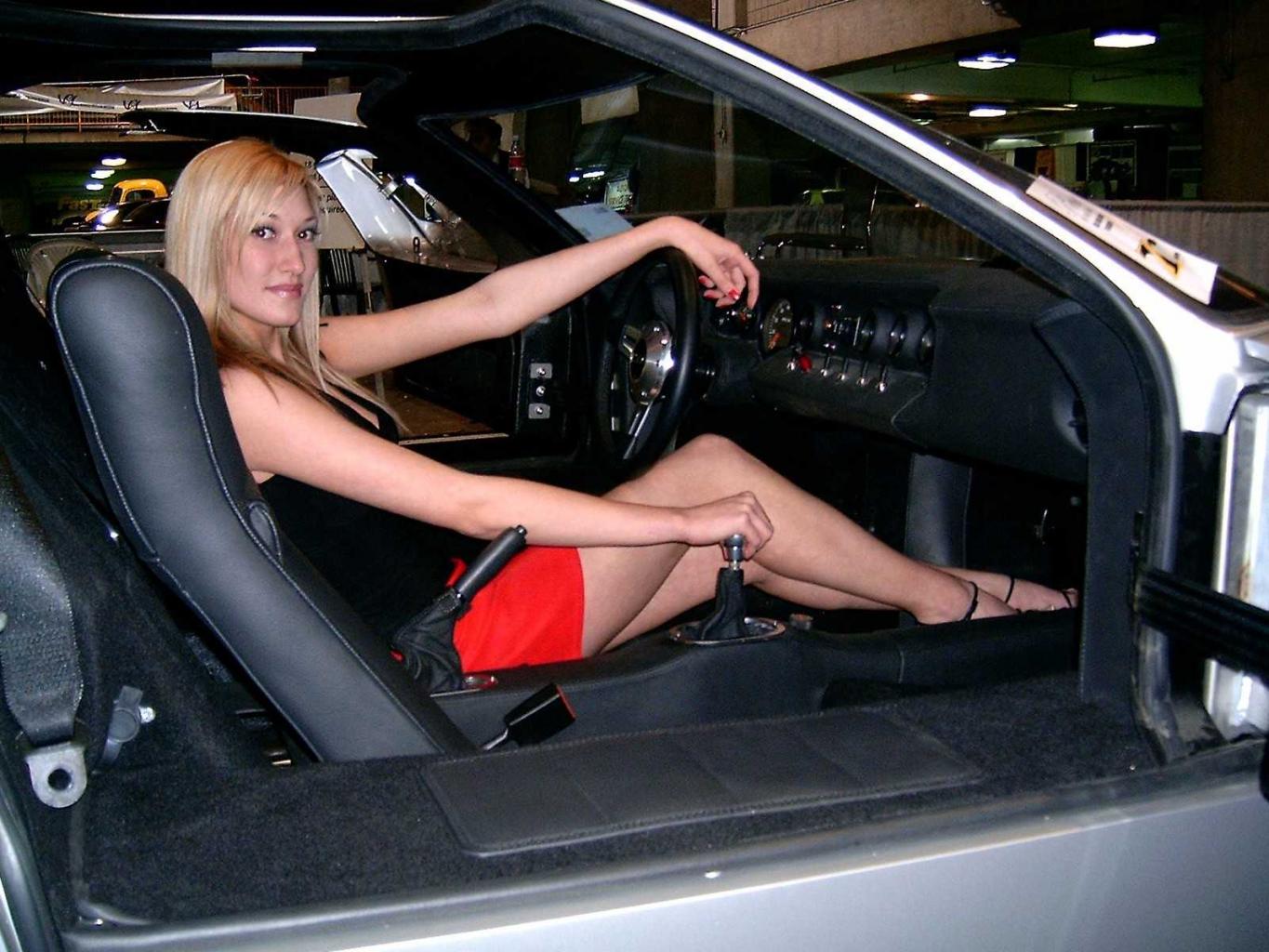

Your passengers just need to have smaller feet......size 7 high heels fit just fine.....
