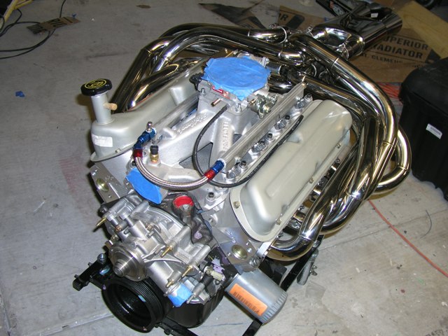

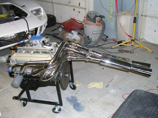

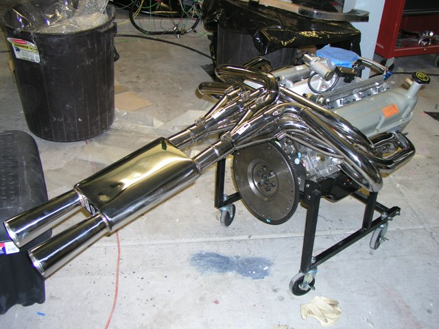

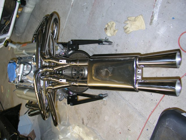

Guess what I got? Looks good, eh?
Cltuch disc, press plate and alu flywheel and bellhouse on the way from Dennis at Pantera Performance (303 660 9897). Should arrive this weekend. I could theoretically have the drivetrain mounted (but not permanently installed) this weekend!
The special shiny bits came with the deluxe kit and I must say they look fantastic on the motor!

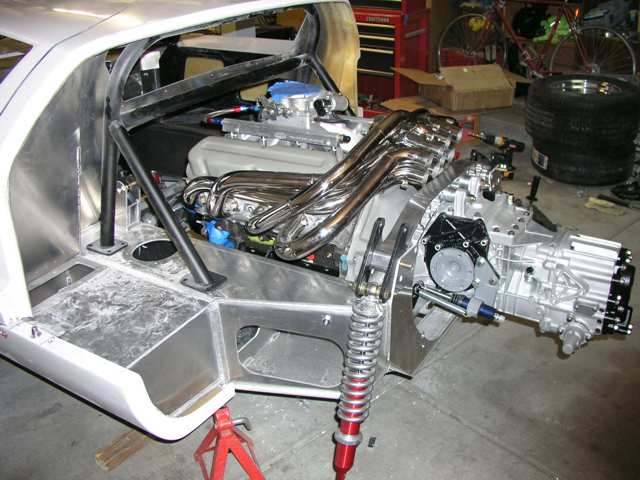

Bellhouse arrived today, I have the drivetrain bolted together (no clutch in the house though) and will be putting it into the chassis tonight! Unfortnately I can't upload a pic here but will when I have the chance. It looks great all together.

Hi Chris - Great progress!!
Don't forget to use the pressure plate alignment dowels. They come with the Pressure plate bolt kit from Ford.
Also - Don't forget to use a sealant on the flywheel bolts. I use liquid teflon thread sealant myself.
I see you have the Ford Explorer front timing cover, harmonic balancer and water pump. I was thinking of using this configuration as well to minimize the size of the bump needed in the firewall.
Are those RCR Headers? Could you get a closeup of the collectors?
I think I've already bugged Fran about this but forgot the answer - I'm wondering if the same headers for the ZF will work with the G50?
Thanks! Keep up the good work and keep the pics coming! :)

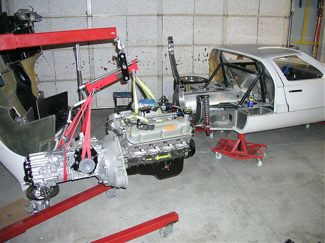

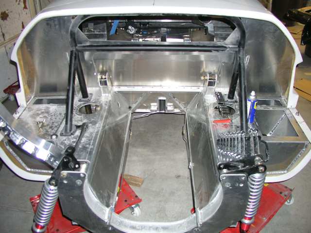

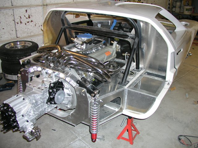

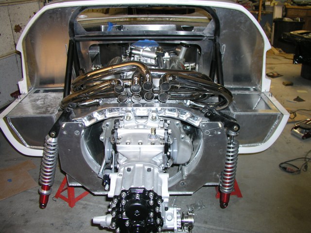

Pics to follow in the next couple days but the motor and trans are IN! Things went very smoothly with one exception: in cutting the clearance for the starter I cut right through the hard brake line on the opposite side of the chassis wall. Other than that, things went really smoothly. Started about 11 and finished around 430 (solo). Lots of setting it in, marking the wall, trimming the chassis, and repeating but I think it's good.
The headers are the RCR ones. I don't know if my set will clear the G50 but I am quite certain that Fran has them available. Best to chat with him directly.
I have the 6007-XB3 long block from FMS. I didn't know for certain it'd be short enough on the front but it looks like it'll fit pretty well actually. I don't yet have the pulley set figured out so I'll reserve my opinion for later but so far so good on the clearance front. Looks like it'll need a very small blister if at all (but like I said, wait til I am through with the pulleys).
Bolting things together was extremely easy though. I don't have a clutch in there yet. I needed all the pieces together to get through the cage build. Motor's in, headers are on, it's time to put it all back together and start bending tubes. Stay tuned for more pics.
Should be back on its feet by next week and will start looking really good soon.

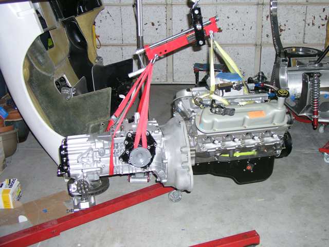

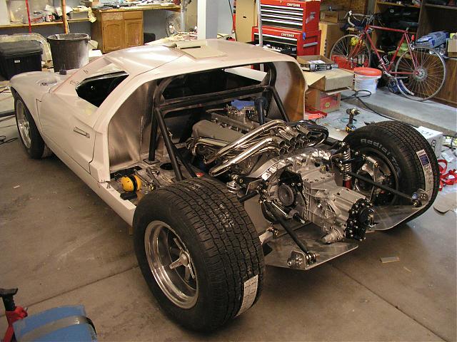

The pics...

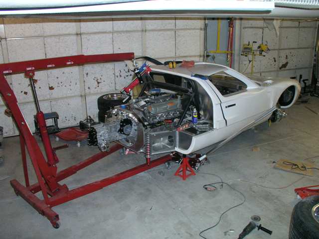

With the motor and trans connected and hanging there on the hoist, I had a flashback to the gazillion models I had built as a kid (and no-so-kid) with a drivetrain ready for install. This "kit" has the benefit of being much cooler and totally practical for later "display" as well.
It was a great feeling after the many trial fits and re-fits. I didn't want to cut too much from the chassis to make it fit and have a huge hole. I now need a starter to ensure it's all good.
Regardless, it looks great and once I get the suspension re-hung it'll be off to get a cage built.
Ah, progress!!!

Chris - fantastic progress!!
It looks like you may not need a firewall bump at all with the short Explorer Water pump and front cover!!
Please let us know if that is or is not the case!
Re: Rcr40-31
BTW - Be ***very*** careful of the Jack-Stands on the Wheel-Skates thing.. I had a Cobra fall using the very same trick. Un-even spot in the floor and one of the stands came out from under the car, when the car stopped rolling - it tipped and literally SPIT the two balance point jack-stands out from under the car as it came crashing down...
I was rolling it very slowly as well so I was being careful when it happened. The jackstand that came loose was still under the car just not under the frame so I did not see it out of position..

Yeah Randy, I did it (carefully) to get the car in position and if you look closely at the other pics (taken later in the evening) you'll see I pulled them out.
Thanks for the note.
I'll keep you posted on the firewall cover.

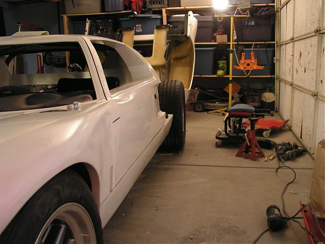

Been a while with the updates...
I too went with the +2"/side rear flares. I was chatting with Fran about how I was bummed that I didn't flare the car now that I am going to be painting it (instead of gelcoat for a while). Unfortunately the lack of road rubber was also still holding me back as well. He launched off into a conversation of how he just finished developing a wider rear suspension package... 295 sized rears, 2"/side flares, all the curvy bits without the hassle? Done. He told me to send him some bits and a check. 4 hours later, everything was in the mail.
I got the bits from Fran got them mounted up over the last few days. I've actually been out of town for ~2 wks, had family in town another week and am finally getting back in the groove of it. I worked through RCR business hours and had a question or two and was able to work it out with Fran the next morning. Install was fairly straightfoward and simple.
The pics don't show much as the angle isn't right to highlight it. I have subsequently reinstalled the rear clip and it's going to look fantastic. Flares are still a few weeks out for me but I have the car ready for cagework at this point. Now waiting on the cage builder...
