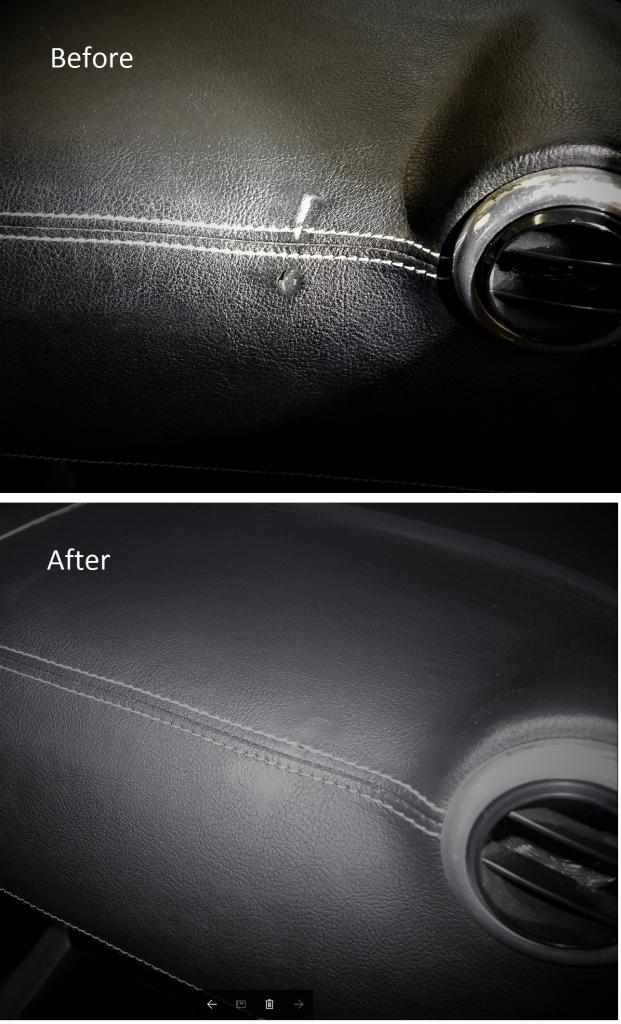

Something strange happen to my SLC this past Saturday, and it could happen to any of you. I took my SLC to the annual Ray Evernham "AmeriCarna" Cruise-in. You may have seen Ray's AmeriCarna TV series on the Velocity channel.
Anyway, I arrived at 11AM and it was a cool 50 degrees with a bright morning sun just peeking over the distant tree line. I parked my SLC with its butt toward the rising sun and a crowd of spectators began to gather around it. I was talking with a fellow motorhead when suddenly a kid in the crowd yells...
:pepper::flameon::pepper:Your car is on fire!:pepper::flameon::pepper:
Yikes! The passenger side of my dash was smoldering and smoking up the cabin! There are no electrical components or wiring in that area, so what could be the cause?
The sun was behind the car at a low angle and was reflecting upon the lexan passenger side window. The side window is shaped like a parabolic mirror and it focused the sun's rays into a small hot point on my dash. Kinda like burning ants on the sidewalk with a magnifying glass.
I had the damage repaired today. The repair isn't perfect, but it's passable.
Lesson learned: Don't leave your SLC doors open if the sun is behind your car.
