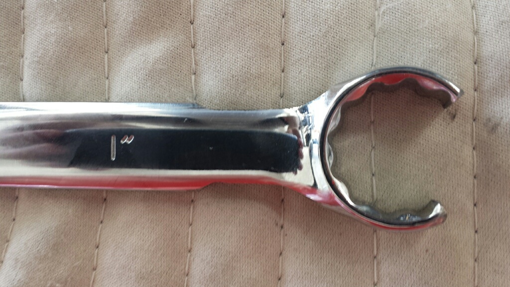

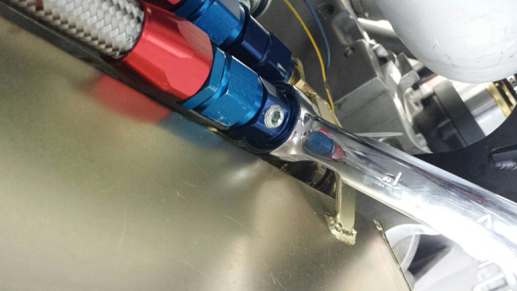

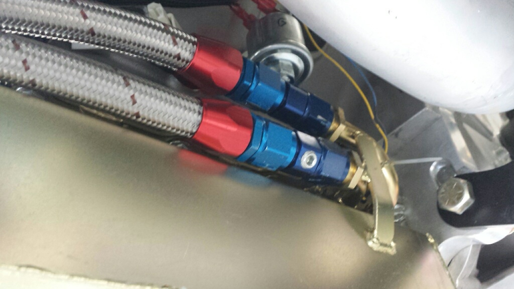

In the process of tracking down the oil leaks around the pan I noticed I had not been able to tighten the oil lines enough due to limited access. Had to re-appropriate a common box end in order for it to serve a higher purpose. No more leak there, although I do have the main culprit as of yet unresolved. Got it clearly identified, with a little effort should have it sealed up next week.

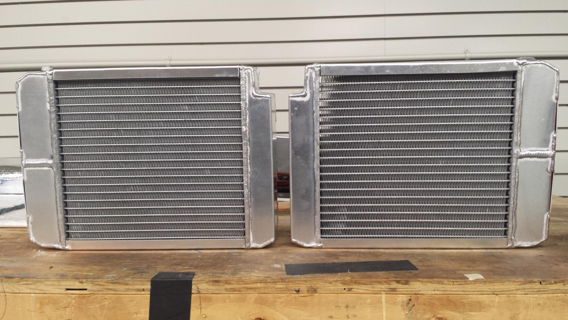

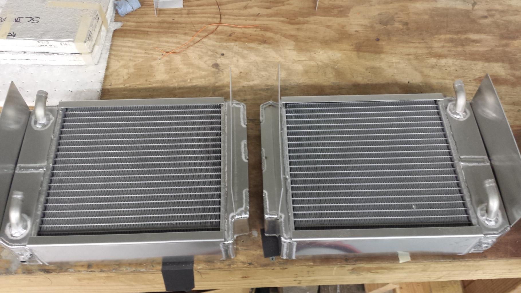

OK got a little something to talk about. Been away, and away from the build for awhile but now should be ready to do some damage over the holidays. Intercooler radiators, finally here.

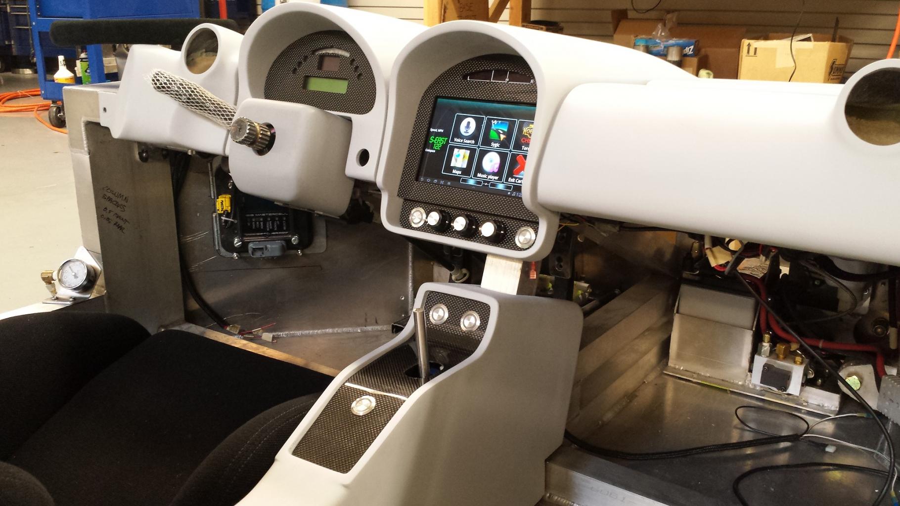

A question on carbon fiber sheet in another post reminded me of this carbon dash cover work, cut to spec. Not the most modern of knobs, I will keep my eye out for better looking ones for sure.

Great job on the dash!
I see the right control stalk is missing.
Is that a custom steering column cover as well?
Thanks.
I pulled the right stalk because it was seriously blocking the center display, plus with the small wheel it looked way out of place.
Yes, the column cover was scratch made, details are available earlier in the thread if interested.
On the intercooler radiators, i dont understand why the tubes are so small in the radiator? Are you running a water cooled intercooler? Thats what I have but my intercooler had 3 inch holes for the boost piping.
The dash looks great, very nice job.
I think those are the engine water radiators. From the previous posts it appears he is running split radiators ahead of the rear wheels rather than a radiator in the nose.
It appears to me that he is indeed running water cooled intercoolers. Those are the radiators to cool the intercooler water. Lots more involved than air to air.
Water intercoolers - I was frustrated to find no one that I talked to had a formula for proper cooler size when it came to these parts. All said "as big as you have room for". These may be overkill, particularly because the internal supercharger heat exchanger is relatively small. Seems like it may have been (some) waste of space in an already tightly packed engine compartment.
Switches- Yes they light up and are on a LED dimmer. I am really looking forward to when I can light up all the interior at once. It is done in an all red theme (like my Audi) including the overhead. In test I found it near impossible to read anything in red light so there is a white overhead light as well.
