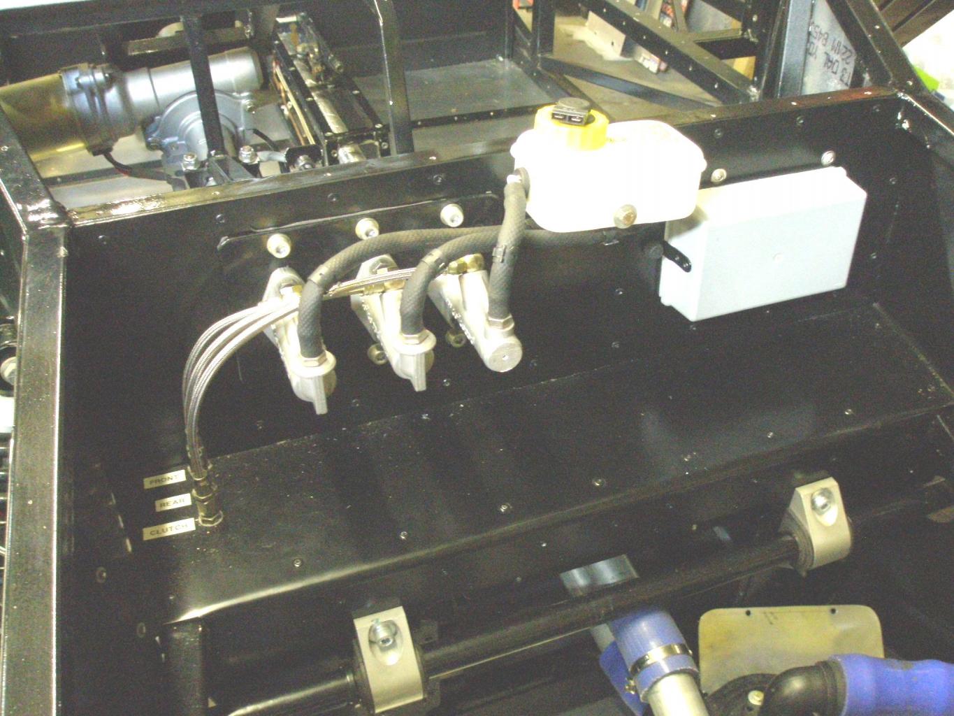

Well progress has been slow of late but I have got a bit done:
Fitted some fibreglass panels each side of the dash to seal the fuel pipes from the cabin (IVA requirement) absolute sod to get them them fitted and involved lots of swearing but got there in the end. Into these I have mounted access panels and the fuse board.
Spent ages on these parts and then realised they will never be seen when the dash is in :rolleyes: but I know they look nice...
Also got the steering column fitted including FIA quick release boss (just like a real racing car) :laugh: which in turn has allowed me to start to position the peddle box, I think it is about right now, trying to get it as far to the right as possible to straighten up the driving position.
Once the peddle box is in it will be time to start wiring and plumbing, should be fun!

Hi Paul,
Excellent progress, it will soon be on the road. Regarding the positioning of your fuse box, you might want to re-consider the access to it. It looks OK now, but once the dash is fitted and the face vent air duct runs over the front of them, trying to change a fuse on the side of the road could be a bit challenging. You will also have to a ensure a tight seal seal around the harness to prevent any fumes entering the cabin area.
I mounted mine on the front panel, which gives clear access and the harness then runs on the inside of the chassis
Andy

Cheers Andy, Dave also pointed this out on my PH thread and after a visit to SGT I can reassure you all I have made a great big cock up and indeed it will not work where it is:furious: Looks like I have a bit more work to do, and it looked so good too....:sad:

Well progress has been very slow of late as had a lot on at home but I thought I would post a small up date...
Got the pedal box in its final position and bolted in place
I was struggling to fit the wiper motor as since the chassis was designed IVA decided the fuel pipes had to be enclosed, This was got over by mounting the fibre glass panels (where I mounted my fuse board) to seal them off but that also took up the mounting place for the wiper motor so a bit of adaption was required and a new mounting plate welded in.
Managed to pick up a Moroso sump and a Performer RPM intake manifold too, a bit grubby but after 20mins of bead blasting it came up quite well.
And last night I stated to put the front panels back in and enclose the pedal box. I have decided to move the fuse box and relays under the bonnet too, they will be going on the right hand side with the washer bottle mounted between them and the pedal box, I have had to order some new bits to make this work relay and fuse holders etc as I want the wires hidden behind the dash which hopefully should keep everything accessable as well as looking look clean and tidy too, I may even get a nice alloy washer bottle..
Unsure whether to fit the angle trims I made around the pedal box or not, sometimes I like them and sometimes not????
I like them round the peadal box Paul - nice monkey BTW
What do you plan to do with the area next to the pedal box? I am going to try and make (or get someone to make a custom box), so I can take in and out for tools/small luggage etc
Hi paul, question about the foot well on #126 the 6th picture. The seat to pedal position looks like your leg would hit the alloy panel when you press the gas pedal. Is that the correct way to look at it. Nice work for sure though. Brian
Thanks all, Brett I will pass your regards onto Monkey I'm sure it will cheer him up as he's been looking a little deflated lately ;o)
With regard the pedal position it's fine when seated in it and is a good as I could get it between space for the pedal and pedal offset, a lot of time went into deciding this...
