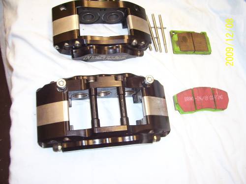

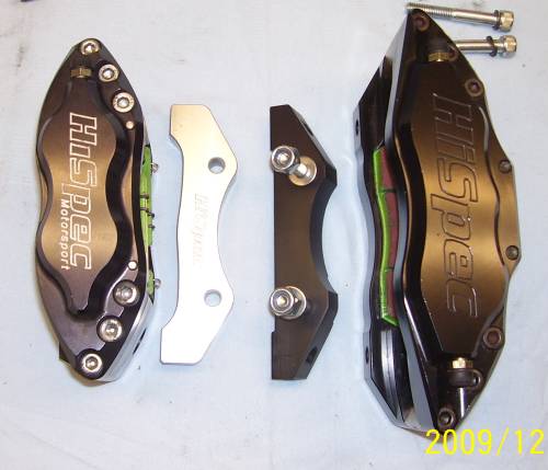

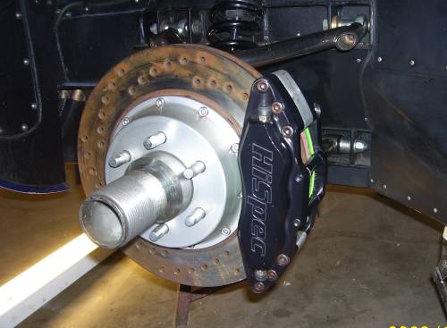

Brakes first. I had HiSpec four pot front brakes and thought that I could do with extra piston area to improve the brake effort. This could have been some new four pots with larger pistons or try to find some six pots that would fit inside the 15” wheels. In the end I found a pair of HiSpec ‘Monster SixPot’ callipers that gave about 30% more piston area and pads. After lots of temporary mounting and measuring I established the dimensions for the calliper mounting brackets and machined up a pair from billet and had them anodised black to match the callipers. I was not convinced there would be clearance for the stick-on wheel balance weights, in the end there was about 10mm clearance at the calliper. I need some track time to get the brake bias just right.

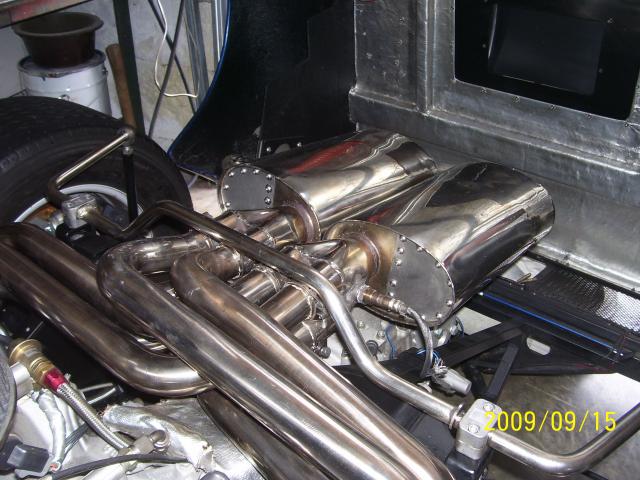

Taking the exhaust was next. I stripped the whole system after noticing that some of the pipes ran very close to each other and were chafing due to harmonic resonance. In fact when removed there were clear rub marks. I tried some twisting and bending without success; so re assembled the system and identified where extra pipe was needed or where a bit removed would result in greater clearance to avoid the pipes chattering.
I decided to replace the manifold bots with the 12point ARP type that allowed a better tightening grip. I also cut individual gaskets out of some specialist packing sheet. It is a three layer material about 1.5mm thick with a thin bronze sheet between two layers of the graphite sheet.
I refitted the system after the pipe adjustments. A major improvement even the engine efi ran smoother due to the better seal!! However in the new relative quietness yet another vibration could now be heard in the silencers. Oh deep joy.

The drive to checkout the new six pot brakes has given a reassuring result. There is some work to do in fine tuning the bias, but the the brakes now feel very reassuring and positive.

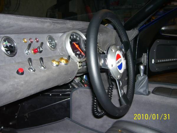

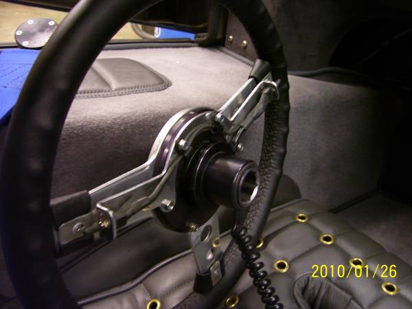

In general driving I have found the need for a headlamp flasher and missed having an intermittent wiper. At night I was too late reaching the headlight switch for a quick flash signal.
I have made up a set of switches behind the steering wheel for main beam flash, wiper single stroke and washers. The wheel is removable so there is a curly cord and plug. It is all wired via relays to allow low current loads and prevent back feed to other systems.
It all works pretty well, here are some pics of the layout

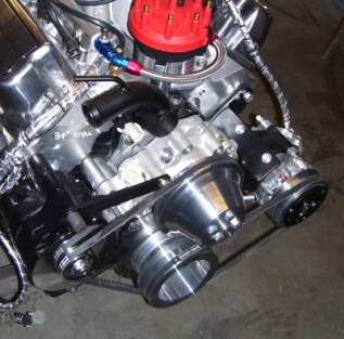

I eventually found a great guy to set up the efi Edelbrock system on his rolling road this improved the running but highlighted the exhaust backpressure was causing problems at low revs with the Comp cams( XE282HR).
The silencers have been disembowelled and re piped inside and the internal baffles opened up to allow the whole silencer to be reshuffled from one end.
When everything is refitted a rerun on the rolling road for final set up is something to look forward to. John Sleath is a top bloke, he runs a road legal Audi at 7.68seconds for the ¼ mile

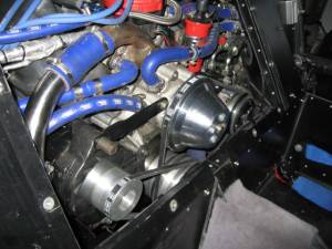

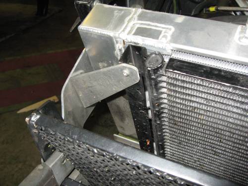

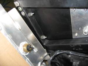

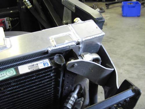

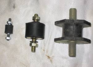

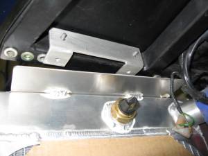

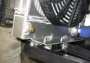

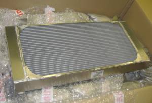

I have just been in touch with Docking the radiator makers. My new item was due to dispatch so I discussed the issues with the mounting and factors causing the stress fractures.
The advice is to keep the mounting minimal and soft so I will use the very light vibration insulators perhaps only one each side at the top and seat the rad on a foam tape bed. The hoses should keep things in place at the bottom
The other thing was to ensure the rad can not be on compression due to expansion as this can load up the core and amplify the stress loading. Ali rads expand quite a lot from cold to max temp.
Basically the rad must not be allowed to flex. However to strengthen my new item Docking are putting a corner gusset in all the outer corners and have also made the new one 10mm narrower to make some clearance for expansion.
As a matter of interest my car has the MkII front clip mounting on bobbins mounted on the sides of the frames the rad is fitted to, rather than the hinging type mount that pivot on the front low chassis extensions. This may be a factor in my case.

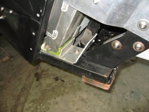

I have done the reinstall of the radiator. It was pretty straight forward.
There is a pic of the mount option,s I used the lightest with m4 studs; the mid item is the Facet fuelpump mount.
The rad now sits on a foam tape bed
When installed I can still move the rad up and down and a little side to side before the rubber and foam beds firmed up, I think that if you can't it is probably too firmly fixed.

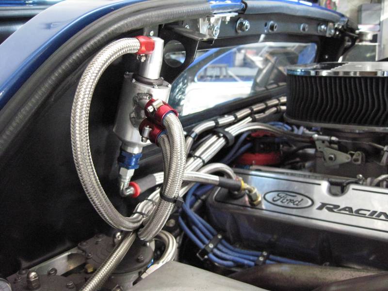

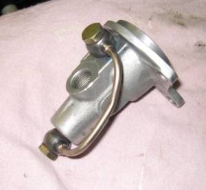

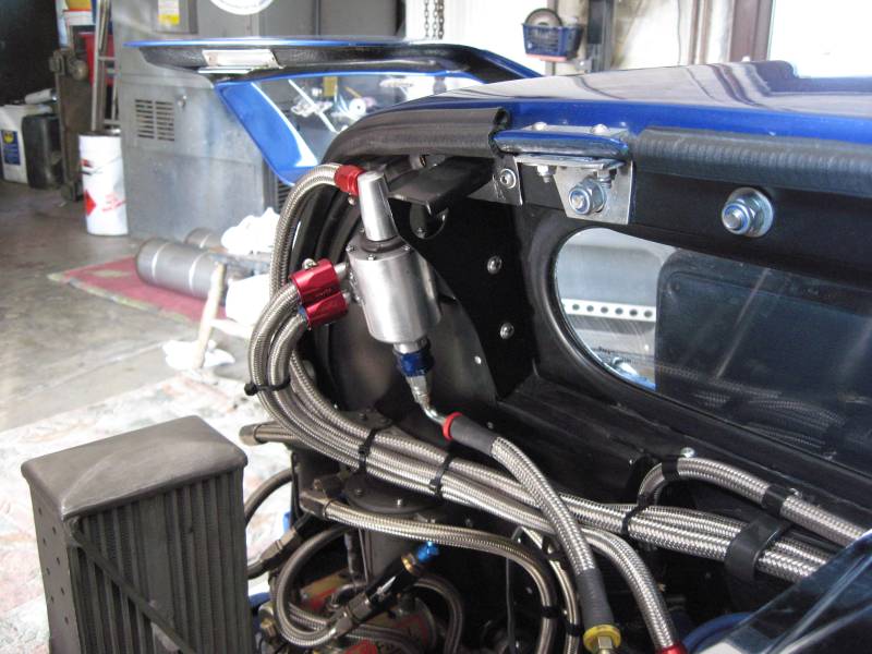

The oil issue turned out to be the crankcase ventilation system. The engine is a Ford Racing crate unit so I had assumed wrongly that I would not need to modify things. I run with a PCV as supplied, however I had previously had an issue with oil seeping out of the rocker cover vent and had fitted a baffle plate behind it to stop the rockers throwing oil at the vent and solved the seepage. Anyway it transpired that the rockercover with the PCV also had no baffle behind it and worse it was at the front of the engine so when the engine was on braking and overrun the oil went forward and the valves and rockers sprayed it directly into the PCV on full suck, that explained the oil consumption and smoke.
I searched through the site, there appear to be two schools on this; Use a PCV and positively ventilate the engine or vent it to a catch tank. I decided on balance the PCV gets rid of more of the products of combustion so revised my system. After fitting baffles in the rockercovers I made a separator that takes in a hose from each side in the form of a swirl pot and fitted the PCV into the top and piped that back to the EFI air / throttle body. In the bottom of the swirlpot I fitted a one-way valve and piped it back to the rocker cover to return separated oil back to the engine. There are some pics, I need to decide on whether to fit an air in filtercap.

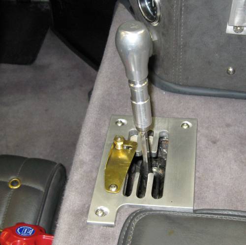

I spent some time re aligning the gear shift and abandoned the gaiter for a more positive ‘H’ gate with a reverse lockout and again tweaked the bias on the selector cross shaft. This must be one of the trickiest jobs on the car, but it does feel better (again)

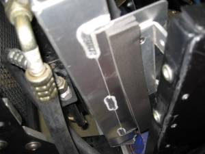

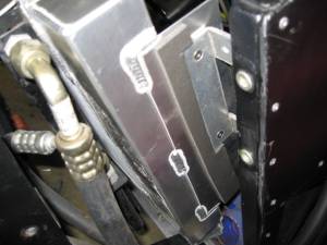

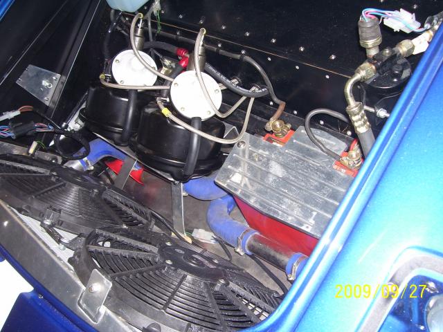

I had some further thoughts on the Radiator issue and came to the conclusion that the aircon rad hanging on the ally rad could not be a good idea so I have made independent mounting for the aircon rad to relieve any load on the rad frame.

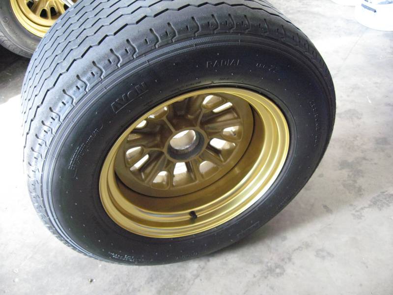

The tyre rubbing issue probably came from meeting the SVA need to have the rims inside the body plan. The 295 x 15 rears were a bit short on rim width so I decided to fit some wider outer rims to draw the tyre over. I had also damaged a front inner rim on a speed hump in France so I sent them all to Image who have rebuilt them wider at the rear and fixed the bent rim at the front. I couldn’t resist going a bit more MkII and had the rims anodised gold, a bit bling but I am getting used to them now.

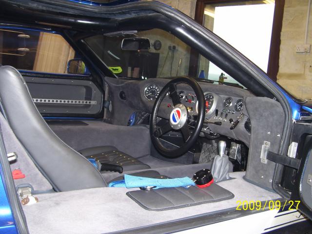

Colours... The dash is grey Alcantara so the door pockets will be the same, carpet set will be the same shade of grey with edge bindings in the seat colour which will be a lighter grey leather in the MDA patern.
The car will be the Shelby Guardsman blue with the white stripes, hope it will be a good combination.
