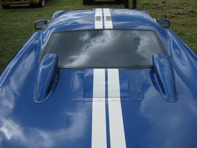

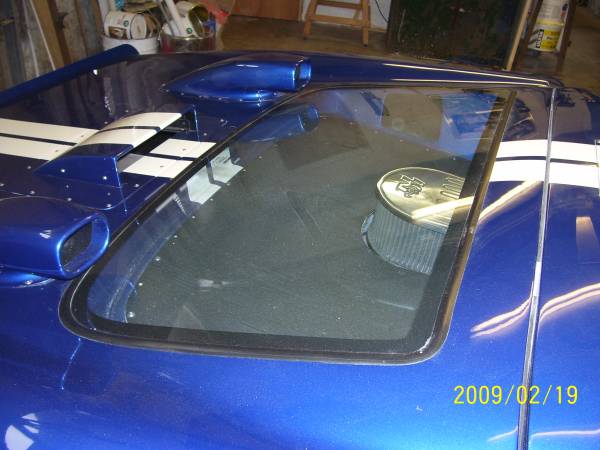

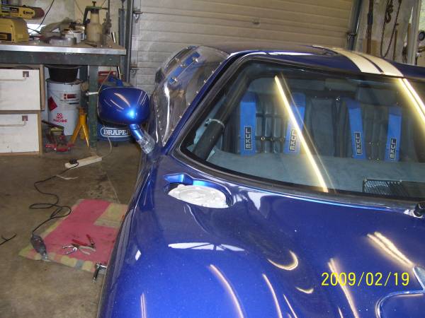

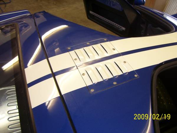

The SVA document was a bit of an anticlimax after all the effort to get it. It just looks like an old type MOT! However now I can refit the proper bits and finish the build. The rear screen is now bonded in and looks very sharp and tidy, The painted roof vent is now in place.
The mirrors had to be extended to get an acceptable position to pass the SVA, the big side/top air intakes created a blind spot that was not easy to see past in the test.
Lights and front indicaters next.

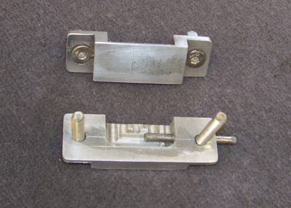

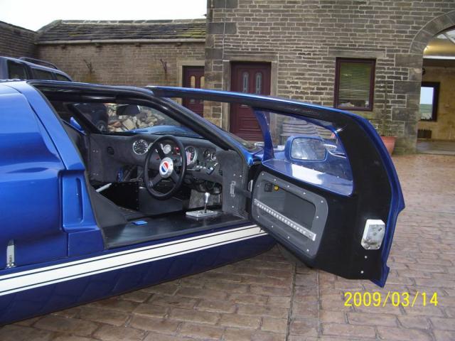

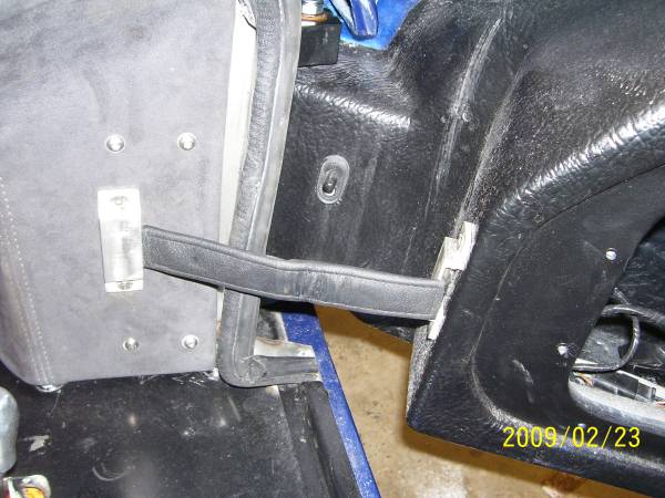

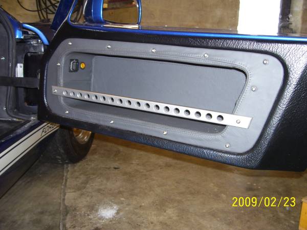

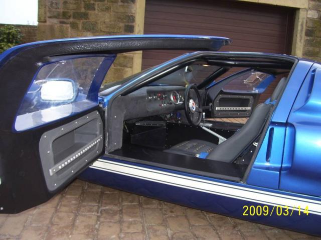

I have restored the mirrors to a more conventional height so the door bin panel can now be fitted. I have also made some check strap brackets they are screwed directly into the door pillar behind the dash for a good solid fix.
The VW mirror controls are fitted in the door pocket also the heating switch for the mirrors, I decided to keep this feature to keep the mirrors as clear as possible, hopefully no fogged up mirrors.
Steve

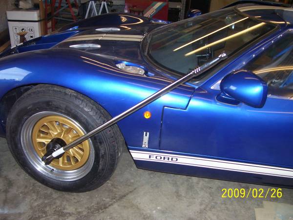

I am changing the hex wheel nuts to spinners and had difficulty removing the nuts that were tight on. This 70mm socket fixed it!:thumbsup:

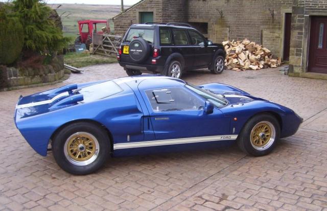

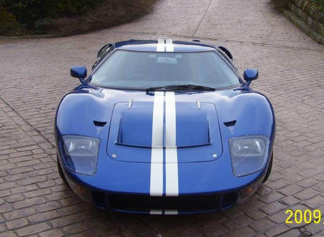

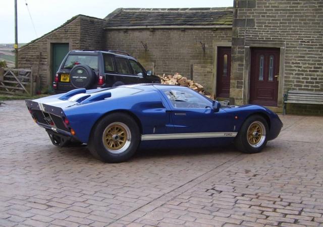

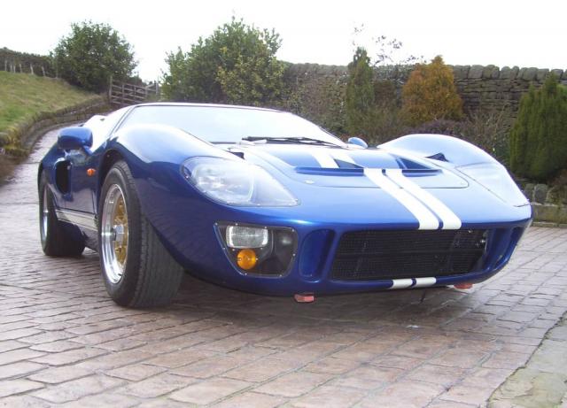

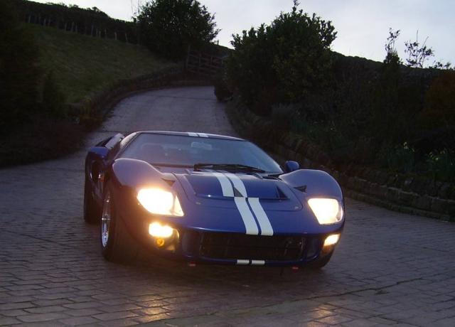

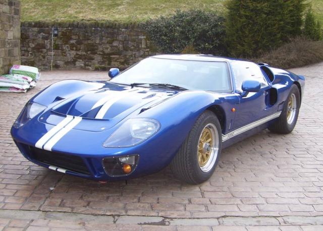

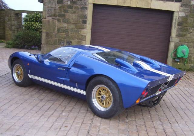

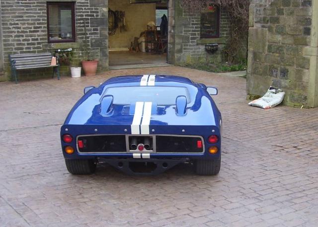

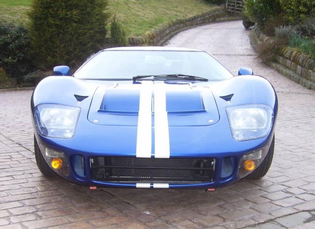

Today I was able to check how the car goes down our access road that has a steep junction with the road, made it down and back without grounding the nose. Here are a few pictures on return.
Steve

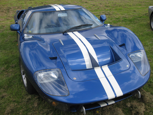

It was good to meet with you at Stoneleigh and get a chance to see first hand the amazing job you have done on this car build. You should be proud. Attached are a couple of the pictures I took.
Dave

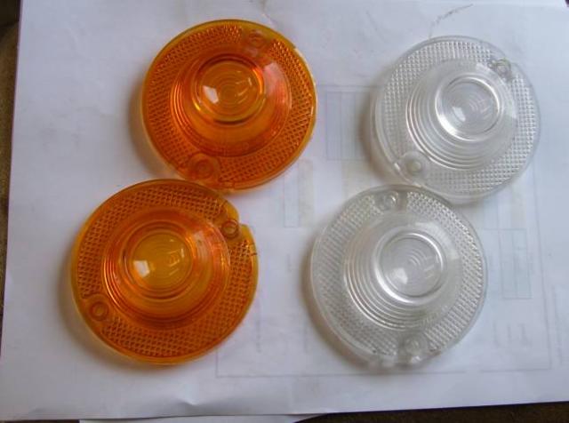

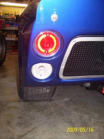

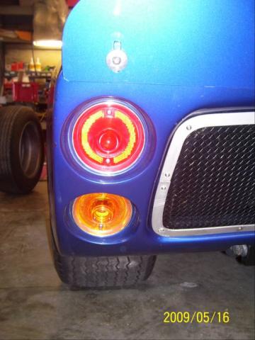

I have been a bit down on the rear lights. The brake and tail lights of the original 'Corvair' are exactly right but the indicator lights for the UK have to be amber, so I had used the matching reverse/backup units but with amber light bulbs.
These work fine but look a bit 'Chav' and modern and also act as a white reflector that I think is not acceptable on regs.
After a lot of dead ends I found some transparent amber paint and airbrush sprayed the inside of the lens.
I think these now look better
Steve
