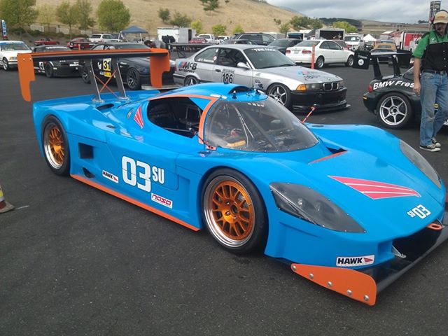

All loaded up & heading to Sears Point in the morning for a weekend of NASA racing. Should be great weather so come on out & check out the "Blue Mistress" & have some fun at the races.
Ted, look forward to seeing you Don and Cary at the track. Dont make em cry too much before we get there I wanna see that first hand ;)
Dave, we will be headed to Sears on Sunday. BTW Howard, we will be headed to Sears on Sunday :)
I am in a marginal cell area so cannot call in the details today, I'll call you tomorrow.
I had fun. Chris had fun. Ted and Don seemed to enjoy themselves. The car worked pretty good. Still working out some bugs. 20 min warm up, 20 min qualifying and a 30 minute race. The tires we went out on for warm up were crap(old used tires). Next set way better. Ted is truckin home to get more tires and a new exhaust gasket. It looks really good with the orange wheels and trim pieces. Down on power some. might be an ecm issue. We're going to do it all again tomorrow.

Weekend at Sears turned out well for Team QRP & owner/driver Chris "Big Dawg" Durbin. Sat started a little rough, as Chis was scheduled in from Pittsburg, later in the day. Team driver Darrell Anderson, got a chance to drive the SLC in the morning warmup. We tried a different tire package, (used) that turned out to be drastically bad!, Darrell was hanging on for dear life as there was zero grip. DA was not to sure what he was getting into, as the car would not turn, stop, or accelerate. We knew right away what to do, as we put the tires from Thunderhill back on, & made a few adjustments to the aero. Darrell went back out for quali, & realized this is a good car after-all. Ran a 1:48, which is okay, but the motor was really laying down. Chris showed up, jumped into the car cold turkey, & started from the pole, (he hadn't driven SP in about 4 years). He showed his merit, by not balling it up, got into his groove, but we had no power, as the car would just labor down the straights. Finished up 5th overall, 2nd in SU.
We knew we had to get our sh*t together for Sun, as we got our butts kicked a bit. Ran back to Stockton & got some more tires, & exhaust gaskets.
Sun Don & Carey got the exhaust fixed, I took a shot at fixing the motor, & Chris headed off for practice. He was a happy camper, as the car ran much better. Qualified 5 sec faster with a 1:43. Started on pole, got beat into turn 2 by the fast red Camaro, but outbraked him into turn 11 on lap 2. Said goodby to the field as the car would go anywhere he wanted. Backed her down to stay out of trouble as SP is brutal on cars, (the bone yard had about 10 cars balled up in it), got the first win in the books, all in all, a good weekend at the races.
Much thanks to the crew, Don, Shawn, Cary, Jim, Darrell, and everyone who helps out, Hoosier, All Pro Coatings, Superlite Cars. Also good to see SLC owners Howard, & Tim, had fun hanging out with them. Ron also brought his GTM out, so we really had a good group!
Car attracted lots of attention, as usual.

I flew in Sat morning so Darrell Andersen practiced and qualified the car. We tried a new tire compound which wasn't as good as what we had tested previous, so we put him back on the old tires and he promptly put it on the pole for Saturday's race but near the end of qualifing was saying the car wasn't pulling as it should. The guys jumped right in and tried to diagnose the fix the car for the race. I get in on the pole on a track I hadn't been on in 3 years, no pressure. I led for about 4 laps but the car was down on power and I didn't manage traffic very well so we came home third. Immediately crew jumps in and more diagnosing and work saturday night and early sunday morning. Ted and Don think they have it right so we head out for morning practice. 'Holy $h!t' you guys fixed it alright its a rocketship and more than 4 secs quicker than saturday. Qualifying goes well and we put it on the pole again. We were out powered into turn 1 by the stockcar but I put the heat on him and he'd already over cooked his rears by T10 and I drive by and away from the field. Managed traffic much better, handling changes allowed us to put the car whereever we wanted in the corners and cruised to a pretty dominating finish.
Proud of Ted and Don, they really built a good piece. Thanks to those who helped out over the weekend, Darrell, Jim, Cary and John as well as some new friends and SLC owners Howard and Tim. We had an issue and they guys dove in and remedied the situation. Thanks guys, my job is easy cause you guys do yours so well.
