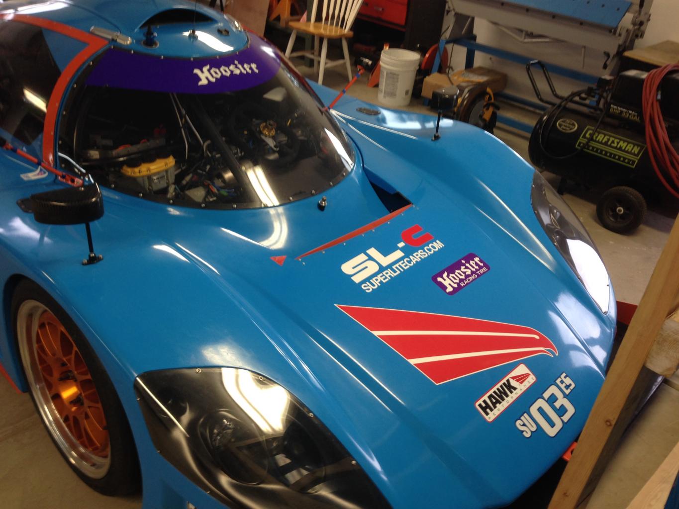

Sure! So if you take a look at photos of the side/door of the car, you'll see and orange L-shaped piece that runs along the front and top of the door. It's about 1.5" wide all around. Here's what Don did:
1) Use the window as a template to cut out those orange L-shaped pieces in metal (not sure if steel or aluminum).
2) Cut about 3/4 to 1" of the window front and top edge off where it is underneath the newly cut mounts.
3) Powdercoat/paint orange. Obviously.
4) Attach the mounts with rivets using the trimmed pieces of 3/4 - 1" lexan as spacers between the body.
5) Now you can slide the window into the mounts. It does scratch it a little but it's not visible when the window is in the mounts.
6) The latch at the bottom is hard to describe without a picture, but it's located roughly in the middle of the lower edge on the inside of the window. It pushes onto the inside of the door, thus forcing the window onto the outside of the car when engaged. You can release it from the outside via a finger-sized hole.
The window seemed very snug. I hope this makes sense. I'll consider doing something like this once I'm looking at mounting windows after it's on the road.

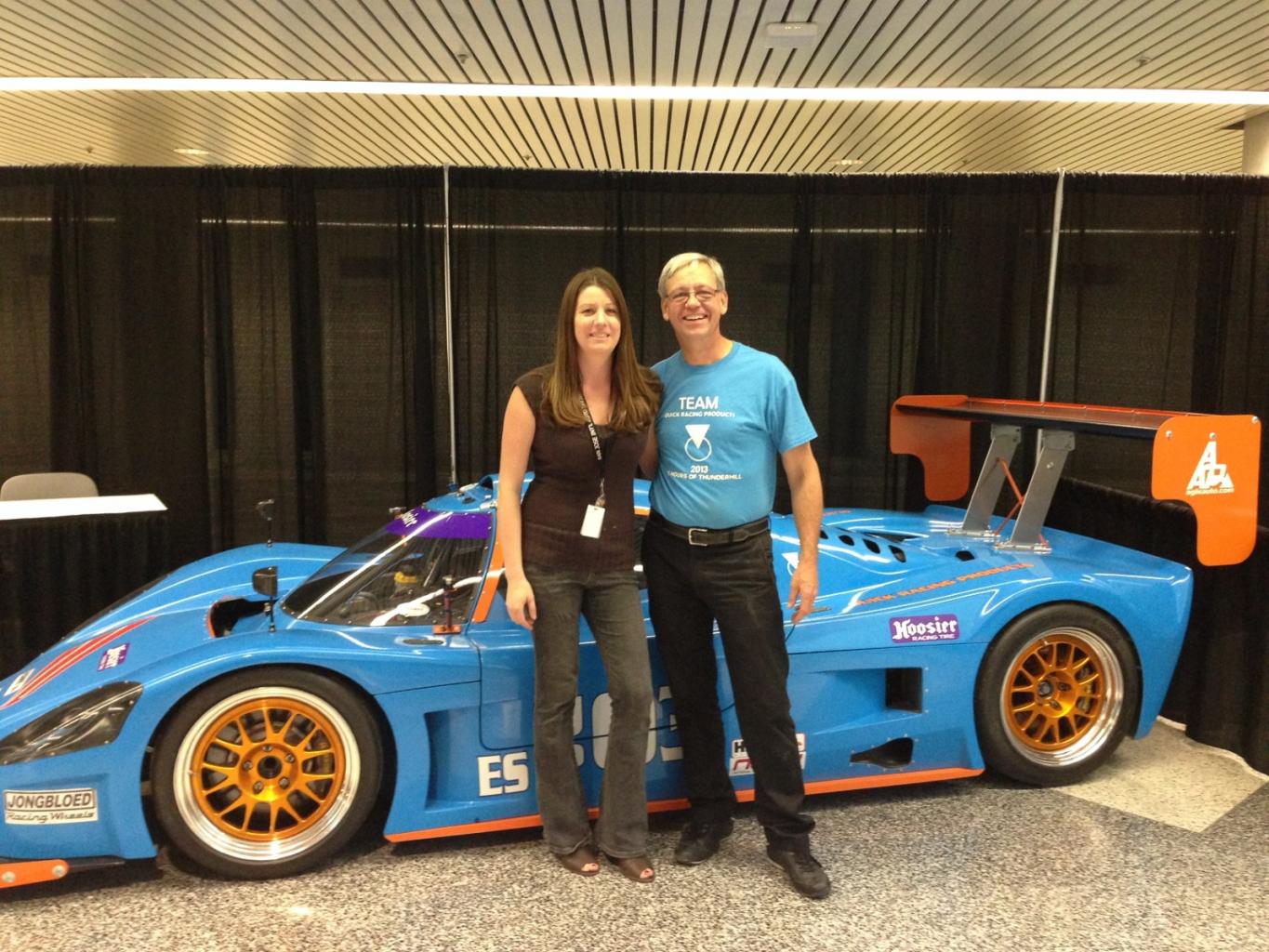

What a great team to work with. Everybody on this team is so generous. Ted gave up several days of work and personal time to come show the car. Ted and Don both share their knowledge freely. We all answered questions and let the people sit in the car. My friend Heidi said we the first race car ever to let people sit in the car. I wish I had a dollar for all the pictures that were taken of smiling people sitting in the car. We had a couple of local SLC builders stop by and check out the car. Chris thanks for your generosity too. I think only one little kid peed in the car. These guys are fun to work with. Thanks for letting me join the adventure. Here is a link to Don driving the car in. [ame="http://www.youtube.com/watch?v=264gGyWpJBk"]SLC move in - YouTube[/ame]

Boy, hey. Now THAT is taking the wrong turn to get to the Hilton check in!
Interesting, the way in is from the street that served as the straight for the San Jose Indy Car race that was held here. Poor little blue car musta got lost.
Dave
It would have been fun but I did not want to get Heidi in trouble. Heidi was kind enough to get us invited to the event.
