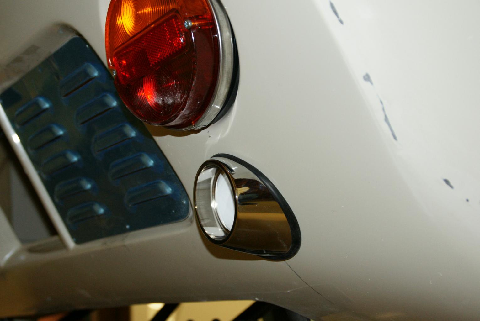

Backup Lights
Some GT40s seem to have only one back up light (if any). I wanted two. I don’t know if I saw it somewhere on the forum or if I just thought it might fit, but I have installed the backup lights from a ’65 Mustang in the rear just below the brake light. Before I did it, I carefully mapped out the curvature of the rear end and found a match to the curvature of the Mustang lights and a place in which the lights were basically horizontal. They fit perfectly.
Somewhere I saw where the reverse switch on the UN1 transaxle couldn’t carry too much current, and since I wanted brighter lights, I switched to the LED aftermarket replacements for the Mustang.
http://www.mustangandfords.com/parts/mump-1009-mustang-projects-led-backup-lights-installation/

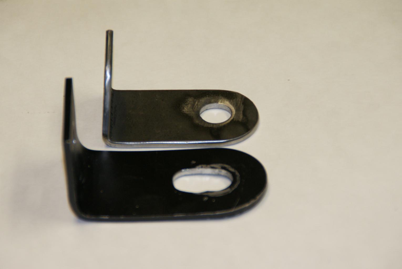

Dzus Fasteners
I know that they are not called Dzus fasteners anymore, they are now DFCI fasteners, but I can’t help to continue to call them Dzus. There are two places that the Dzus fasteners are used: the four corners of the nostril and the back side of the hood. The ones that came with my kit wouldn’t work for the nostril since the stud needed to go through the nostril and then through the hood. I needed a fastener with a 1.00” grip length but couldn’t find it, so I had to buy ones that were 0.80” grip length and then install the spring upside down on the other side of the hood. This way the retaining spring is on the opposite side of the fiberglass from the stud and will secure the nostril. They don’t have much spring effect now, but I have a rubber seal between the hood and the nostril to give some compliance.
The Dzus fasteners for the hood required a bracket to hold the retaining spring. I fabricated a pair but the bracket height had to be correct to let the hood sit at the right level. Thank you Clayton for posting your brackets.
Retaining Pins for Rear Clip
I have the original style of pin to secure the rear clip. These came with a mounting bracket to hold the pin. However, I modified it for a better fit. The problem was that the pin was basically standing straight up but the rear clip rotated around the bottom of the car and the rear clip has a slope to it anyway. Therefore, the pin would hit the front of the hole initially and then hit the back side of the hole when the rear clip closed. When you adjust the angle, the pin is too far back. I fabricated a new bracket that makes a compromise between the angle that makes the pin tangent to the pivot point and the angle of the slope of the rear clip. Thus, the bracket is shorter than the original. In the photo, the bracket in the front is the original (with the hole elongated) and the one in the rear is the new bracket.

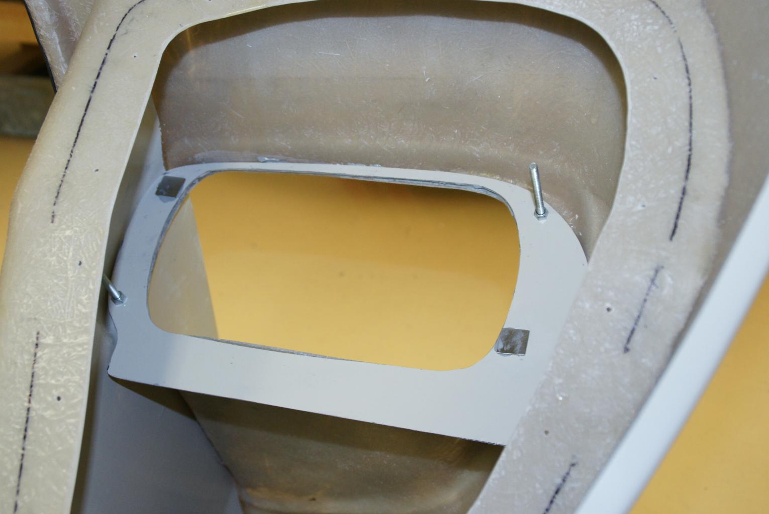

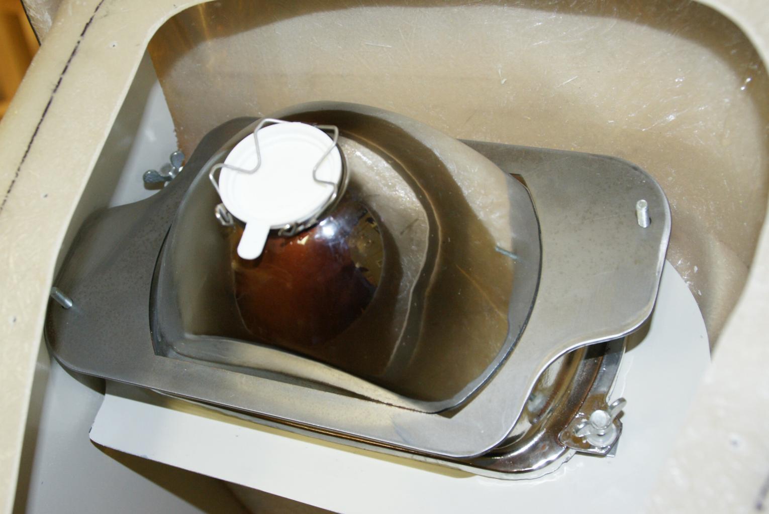

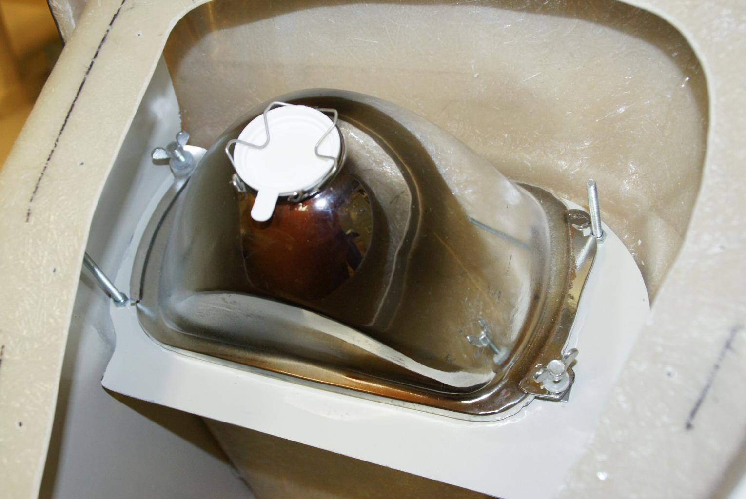

Front Headlights
I think I must have received the instructions for another type of headlight because that approach would not allow the lights to be adjusted. My lights already had two screws on the diagonal for adjustment. I made a hard surface for them to sit on and then used the long screws with springs between the light and the light plate on the back to adjust on the other diagonal.
It is amazing how long these little details take.

Jac Mac,
I have tried just about everybody including the factory. The 0.80" grip length quotes an overall length of 0.92" (so don't be misled), but I really need a 1.00" grip length in order to actually use the retaining spring. However, what I have now is workable.
The factory said they could make it but it would be expensive. Anyone interested in a group buy?

Ian,
Thank you for helping. The fasteners shown on that website were the D-Ring Bail Handle type. I need the flat-head self-extracting type. The ones that I need are the flat-head self-extracting size 5 (5/16" stud) with a "grip length" of 1.00".
I am going to use silver solder to attach the half wing handle as the originals had. I am having the wings laser cut right now. Therefore, I really need the flat-head type.

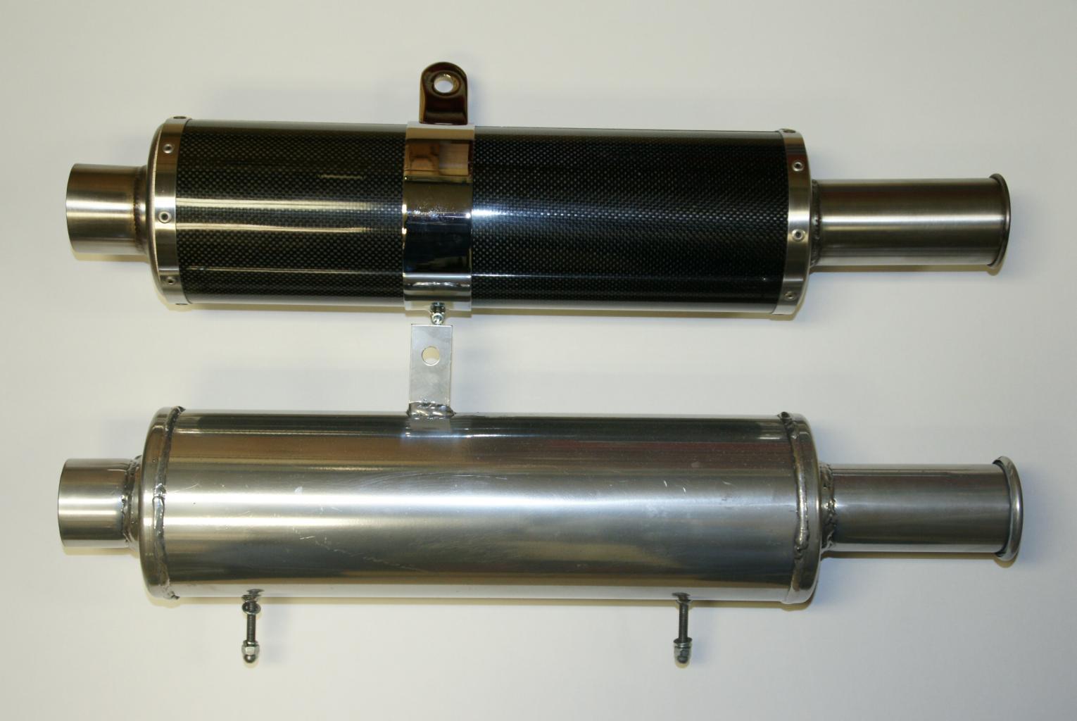

Mufflers
I got my new mufflers from my friends at D&D Performance Exhaust today. If the trend holds for the car as it does for big bikes, then this will have a very mellow sound.
The new muffler has a carbon fiber shell and weights 4.2 lbs. as opposed to 6.8 lbs.
-Bob Woods

Nice looking muffler Bob. What outlet size is that though? Wondering if it might be a bit small for a high performance engine. I'd want at least a 2.5" in a dual exhaust for an engine making over 400 horsepower.
Darrin,
Thanks for your PM message on exhaust diameter sizing. I suspect that analysis is for exhaust pipes that run the length of the car. My "exhaust pipes" are about 8" long. I hope they will be ok; however, we can easily make another set with larger internals and exhaust tips. I will probably do that.
What I have might be a good tradeoff with torque, sound level, and sound quality.
-Bob Woods
You are very welcome Bob. I just emailed them asking what it would cost to make a set like yours but with a 2.75" pipe. Like the look of yours and really, really like the weight of the things.
Going to have to wait to calculate the total length of the things until the engine goes in and I get a set of headers made though so mine will probably be a bit different length wise than yours.
Darrin,
Let me help coordinate your muffler design with D&D. You need to come up with the inlet pipe diameter, the length of the silencer part, and the length and diameter of the outlet tips. Mine are stainless steel, but you could get mild steel chrome plated.
-Bob Woods

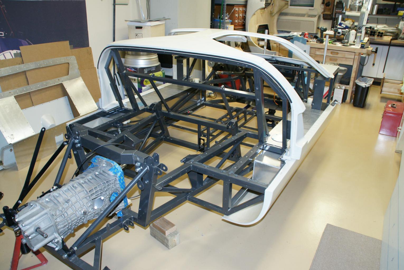

Is This Progress?
Well, I had most of the systems and parts test fitted and then took it all apart. It took less than 2 hours and now it looks like it did a year ago. I think I'm going backwards.
However, the reason I took it apart was to paint all of the aluminum panels and the underside of the fiberglass. So, this really is progress even if it does look sparse. I am working against the clock to use my Lizard Skin acoustic and thermal coatings since they have a one-year shelf life.
While I had it naked, we took the opportunity to make accurate measurements of the suspension and steering components so I can do the suspension analysis.
-Bob Woods
