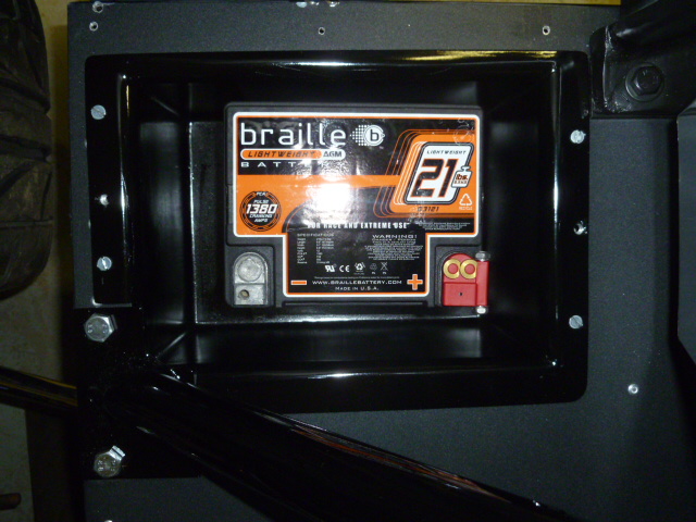

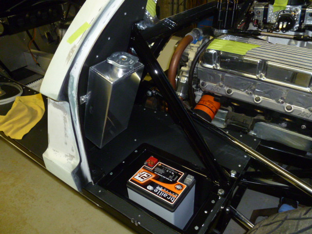

Long time since my last post but summer time events have kept me busy. I have got some things done however. Supports for the rear bulkhead have been painted and fit, the main wiring harness is in place, header tank is mounted, wiper motor is mounted and the heater/AC unit is in place. I've also got the battery box in place and the light weight Braille battery in place but not yet secured. 780 cranking amps, 22 pounds. A few pics will show the work done. Body work goes on at a different location. Small steps but still moving forward.

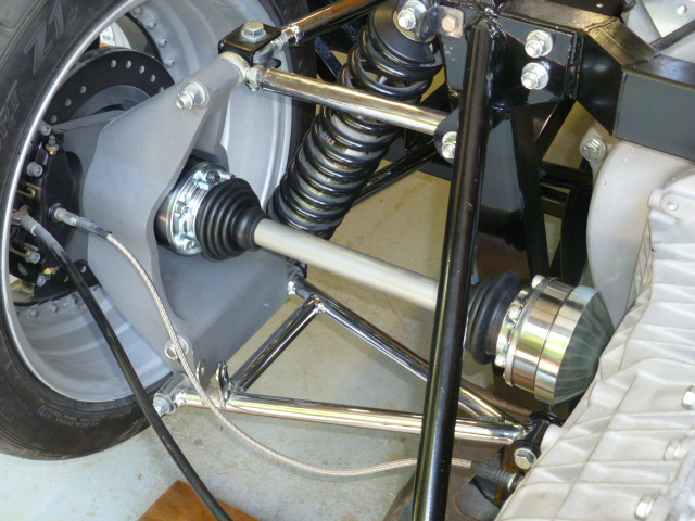

No photos to show but both half shafts are now in place. A note to all Tornado builders, run a 8x1.25 mm tap into all c-v joint mounting holes, both inside and outside before trying to assemble. I found that the retaining bolts won't screw in due to crap in the threads in both the inner and outer adapters.

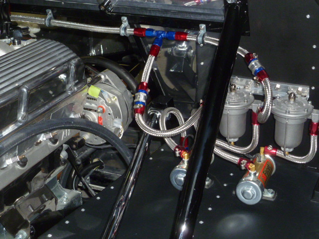

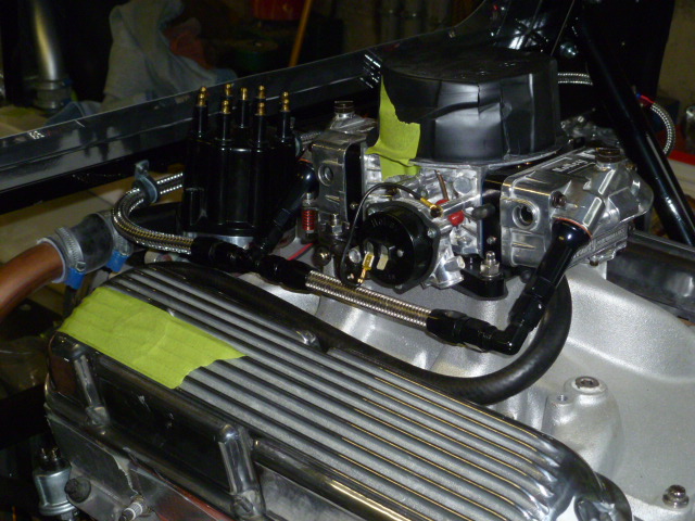

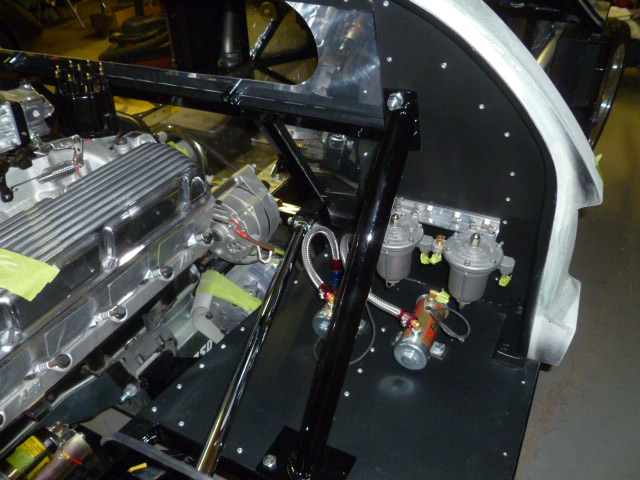

On a better note work has continued on the GT. After fitting the half shafts I went on to finish running the fuel lines from the pumps to the filters then to the carb. Work continues on the heater/AC unit with getting the lines run for both system. Small steps but moving forward.

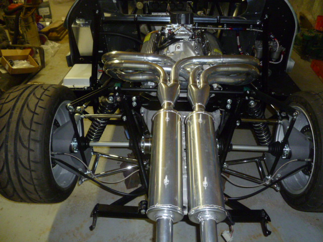

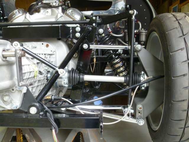

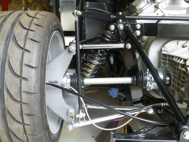

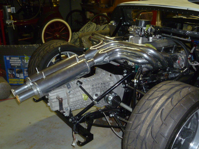

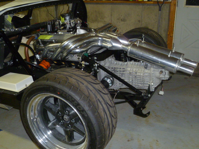

A little more work finished. Rear anti-sway bar is fit along with the exhaust system. I hope to have a running car by the months end. Snow can come early here in northern Vermont.

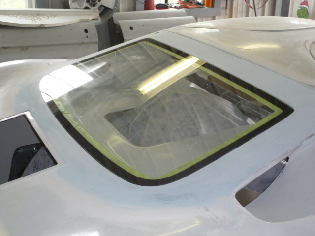

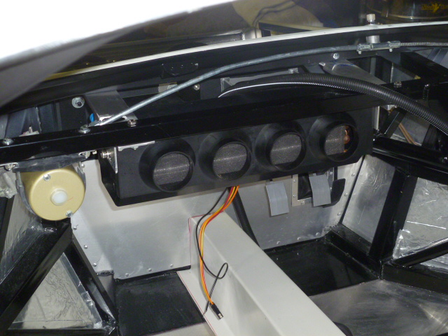

Been away for a while but work does go on. Because I'm working with a glass rear window we built up the area around the window so that it would fit flush. This is to deal with the thickness of the glass vs the use of the thin lexan rear window..

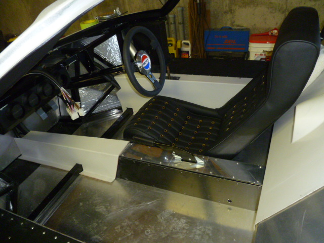

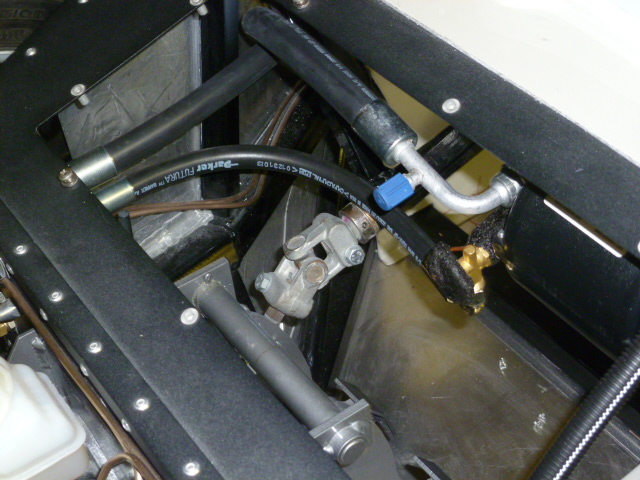

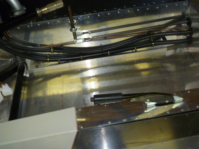

As far as the chassis work,here is a series of shots showing the run of the AC lines, the fitting of the 'glass cover,fitting of the drivers seat and steering wheel. At this point the cooling system is tight, having been tested at 20lbs. pressure. I will say that the fitting of the compressor and the lines was interesting due to lack of space. If all goes well the GT will come to life by the end of the month.

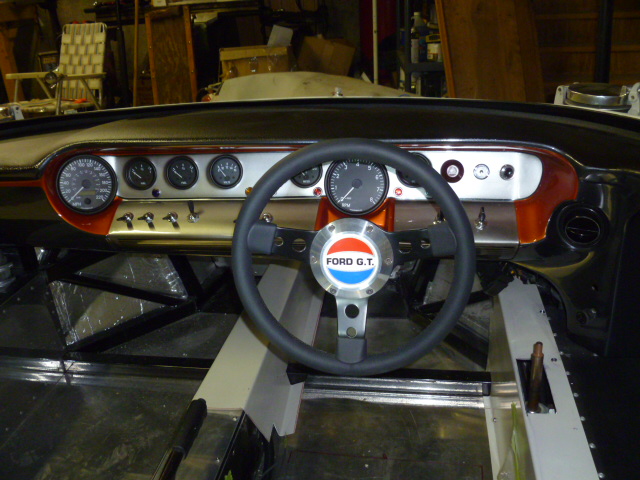

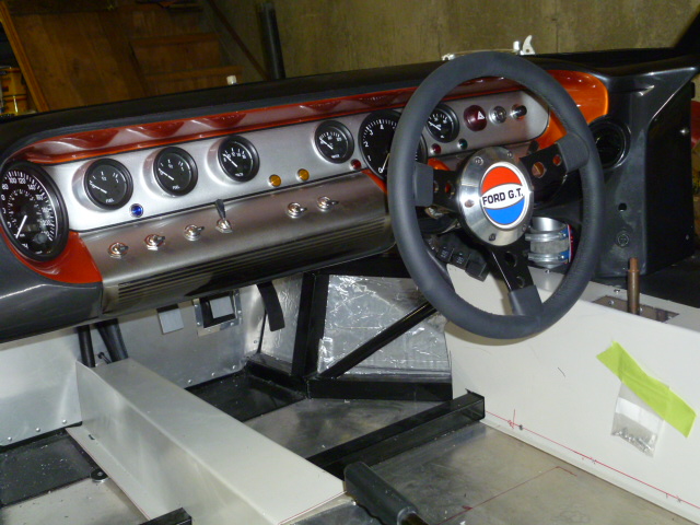

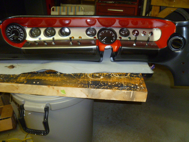

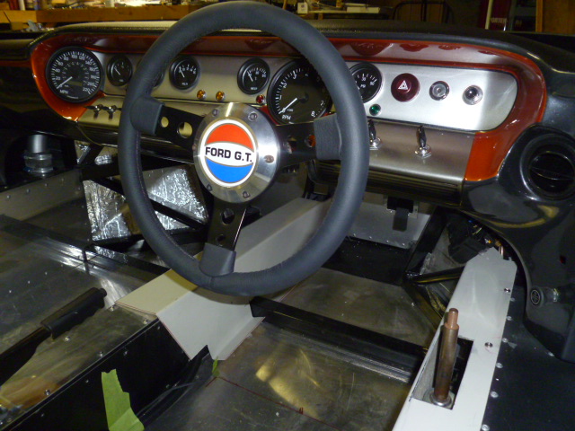

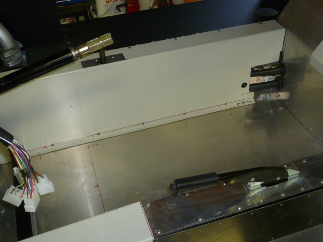

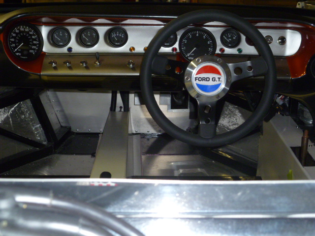

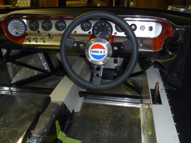

I have managed to get all of the chassis and dash wiring done. All of the A/C and heater hoses are in place between the engine and the under dash A/C heater unit, so at this point I thought I'd fit the dash. All though it might have to come out I wanted to fit it and plug in all of the wire connections to check all of the electrical circuits. If all checks out I'll have a running GT by weeks end. I'll let you all know.
Any way, here are some pics of the dash in place. I"m hoping all systems will be a go. I ran out of energy today so I'll continue during the week.

Well for a change I have some good news to post. After getting the dash in place and plugged in I did a check on the electrical system,operation of the fuel pumps, pumps work fine,leaks needed to be tended to, now tight. So with nothing left to do I turned the key. I'm pleased to say that I now have a GT40 with a heartbeat! All of the vital signs are where the should be,all of the gauges function,the fans cycle on and off with manual over ride working as well. It was a good nights work.
Found a few coolant leaks this morning tightened all of the hose clamps checked all systems again and ran the car again. All systems go. Time to watch some football!! :thumbsup::thumbsup::thumbsup:
