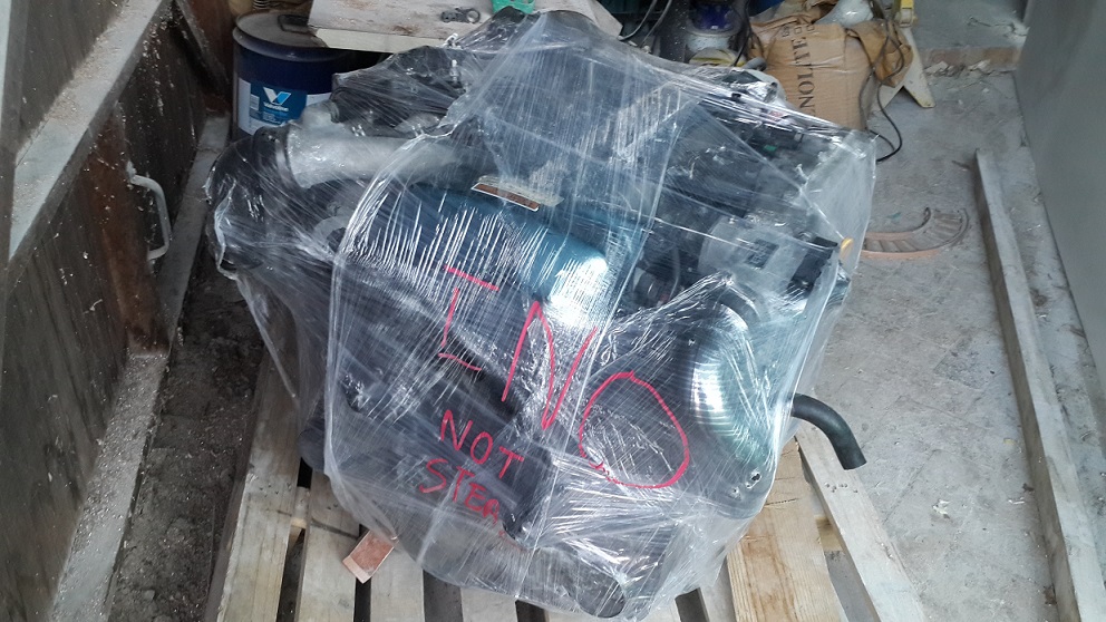

I have decided on a different route but have not managed to find anyone that has done this. I am going to use a 2JZ Toyota coupled to my 01e. Standard 280 bhp. Replacing the twin turbos with a big one and with management system and bigger injectors ... well it is how much I want. I am happy with 500 bhp though. Any thoughts on this new route? I already put down a deposit and the engine is local. So no scams.

It is the 2JZ-GTE. Twin turbo. 3.0 engine. It is a straight six and was used in the Supra. As I understand it a bullet proof motor with double the bhp just playing with injectors and replacing twin turbos with large turbo.

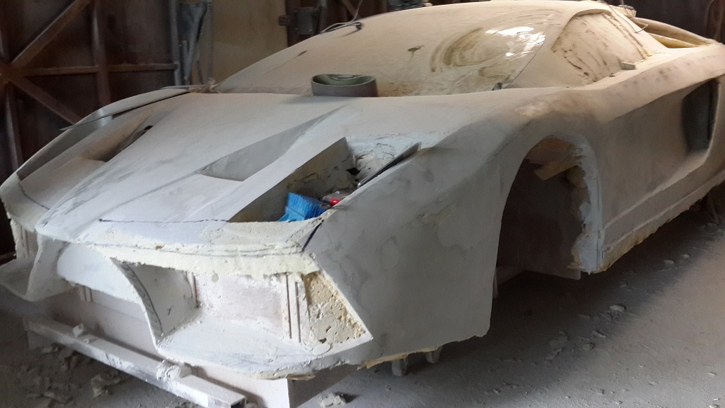

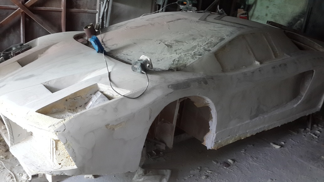

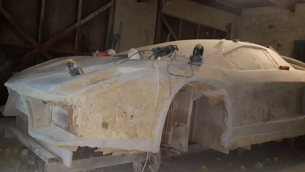

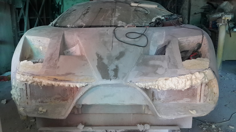

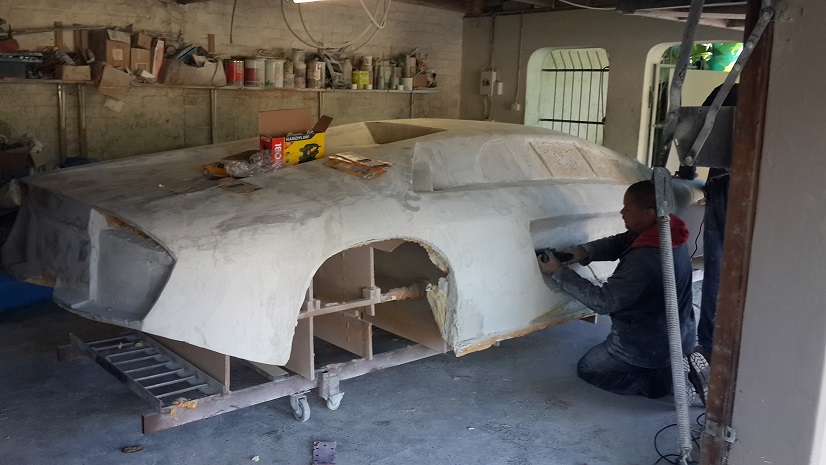

Haven't posted pics etc. for a long time. Took a couple of months to feel myself again after totalling my pickup but I am fighting fit again.

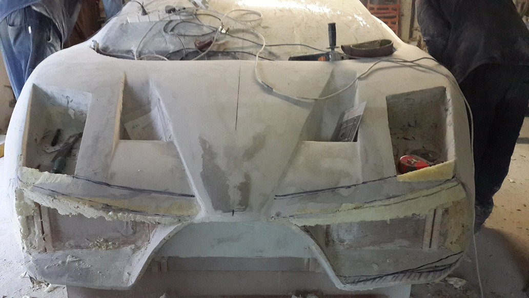

I also got two chaps to help me with the sanding work. I have been changing the shape continuously and we are now busy bringing the nose vents in from the sides. The lights have also been changed and I have not the latest photo of that yet. The side windows have been enlarged and I think it is for the better. So the Diablo style windows are gone. More Murcie like now.

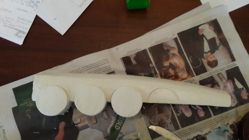

I have designed my taillights using modelling clay and I am going to use crystal clear resin and pigment for the lens. LED for lights. That is far from happening right now though.
Priorities is the body and at the same time I am going to have an adaptor plate made, a button clutch and hopefully get the long awaited chassis started. (My chassis guy kind of hit hard times....)
Here is the latest pics minus some additional work we did.

Nice to see some progress.
You bold using the power tools on the soft foam/filler surface. if you lean on a power tool for just too long it puts a flatspot or divot in that has to be fixed later. I did all my shaping by hand, using a long board and various shaped sanding blocks.
Use a course grit (60/80/120) as long as you can until the shape is right, only then go for the surface finish.

Thanx Jack and Fred. Yes. Alot of changes. Just this afternoon I changes a "bump" I did not fancy. It seems I have been standing still but from the original shape to narrowing it considerably took loads of time. I am close to what I want but still working on the front sharpening it up.
Yes Fred. Power tools isn't the finishing solution. Because I am still shaping and meazuring and measuring and measuring..... it is just quicker right now. I will get to the hand finishes as we go on eventually. Not looking forward to that but I do have help now so that takes eases the burden. That and off course getting things done and standing back and feeling a sense of accomplishment. :) I di have miles to go though. I am planning to compete the shape, pull the doors and lids, then cut them out od the 'buck' and do the recesses so that it becomes part of the main body mold.
Well on it again tomorrow. Also taking of 2jz flywheel and taking that in with gearbox to the guy who will be building my button clutch.
