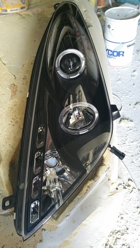

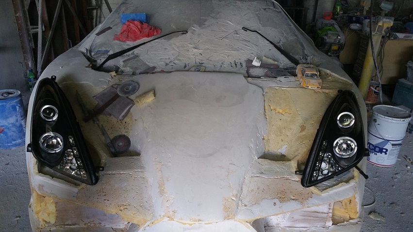

Well my lights arrived today from the States. What a nice company to deal with. Super efficient, super fast (on ebay) This is the fastest I have ever received a package from overseas.

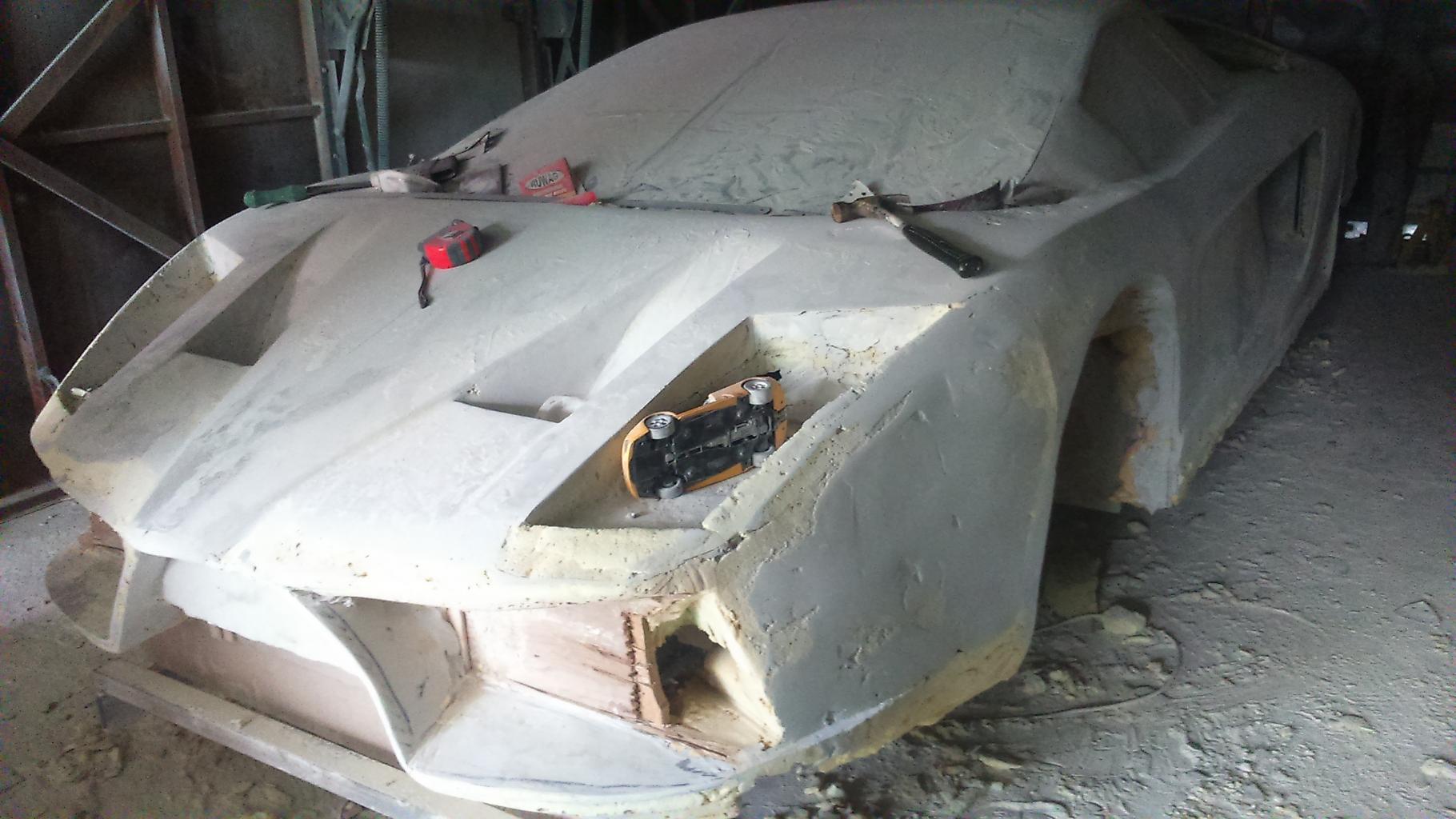

See attached pic. The lights are just place loosely on top. Next move is to tape the lights up and cut bigger holes position the lights and foam in before removing them again just to get my headlight holes.
I am super happy with the looks of the lights.
My mated engine and box should be ready by Wednesday but will only pick it up over the weekend. Will take some photos too.
Note I changed a lot on the nose so now I have to get cracking once the headlights holes are right. A lot of reconstruction and finishing awaits. Also see my wiper arms.... Thought I would not like the Peugeot setup but I actually think they look kind of cool on the sides.

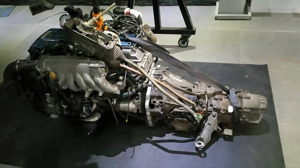

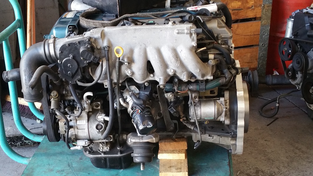

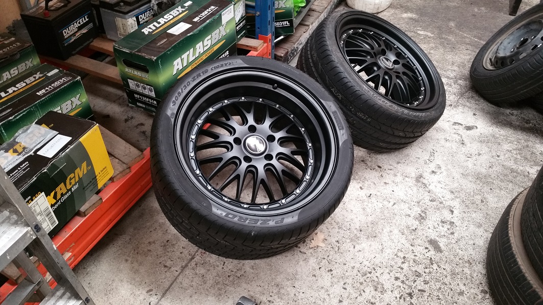

Some pics. Engine gearbox setup not completed yet. Release bearing problem so they will be making a housing to take an off the shelf bearing.

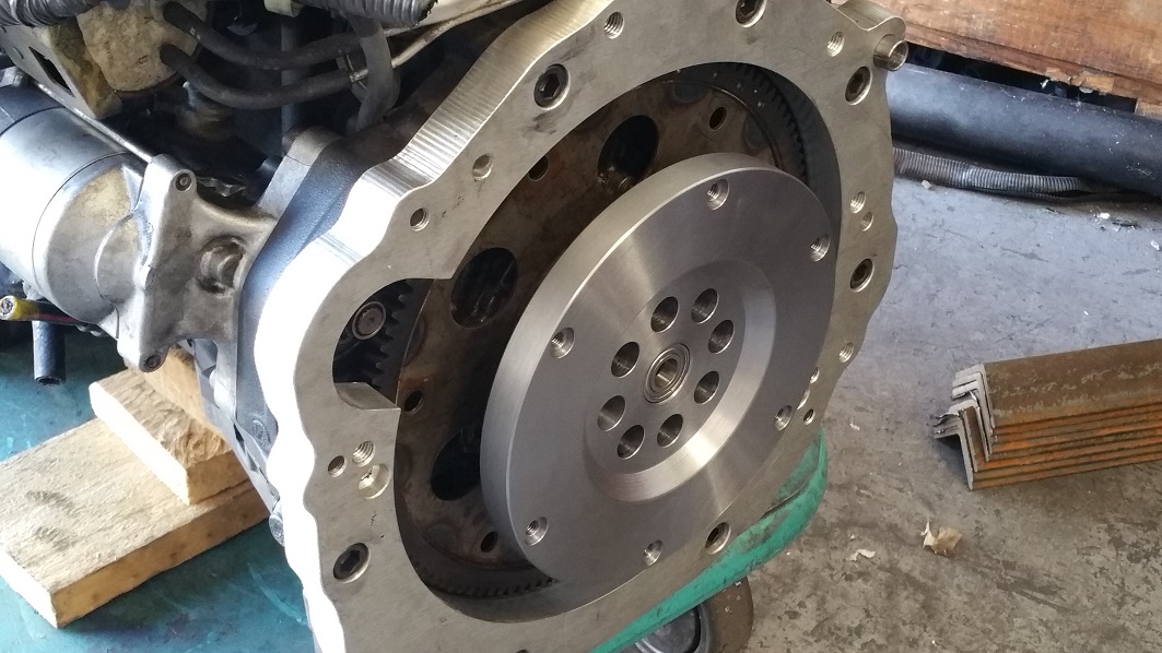

Some pics of the custom flywheel and adapter plate.

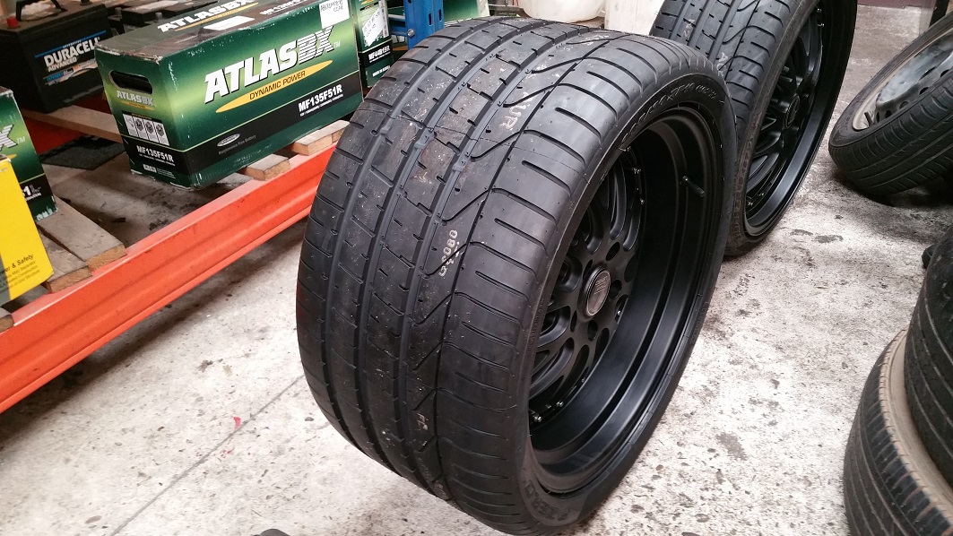

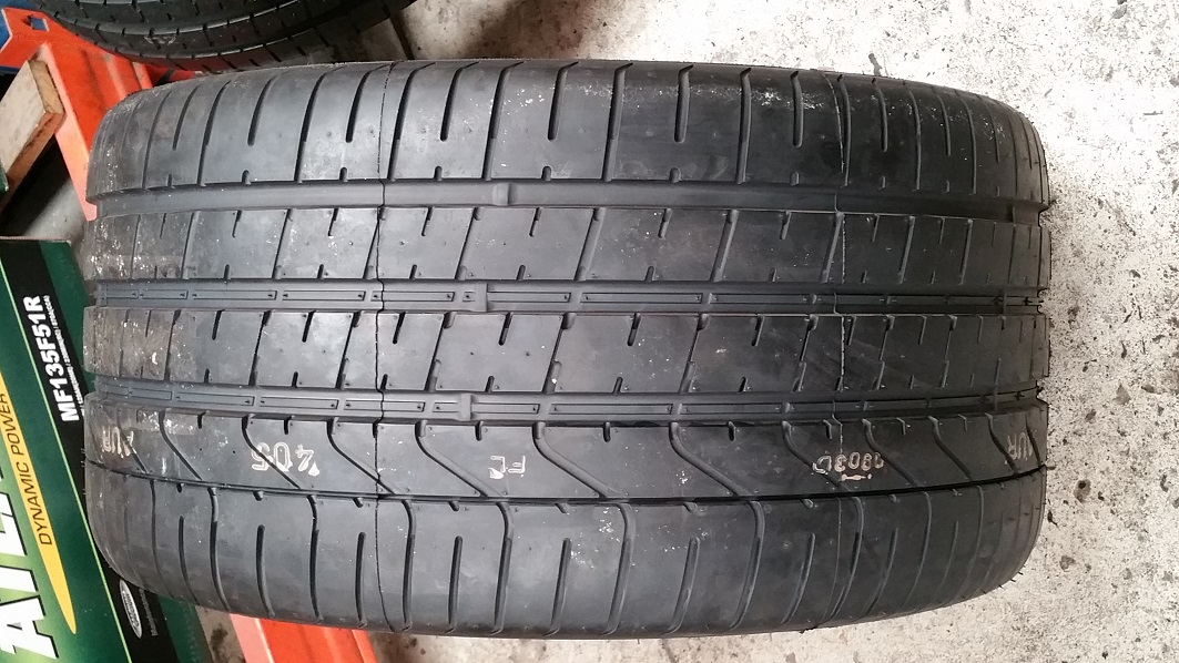

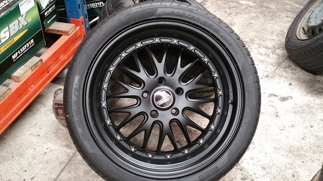

Also I got my wheels back with the Pirellis on. :)

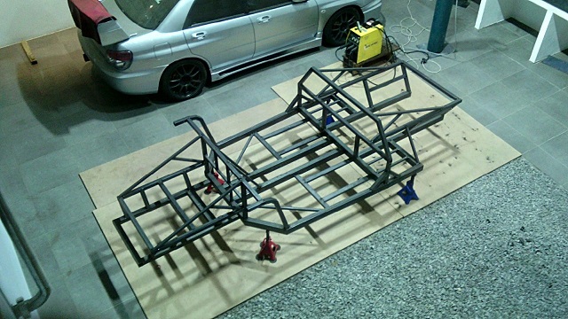

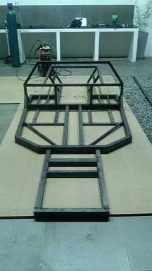

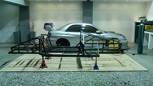

Very good news indeed. My chassis is underway. :)

2jz-Gte mated to 01e 6 speed with custom flywheel, adaptor plate and two pack clutch

My that looks quite familiar. :)
Looks like you're doing kind of the same as me (1UZ-FE mated to an 01E) and retaining the flexplate with the starter gear on and adding a flywheel after it.
What clutch are you using? That flywheel looks tiny!
Jackal
CURRENTLY BANNED
Hi David. I am not sure what clutch it is. It wasnimported from the USA and it was a 3 pack clutch converted to a two pack and the inners of the playes removed and new inners refitted to fit the splines on my 2jz engine. I will try and find out what clutch it is. New Engineering in Cape Town did the whole conversion for me. They even removed the release bearing with housing and made a new one so that release bearing is now an iff the shelf buy. The whole exercise. Adaptor plate, custom flywheel, clutch etc. Etc. Cost me the equivalwnt of $1300 which I think is very reasonable. I also have the extra plates of the 3 pack clutch.
Ah, I was looking to use an Audi RS4 clutch as it's just "bolt on" (to the gearbox end at least).
Not a bad price at all with that work on the clutch, I was figuring on £500-600 (~800 to~950USD) for mine but that was with a stock off the shelf clutch rather than a modified performance one!
Jackal
CURRENTLY BANNED
Yeah mate the problem you will have is that the rs4 clutch plates will most probably have different splines than that of your motor's shaft. What the engineer did here was to drill out the rivets and take out the part that goes over the shaft. He then used the correct inserts that fits on the shaft and put them in on the plates. If I ever needed a clutch again I would have to go back to him again. He is also going to make custom racing side shafts for my car at $300 per shaft. My guarrentee....... ic they beak he will replace them for free. (He does most of the Killarney Racing guys' side shafts. Never had one break yet.
I am going to Noordhoek where my chassis is being built tomorrow morning. Taking the steering rack, steering column, seats etc. through. Will also be discussing sheet metal, fuel tanks, suspension and so forth. I will phone Michael on Monday and get some advice on your setup if you like regarding clutch. He has done numerous v8 lexus conversions.
