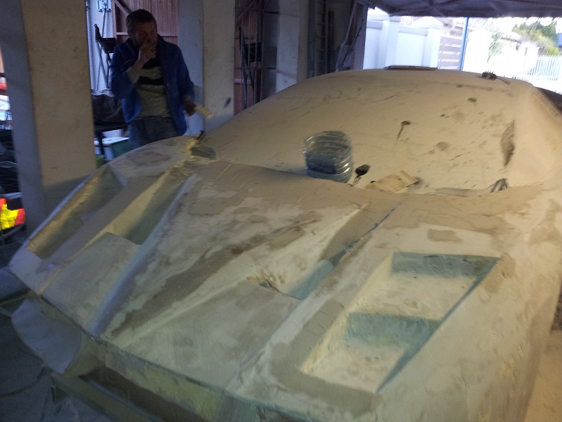

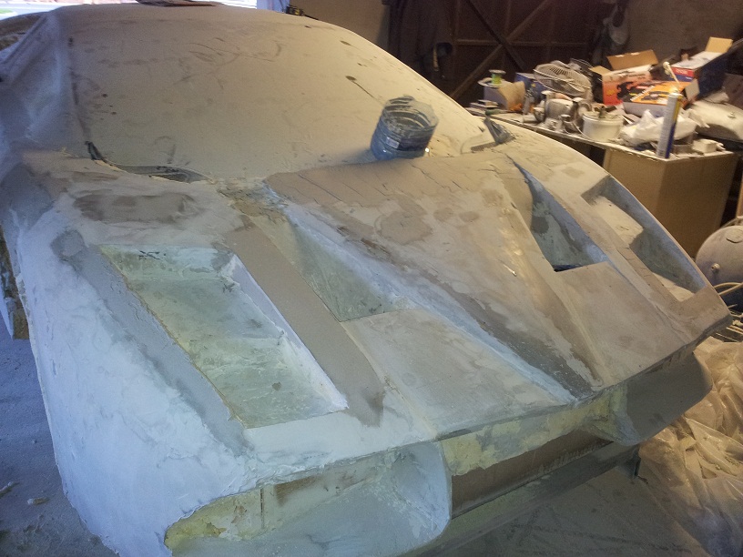

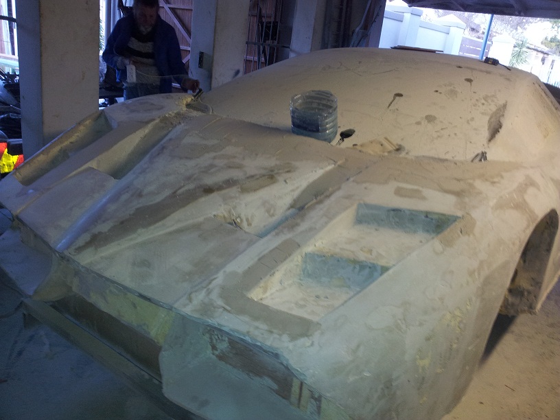

Starting to get the bonnet/vents/nose area close to what I want. The bottom front vents I have changed a bit too but not quite there yet.

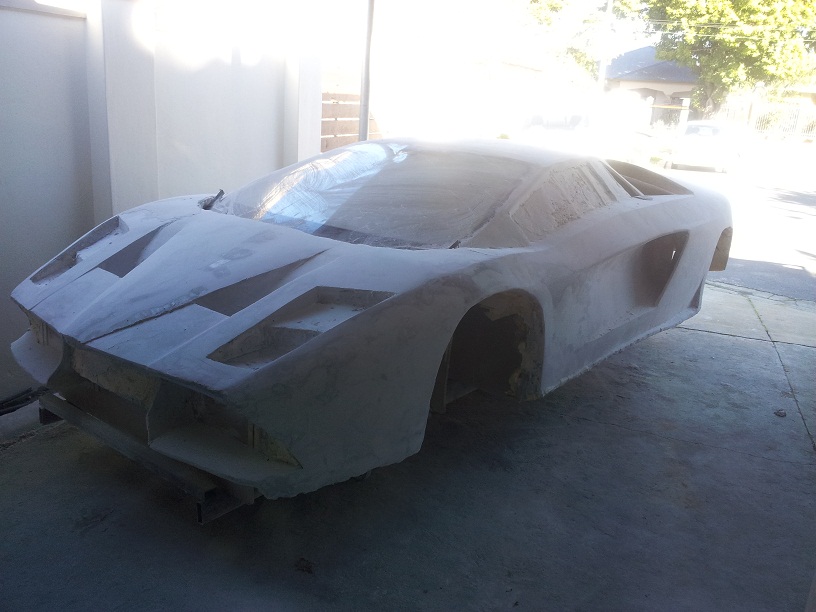

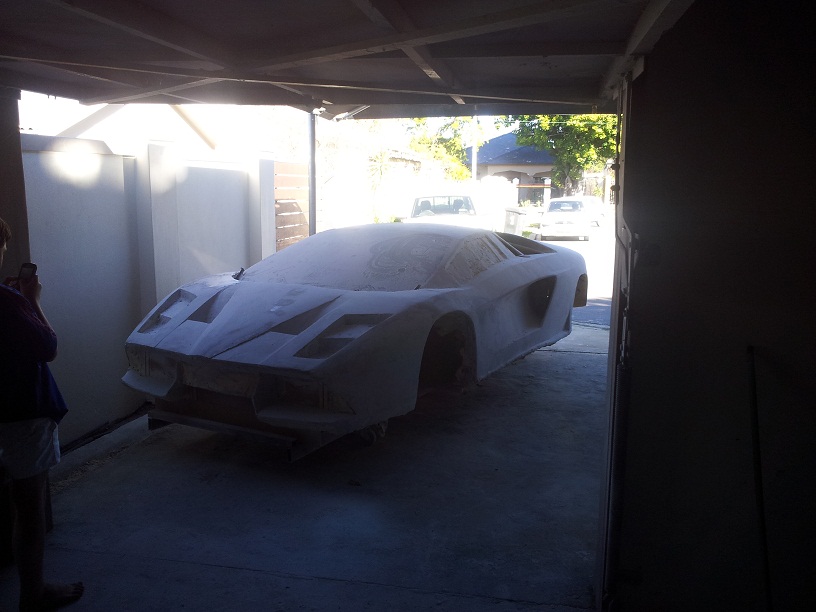

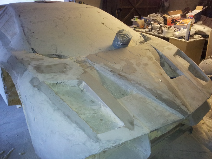

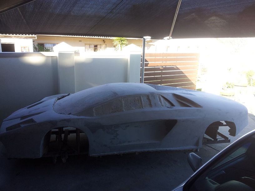

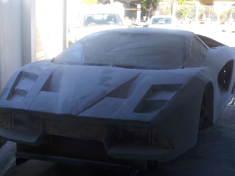

So pushed the fat lady out of the garage to have a look at it. It is getting there but even at this stage, especially when I think of the doors and recesses, I get my doubts sometimes! When I looked at it outside though it's all worthwhile.
We worked on the nose again, the bottom front vents STILL needs work. Where the bonnet and the winscreen meets also needs to be finished. Side vents needs alot of work on the insides etc. etc. etc. etc. :stunned:
