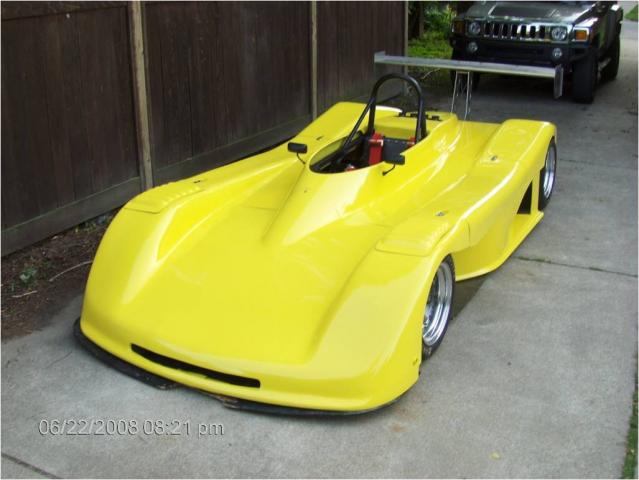

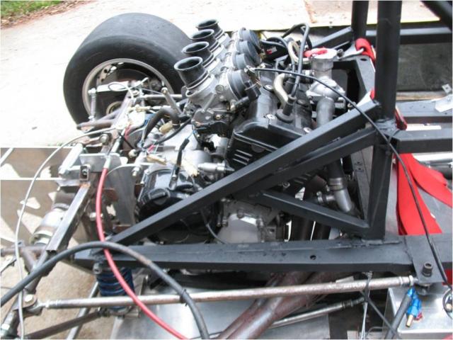

Ditch the VW powertrain. Use a Yamaha R1 Bike Engine, you will have you 150 hp, be much lighter, and have a 6 speed sequential trans to boot! (this is the powertrain in my racecar). You can buy these for about $500.

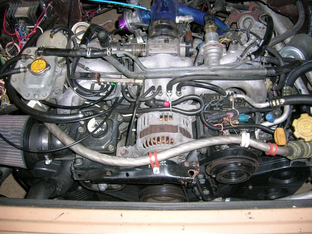

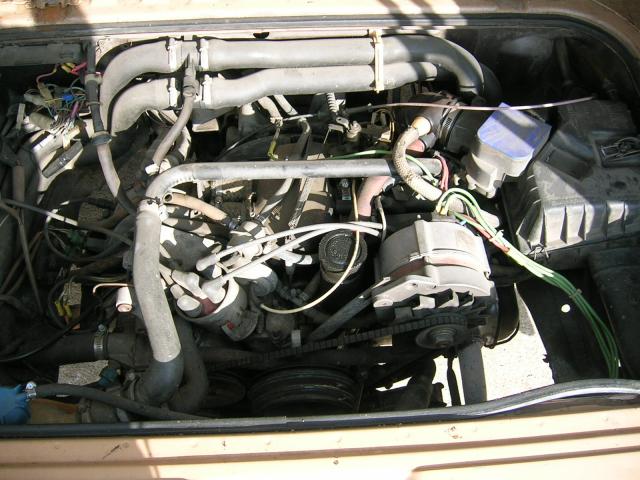

Subie JDM engines are cheap on ebay and as you all have read about my Vanagon conversion I love it, you can buy an adapter bell housing from www.smallcar.com and it comes with internal hydraulic release bearing for $590, I got my twin turbo motor on ebay for $960 plus $160 to ship it and it one Billy bad ass motor. It does weigh more and larger in size but if you have the room I suggest it. Here is before and after pictures, so you can get an idea of size.

Jim so far with 7 lbs of boost it has, but with 14 it took out the CV joints the second time I took it out. I hope it holds up thats why I dropped the boost, the input shaft on the VW transaxle is a little on the skinny side. I just drove it 2300 miles without any problems so if I continue to be kind to it, it should last.
Jack is right the NA motor will be plenty for a light car, my Vanagon is pretty heavy, I think 4200-4400 lbs.

do you have any pictures of that setup??? sounds sweet:thumbsup:
Darnel A.
I am in the Detroit area. You are more than welcome to come by and check it out. Just PM for directions.
