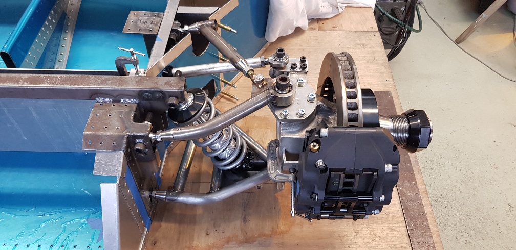

I’ve just completed tacking all the front a-arms, springs and brackets and is ready to get professionally welded. I would normally do the A-Arms but welcome to the the modern NZ where Regulation rules. The Fuel tank and Roll Hoop will also follow suite when ready.

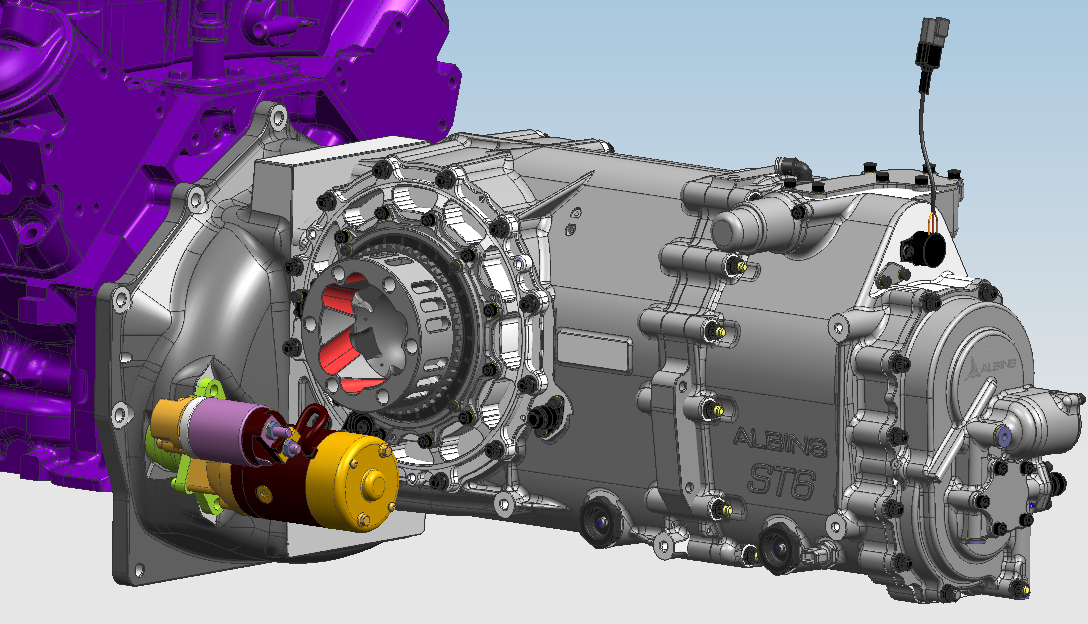

Having a few issues with the engine flywheel. I got the dry sump bellhousing from Albins which is designed for the 104T 10.44" flywheel and 7.25" clutch. This drops engine and Transaxle down low which is what I wanted. Only problem is Tilton don't make a 104T 10.44" flywheel and starter for a 8 bolt LSX style crank bolt pattern. The Tilton flywheel#51-4479 153T 12.75" and Super starter #54-40012 is the smallest diameter setup that might work. (looks like the setup in Wolfgangs M1) Might be contacting Albins for a replacement bellhousing but I will wait till the motor gets here and confirm. If anyone can put me onto a 104T 10.44"flywheel, 7.25" clutch and starter that will fit, I'm all ears. I can't believe I'm the first to fit this Albins ST6M setup to an LS.

Thanks for the offer John, looks nice, I already have a Tilton 7.25” 3 plate Clutch. The Albins STM6 is a 7 bolt BH to Trans design.
What diameter/Tooth flywheel does your setup use with the trans side starter. Also is it the LS 6 bolt crank pattern
What part number is the Tilton starter.
Tilton make a button flywheel for the LSX 8 bolt crank, but they don’t make a 10.25” flex plate or a engine side starter for a 10.25” 104T ring gear. I don’t want to yet go down that fabrication path just yet.
Albins make a Trans side starter bell housing but I was trying to have inboard discs’s which would get in the way of the starter. Might be the best option to have outboard disc’s and trans side starter.

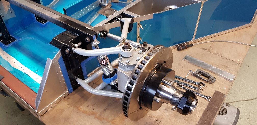

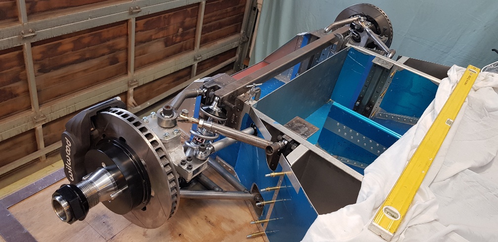

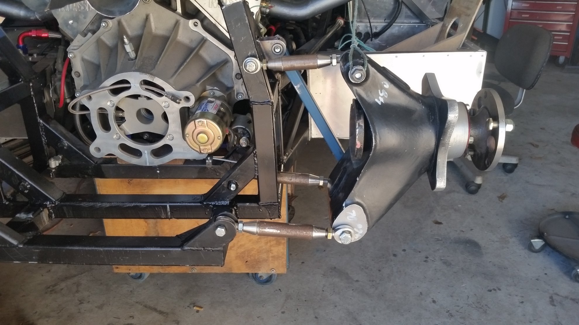

Back to the garage.. Front A-Arms nearly all welded.

The front A-Arms are all done. Just waiting for the Steering Rack to arrive so the front foot wheel cover can finally get some rivets smashed.

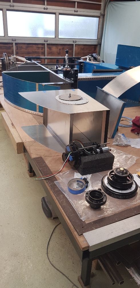

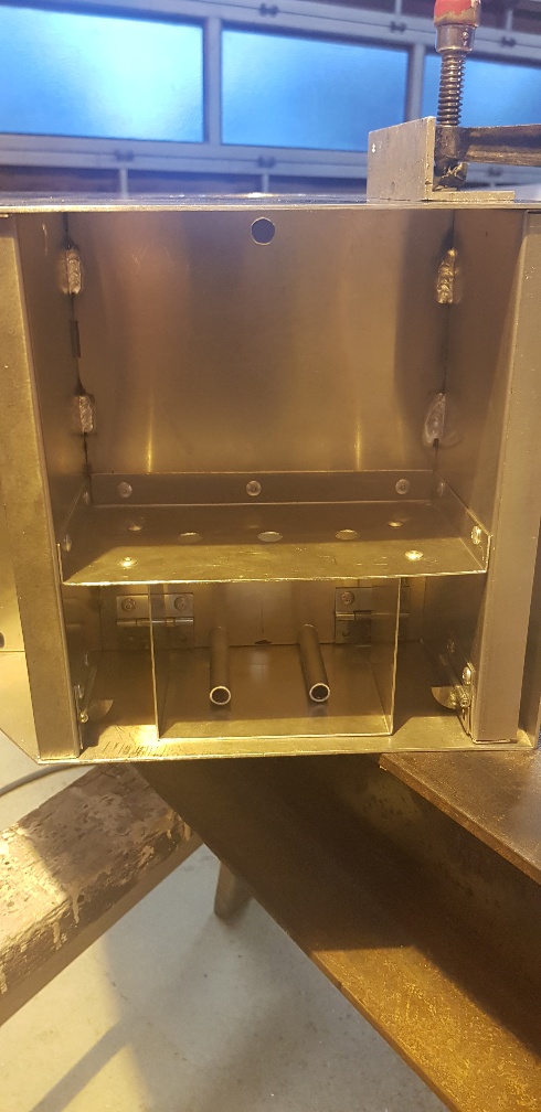

Work continues on the fuel tanks. Baffles and trap doors, getting closer to putting the tops on the side pods.

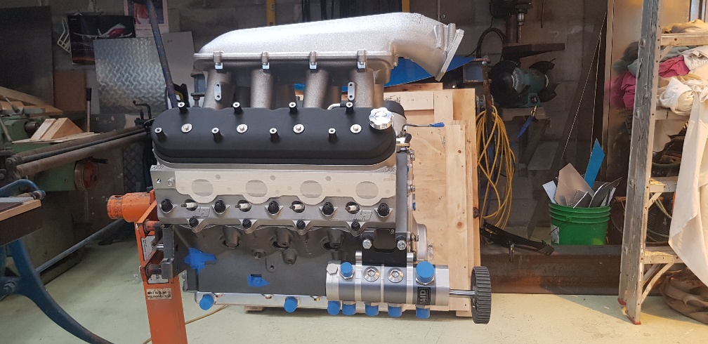

Randy meet the 427 that will exhaust a twin 255 lph pump. Hoping it will be bullet proof.
Went with Shafiroff LS 427 power adder Stage III.
Deleted the oil pump and sump as I’ve got the Aviaid LS-D 4 stage dry sump.

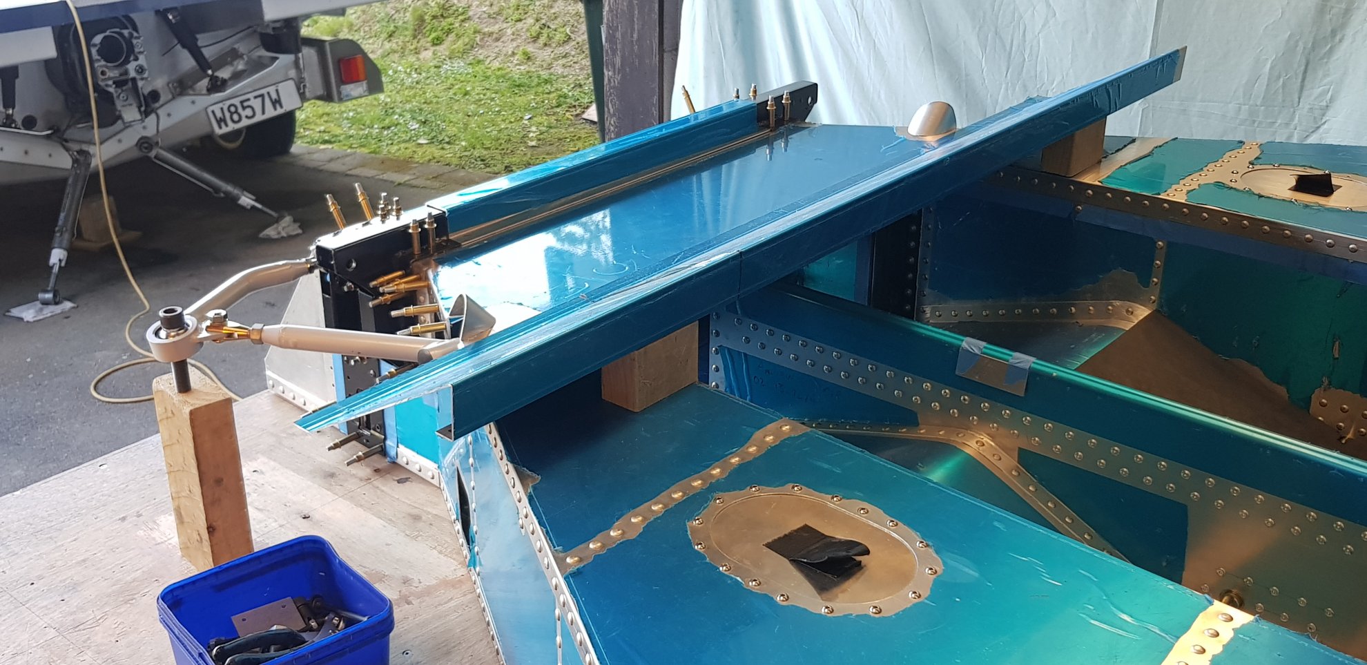

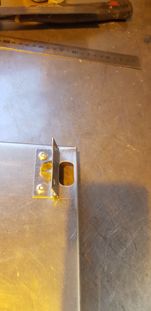

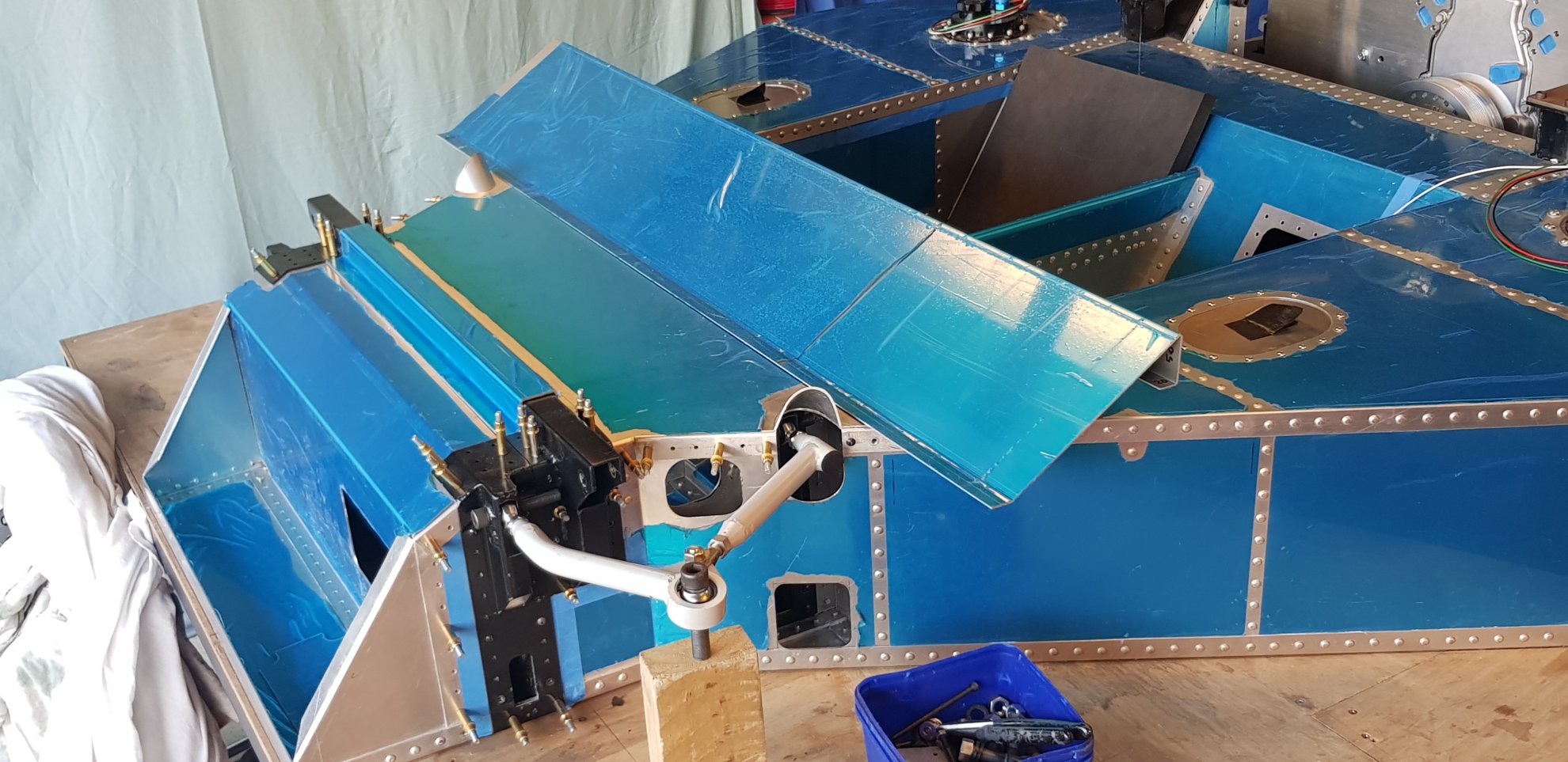

Finished 1 tank, it has 4 - one way hinges and baffling to trap fuel at the rear of tank. All welded, pressure leak tested and ready for the side pod to be riveted on.

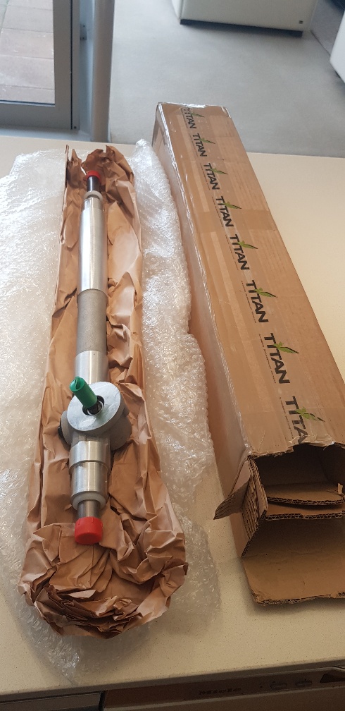

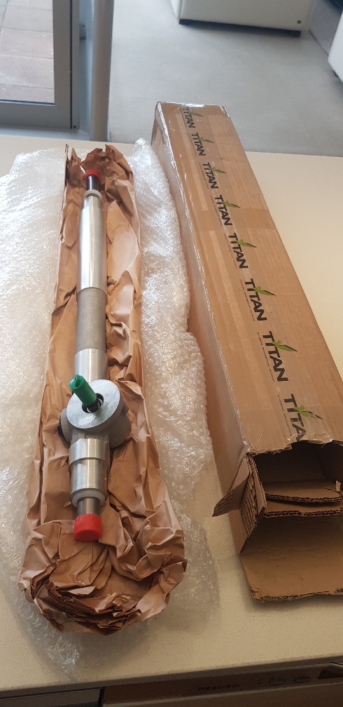

The Steering rack arrived, less the rubber gaiters and mount brackets, so that took another 10 days for them to arrive.
Still a bit more trimming needed to get the rack in the position it needs to be.
Starting to get the steering wheel, gear shifter and foot controls in a position I like. Feels comfortable sitting in it.

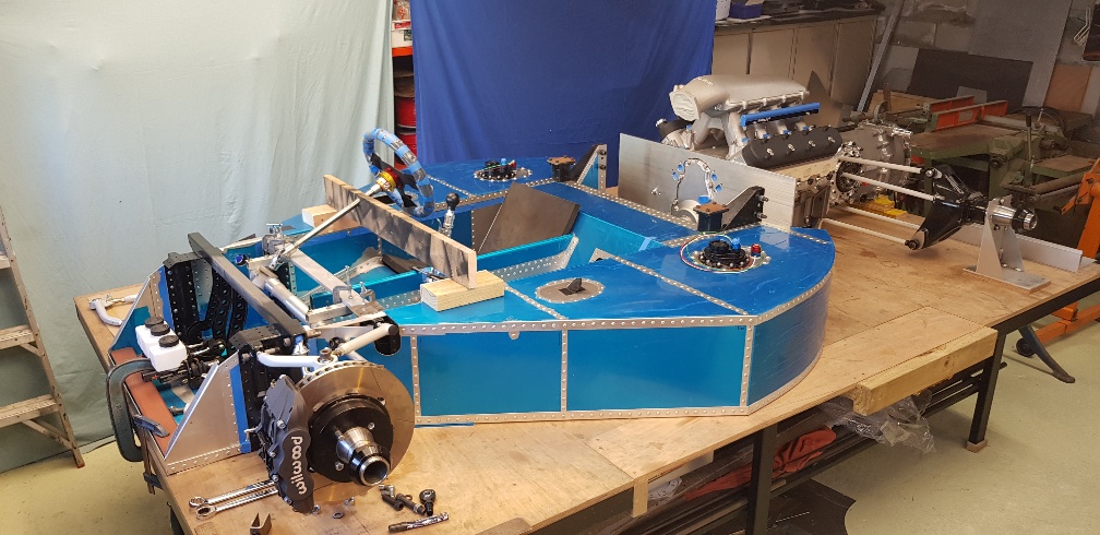

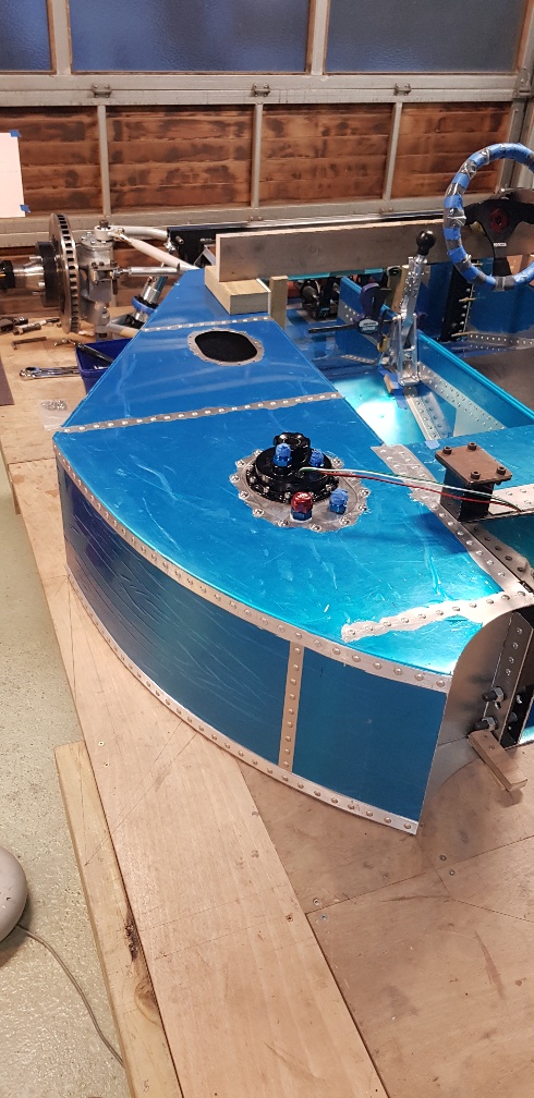

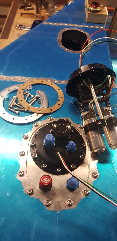

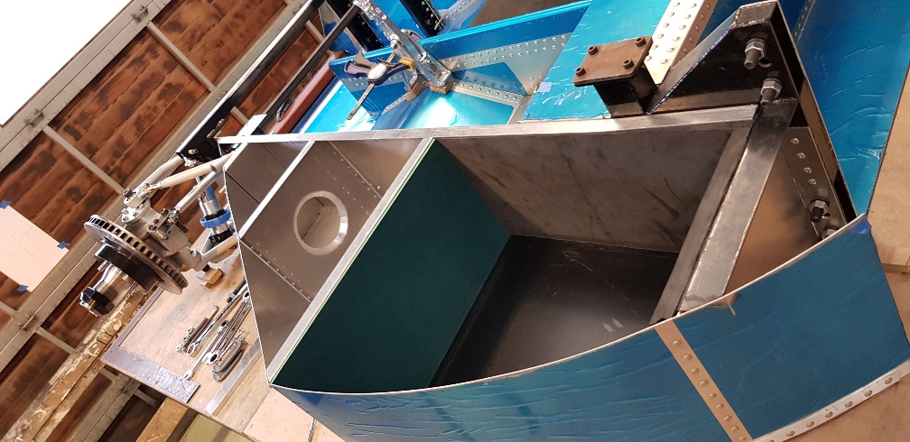

Finally got the left tank in and sidepod cover all riveted up. I coated the inside panels with a clear marine coating called Nyalic to seal the aluminium.
A Holley Fuel cell EFI Pump Dual 450lph is installed. (gasps... yes I will use the smaller 250 dual on the other side. I bought the bigger pump as who knows if E85 is in the future) Pumps can be sequentially run with EFI system. Will mainly run on 98 octane pump gas.

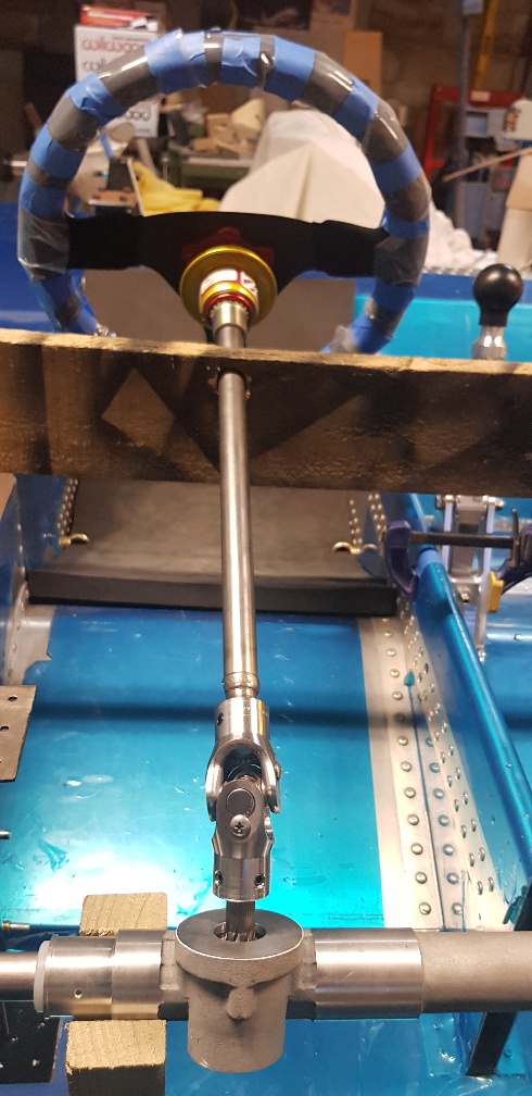

Waiting for the Woodward steering column and universal to connect to the rack.
Now onto the right side tank, the second one is always quicker...hopefully.

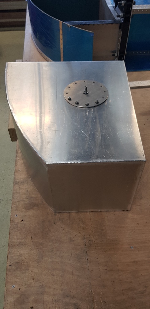

Question: Hard to tell from the photos, but curious on how the tank is assembled in respect to the sidepod/sidepod cover? Are there two flanges, one for the tank/black item, and then another for tank/sidepod cover? Wondering what/where the seals/sealant is used for future disassembly and/or access to inside of the tank, or for tank removal.
Great job on this project!
Terry
Hi Terry,
The intank pump and inspection flange all unbolt easily.
The Holley intank pump flange housing(black) sandwiches a cork gasket and the tank inspection flange
between a solid steel base flange. Bolted in with 12 cap screws and nylon sealing washers.
All in the Holley intank kit.
The side pod cover oval hole is cut exactly the same as the tank hole and drum sanded so when
bolted together they looks like 1 piece.
The Tank inspection flange is 4mm aluminum 5086, this slides in the tank and sandwiches a paper gasket
to the inside of the tank and is bolted with 14 x M8 domed SS316 bolts with nylok nuts and
nylon washers so it wont leak through the threads. There's no sealant needed.
As for taking the tank out again.....I think it can just stay were it is for some time.
It would require drilling out 150 odd rivets softening the glue with some thinners(MEK) and removing the lid.
I'll add some more pics later

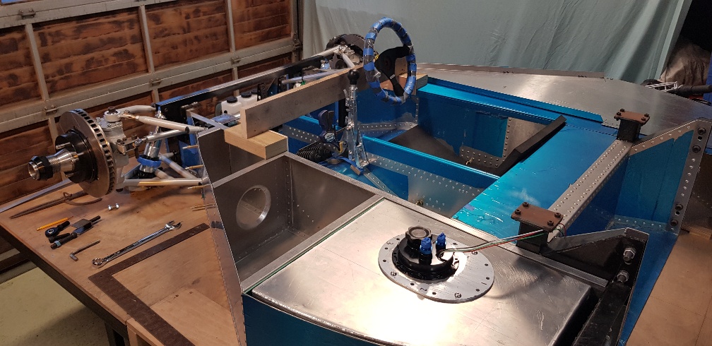

Left fuel tank (Main fuel supply) has high pressure 12AN feed and 10AN return. Also has the Jazz 12AN breather/rollover and 12AN feed from reserve tank.
I wont need a swirl tank, just a filter on the feed and pressure regulator on the return.
Steering shaft and universal has also shown up.

The right side pod is all done, tank and pump installed, all riveted up.
The steering rack and foot pedals are next, then finally the front foot well cover can be riveted in, then dash.

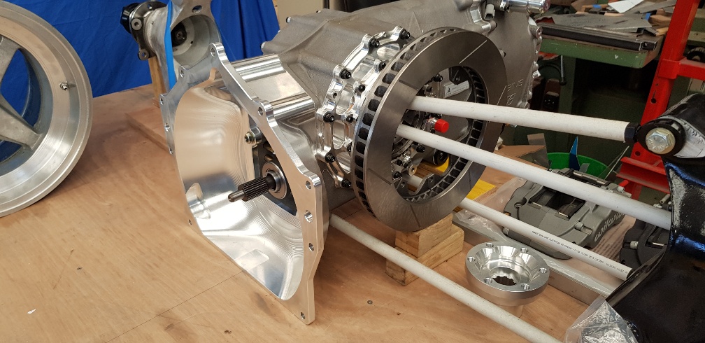

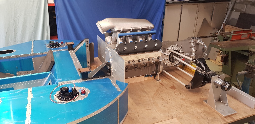

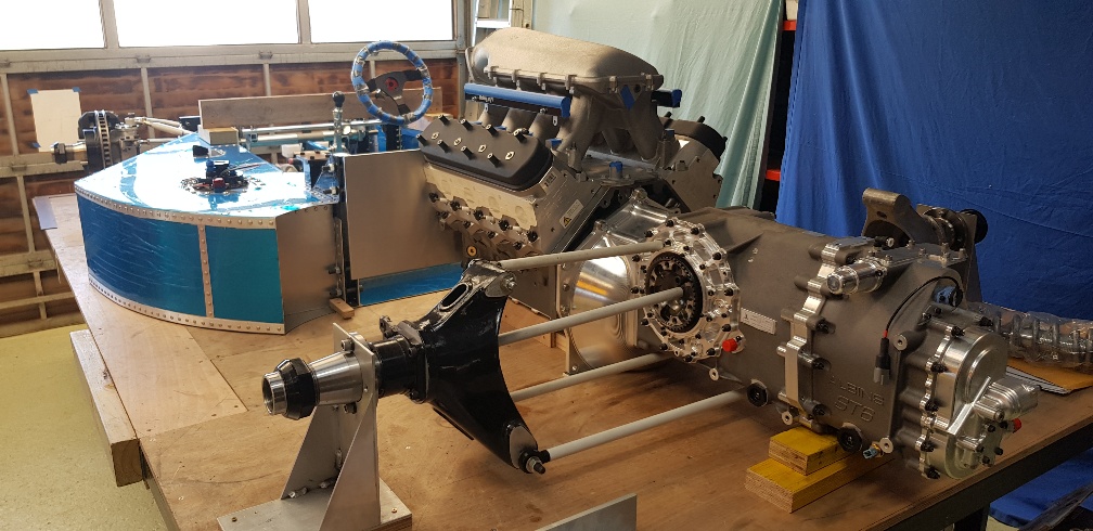

I couldn’t resist putting the motor on the table and bolting up the transaxle.
There’s 300mm in front of the motor to play with, the bellhousing is only 100mm long, original had 200mm housing, to much dicking about, and cost to extend the same with minimal benefit, More room to mount Centrifugal super charger and pipe work.

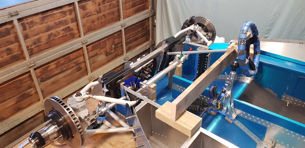

Well I'm a year plus now, things have progressed slowly but steadily. The Steering geometry took sometime to get where I am happy with, but is done.
The front footwell cover is ready for the final rivet. The dash has a couple more folds and brackets to complete.

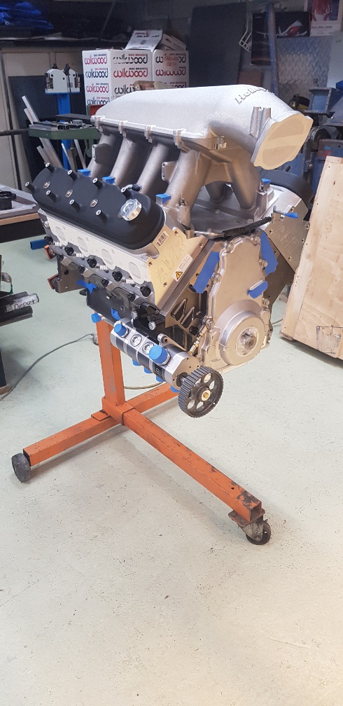

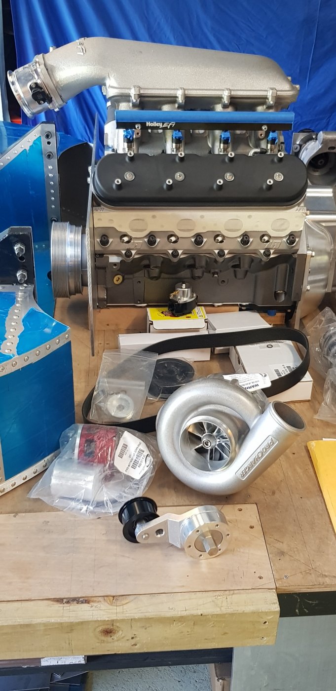

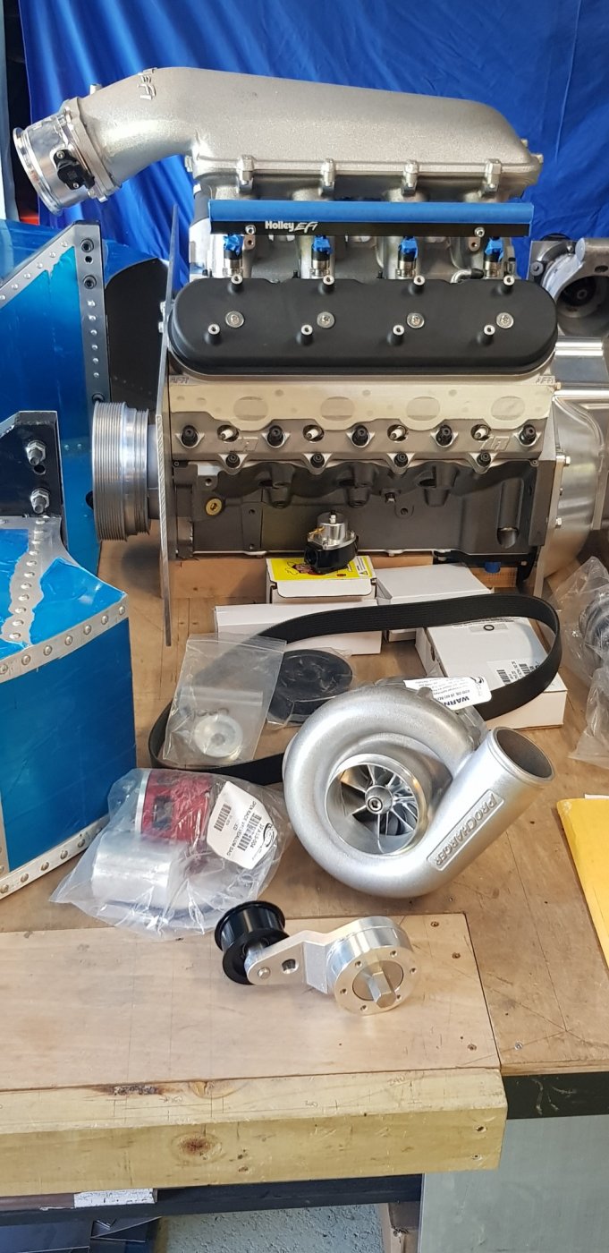

The super charger, tensioner, idler pulley, race valve and a couple of different sized blower pulleys are all here. I will make a custom front engine plate from 20mm aluminium to mount super charger and accessories to.
Holley 120lb fuel injectors are inplace and the 105mm mono blade Throttle Body is mounted via a custom mount plate. I foolishly thought the Holley 105mm TB would just fit Holley 105mm Hi Ram manifold....not so. Fuel reg and filter also turned up.

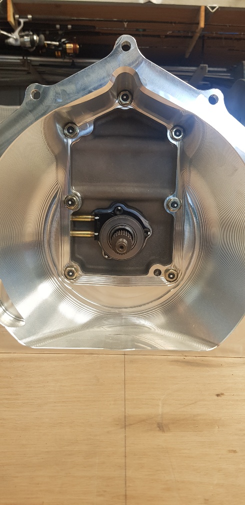

Albins have designed a new bellhousing that uses Tilton 52 series flywheel. 7.25" clutch. Stepped 3 plate and trans side starter, they have been great. Which will mean wheel mounted discs, not inboard. Keeping at it and all the other things.
Andrew.
