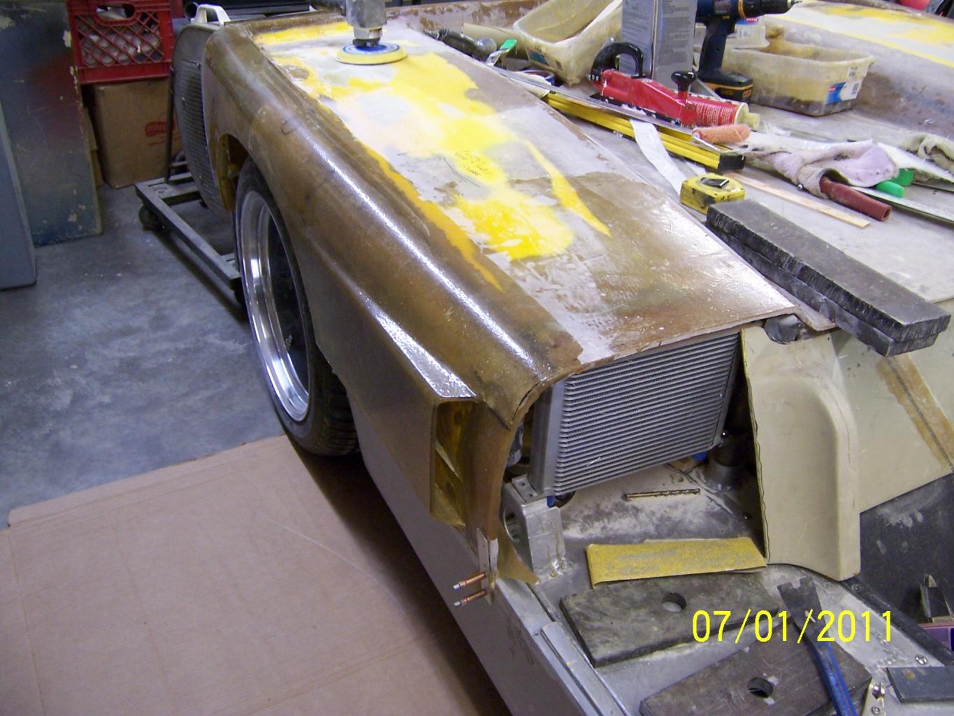

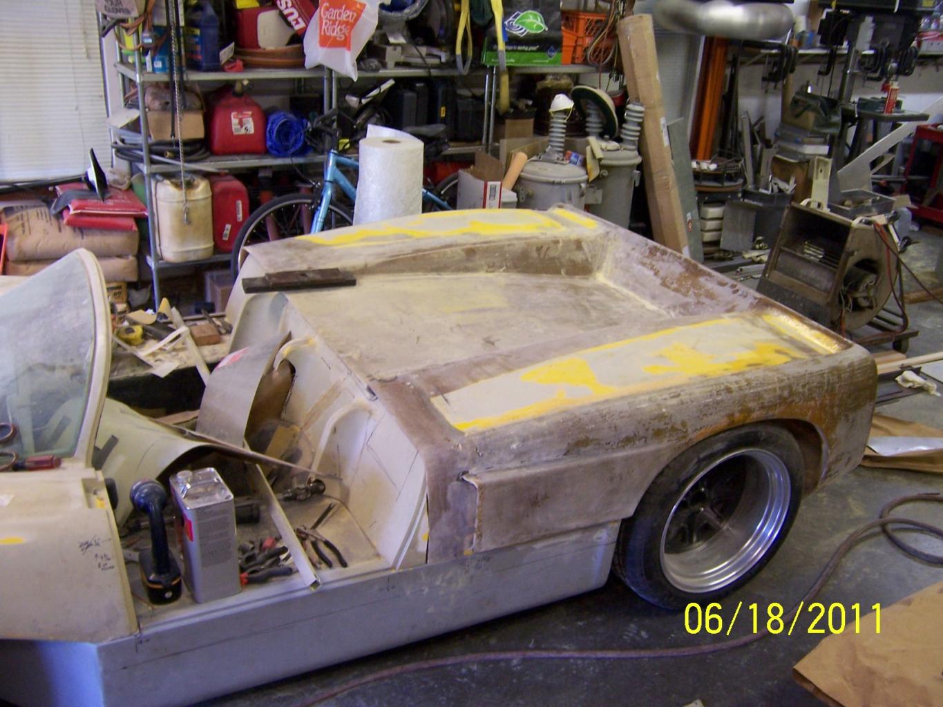

A bit more progress now that the summer heat facilitates the fiberglass hardening process. Finally eliminated that hermaphrodite sculpturing over the wheel arches and produced something more aligned with the M8 series.

Amazing progress Terry.. You have come such a very long way with this car.. It will be a work of art!
Hi Terry, good to see some more progress. Are you just Fabing the class as you go?? That makes for a lot of finishing work but it seems to be going the right way and looking less like a Manta with every every stoke of the resin brush. Looks good man Keep it up. Cheers Leon.

Yes. Either way, make the buck, or make the body, is a lot of work. Finishing doesn't bother me too bad, and is actually the fun part once the
'shape' is finalized.

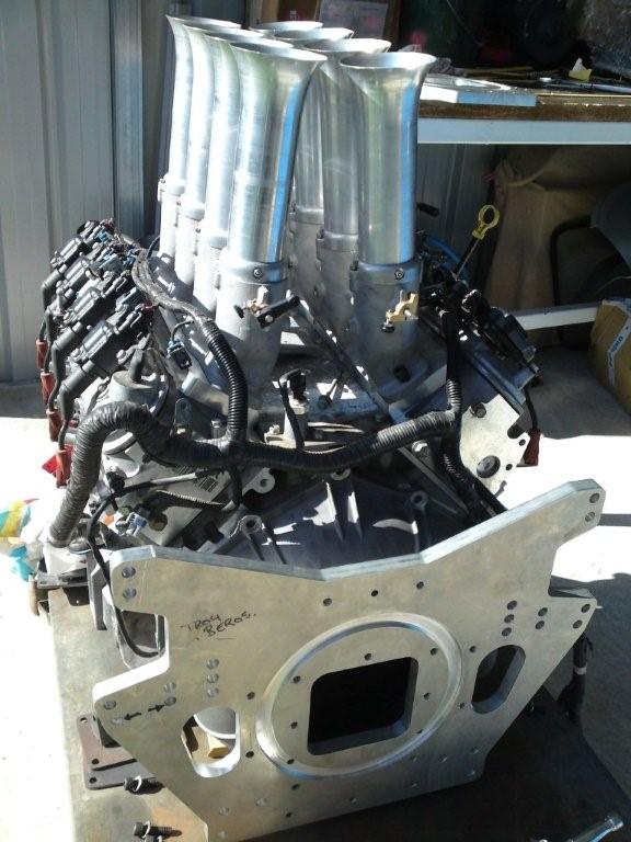

Great work Terry. As far as the NACA ducts go, you can buy some from Pegasus Racing or a number of other suppliers that are preformed to an outlet. That's what I used on my racecar and they worked like a champ.
Now all you need is one of those honkin' TRACO Chevy motors with 18 inch velocity stacks!

Nice adaptation Troy! I've fabricated a similar setup, only much smaller (48mm) with 2.5" dia, 12" long stacks, on a "home-made" manifold and salvage ITB setup.
I know, I almost copied it! This set-up is adapted from a 392 Hemi. (Yes, I need to shorten the stacks by about 6" or so). By the way, what ever became of the cross-over headers you made?
