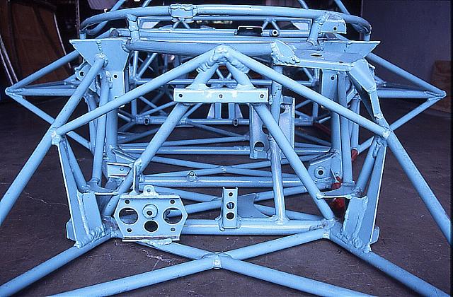

The frame was rather badly welded and had pressurised gas inside it. A pressure gauge was then put on the frame and if the pressure went down then the drivers got out as a crack would have developed in the tube frame... had some pictures of a frame from an original 917... see if I can find them.

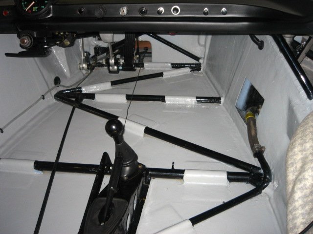

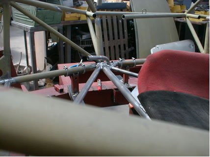

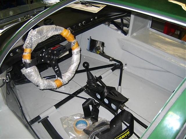

Hi guys
running oil through the chassis on racing Porsches is not unusual here are pictures of a 906 chassis showing the oil tubes going into and out of the chassis rails.

All of the original 917s used the main top and bottom chassis rail to carry the oil from short flexible hoses at cooler and engine ends. This was a complete no-go as far as Gulf/Wyer etc teams were concerned as the frame would crack at various points on a regular basis thus making a hot oil spray a distinct possibility, especially in the event of a shunt. The chassis were subsequently gussetted at the weak points and long flexible oil lines run through the cabin on the passenger side, into the sill area and into the engine bay.
This i have done with my own car and all subsequent builds will be that way. The scrutineers will not accept any fluids running in chassis tubes on reproduction cars for racing. I,ve tried !!
The main chassis rails were pressurised and used a small Schraeder valve mounted on the upper cross member and a gauge mounted in the cockpit, usually on the passenger side sill, but sometimes on the dash. Loss of pressure was frequent !!!!

Does anybody know who's owns chassis in the 917 photos above?
Two additional "chassis" were made in High Wycombe when the Piper car was
dismantled and overhauled. One was sold and apparently went to Switzerland and then the U.S.A., and the other is still in the UK as a spare - unbuilt I believe.
It may be unfair to lay the blame on seemingly bad welding on Porsche as the tube used was a one off and apparently a pig to work on, and if the photo is one of the two "replicas" [for that is what they were - identical in every way right down to the tubing] then they were never built by Porsche in the first place. Fran might know better than me.
Dave, the chassis is own by Carl Thompson and is build up by himself (see the link above) and had the body work done by Gunner Racing (see their past projects). The frame is aluminium tubed and if I remember right it was exbition piece at the reception of the frame manufacturer. Carl Thompson bought it in Switzerland in 2003.
