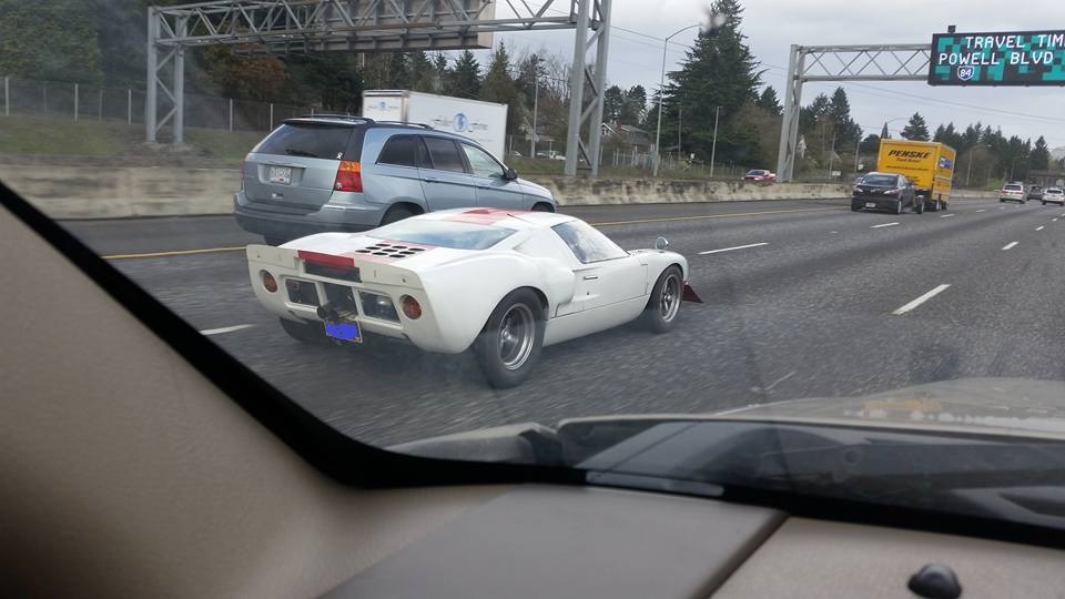

Been doing quite a bit of work to try to weatherproof the car and thought I had made a bit of progress. I knocked out 100 miles on Thurs (at least according to the odometer, which I believe to be a little optimistic- but the speedo is fairly accurate...). Part of this included driving in an absolute deluge, during which I did get water into the cabin, so back to the drawing board. I think I am on the right trail though.
The rain was quite late in the run though and I can honestly say I had a fantastic trip. I got onto a few roads on which I hadn't been before and thoroughly enjoyed them. It was definitely a bonding experience with the car. No crazy speeds, but got to lean into the corners a bit and that sound is still symphonic...
Interestingly enough though, today (literally, the next day), a friend sends me a link to facebook, of someone who posted a pic of the car on the freeway. It's my 15 seconds of fame!
Regardless, more proof it moves. Things are good here.
