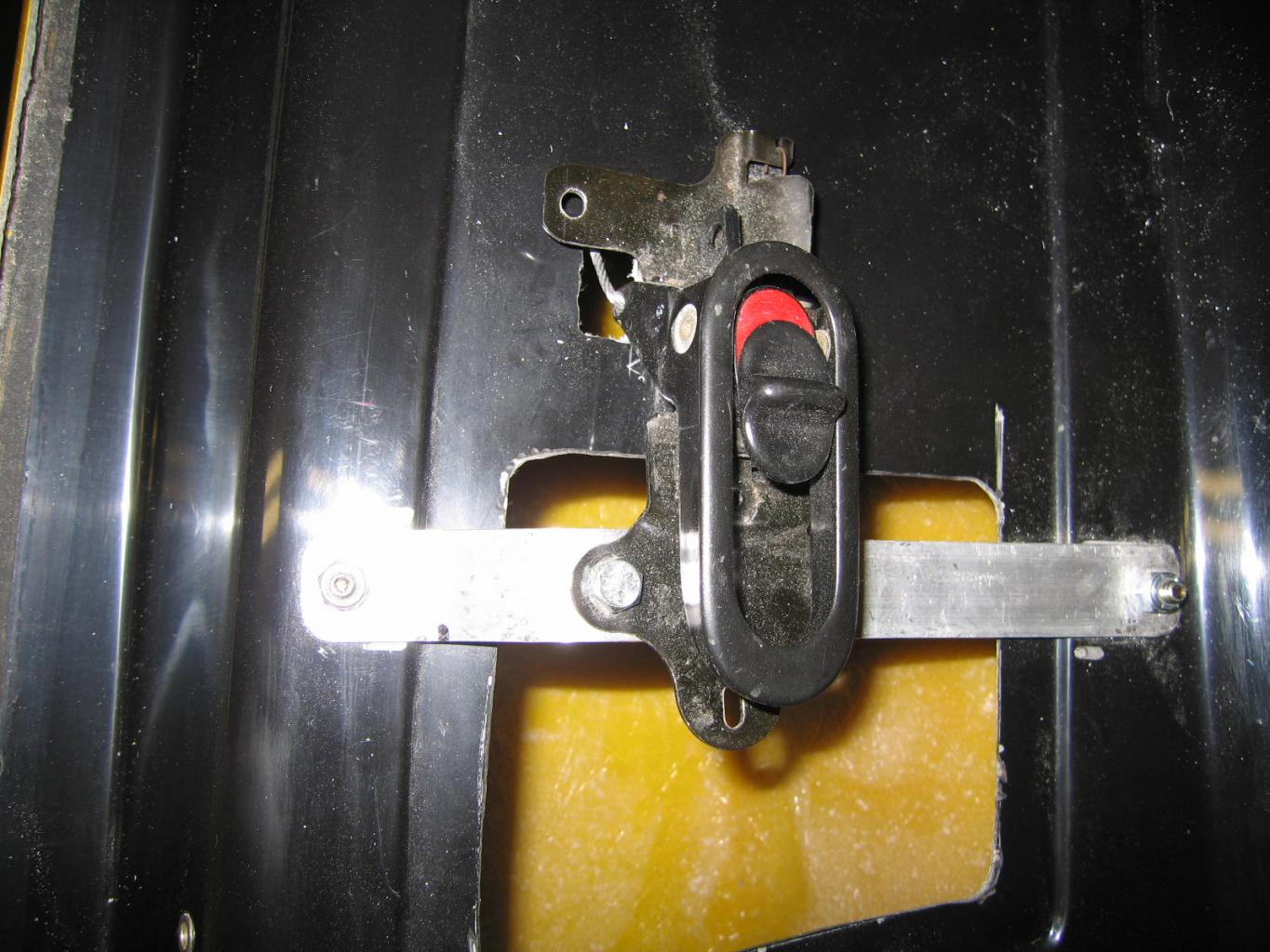

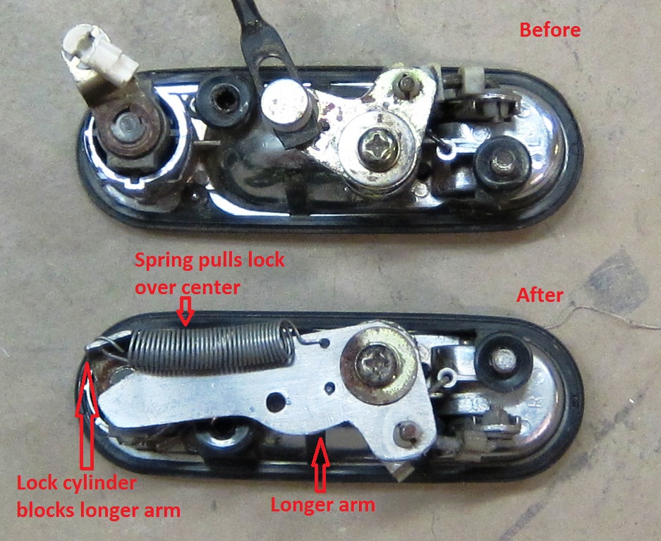

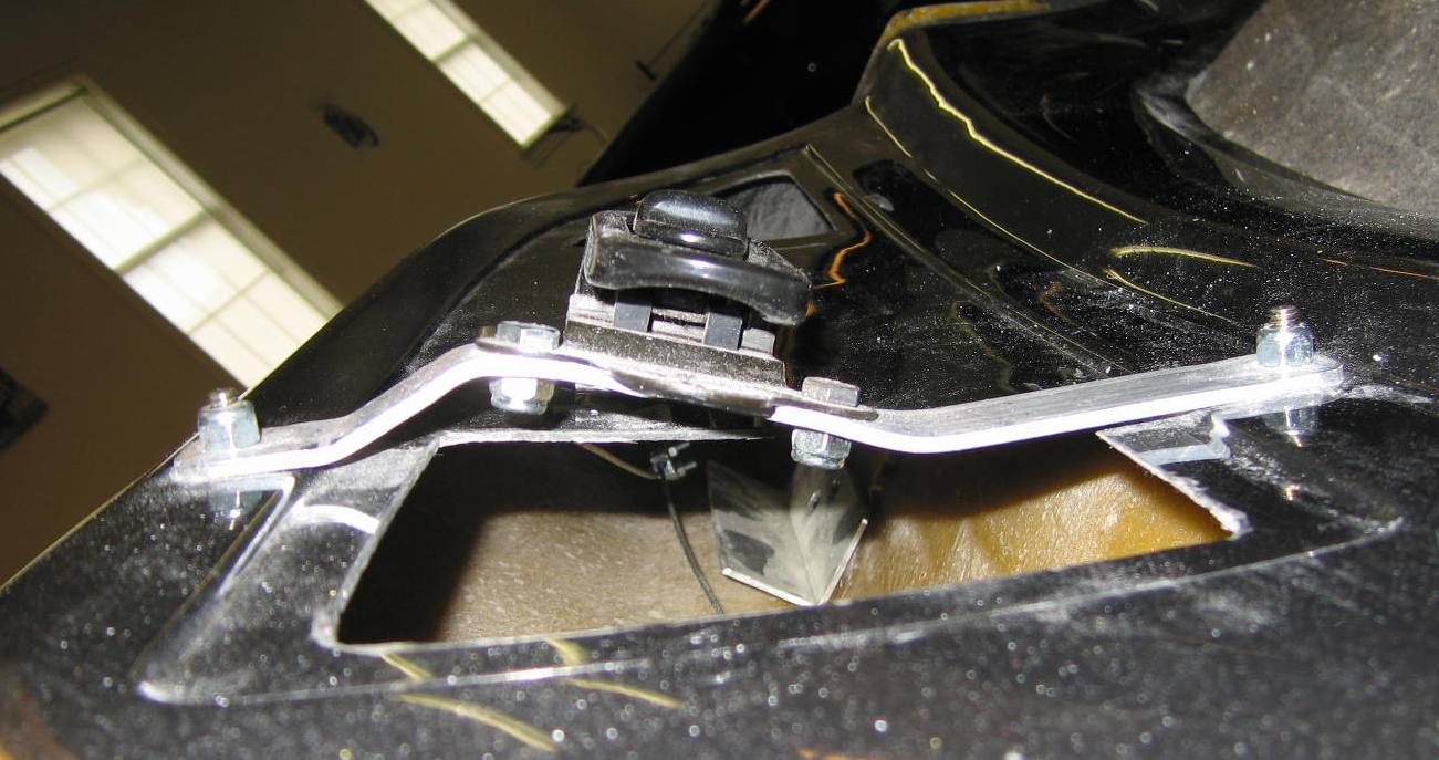

  • I installed the external door handles and modified them so they lock.

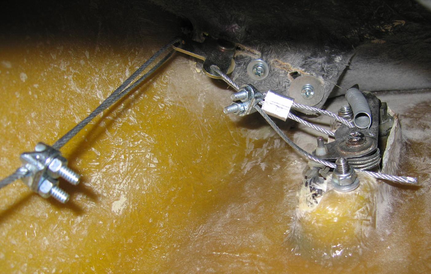

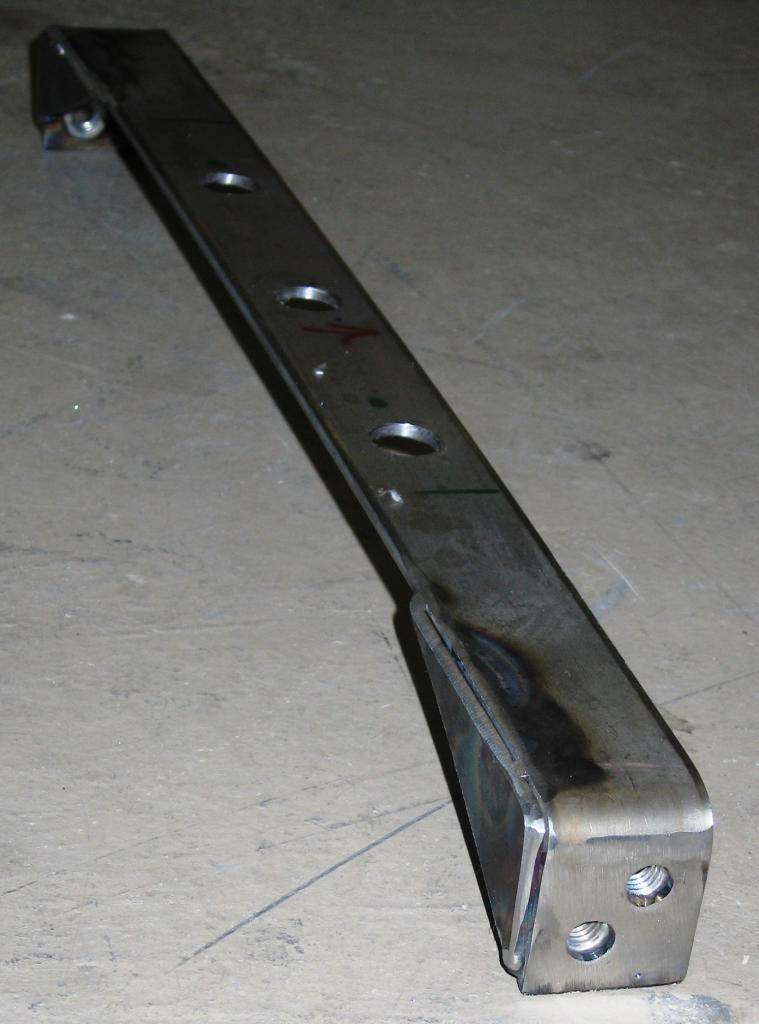

  • I innstalled the internal door panels. That includeds fabricating brackets for the interanal door handles.

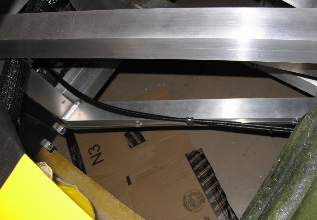

  • I install the internal cables between thew bear claw, ijteranl door handle, and external door handle.

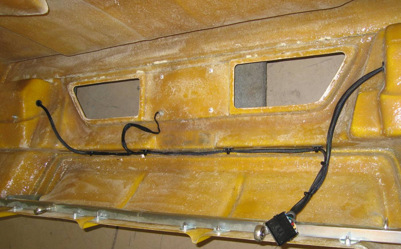

  • I fabricated the tail wire harness. Since I modifiesd the ISIS harness routing, it did not reach the tail. I added a weather pack connector so the tail can be easily removed.

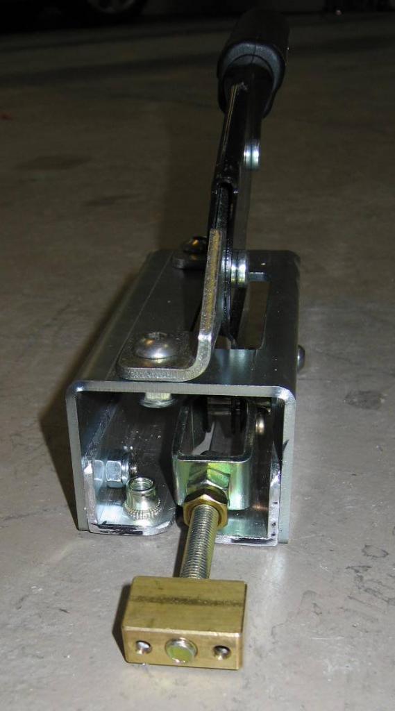

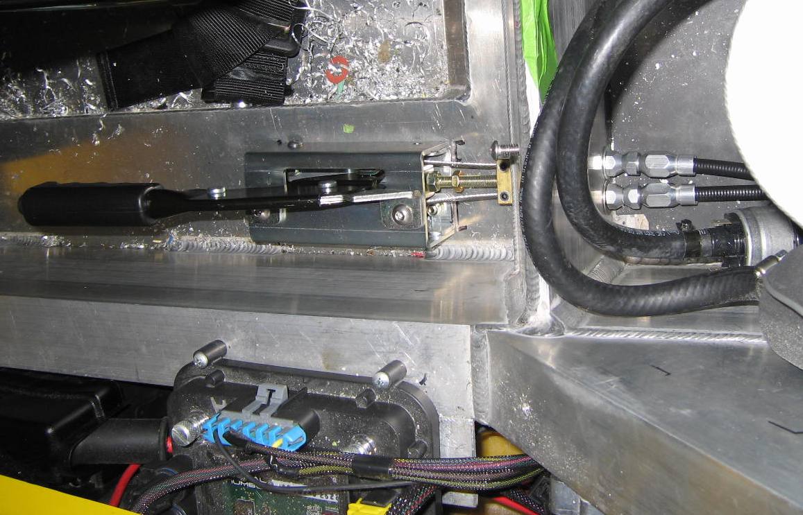

I got my e-brake cable from RCR and installed it today. I decided to mount the e-brake handle on the left side of the cockpit, and to keep out of the way of driver entry/exit.
  • I fabbed some hidden brackets for the e-brake handle. The clearance on the right rear is limited by the movement of the cable clamp, so there is no room for mounting screws on that corner.

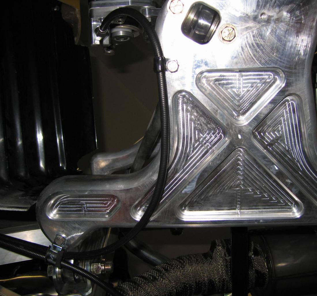

  • I mounted the individual cable adjusters from within the fuel management compartment.
  • The cable must be secured to the bottom of the lower A-arm to keep it from rubbing the wheel.
The finished e-brake system seems to work smoothly and has good holding power

I also recently mounted mine to the left side of the drivers seat. The passenger side ES cable length fit fine. The drivers side cable I shortened. And yes, the cables will rub the inner wheel if you do not secure them up and against the lower control arms. My passenger side caliper is too loose and won't grip though - even with the using the caliper adjustment bolt - so at the moment only my drivers is locking down. I have to revisit that caliper that is not clamping to see why I can't get within feeler gauge space spec. The issue is not apparent at the moment....
Both my calipers are clamping well.
You mentioned that you tried adjusting the "caliper adjustment bolt". If you are referring to the adjustment bolt on the caliper, that is for centering the caliper on the rotor.
It sounds like your passenger side cable was a little loose when you tightened the set screws on the cable pull block.
With e-brake handle down, have you tried loosening the set screws on the cable pull block, and then pulling any slack in the cable with pliers as you re-tighten the set screws?
Bill did the cables come cut at the required different lengths? Or were you able to shorten them as required?
No Ken, the cables do not come pre-cut to length. You must custom cut them to accommodate your routing. I 'm in the process of installing them now and like others have posted, I too located my brake handle on the drivers side; it appears that I will have more than enough cable.

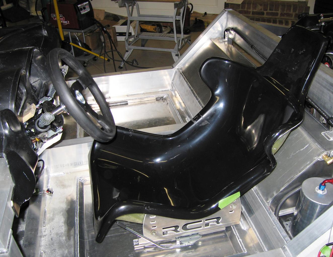

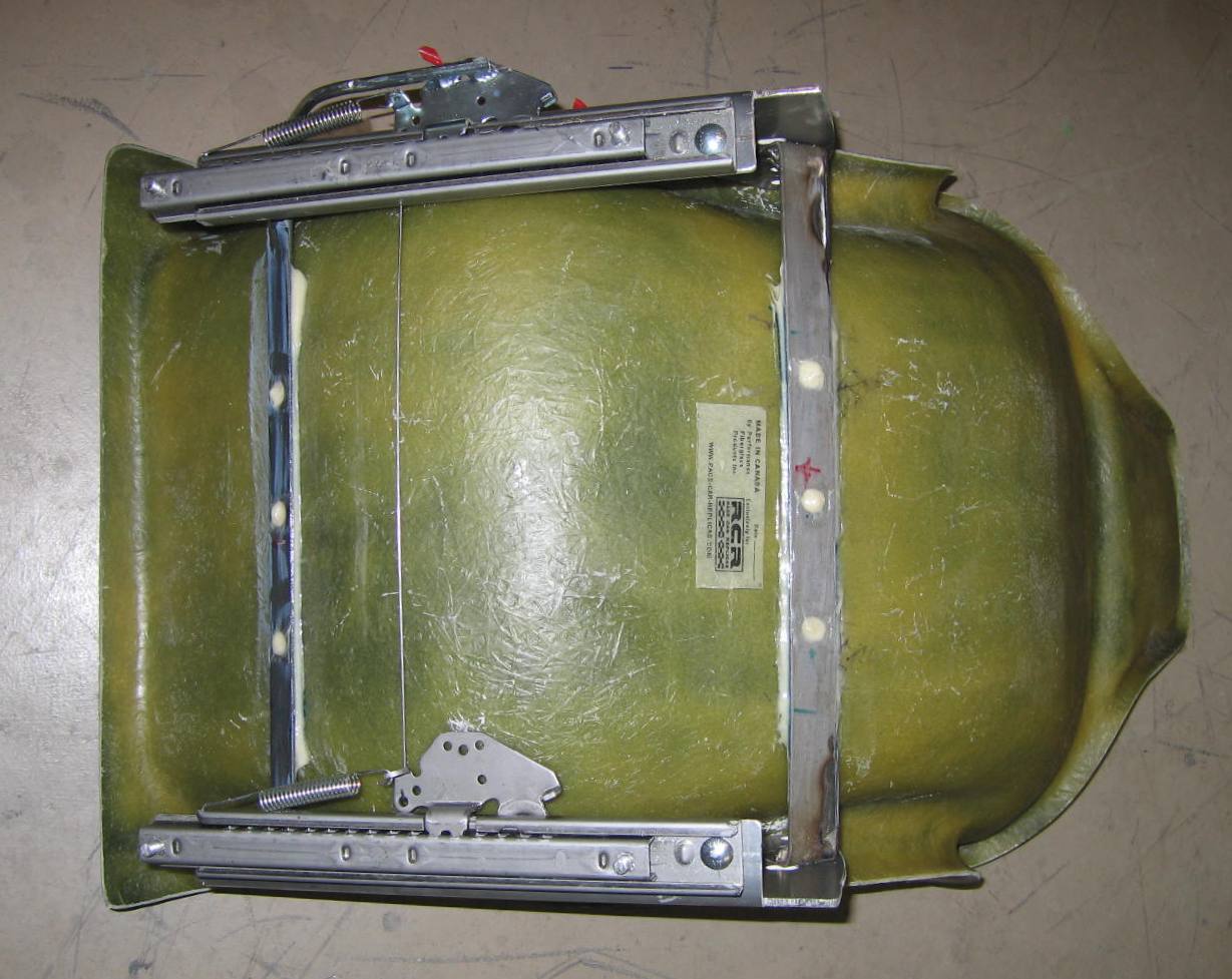

I fabricated my seat cross braces and sliders a long time ago, but I finally glued it in this week.
It turned out to be quite a solid.

Bill, what sort of epoxy did you use to glue the seat to the cross rails? It looks as though you glued the rails accross the bottom and bolts the seats to the side brackets that bolt to the sliders.
I've been watching the Patrick Dempsey mini-series also. It's actually a lot more interesting than I thought it would be.
Yup, I had my doubts about a TV star in the racing series, but it's more engaging that I expected.
I attached my seat bottom with West Marine epoxy resin (105/205) mixed with 406 Colloidal Silica.
