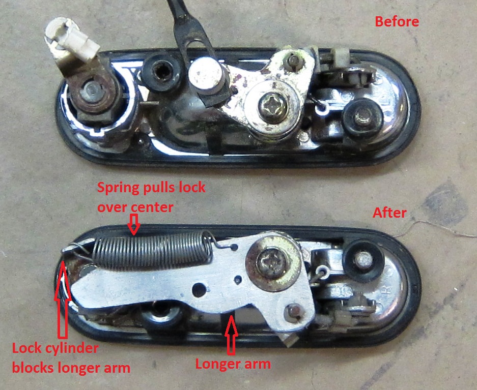

A while back I bought a 1990-1997 Miata lock set, so I only have to carry 1 key for both the door locks and ignition. As I looked closer, I realized that the Miata outside door handles depend upon the bearclaw to lock the door.
I modified the Miata outside door so it now locks. Its a simple change that involves fabricating a lever, adding a spring and drilling a few holes.
Checkout this YouTube video: Modifying the 1990-1997 Miata outside door handle so it will lock

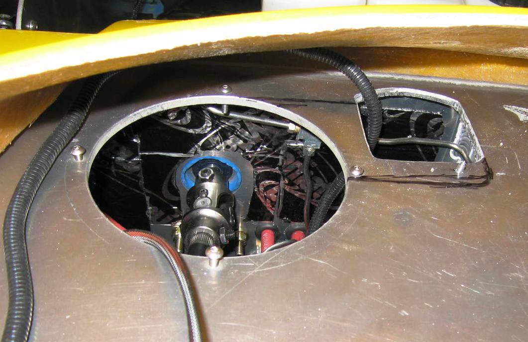

I cut a whole in the aluminum foot well for the wiper motor, but its not big enough, if you add the recommended 1/2" spacer to the arm shaft.
I used a black marker to show the enlarged hole that would include the round access porthole. That's a big hole!
Will a hole that large weaken the aluminum chassis?
If the wiper shaft hole in the spyder section is moved upward by one-inch, and a little more centered, you may be able to avoid cutting the top of the footbox. Or make a very minimal cut.
There were two part numbers for those AFI Marine wiper motors. One with a long shaft and another with a shorter shaft. I assume that you have the long one. I purchased mine aftermarket (short shaft). I don't know what RCR is supplying at the moment.
Bill, it should not weaken anything significantly enough to worry about.
A few builders have cut 8"x12" holes for the non-standard Manex air conditioner evap unit without reported issues. The primary load bearing structure in that area is provided by the cross beam under the dash.
The threaded portion of my wiper shaft s 2". I looked up AFI Marine wiper motors and they range from 1.5" - 3.5".
It is the 1.5" long shaft that works best. No footbox holes needed. It just clears
when installed at the correct angle. There are some photos out there somewhere, I'll have a look.

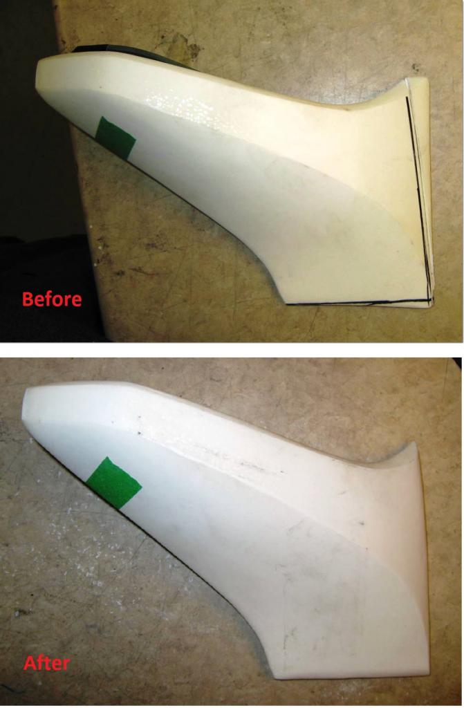

I installed my Hippo mirrors.
It was pretty straight forward. The only modification was to the passenger mirror pod. Like most cars, the passenger mirror needs to angled more to get a good view down the right side. That makes the outside edge of the mirror stick out from the pod, so I made an angled cut the passenger hippo mirror to accommodate.
The driver and passenger mirrors are far enough apart so the difference is not noticeable.
They are solid cast resin, so they cut and shape easily. I used a hack saw to cut it, a file/rasp to shape it and then sandpaper for the final touches.
The metal screw inserts are the real bugger, because the thin Allen head end tends break apart when installed. Drill the holes larger than barrel and lubricate the insert with liquid soap before driving it in.

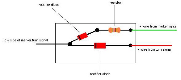

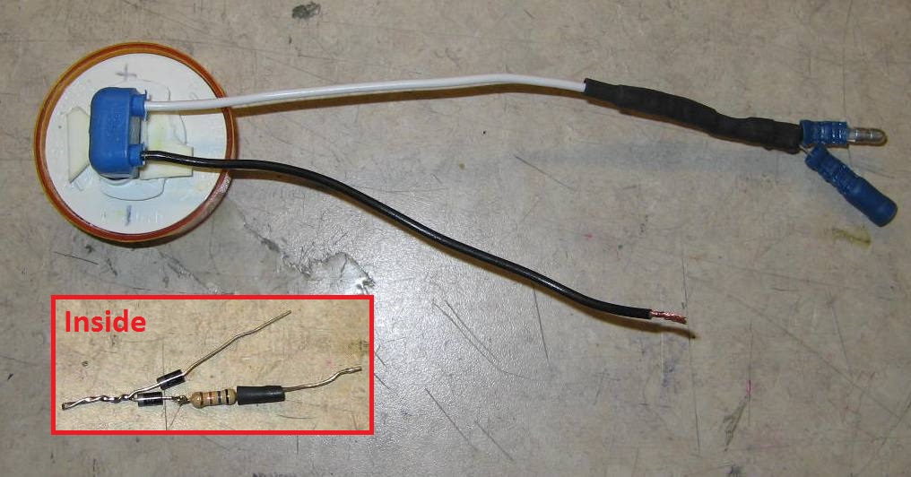

Problem: The front indicator lights only have 1 LED, yet the ISIS system has separate parking and signal wires which require a separate LED for each.
Solution: Here is a $5 solution. Go down to your local Radio Shack and buy:
  • 2 560ohm Resistors (PN:271-1116)
  • 4 Diodes (PN:276-1102)
Connect the circuit as shown in the attached diagram and then splice it in to the light wiring and cover with heat shrink tubing to protect it.
Job done...

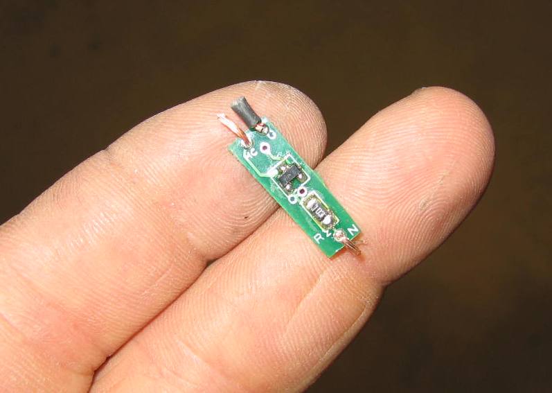

Speaking of electrical idiosyncrasies, I went round and round trying to get my Hurricane HVAC unit to work with the ISIS system. The "ahhh-haaa" moment came when I found this tiny circuit board hidden inside heat shrink tubing, midway up into the electrical harness.
The ISIS system only understands switched ground inputs, but some inputs are 12V (like from the Vintage Air HVAC). This tiny transistor circuit board converts a 12v signal to a ground signal, so ISIS can understand it.
The connections are:
  • The upper left wire goes to ground
  • The lower left wire goes to the 12v switched input
  • The right wire is the switched ground output to ISIS
Please, no criminal background checks on the fingerprints:vanish:
