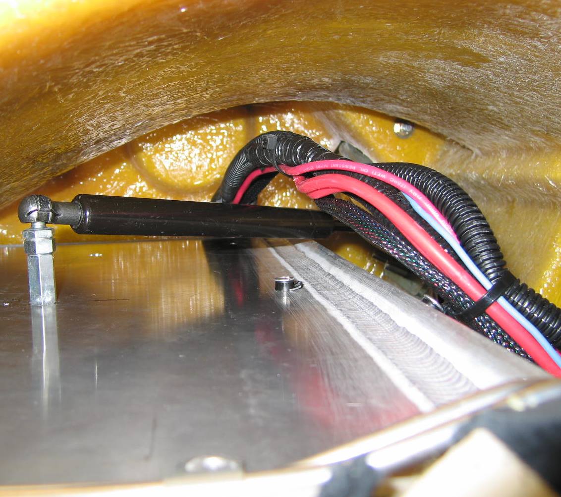

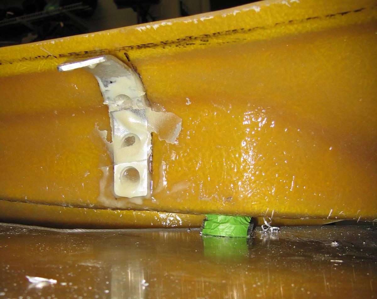

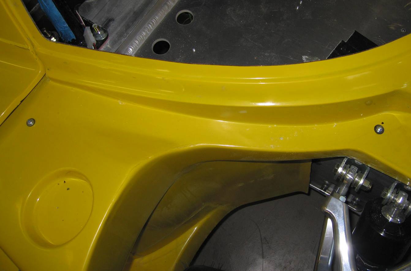

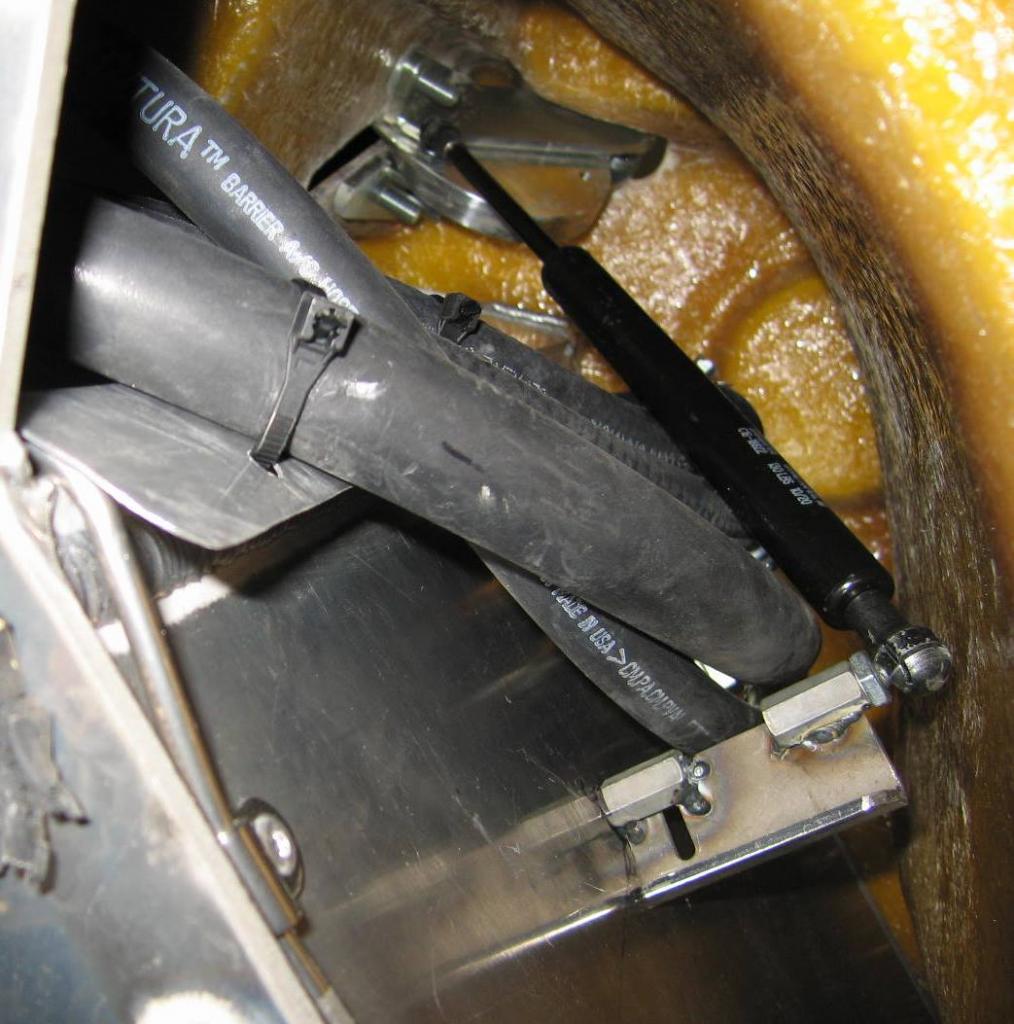

I got my door gas struts installed.
There are some templates floating around for where to drill the hole for the lower strut mount. I found it easier to:
  1. Remove the door
  2. With the strut attached to the door arm, extend it to the full open position
  3. Place the other end of the strut against the foot well about 8" up from the bottom, and mark it. This will account for any variability you may have depending on where you positioned your body on the chassis.
  4. There isn't enough room between the body and footwell to drill the hole. Measure the horizontal/vertical position of the hole and transfer the mark to the inside of the footwell.
  5. Assume your transferred mark will be somewhat close, but will probably not be exactly where you want it. So drill and very small peep hole and place a light in the footwell to see where it lands on the outside. Then adust as needed for the full size 5/16" mount hole.
You will need some sort of spacer on the footwell mount for the strut to clear the edge of the chassis. I found that a 1" x 5/16" coupler does the trick and is a common item at most hardware stores for about $1.
On the driver's side I needed to reroute the electrical harness to clear the strut. On the passenger side I fabricated a taller spacer to clear the HVAC hoses. The spacer bracket has a wide base to support the 130lb force. I also added an abrasion guard to protect the HVAC hoses from the sharp corner of the chassis.
The 12" 130lb struts seem to work fine with the door panels and hippo mirrors installed.
The 130lb force of the strut causes some body flex when opening/closing the door. The flex is especially noticeable in the windshield frame. I don't know if slamming the door could cause stress on the windshield. To be sure, I added body mounts toward the front of the windshield frame. The body is quite solid now with no noticeable flex.

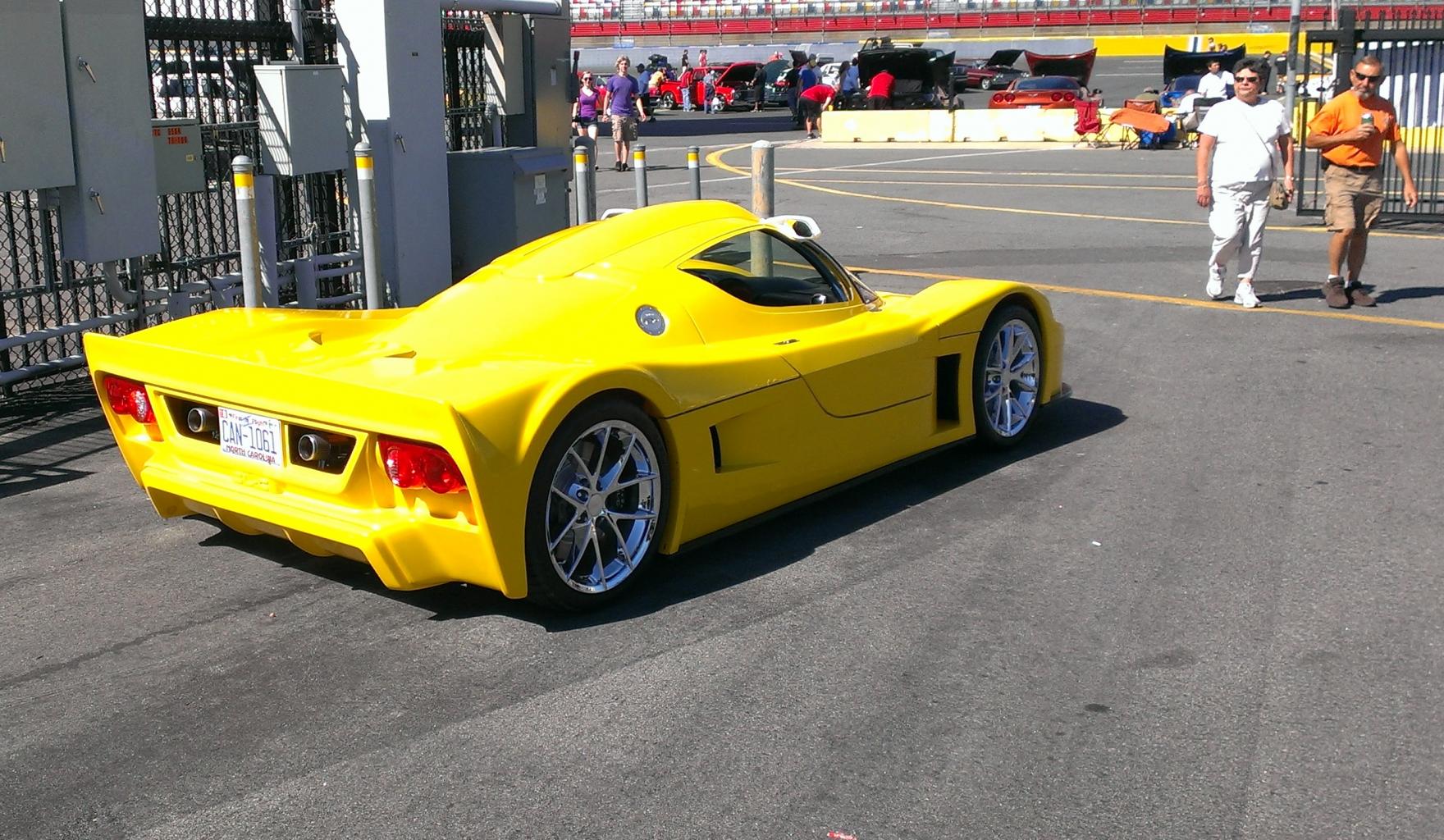

I had a great weekend at the Charlotte AutoFair.
As you might have guessed, my SLC got a lot of attention and was the target of a "click, click, click" photo-fest for most of the day. Here are some PICs of my SLC in a rare moment at the end of the show when it wasn't surrounded by spectators.

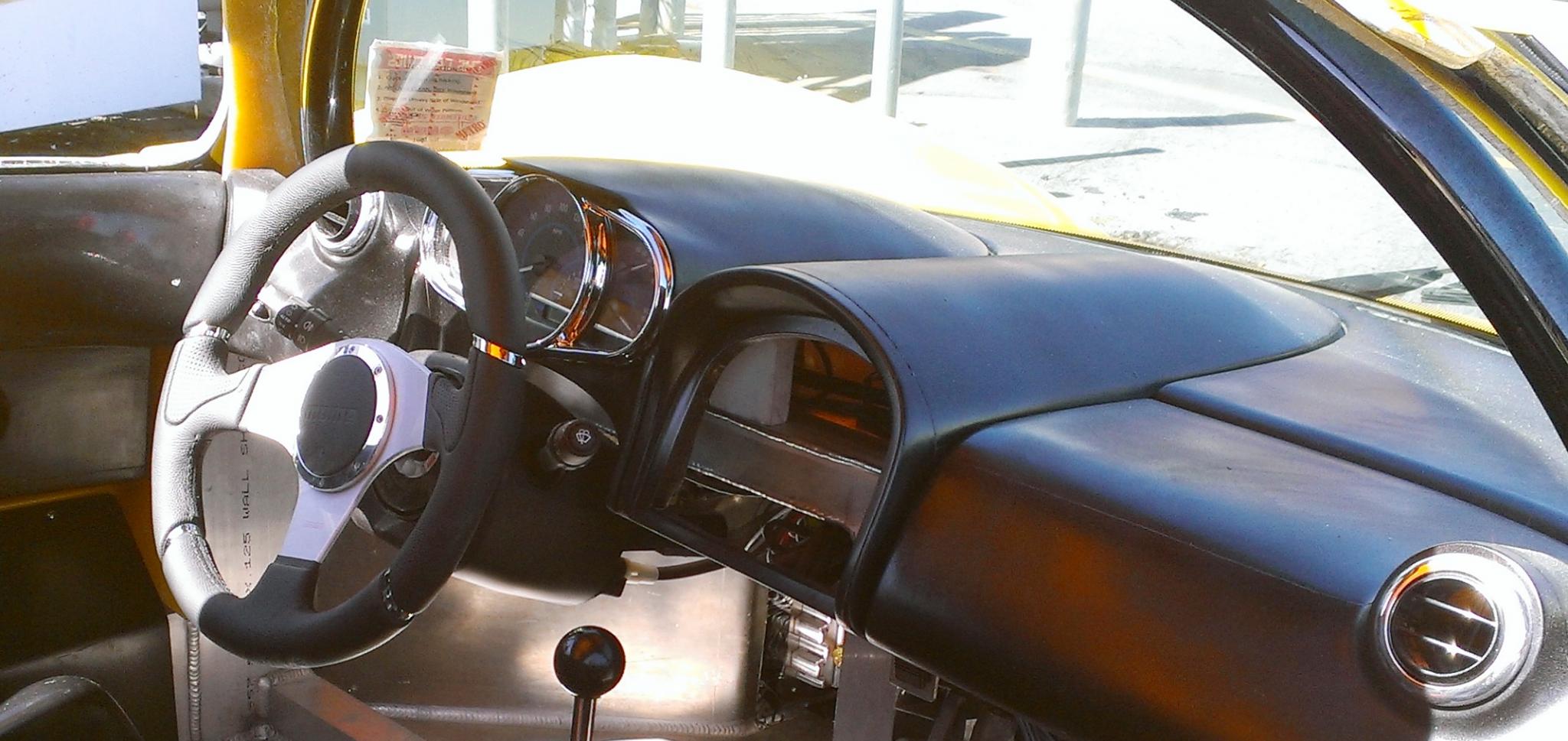

In the interior PIC, you can see that I modified the dash and went with a different gauge cluster

Yup, that is the Dakota Digital gauge cluster I used.
It comes with its own senders for oil pressure and water temp that work well with the LS engine.

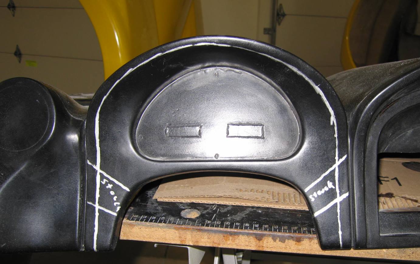

The gauge cluster just barely fits within the width of the driver's pod on the dash. I cut the pod's sides way back to fit the gauge, and then fiberglassed the sides back in. I left the pod's upper lip and shaped it into a visor.
When I retracted my steering column, the left/right stalks would ram into the stock dash. So I also cutout the section under the gauge cluster and recessed it forward to add clearance.

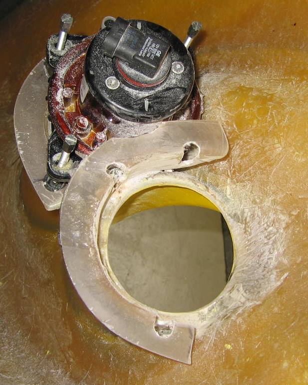

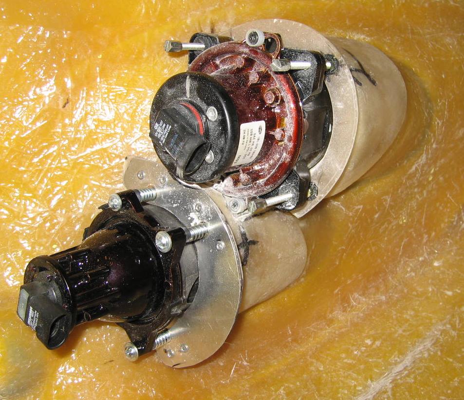

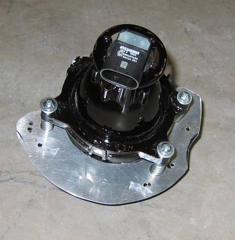

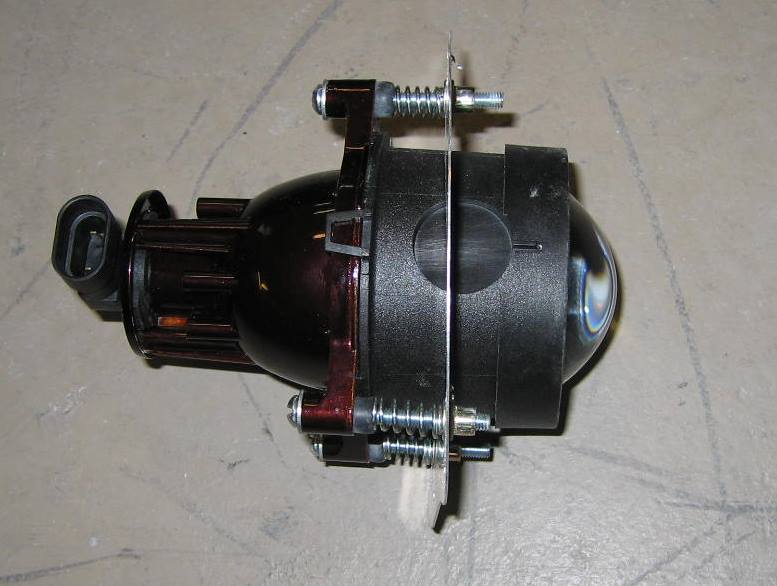

You may have noticed in my AutoFair Cruise-in PICs that I put used 60mm high beams. They require a little fabrication.
  1. I glued the standard SLC fiberglass light cups to the nose.
  2. I used the springs that came with the 60mm lights, but replaced the screws with long 10-32x2" screws. I then made a mounting plate from thin aluminum sheet with 10-32 rivnuts for the adjustment screws. The thinking is that the thin sheet will flex to allow the angle of the adjustment screws to skew as you aim the lights.
  3. The SLC light cups were cut to allow the rivnuts and screws to pass thru.
  4. Lastly, I used 2 rivets near each of the adjustment screws to mount the aluminum mounting plate to the fiberglass light cup.
The result is a solid mount with a good range of adjustability.
