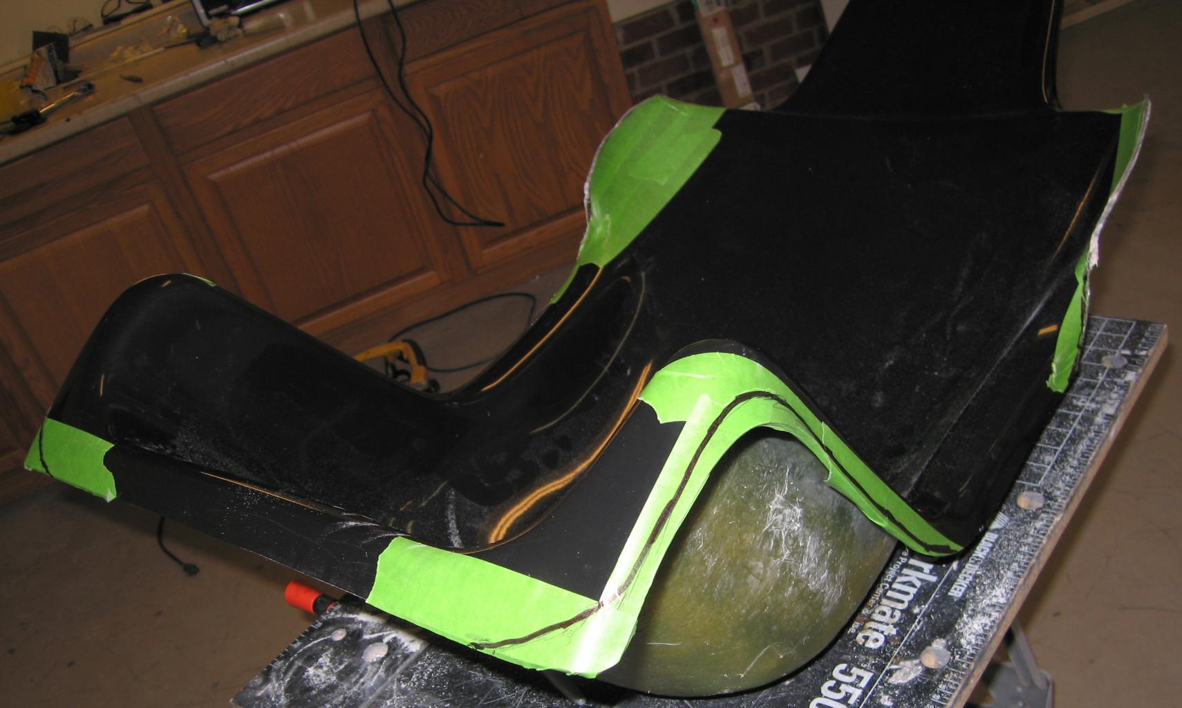

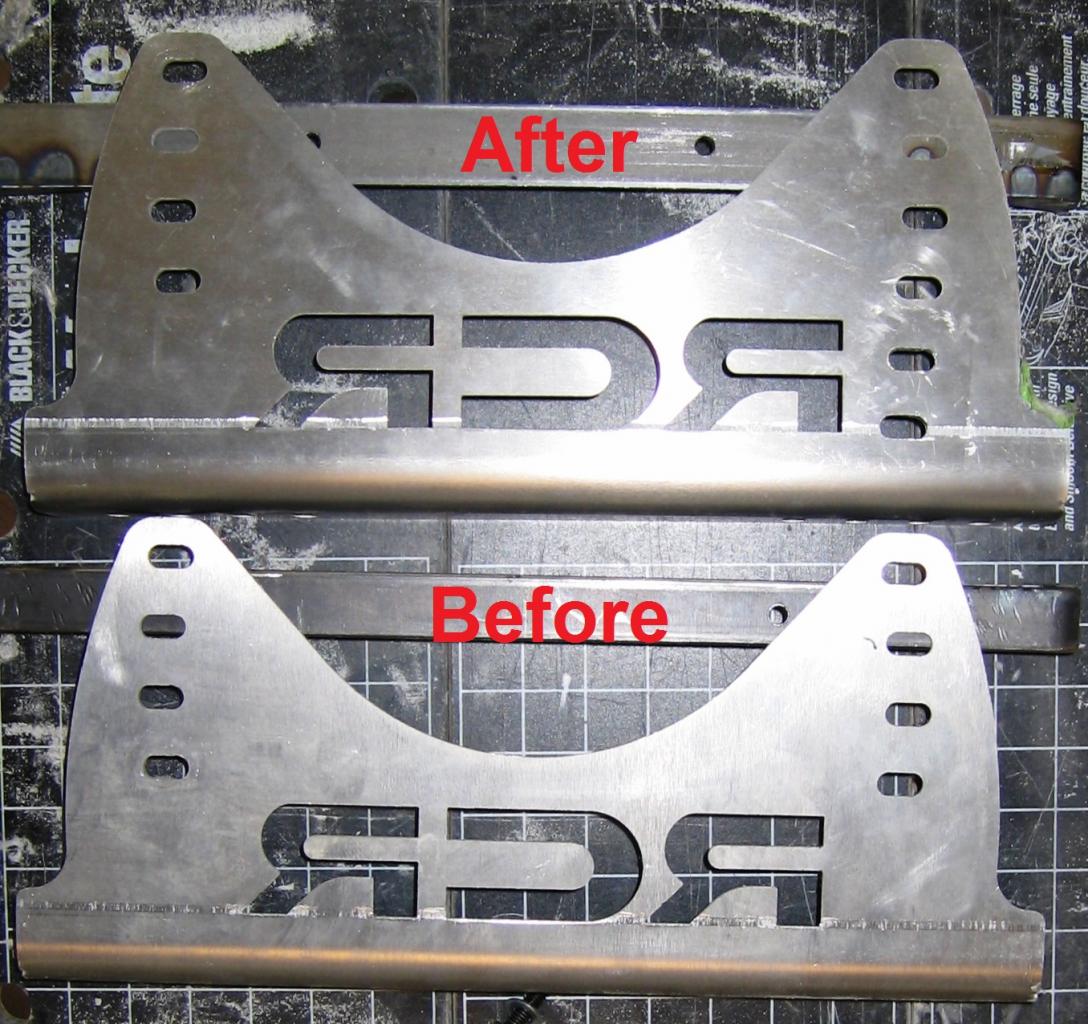

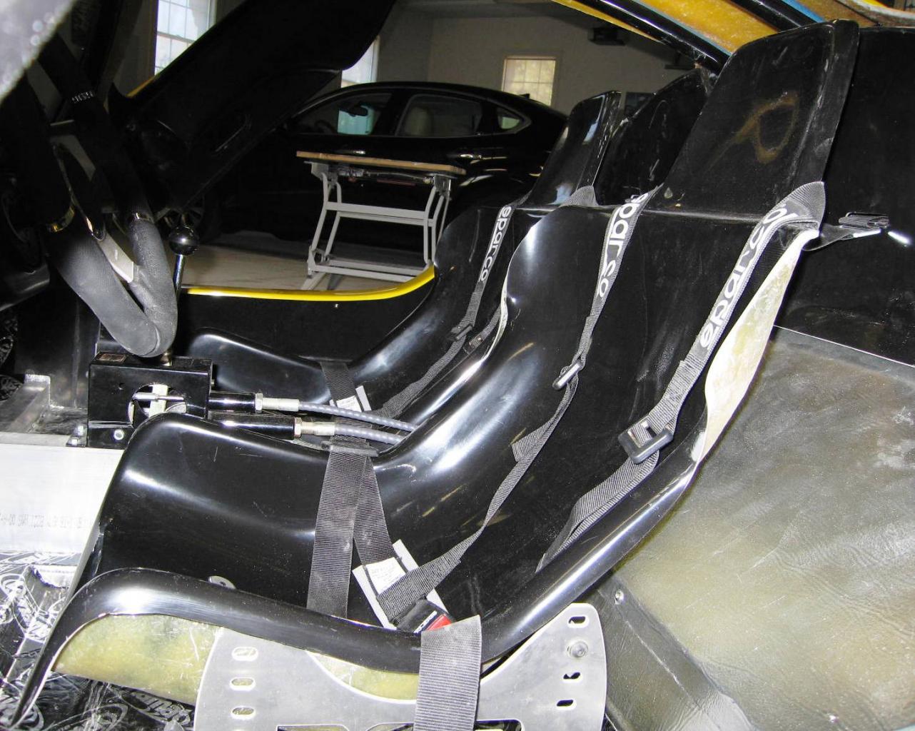

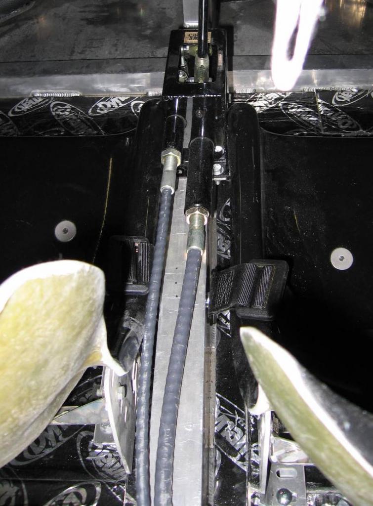

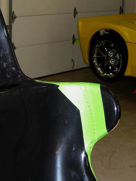

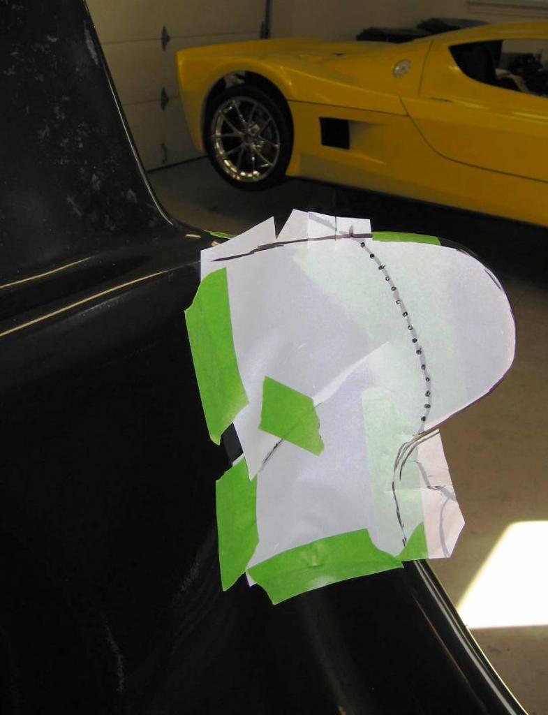

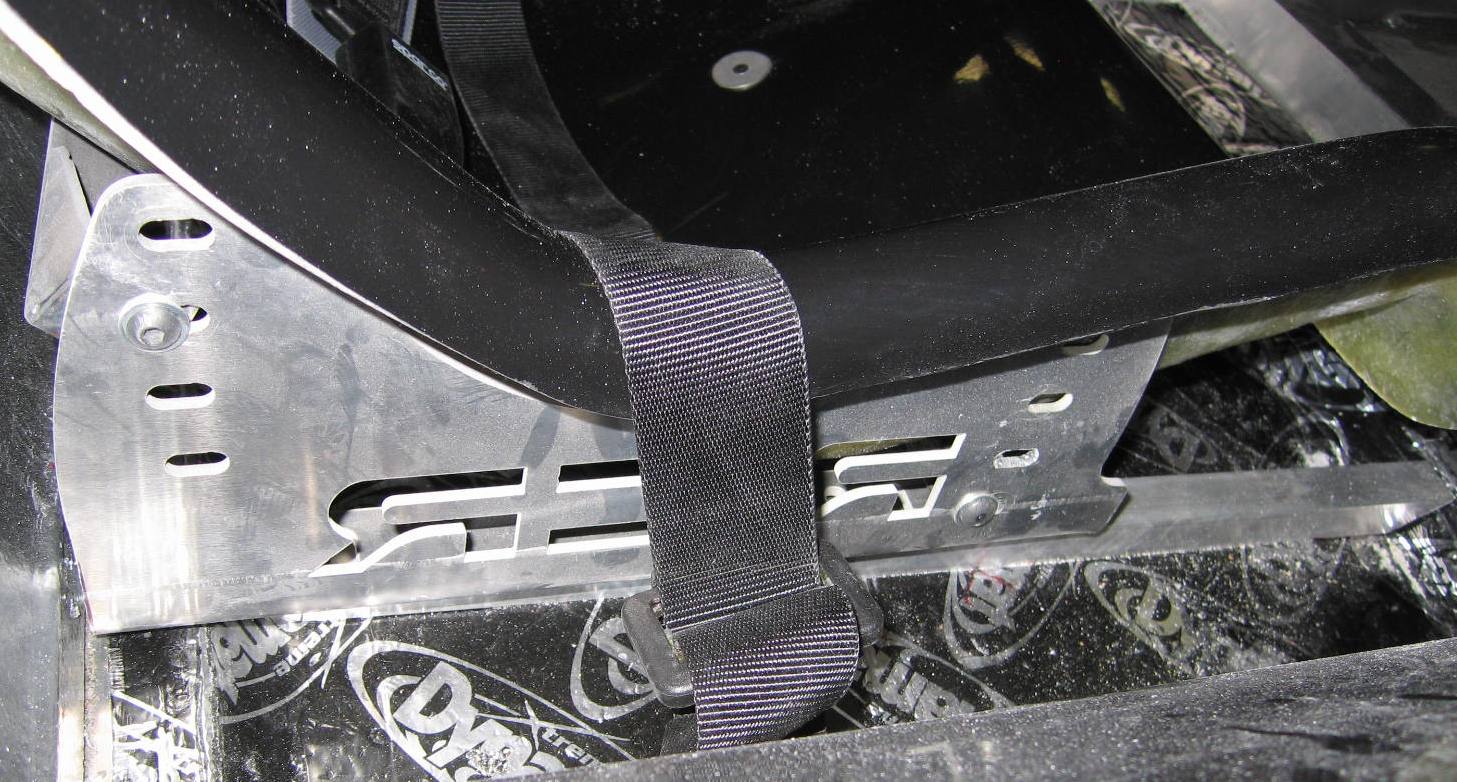

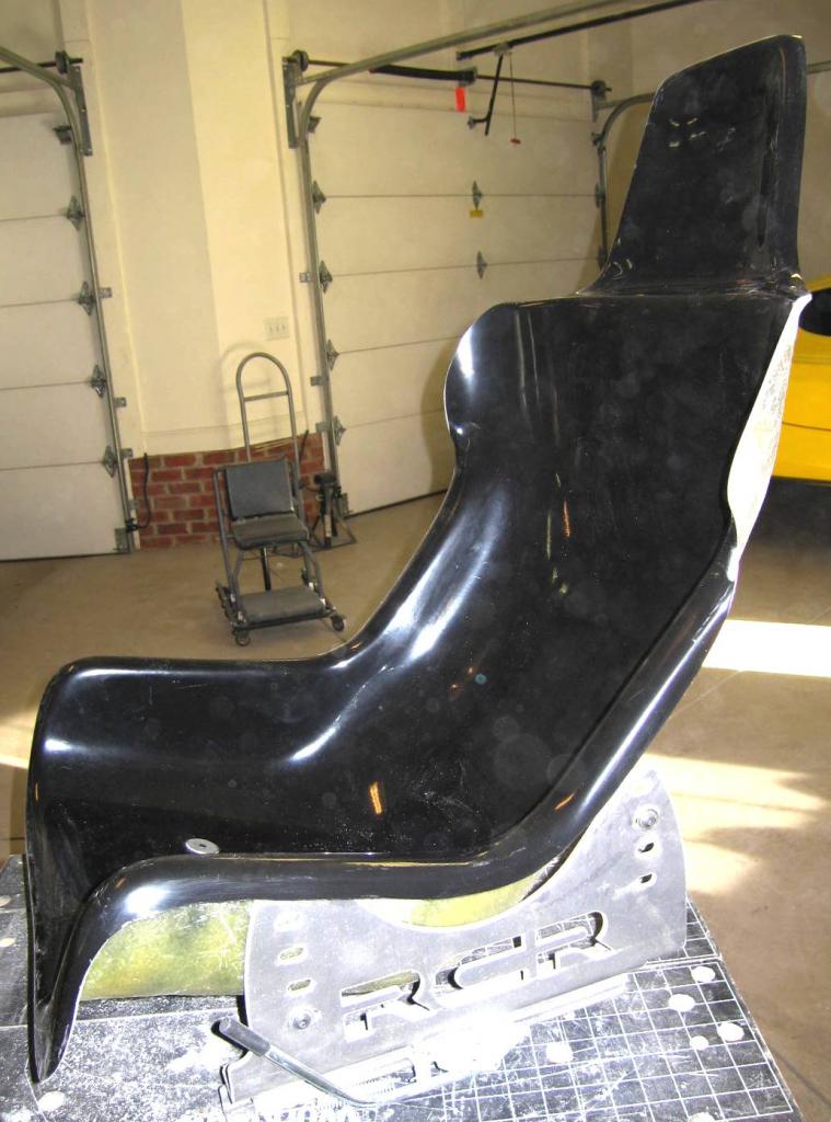

When I bought my SLC, I opted for 2 gentleman seats to fit my gentlemen's posterior. I knew the gentleman's seat would not fit on the passenger side, and I finally got around to installing & trimming it.
Before you can trim the passenger seat, you need to:
  1. Install the driver seat and adjust it to your liking. This gives you the height and reclining angle so you can match it on the passenger seat.
  2. Install the shifter. The left front corner of the passenger seat will hit the shifter box, so the shifter's left/right position on the center beam will make a difference. For example, I wanted my driver's seat aligned as close as possible with the steering column, so the seat needs to be as far right as possible. To allow the driver's seat to slide forward/aft without hitting the shifter, the left side of the shifter needs to be flush with the left side center beam. That means that the 3" wide shifter hangs about 1" over the 2" center beam onto the passenger side.
  3. Install the interior passenger door panel. The passenger seat shoulder wing will interfere with the interior door and need to be trimmed. Depending upon the passenger seat height and angle, the headrest may interfere with the door panel as well.
  4. Install the passenger seat shell into its brackets. For a cleaner look, I mounted the seat brackets at just above the floor level, but with the seat bottom extending down into the sunken well. That allows a flat floor to be fabricated around the seat when I trim it out with carpet. That required that I drill 2 more lower adjustment slots in the brackets.
Once all the above is done, you can position the passenger seat to see where it hits the door panel and determine how much to trim from the right shoulder wing. I think it helps to draw out the cut line so it compliments the seat contours. After the wing is cut to shape, an orbital sander with a coarse 80 grit paper worked well to refine the shape.
When you are satisfied with the shape, make a template to cut the other side to match. Use that same template to cut the driver's seat to match as well.
While you are trimming the seats, you may want to do a final trim around all the edges as well.
Once the seats are upholstered, I think they will look fine.
