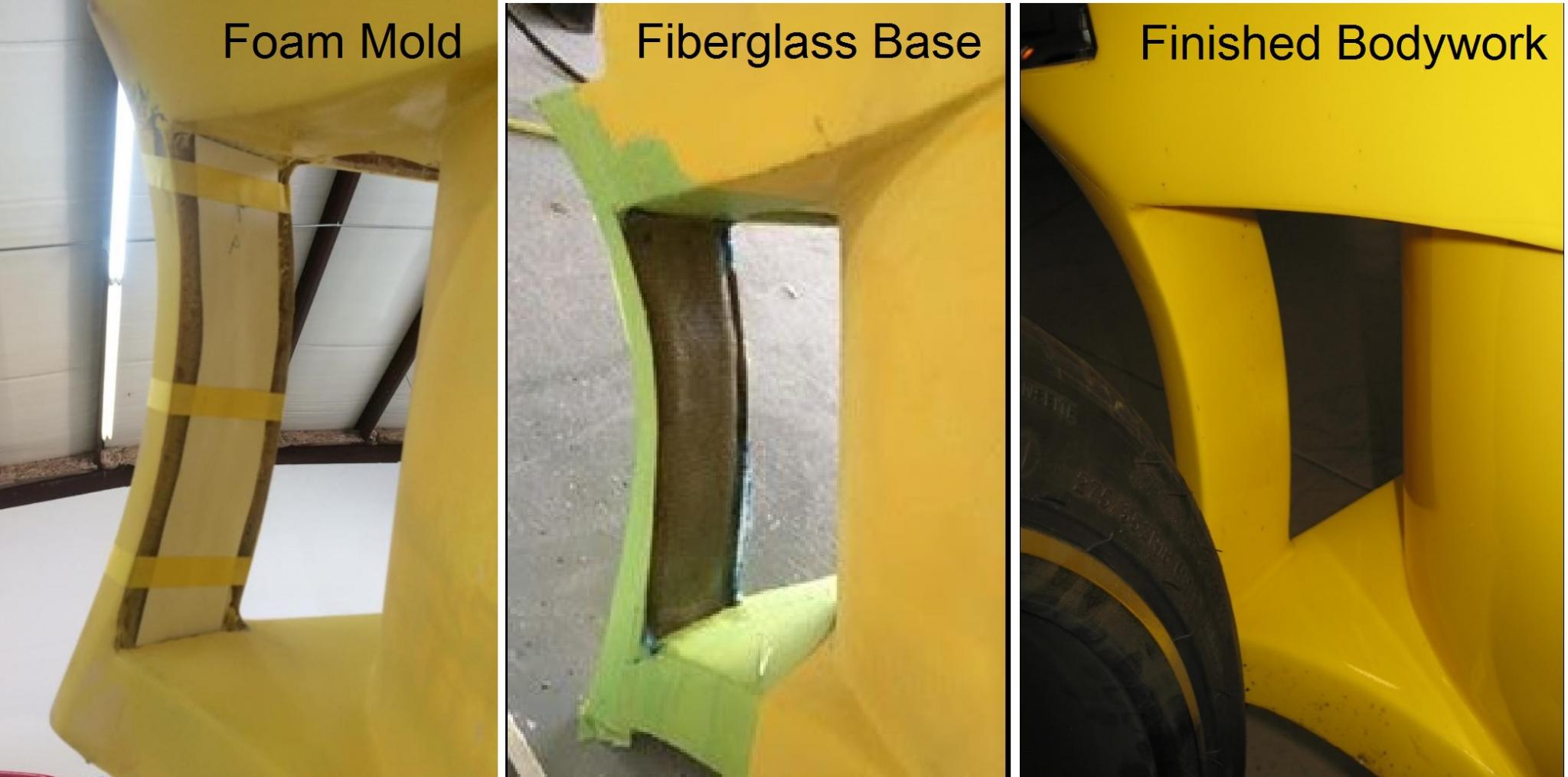

One of the details in the finished bodywork was to fill in the open mold cavity behind the front wheel wells. The cavity is more noticeable on the light colored car vs a dark paint color.
  • I started by filling the cavity with foam and then working it down to a smooth molding surface.
  • Then I applied 2 layers of 1708 fiberglass cloth.
  • Lastly, Tony at Charlotte Speed Shop (AKA Dent's Charlotte) did the finished bodywork.

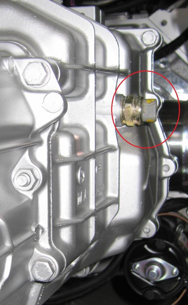

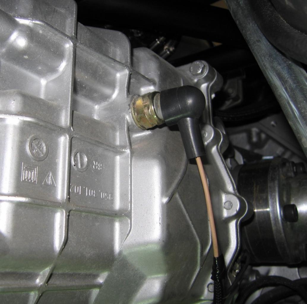

With limited rearward viability, its a good idea to warn anyone behind you when backing up. One of my winter projects was to get the reverse lights working.
I have a G50-20 transaxle and it uses the same reverse switch that many other Porsche transaxles use. The stock Porsche electrical harness uses 2 individual 5mm male pins (no connector housing) with a rubber boot covering. However, Porsche charges $50 for 2 little pins and a boot!
Call me cheap, but there must be a better solution.

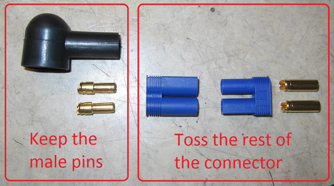

  • I found that the male pins in an EC5 connector fit perfectly. An "EC5" connector costs $1 on ebay.
  • An alternator boot fits perfectly over the connector to protect it. An alternator boot costs $5 on ebay.
I already had 12VDC powering a reverse camera on my back bumper, so I used that to power the reverse lamps as well. I then ran a ground seeking circuit to one side of the reverse switch on the transaxle, and grounded the other side of the switch.
