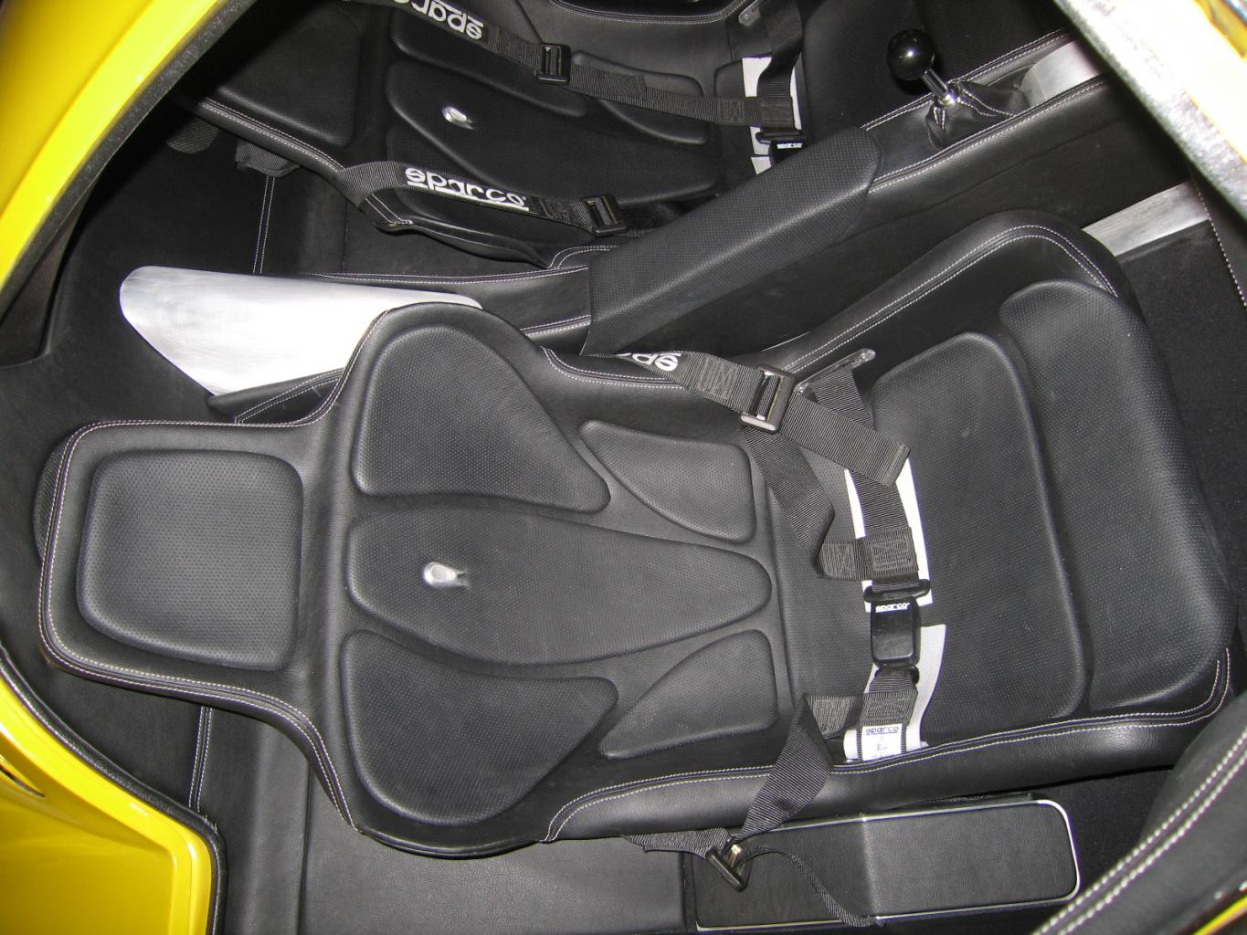

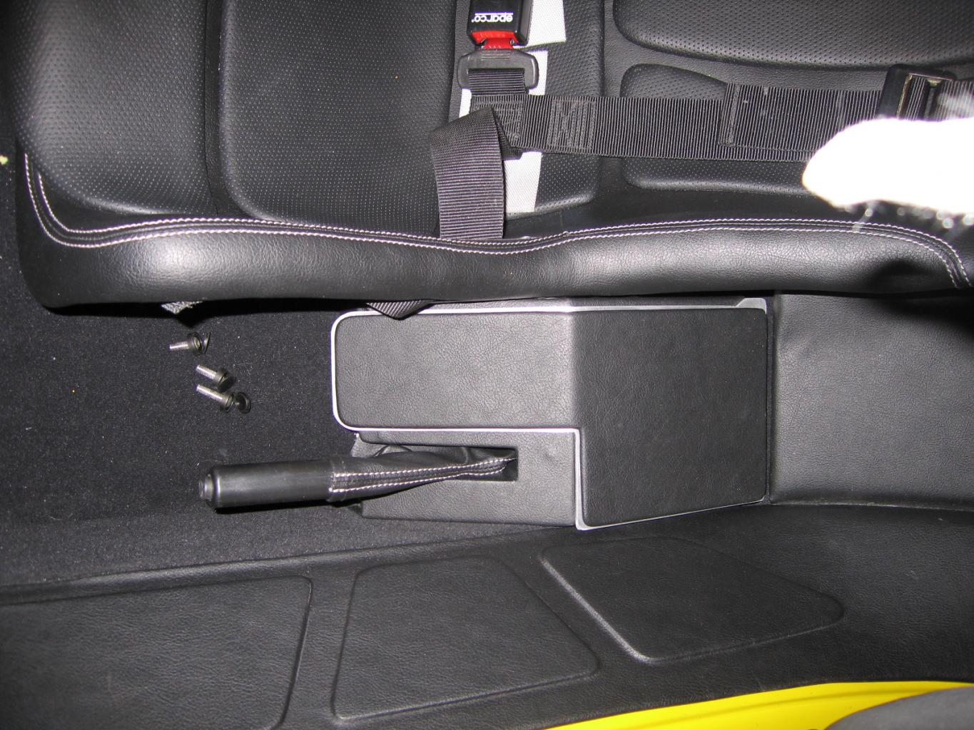

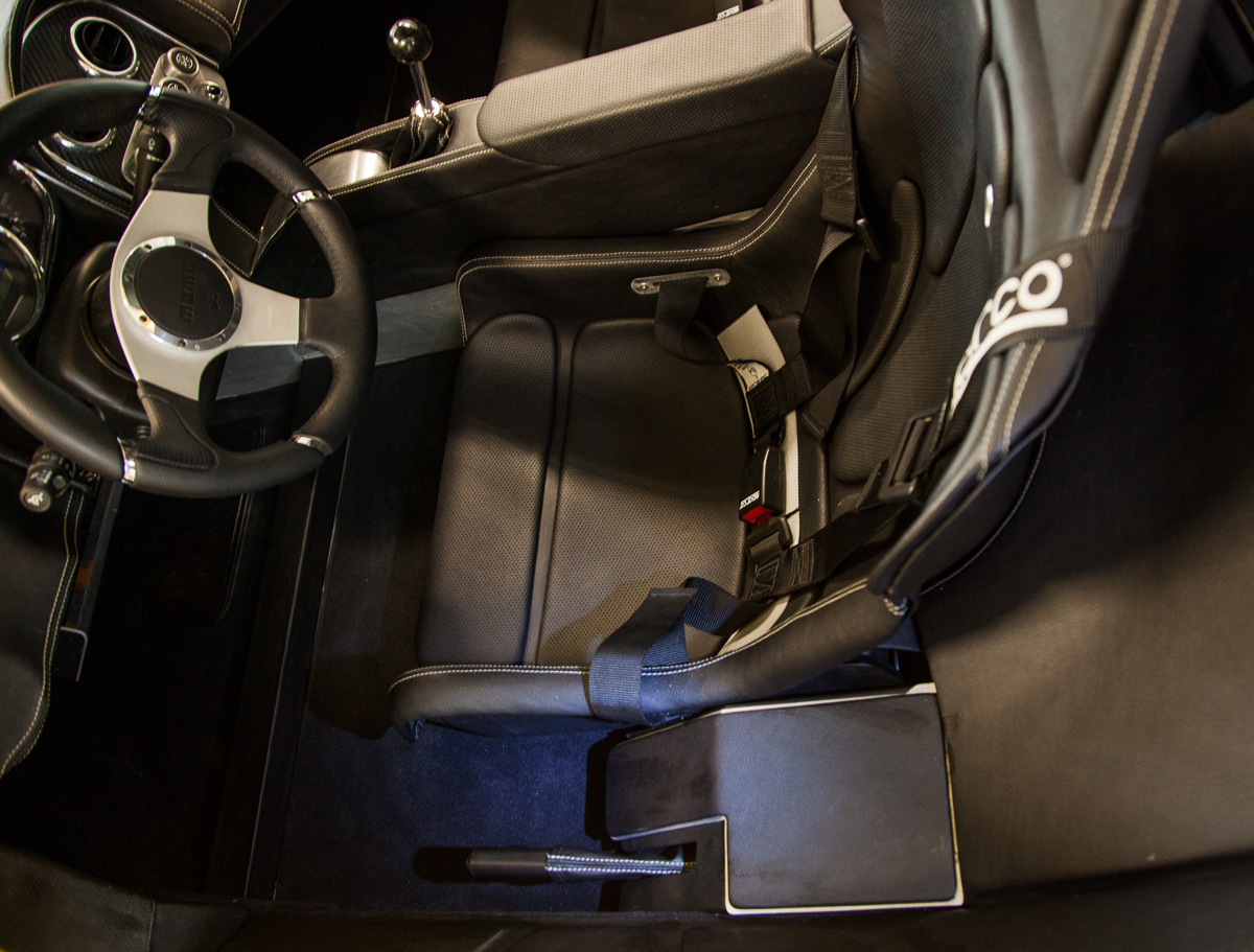

Do you have any pictures of your storage boxes along side of the seats? I'd like to do the same.
Nicely done all around Bill.
I like the detached diffuser, somehow gives the back a little more trick/functional look to it.
See attached PICs.
The driver side compartment incorporates the E-brake and is wider than the passenger side. Together, the 2 compartments have as much storage as most daily divers.
