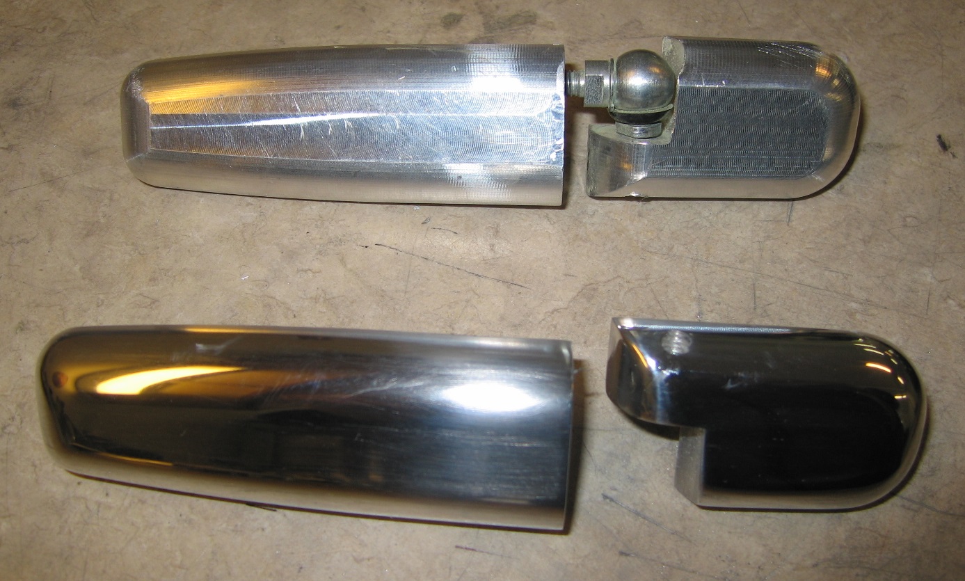

One of the details was the upper door hinges.
  • The upper hinge is a nicely shaped CNC part, but it could use some refinement. I started by sanding out the CNC grooves and polishing them to a high finish.

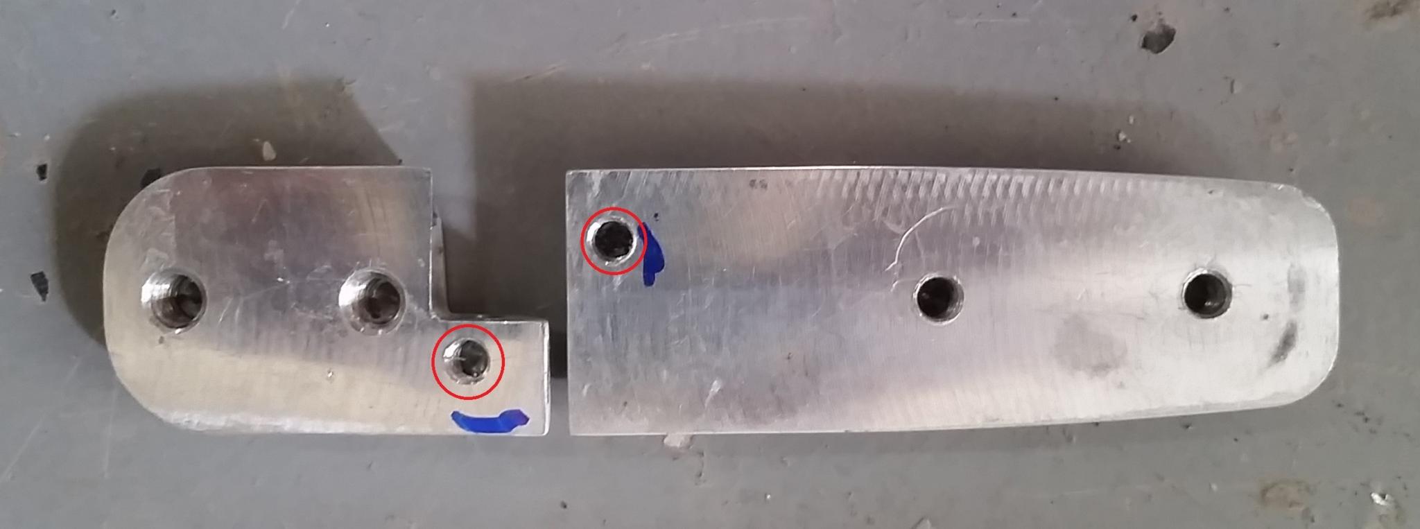

  • I'd always had a problem with the hinge joints backing out of the CNC'd parts and being kind of loose within their threads. No matter how much I tightened the hinge joints, they always seemed to back out. So I drilled and tapped set screws into the back of both sides of the hinge joint. They don't back out anymore and the door has a more solid feel.
  • I wanted the upper hinges to blend in with the black top, so I had the aluminum CNC'd portions black anodized and I did a black-oxide plating on the steel hinge joint mechanisms.

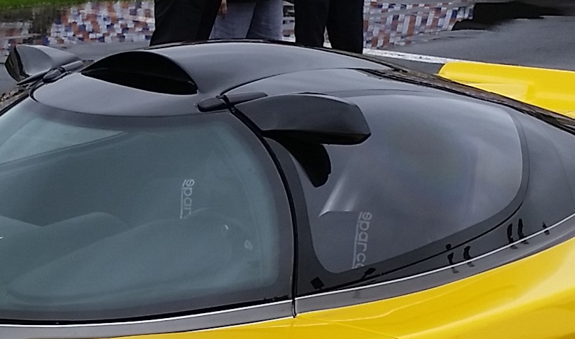

Here's a test. Can you see the rear window clips in the attached photo?
The Answer to the test is...

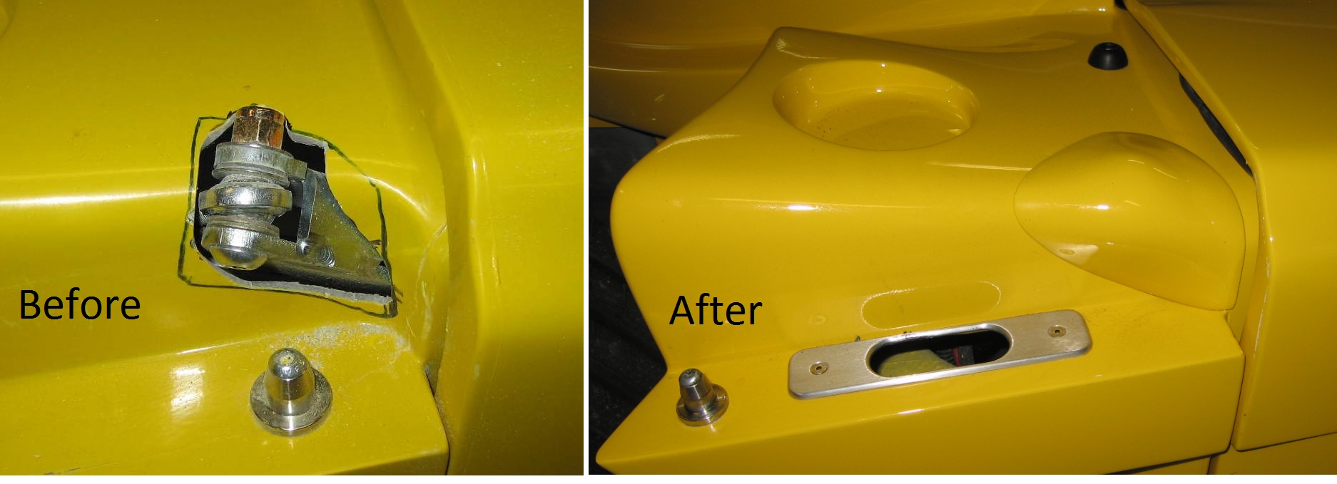

I open my front clam frequently to access the trunk, and the exposed lower door hinge looked a bit unfinished to me. I fabricated this cover to clean up the hinge area.
During the bodywork on this part, it became known simply as the "Athletic Cup" :shocked2:
Nice! Helps with water migration too. Great job..

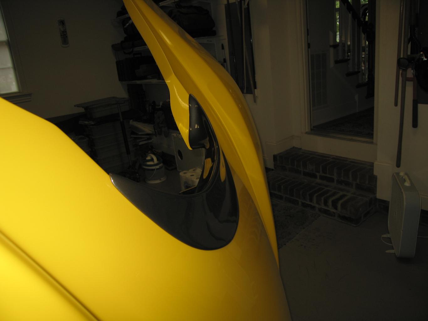

Here's a few PICs of the diffuser I fabricated for the top of the front clam.
While the body work was being done, we affectionately refereed to as the "Klingon Weapon"

Ahhhh, now I get the reference.
