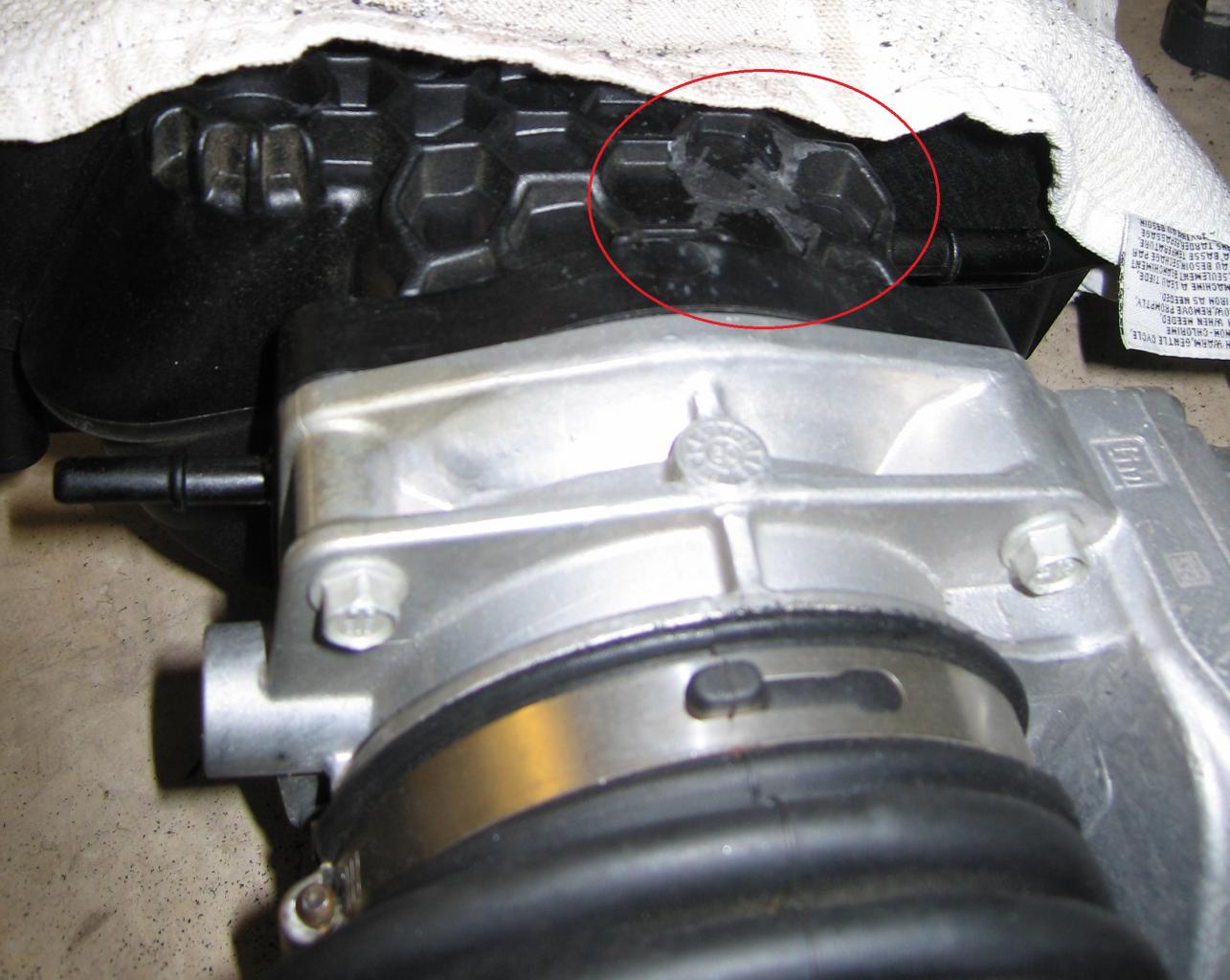

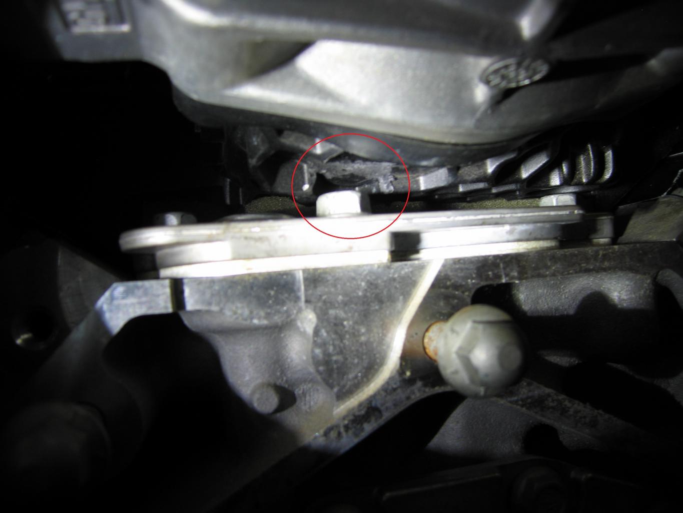

2. I reversed my intake manifold and blocked off the oil pressure sender boss. I also noticed a valley plate bolt at the rear of the motor that interfers with the manifold. A little grinding on the plastic manifold made quick work of that.

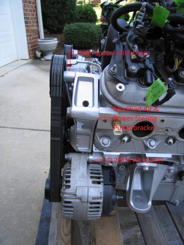

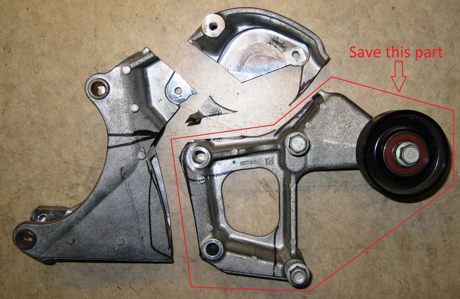

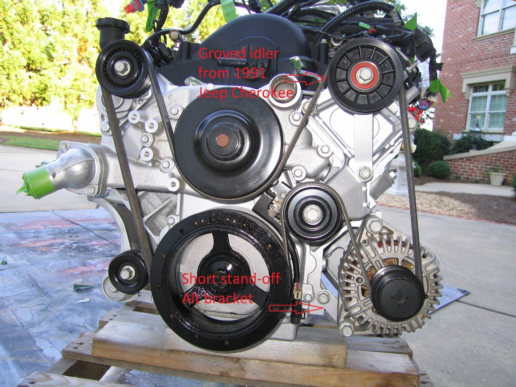

4. I fabricated an accessory drive for the Alternator and water pump. This was pretty simple. Just cut up the original Alternator / Power Steering pump bracket, add an idler pulley, and then fab a couple simple spacers and brackets. I was able to use the original belt so the total cost was just $16!
Ken Roberts
Keep in mind that with the Jeep idler up so high like that you will need to modify the water outlet pipe on the water pump to shoot straight up.
The WP inlet will also need modification. I simply cut it at the base of the "bell", rotated it to point directly out to the side and rewelded. Use a 160 deg. thermostat.

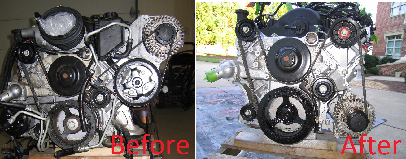

Assy Drive before and after PIC
Meant to post this PIC with the others of my Assy Drive modification
