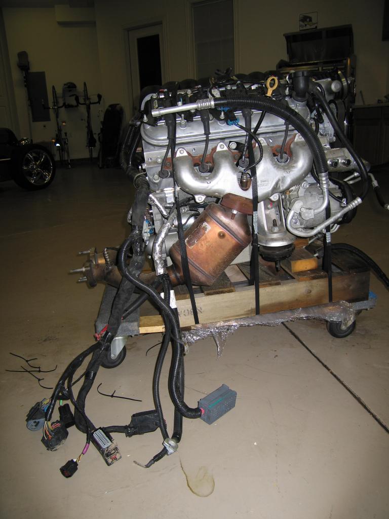

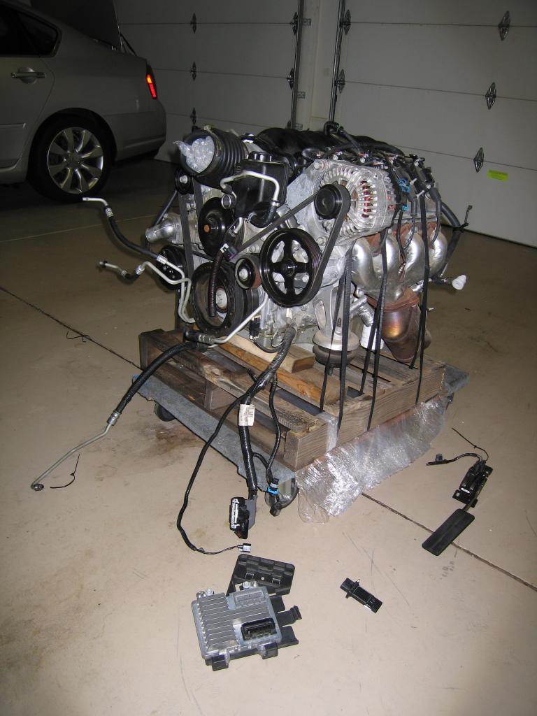

The one thing I could use some guidance on is the GM engine wiring harness. Its all there, including half-a-dozen additional mystery plugs.
Can anyone point me to a pin-out diagram for the GM harness, or guidance on how to modify the GM harness to interface with the ISIS system?
Ken Roberts
I modified a 2007 Z06 engine harness for stand alone use. I wouldn't do it again. It will take many hours of studying the schematics. I'd recommend sending it to this place for conversion for $450. Engine Management harnesses by Current Performance Wiring
Sell your complete front accessory drive and put the funds towards a CTS V accessory drive. GM Performance Parts - 19155166 - GMPP Accessory Drive System Without A/C - Fits LS1 & LS6 Engines or http://www.summitracing.com/parts/NAL-19155066/ Summit will match the Pace price.
Some of the additional plugs in the engine harness are the front wheel speed sensor wiring and ABS wiring.
Also sell the LS3 headers/cats and buy the Z06 style of headers/cats. Post all of these items up for sale on LS1tech. They should sell quickly.
It doesn't. The only "link" between the two is the switched 12v power to give it power.
