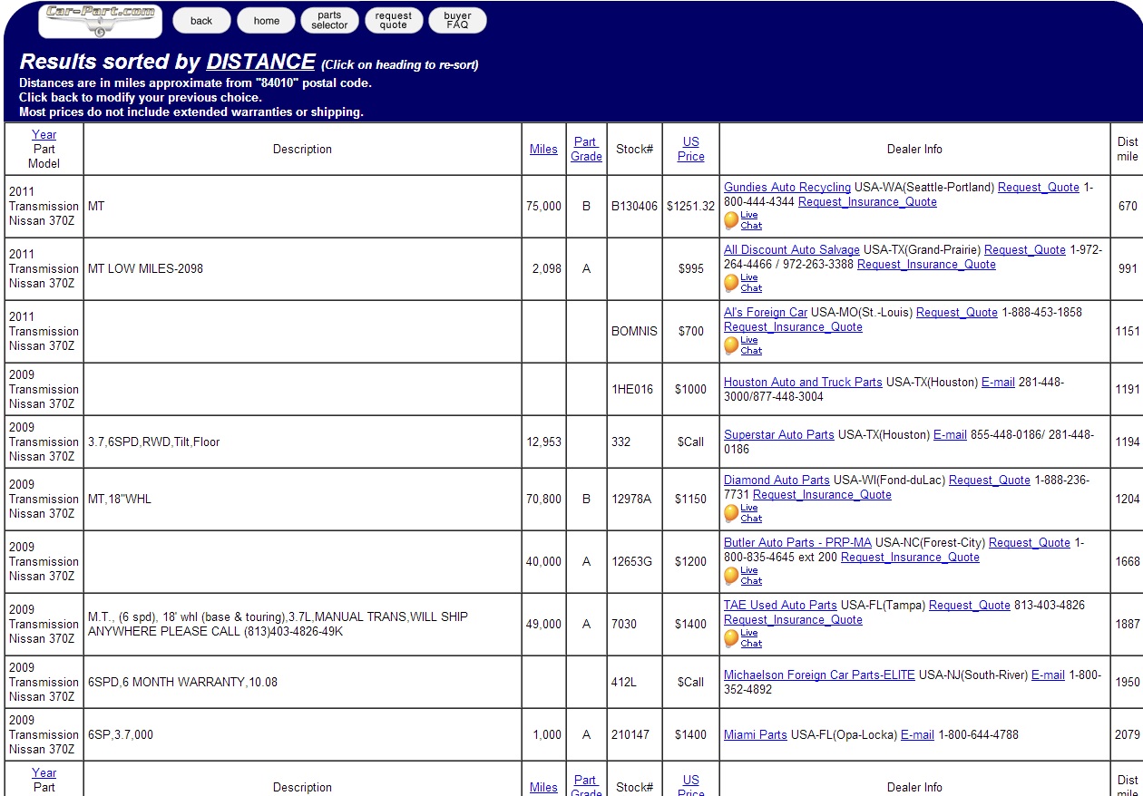

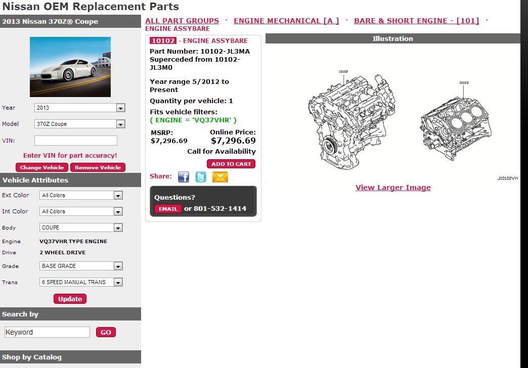

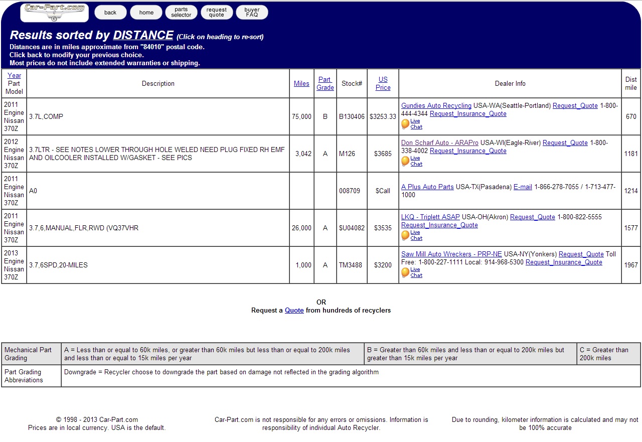

Wow, you have a great point. (unless your building a Texas mile car or a Bonneville Salt Flats Car where you really want/need a mega horsepower capable car, I've just never seen any VQ37VHR's that make more than 600HP, do you have any links that I can click on to see some mega HP VQ37's? I really would be interested, if you did. Thanks in advance.)
After some quick research, a new VQ37VHR (without ECU or Harness) is $7,300.00 (see attached), yikes...
A used VQ37VHR, however, (WITH THE AUTO-BLIPPING TRANS, which we could sell for between $700.00 and $1,400.00 buck) is between $3,200.00 and 3,700.00 (all of this according to car-partDOTcom). So the net worst case scenario (after selling the trans) for the used VQ37 is $3,000.00, but the net best case scenario (after selling the trans) for a used VQ37 is $1,800.00! Not bad at all!...
Then, to address the fact that no SLC should make less than 400HP, all you need is a "turn-key twin turbo kit" (or "turn-key supercharger kit") from GTM motorsports (or some other Nissan/Infinity tuner house), and your looking at 500HP for $8,500.00 to $9,000.00, AND NO GURGLY/LOPPY/CLUMSY SOUNDING AMERICAN EXHAUST NOTE (can you tell that I really don't want that?...), sounds great to me!...
