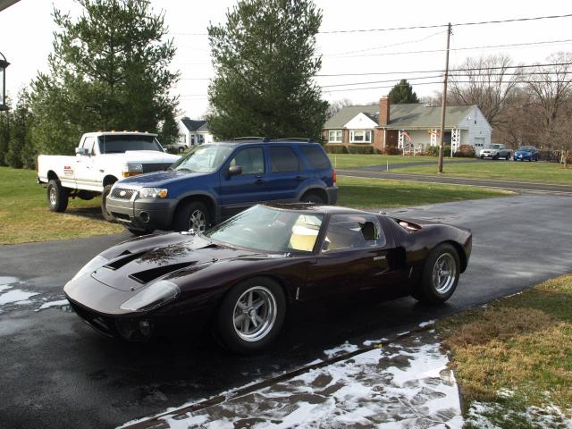

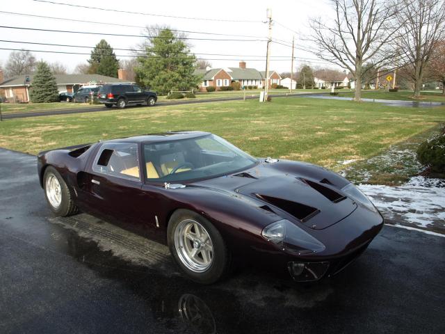

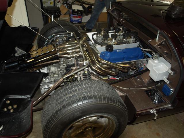

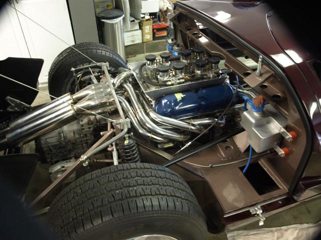

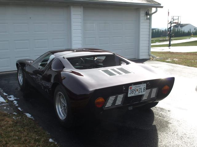

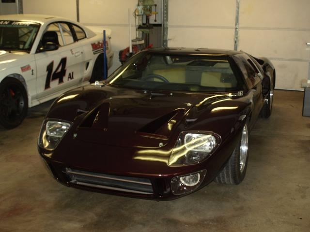

A few photos from today. Notice the plush seats :)
An old photo got in there by mistake, but it does serve to illustrate how far we've come.

It's more like relief... that it finally runs and does something like it is supposed to. And it is not too loud, which means with some insulation it will be usable for vintage rallies and that kind of thing. It wasn't too much of a white-knuckle trip, it was kind of fun, wish I had been able to drive it further, but the tire rubbing limited that. We'll have new rubber by Tuesday or so, but the road insurance will be off it as of Monday, and unless we get a spell of really good weather and a lot of progress made on fixing the small stuff, I am not going to reinsure it for road use until the spring.

I forgot to add.... if you look at the photos in the post up above, and compare the two engine shots, the pipes have begun to turn color. Kind of a nice gold. Hope they styay that way. Also note the exhaust silencer shield, another piece of lovely work by John Shriver's shop... the guy who hates the word "perfect"...but comes very close to it in his work.
