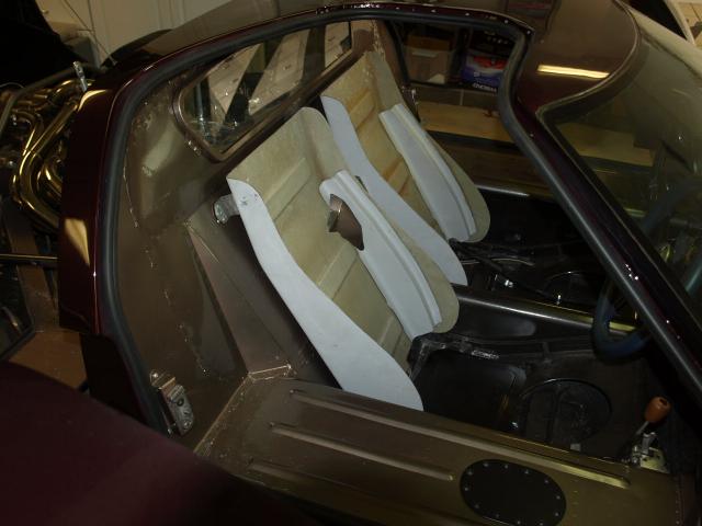

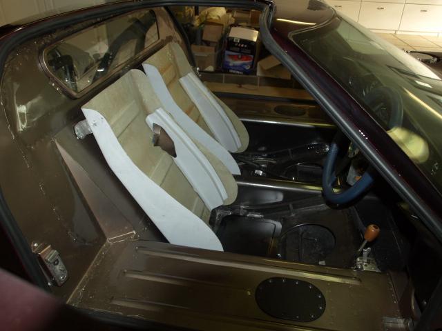

A few photos from yesterday; the fiberglass parts of the seats are in; they require relieving around the hump in the engine cover. Turns out they are supposed to be painted black- I thought they were left unpainted, I was wrong. I have found one UK site that has most of the webbing material but they don't answer emails; I'll have to call them when the world gets over its hangover, Monday morning or whenever. I need to figure out what rivets to use to hold the trampolines together. New tires on the back, too, courtesy of Ron, and a corrected stance for the car which looks terrific. He is waiting on a replacement water temp sender to be able to start the engine up.

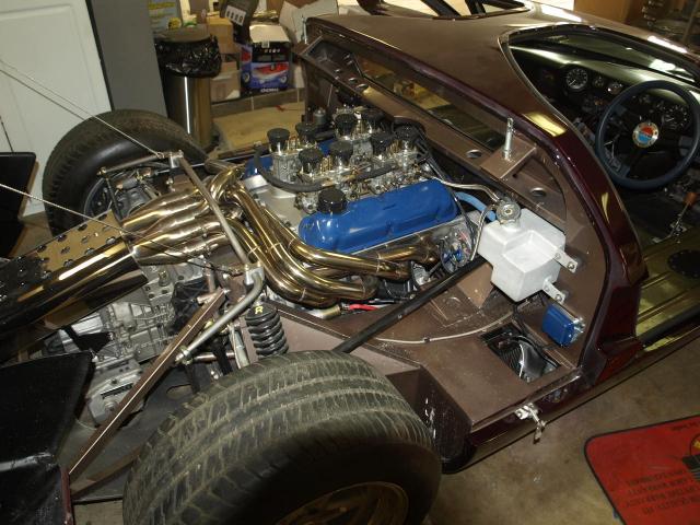

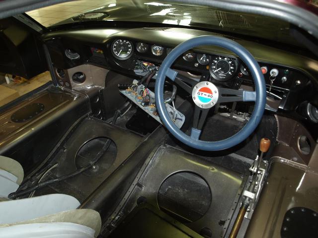

Going back up to Hampstead, Sunday; the seat backs are painted and back in the car, Webers synchronized and tuned up a bit, and I am going to work on patterning the aluminum panels for the front of the car. Also figure out how the seat harnesses are going to mount. The webbing is on the way here,but I still have to get the rivets and the double hooks that hold the trampolines to the chassis seat rails. However, it's coming along. A new MSD box got the engine going again, and Ron has got all the gauges sorted out and working. Perhaps a short ride in the next week or so... if we get a spell of clear weather that is not too cold I can get the road coverage put back on the4 car for a few days and get some more seat time and sort a few more things out.
Ron has also figured out where the handbrake cables are going to run, and is working on installing them. The next step is a single cable that will run into the passenger space, along the top of the center tunnel, and then make a sidewise U-turn and attach to the E-brake handle. This ought to get everything working, more or less.
The SW pumps are back in, seem to work fine without leaking, and supply enough fuel for tuning. We'll see how they do when the car is actually moving etc.

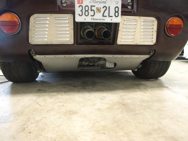

Worthwhile day working on the car with Ron... we got the patterns made for the aluminum panels for the front framework- astonishingly, the two sides are nearly the same. Also got the protective insulation applied to the inside of the rear clip. This was far less easy- the stuff wanted to move around and spread out and not behave itself. However, finally in place it looks great and it is all one piece with no seams. I hope this will protect the fiberglass and paint of the rear bodywork from all that heat coming up from the engine and exhaust system.
Ron also has a lot done with the emergency brake system- calipers in place, two of the three cables run, and close to being able to order the primary cable which will run from the handle back into the engine area where the splitter and clevises are mounted. I think this system will work very well.
The seat backs are painted and all the bracketry that holds them in is done. Webbing is on the way and I have some sources for the clips; I meant to measure for them today but ran out of time up there. The only other thing I have to figure out for the seats is what the panel in the middle of the fiberglass seat back- the part that is laced to the seat back itself- is made of. The photos I have don't show what it is, but it is some flexible material that can accommodate lacing without the cord tearing through. The lacing material looks like parachute cord or something like it. So, lot of progress made, and fairly clear plans for all the rest.
