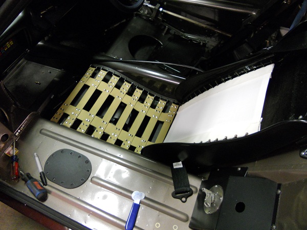

Back up to the shop tomorrow, with any luck, to try to complete one side of the seat webbing. I think I can get the passenger's seat finished. If I do, I will post photos of the completed work. It is supposed to be high fifties here tomorrow; I am itching to DRIVE this car and get acquainted with what it can do....
Jim Rosenthal
So I got one side of the car done- the webbing is all in. This is to say the least a tedious job. It does look pretty good. Just to compare, while I was doing that, Ron took most of the suspension out of a new Camaro and installed lowering springs, a shock tower brace, new sway bars front and rear, and some kind of frame that stabilizes the rear subframe relative to the unibody. He started before I did, and finished about the same time.
So you can tell who the professional is.... however I am getting quicker at it, and I think I can do the driver's side in less time, if it is me that does it. I am working most of the week, and Ron is going racing, so it may not get done for a while..

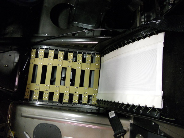

Ron McCall
Here you go Jim!
Jim Rosenthal
I am tempted to post something about how beautiful it looks, but I'll leave that to the rest of you all... the best thing about looking at that photo is knowing that the webbing is half finished. What you see there took about ten hours, but I think the next one will take less time. And hopefully look even better. AND be good to sit on, since I have to sit on the driver's side....
Thanks Ron!!
Jim Rosenthal
The learning curve getting a bit quicker, I got the driver's side webbing almost done today- one rivet popped loose and I will have to replace it, fortunately on the front crossways web, so we don't have to take the whole trampoline out again. Nice fit, not too shabby. It needs to be stretched rather tight to give any support, especially if the car owner weighs too much and ought to be on a diet...
