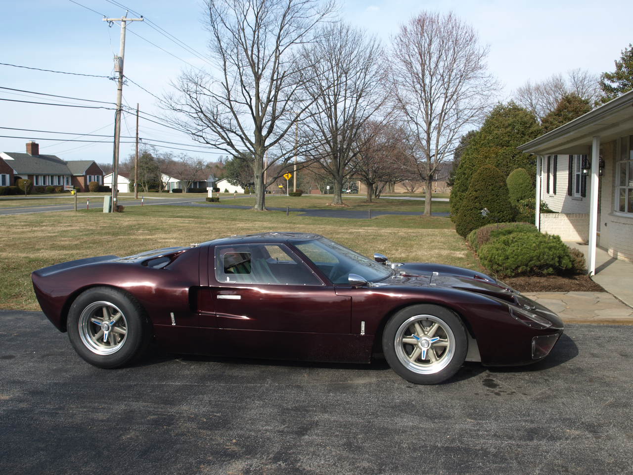

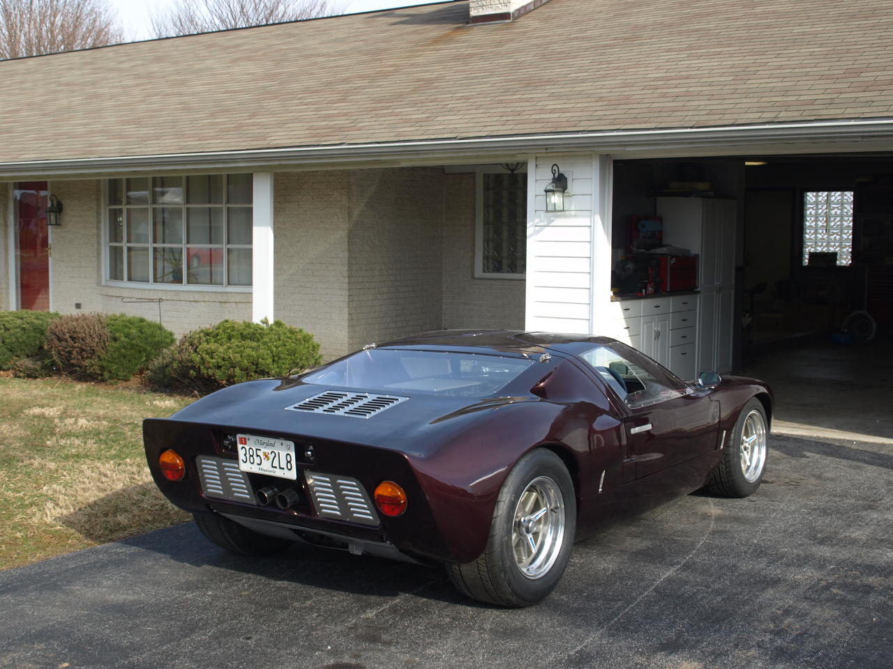

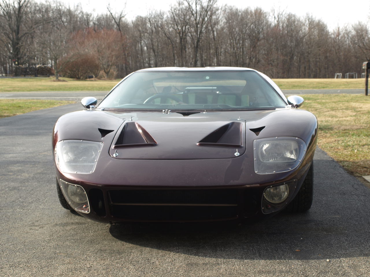

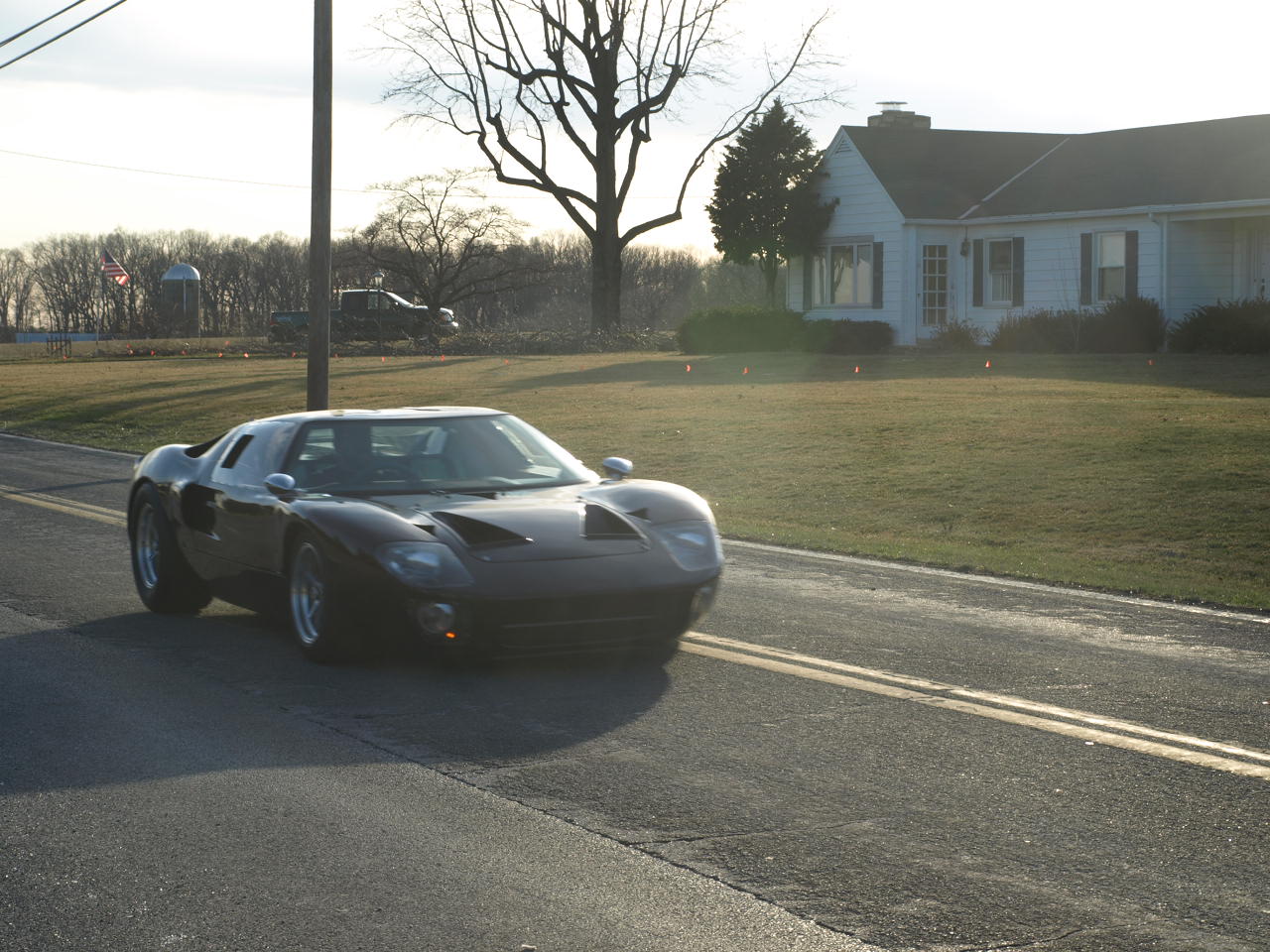

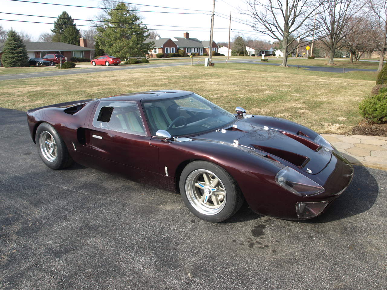

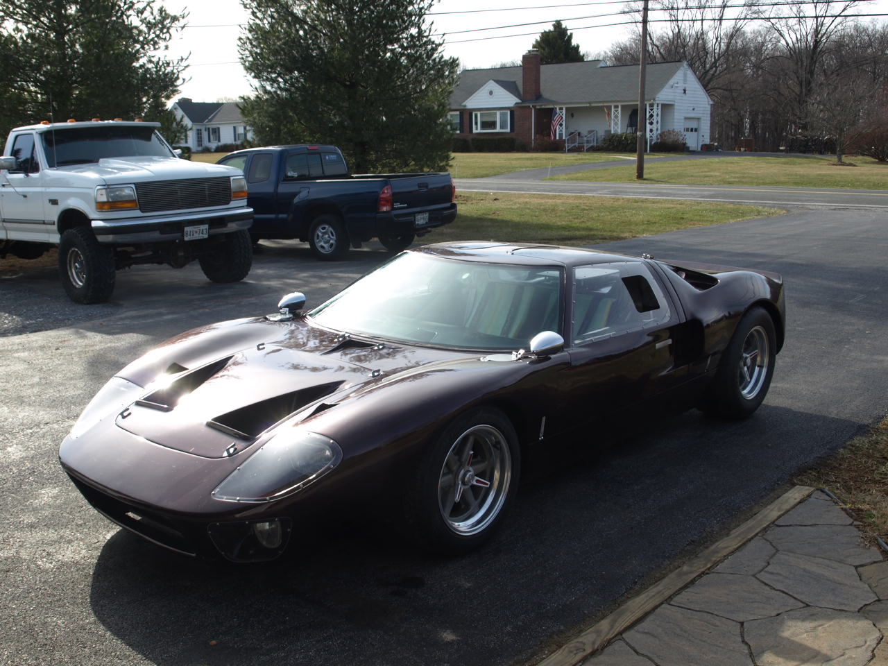

A few photos of the session the other day, and a (not very good) running shot....you can see the front tires, which look too small in overall diameter. Also the washer nozzles, Dzus fasteners with flags, turn signals which work, and the rear window installed... the seating areas are fine, we put blocks of foam on top of the webbing, all indications are that this will be pretty comfortable when done, and hold you in there fairly well. Seat belts are about done also, although we didn't use them (!), but they are just about secured in there; the builder of the chassis put attachment points in for them.
It's interesting that the things I thought would be the problems turn out not to be, and the things I didn't expect ARE. Isn't it always that way?

Brian Kissel
The car looks fantastic as usual. What looks just as good, is the grass. I still have over a foot of snow on my lawn. Keep up the good work.
Regards Brian
Jim - She's absolutely stunning!!!!
What color code is that please??? It lights right up in the sun!!! :thumbsup:
