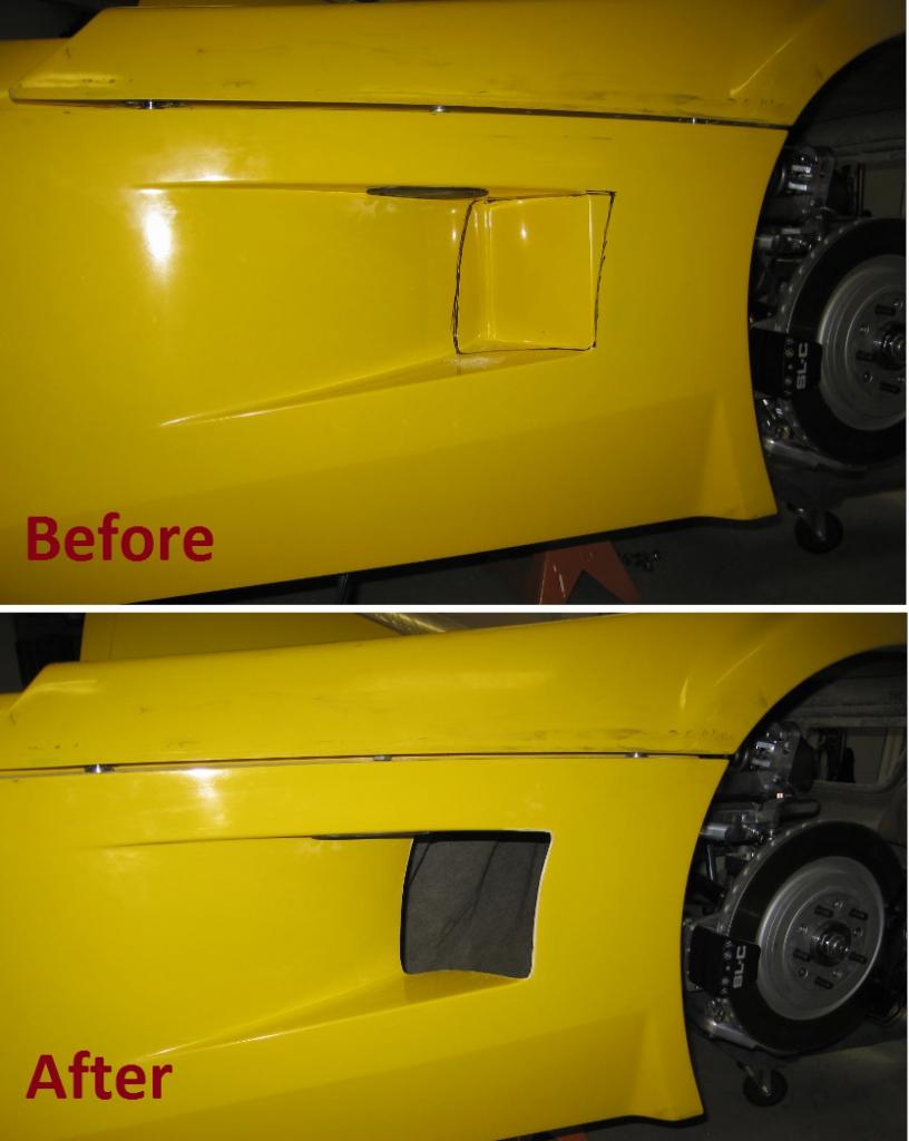

I cut all the vents out of the body.
I pretty much cut long the typical outlines, except for the side vents. I thought the side vents looked a bit square and did fit with the lines of the rest of the body. I cut a more curved shape using the rear wheel well as my guide. IMHO, I think the side vents now compliment the overall body lines.
If my calculations are correct, it also nearly doubles the area of the vent.

Interesting variation on the side scoop. I like it. Maybe I'll open the leading edge of the scoop on mine a bit.
This is the fun of the SLC we can all put our own interpretation on it. It will be very interesting to see the variety that comes from this in years to come.
No end of problems...not really ...there needs to be a vent in that location for airflow regardless of shape/size.
We have done similar shaping on a couple of cars in the past..it looks good.

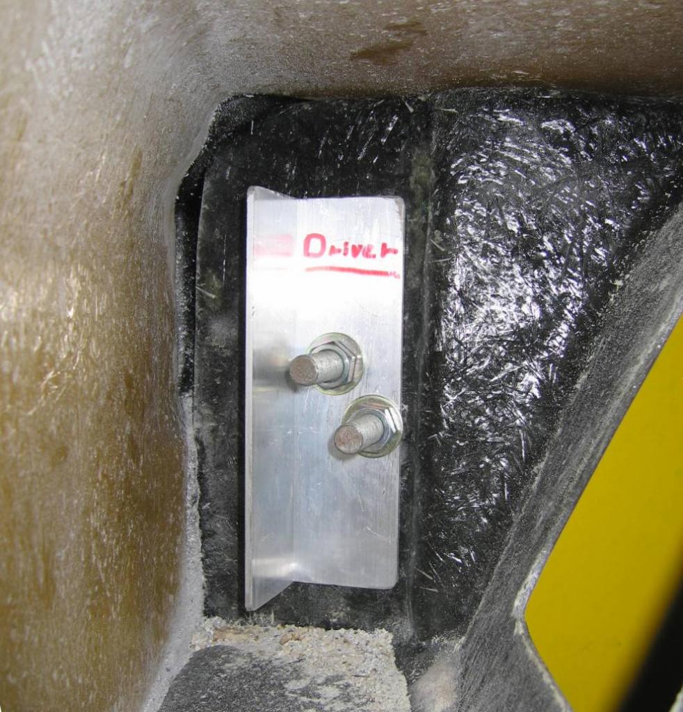

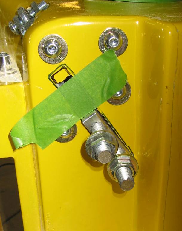

I hung my doors today.
The best advice I can give you is to watch Allan’s "SL-C Build xx" YouTube videos 41 thru 49 before you start. They are very helpful.
[ame=http://www.youtube.com/watch?v=uyqDgtWRoKA]SLC BUILD 41 DOORS - YouTube[/ame]

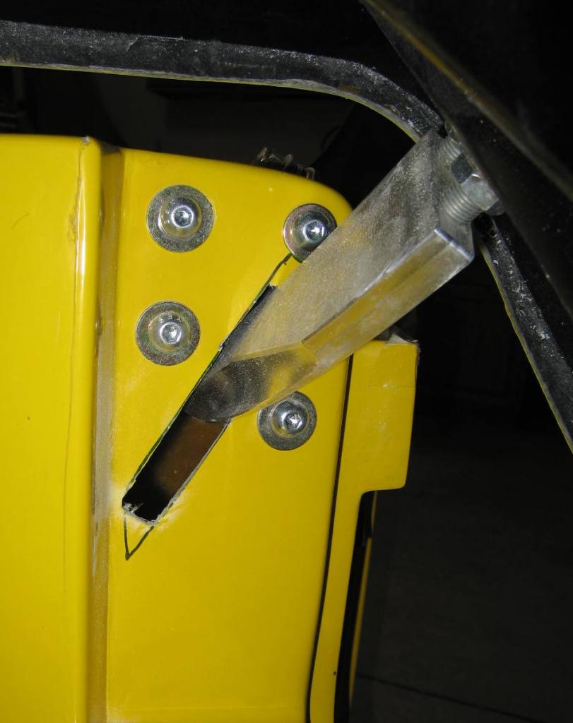

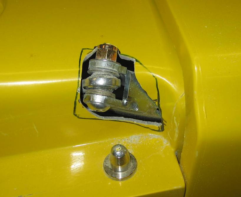

Cut the hole for the Hinge pivot
Mounting the hinges on the body took the longest time. I like to make the holes in the body as small and tight as possible. So I only used the template outlines that RCR drew on the body to give a general idea of where the cuts will be. I start by cutting a smaller hole in the middle of the template area, then test fit the hinge and cut a little more, test fit the hinge and cut a little more, test fit the hinge and cut a little more... Repeat this about 150 times until the hinge fits all the way thru the hole with reasonably tight clearance. This detail takes a couple additional hours but it was worth it to me. See the PIC of the cut hole vs the template.
Cut the Slot for the Hinge arm
The left and right hinge brackets are mirror images of each other. One of Allen’s tips was to use the opposite hinge to double check the door jam template marks. My driver’s side was right on, but my passenger side bolt holes were a little off. Here too, I like to make the hinge arm slot in the body as small as possible, so I start by cutting a smaller hole in the middle of the arm swing and work my way out. See the PIC of the cut hole vs the template.
Drill the Hinge bolt holes in the Doors
With the rod end in the middle of its adjustment, rotate the hinge arm down until the flat end is parallel with the door jam. Use tape to mark the top and bottom of where the hinge arm is in the jam. Position the door where you want it, and use a marker from the front side of the door jam to outline the slot between the tape on to the door. With the studs removed from the hinge arm, lay the flat end next to your mark on the door to determine where to drill the bolt holes. I drilled the holes a little oversized to allow for some door adjustment. The door fiberglass is a bit weak where it bolts to the hinge, so I added a stiffening plate inside of the door.

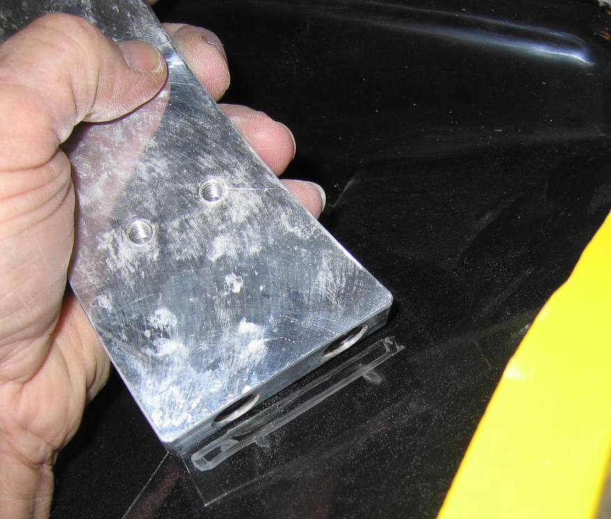

I'm building a street car, so I decided to go with a key ignition, but I wanted to carry only 1 key. Since the outside door handles are from a 1997 Miata, I bought a complete 1997 Miata lockset with the electrical harness pigtail on ebay for $80.
The Miata ignition key locks the steering column so its about 6" long by 6" wide. There are a couple ways to mount the switch to the SLC structure. You could use the threaded holes for the clamp mount or there is a set of 3 mounting bosses that are in a flat plain. I choose the later.
To make the 3 mounting bosses easier to manage, I cutoff part of the mounting arms and re-drilled the holes.

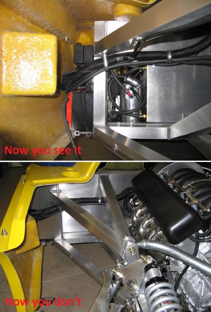

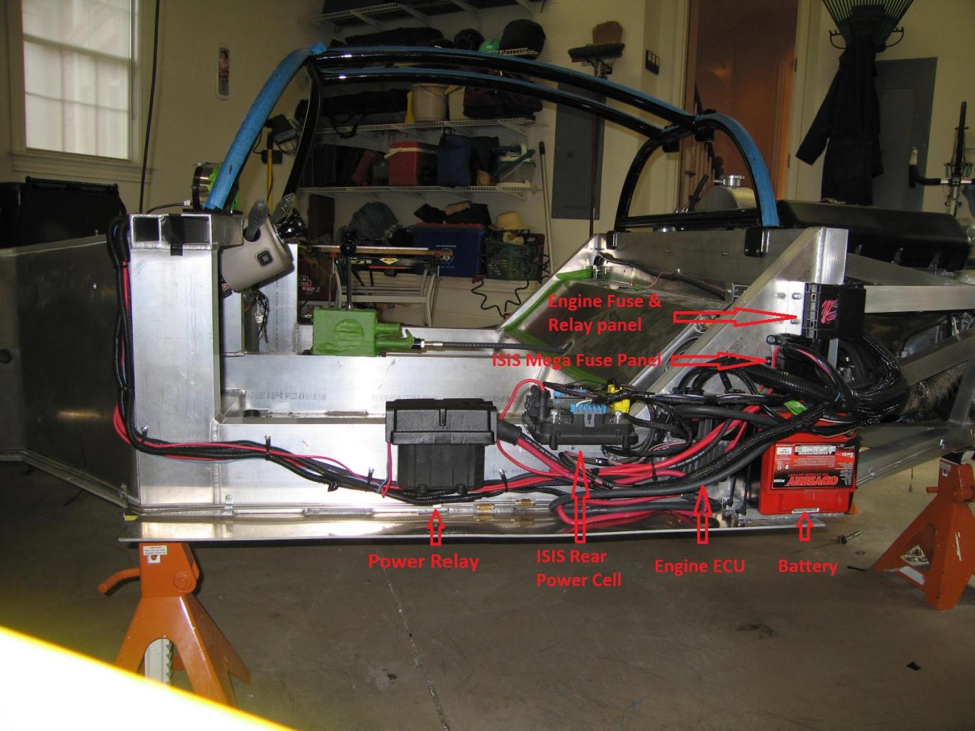

I put the finishing touches on the electrical system.
I wanted a clean engine bay so I decided to hide the rear ISIS Power cell, ISIS mega fuses, Battery, fuel pumps, fuel filters, engine relays, ECU, etc. All the fuel components are located to the left of the fuel tank and electrical components are mounted in the left wing.
The relocated components are then hidden by aluminum panels.
The electrical components are located so they can be easily accessed for maintenance from the engine bay or thru the cockpit side panels. I left some excess wiring so the electrical components can be pulled out for maintenance. For example, with the car on jack stands, the battery can be pulled out and set on the floor while still connected.
