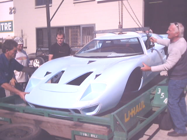

I guess its time to start my build thread which should have started when I took delivery of DRB#68 back in August 2006 but I have just been too busy building rather than spending my time on line.
The first photo is taking delivery Friday Aug 18 2006.

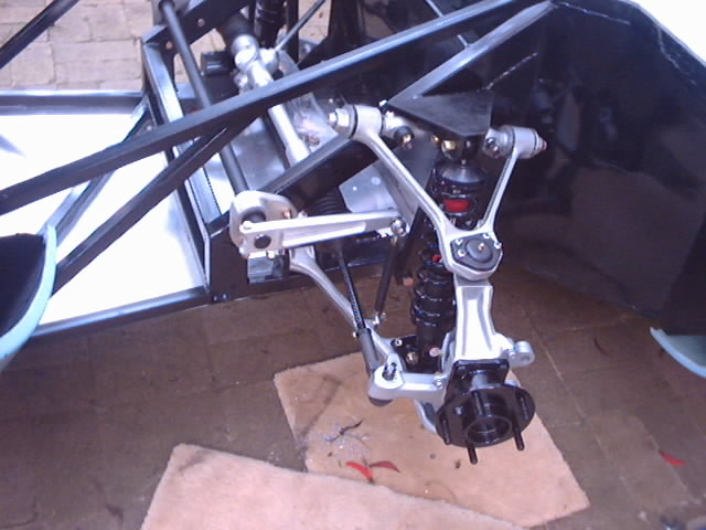

By Sunday both front and rear suspension had been fitted.
Very exciting days.
Dimi

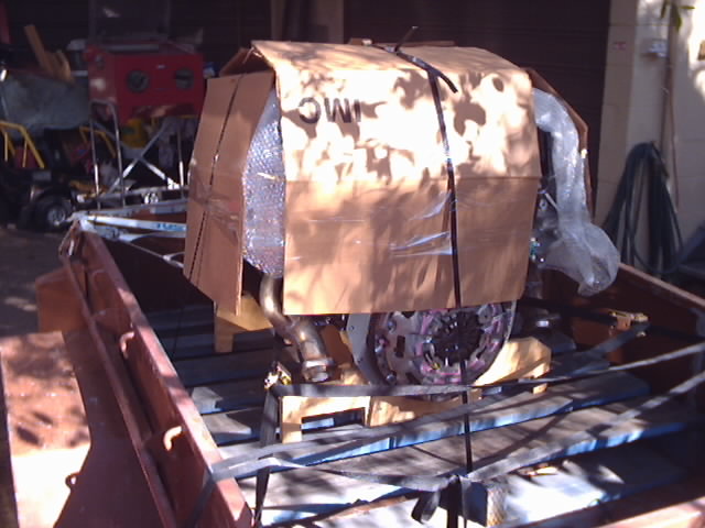

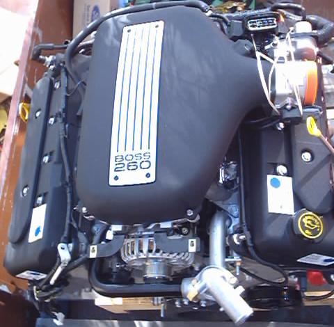

Next big day was taking delivery of a brand new factory fresh 5.4 260 Boss Motor

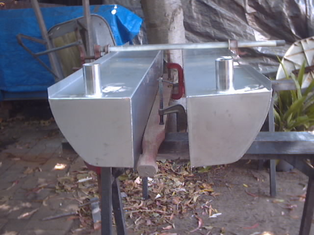

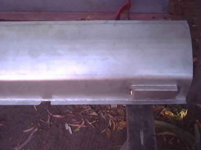

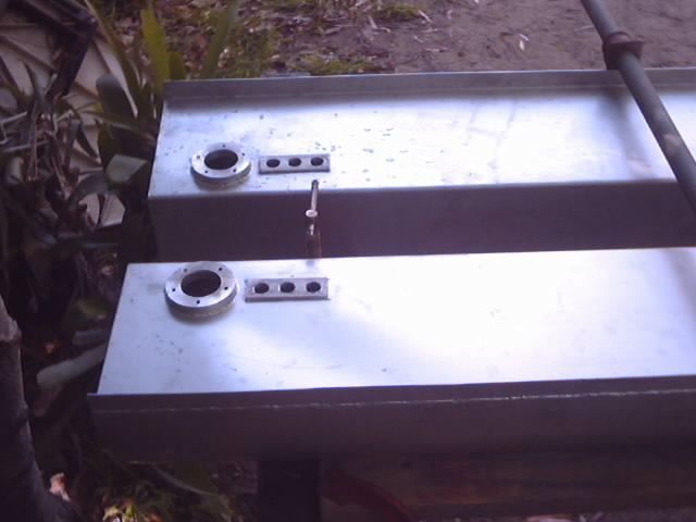

The following photos are of the custom stainless steel fuel tanks I had a friend of mine make for me which have a capacity of 48 litres each.
These tanks will be linked together so the car can be filled from either side but will only require one fuel sender and one set of pumps and are fully baffled and will not be able to surge from left to right and vice versa when cornering

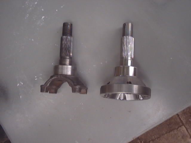

Next photo is of the new billet axle another friend of mine machined up to allow CV joint shafts to be used which will match the G50 tranny to the Corvette hubs without spacers or adaptors.

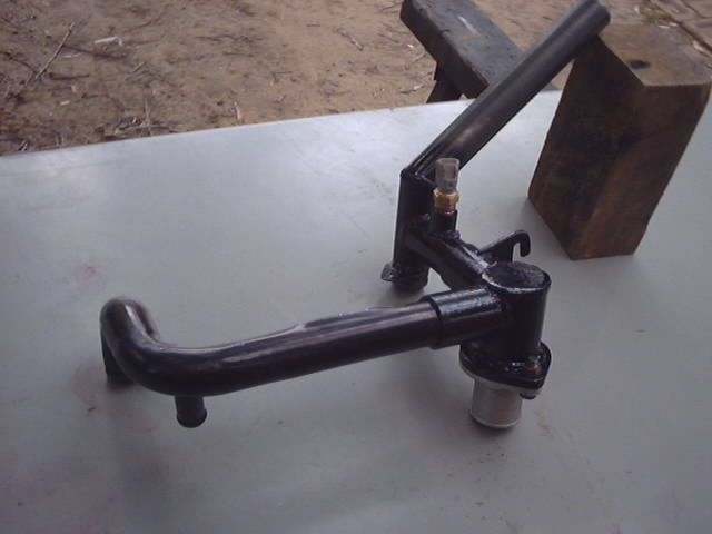

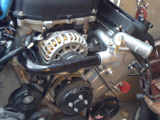

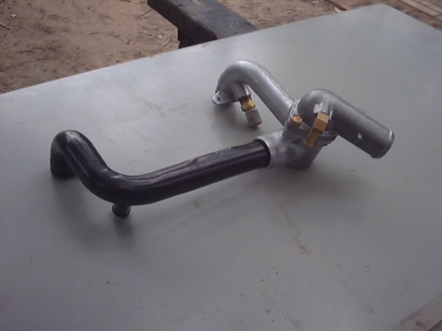

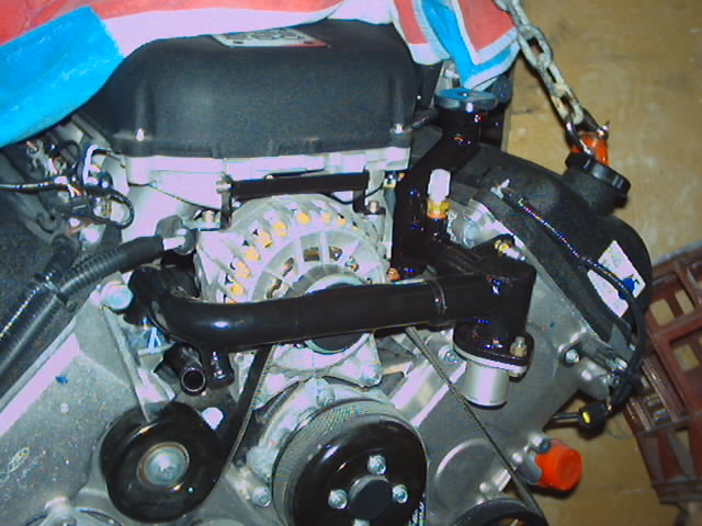

Also I had to make up a new thermostat housing and water outlet from the top of the Boss motor as shown in the attached photos the stock housing exits upwards and to fit in my new one faces downwards.
This also allows the filler for the cooling system to now be on the motor and forms the highest point in the system for bleeding and doubles as an air trap which will vent into a coolant recovery system.

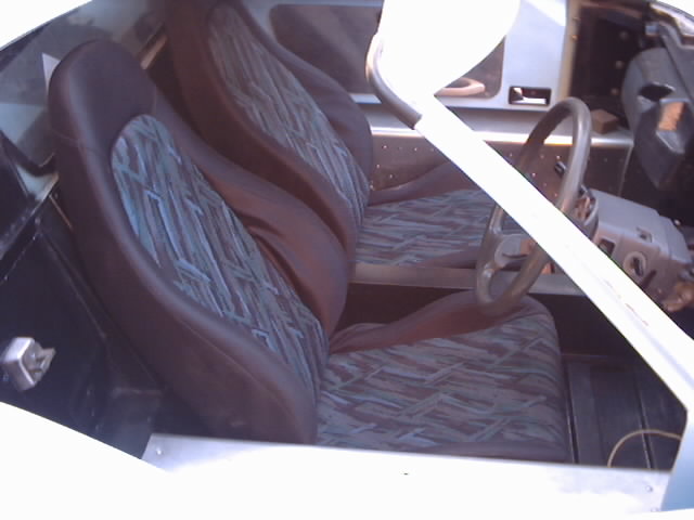

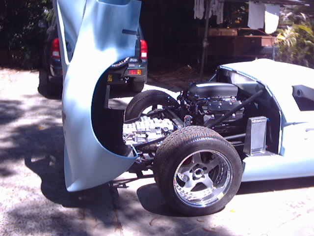

Gearbox and engine fitted
Tranny is a G50 with LSD, taller 4th and 5th gears, rear cover removed and end plate fitted.
Side shifter by CMS and all adaptors,clutch,flywheel mods by Kennedy.
Wheels are Simmons 17x9 fronts and 17x12 rears.

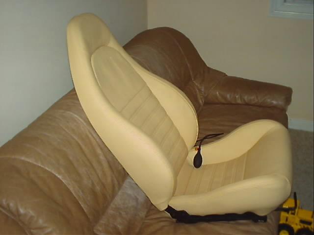

Seats are out of a Mazda MX5 model only available in Japan and are fully reworked in the upholstery to allow lower seating and retain the runners for forward and rear adjustment,backrest adjustment and inflatable lumbar support,fully reupholstered in leather.
seat shape is similar to Porsche seats.

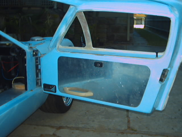

The doors have the Mk3 opening windows fitted.

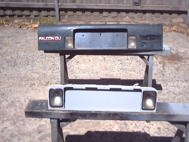

One thing I wanted to have that would look finished and professional was the treatment of the number plate,and associated required lighting.
I saw this ford trim and as it was too big to cut down or fit I made this one up from 3mm ally plate which will house the number plate,reversing lights,and plate lights,and make the rear of the car look like a factory supplied fitting rather than a collection of aftermarket bits.

Dimi,
Must congratulate you on your progress, but have a concern over your coolant line modifications . Are you intending to connect the large upright pipe directly to the header tank. This would be unwise for a couple of reasons; 1. Any coolant added when hot/warm would flow directly into that cyl head. 2. If your header tank is to be the recovery circulation type coolant will take the easy way and not pass thru the radiator along with an imbalance from left to right banks.
How to fix:
Run a small bleed line (3/16" or 1/4" bore) from the 'new' top of your thermostat housing (motor side of t/stat) to the side of your header tank.
Run a 5/8" or 3/4" bore hose from the bottom of the header tank to one of the fittings on the water pump which the heater hose return line would normally attach.
This will allow your coolant to be added and bleed prior to initial start, then even with the motor running to help bleed all air from the system.

I have to apologise but the photo of the thermostat housing is incomplete.
I will post a photo of the completed assembly on the motor which shows the large upright pipe is actually the radiator filler cap which then runs off to an overflow bottle.
Dimi

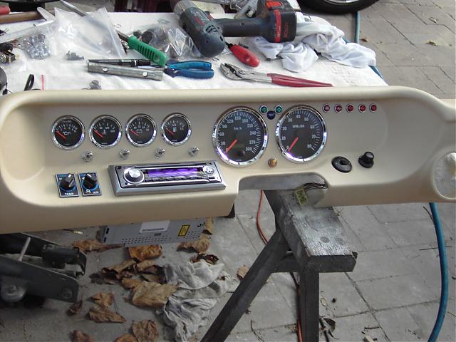

Time to update progress.
Attached photos are of the dash layout, seats in new leather upholstery,

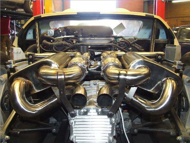

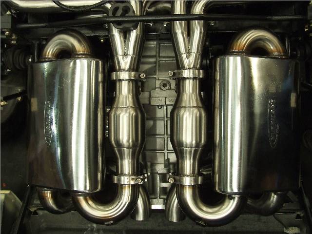

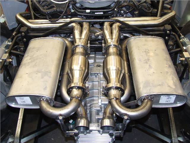

Photos of new stainless exhaust system showing both the sports system and the ''quiet'' one.
Hey Dimi nice build
Hope your knees will clear that stereo hanging down like it is, maybe it's just the angle of the pic making it look like it's hanging down heaps?
Dimi Terleckyj
Hi Dave
Yes I noticed that after I posted the photo but with the dash in the car the stereo can barely be seen and it points toward the front firewall so there is no leg clearance problem.
