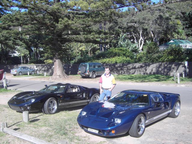

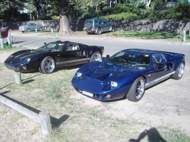

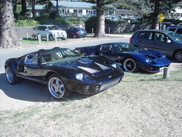

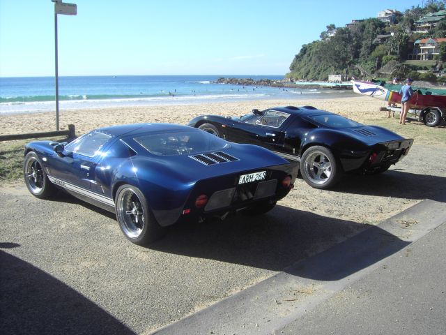

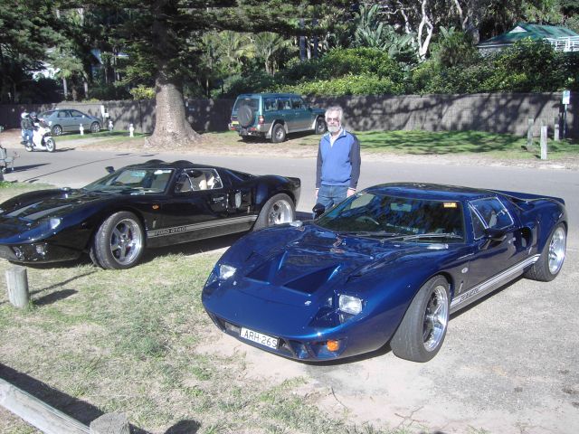

Hi All
Peter Delaney and I decided that as it was such a nice day we would take both our cars for a run up to Palm Beach just north of Sydney.
It was great to see people's reactions to 2 GT40's travelling together.

Ah, I saw Peter go past in the 40 on Kileaton/ Burns Rd on Saturday - heading home no doubt from your run. Did you go through Forestville Dimi?
Cars look sensational as usual
cheers
Stu
G'day Dimi,
This is Stuart, one of (I'm sure) many people who came up and spoke to you at Palm Beach. It was great to meet you and Peter and have a chat. I should say to anyone here in this forum, if you can, to see these cars in person, it's something else!. I could've stood there all day, but I thought it best to leave you 2 alone and get back into my Getz :(
Congrats on your craftsmanship (and Peter too). I certainly appreciate both of you being so approachable... much appreciated!!
See you out on the road....

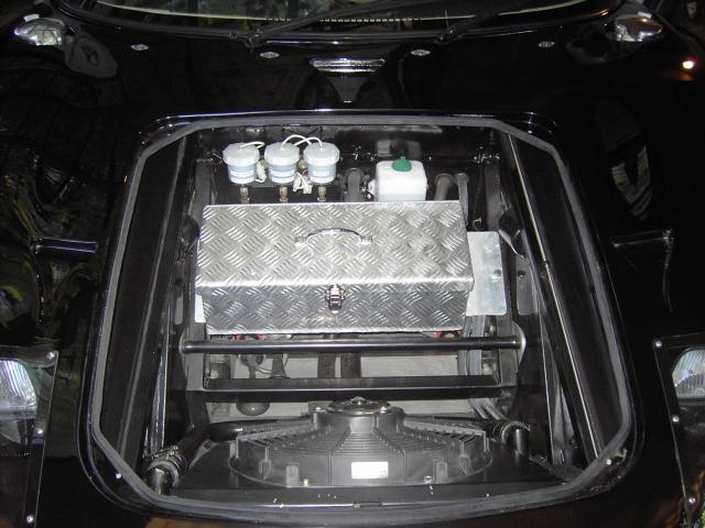

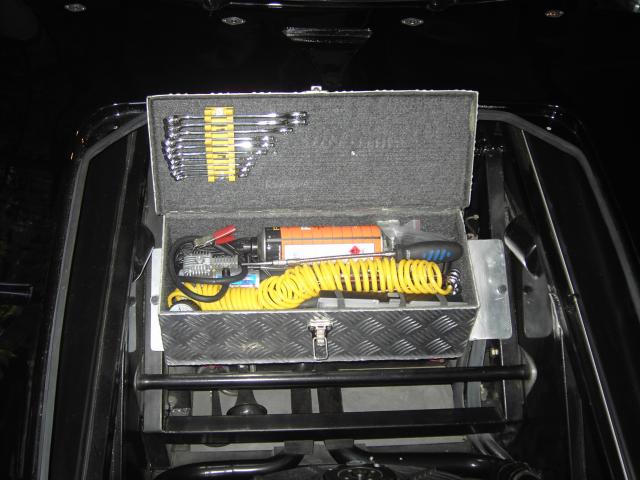

As my 40 is primarily a road car I have during the last few months put up approx 5000 Kms and through this time I have had the nagging thought that if I had a flat tire or some other breakdown that required tools how could I handle it without tools.
As there was no room to carry a spare I found a space that could house a toolbox and built a custom shaped toolbox that could carry a toolkit,jack,mini compressor and air line,tyre sealer, tyre plugging kit, and assorted emergency tools.
Held in place with two bolts it can easily be removed and taken out to the repair location.
This certainly make me feel much more at ease with long distance trips.

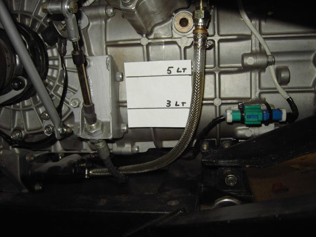

Some how this photo of the oil sight gauge on the side of my transaxle got deleted from my build thread.
Ron
I have reposted this for you.
This shows the level that the various amounts of oil in an inverted G50 sits at.
When the car is being driven the level drops by one litre as the oil is in motion on the gears and being thrown around the internals.
Dimi
