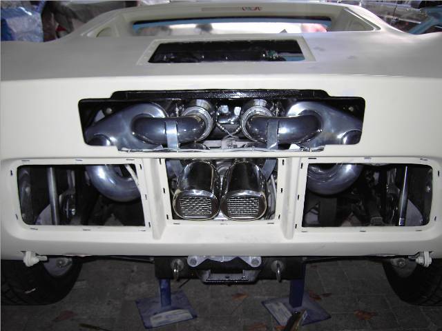

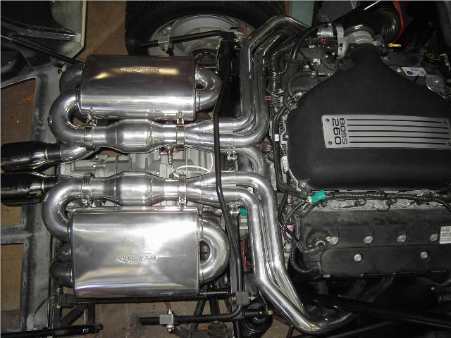

Hi Dimi,
That is a VERY nice exhaust setup (even the "quiet one" looks great). I hope you won't be too upset if you see something like that on my car in a year or so !!
BTW, did you set up a side shift for the g'box ? (the end-plate looks cool & custom, but no shift rod) ?
Kind Regards,
Peter D.
Dimi Terleckyj
Hi Peter
The photos of the exhaust system were taken while it was still being put together.
The system is full stainless and has been ceramic coated and I will post some more photos when I refit it back in the car.
The quiet mufflers are mild steel and are only intended for the obvious short term requirement.
Yes I have fitted a side shifter from CMS and Renegade provided the end plate along with a host of mods to the tranny.
Dimi

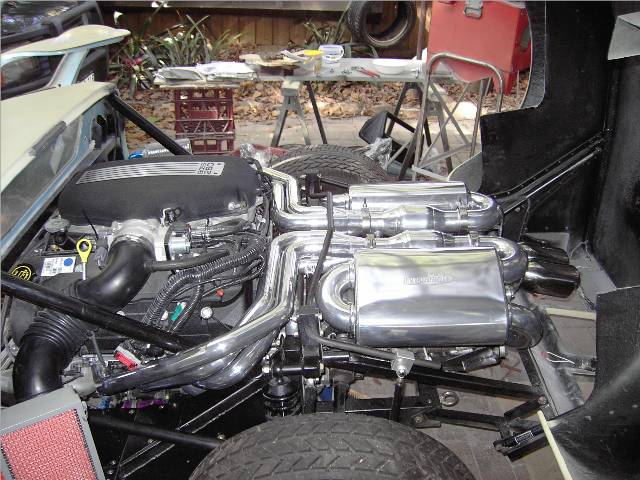

Dimi Terleckyj

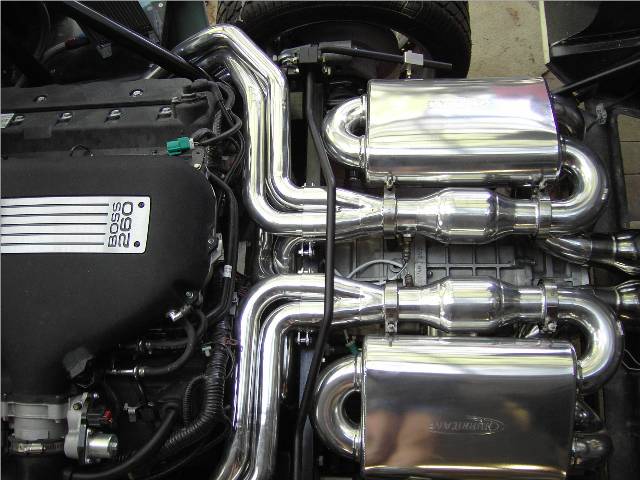

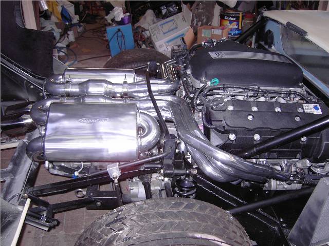

Exhaust system has come back from the ceramic coaters and has now been fitted into the car for the last and final time.

Peter Delaney
Dimi, that has got to be the neatest exhaust setup - particularly when you consider how much less space you have to play with than us old-timers with small blocks !!
By the sound of things, it seems like you have got hold of someone who knows a bit about G50's (CMS & Renegade) - any chance of publishing some info on these "rare birds" ?

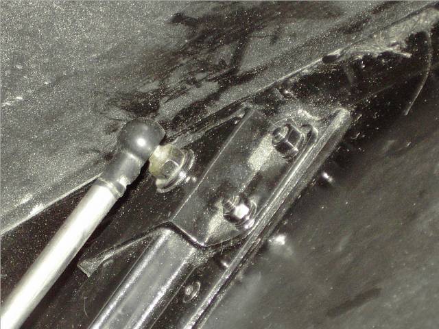

It also looks like you have some very neat & small gas struts to hold the rear clip open - again, any chance of further info on these ??
If you think that you are on a roll now, just wait till you get her on the road !!
Beautiful work !

Dimi, that exhaust is stunning. Is there any worry with all that hot exhaust (when you've got your right foot firmly down) above the transaxle and heating it up?
Cheers and keep up this great build,
Dalton
Dimi Terleckyj
Hi Dalton
Yes there would be a concern but as yet the heatshields have not been put in place as they would make access difficult for any further work that may need to be done.
The heatshields will be fitted as the last thing when all else is done.
Dimi

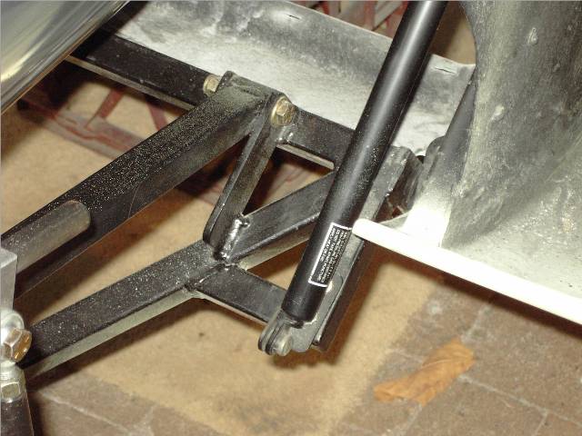

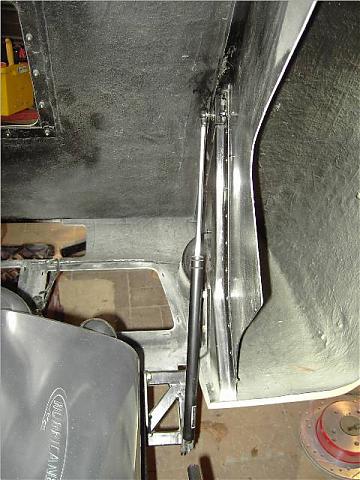

Dimi Terleckyj
Hi Bill
Here are the photos of the rear gas struts and the mounting points you asked for.
I dont know specific details about them other than they came of a Maxda 626 rear hatch.
They have the strength to hold the rear clip at various positions and make the opening of the rear clip a one finger lift.
The ones I will be using for the front clip are from a Ford Laser rear hatch.
I had to add some square tube to the rear corners of the rear clip support frame to provide the lower mount for the struts. (see photo)
And fabricate the upper mount as shown with a reinforcing plate in the wheel arch side.
Dimi

Dimi, I'm very impressed. Details such as those gas struts are making this a very professional product as a USABLE car. If you want lightness and simplicity to race, which was the original purpose of the 40, fine, but if you want to adapt it as a superb sports car for possible daily use, details like this make all the difference. A very professional build. I can't wait to see the finished product and get your driving impressions.
Dalton

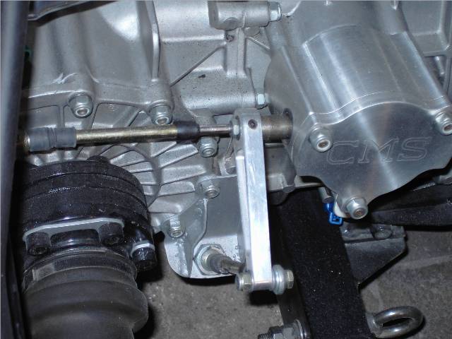

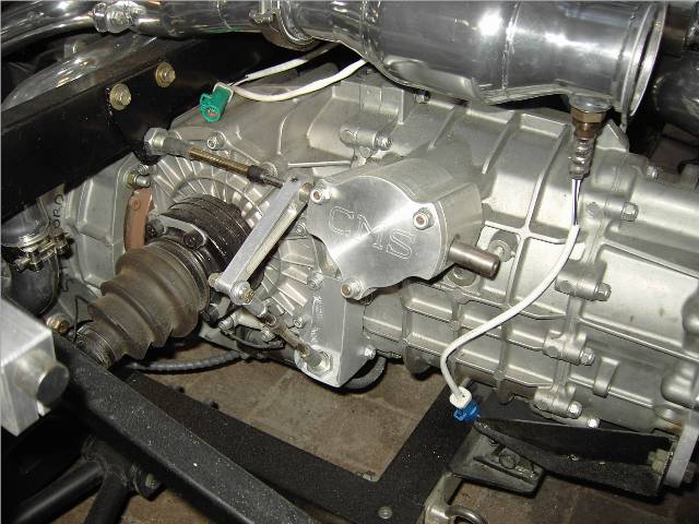

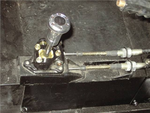

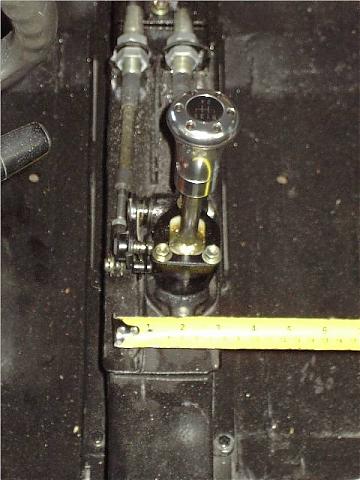

Dimi Terleckyj

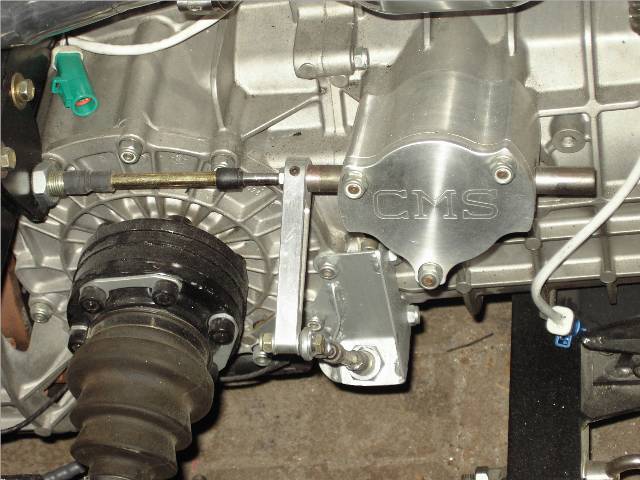

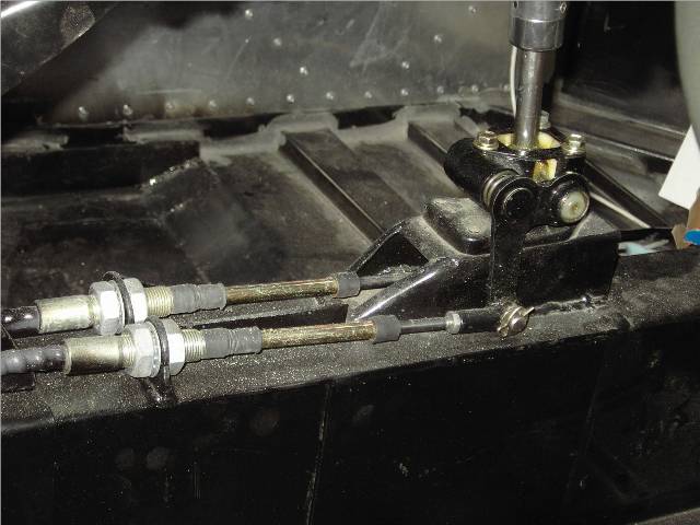

Hi Lynn
As requested I am posting the photos of the Toyota remote shifter and the CMS side shifter as set up in my car.
Hope this will help you
Dimi

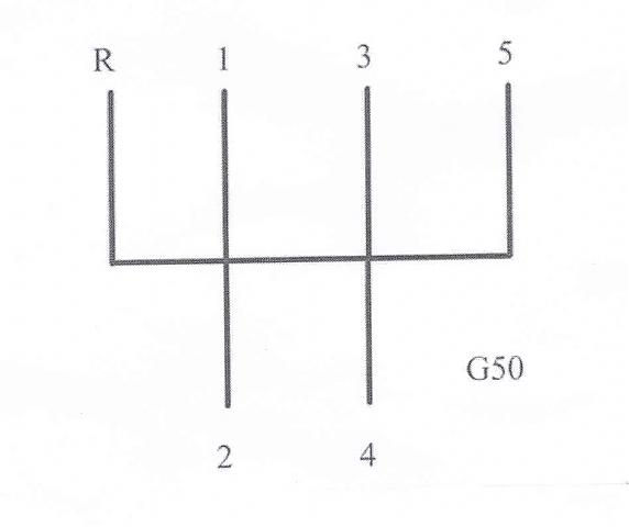

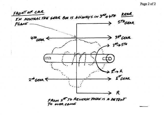

Dimi,
Great shots of the shifter and its parts. Are you aware of which Porsche transaxels can be adapted to use the side shift? I sent an email to Bobby Hart last night, and should talk to him today or tomorrow some time to get the scoop on all the details. I will post my findings. The side shift really cleans up the rear end nicely. Do you know off hand if the imput shaft is 1/2"? Also, can you give the actions it goes through to select each gear? I would assume the shaft on the oposite side is just an extension of the front one, or is it the rear one???? Has the rear cover been replaced? Thanks for such great shots.I find it interesting how one question leads to five more!!!
Dimi Terleckyj
The attached drawings detail the shift pattern and the way the side shifter interprets gear changes.
If you go to page 2 of my build you will see the rear plate of the tranny which was supplied by Renegade Hybrids in the US which closes up the tranny and makes the rear clean and neat.
Dimi
