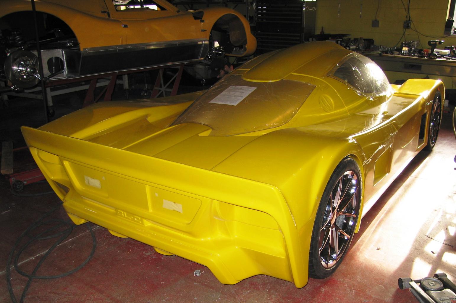

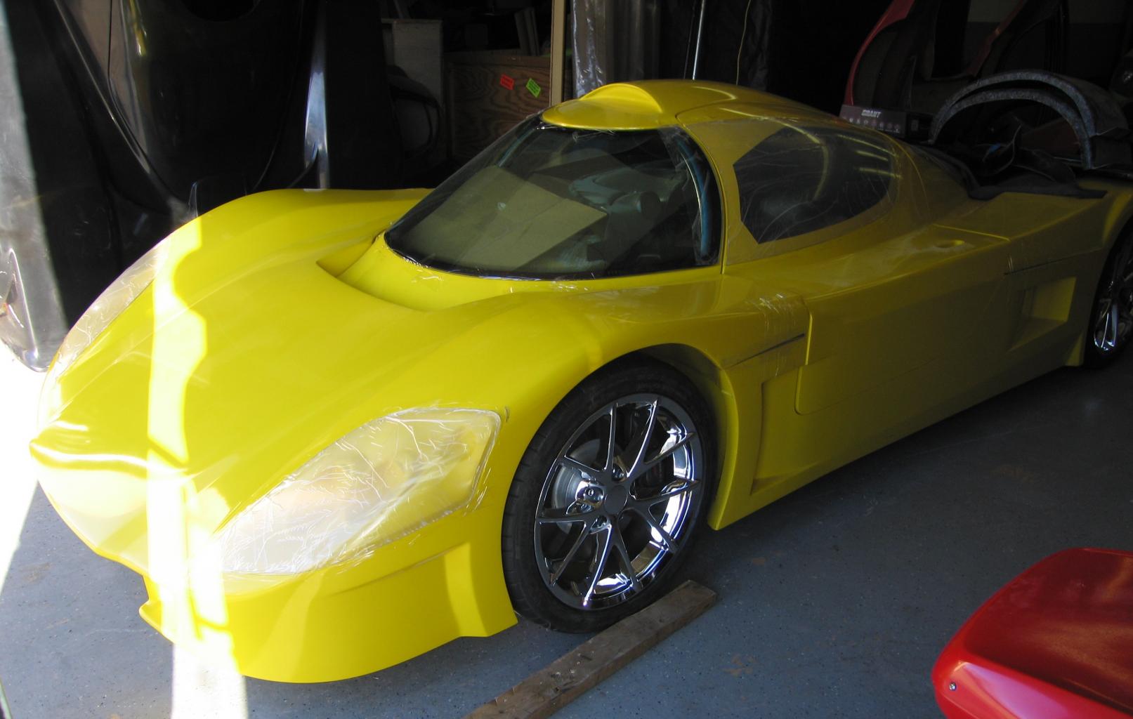

My SLC is ready to ship! I was at RCR last week to take a look.
Check out the PICs.
The next challenge is to get it shipped. I've contacted several transporters, but I'm competing both the January Scottsdale Barrett Jackson Auction and the January Kissimmee Mecum Auction for a truck.

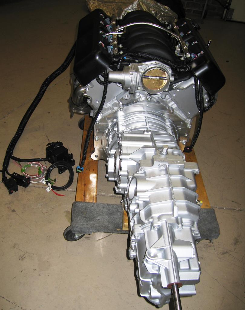

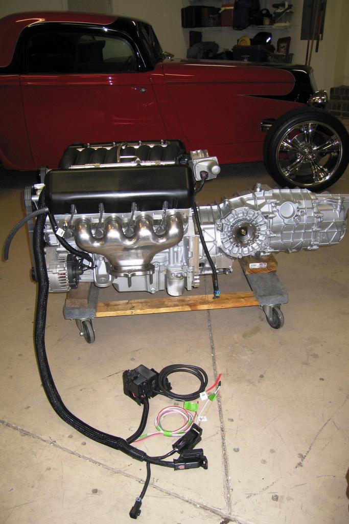

Powertrain is done!
I completed the powertrain tonight! Just add 12V and fuel to make some noise.
  • The G50 transaxle is attached with the help of the RCR adapter plate, Kennedy Engeneering pressure plate, clutch, flywheel and starter. Note that the treaded holes in the RCR adapter plate for the G50 studs turned out to be SAE 3/8 x 16.
  • The electrical harness is complete. There is a single trunk exiting the engine on the front driver's side. The OBDII connector is hidden under the driver side coil cover.
  • The EFI rail was flipped to exit on the drivers side and then the fuel line exits out the front of the coil cover.

The G50 transaxle is attached with the help of the RCR adapter plate, Kennedy Engineering pressure plate, clutch, flywheel and starter. Note that the threaded holes in the RCR adapter plate for the G50 studs turned out to be SAE 3/8 x 16.
Bill, I added some notes to the SLC build manual (word doc) from your prior post regarding thread size. So, 3/8 X 16 was the outcome.... anyone know if RCR used different threads at different times for different applications. I'm a records hound - I like to keep and maintain technical notes on this kind of stuff - so when needed in the future I can find info in minutes.
BTW: very tidy looking set-up

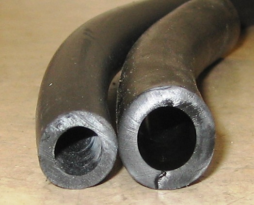

Each winter, I do a top to bottom inspection of my Hot Rod looking for loose fitting, wire/cable wear spots, leaks, etc. That ensures trouble free cruising when the weather warms up. As usual, I found a few minor preventative things to teak/fix. However, I did find something that is a good reminder for all of us to use the correct type of hose for each application.
In the PIC below, both hoses came from the same stock. The one on the left is unused while the right hose was installed on the PCV vacuum line for a couple years. The little bit of oil in the PCV line was absorbed by the hose and that caused it to expand significantly. Hmmm, do think this could be the cause of my vacuum leak:idea:
There really is a difference between hoses intended for:
  • ATF vs motor oil
  • high pressure EFI lines vs those for carburetors
  • Coolant hose vs fuel filler hose

I was just searching silicone vacuum hoses after another post elsewhere regarding watching this issue - timely.
