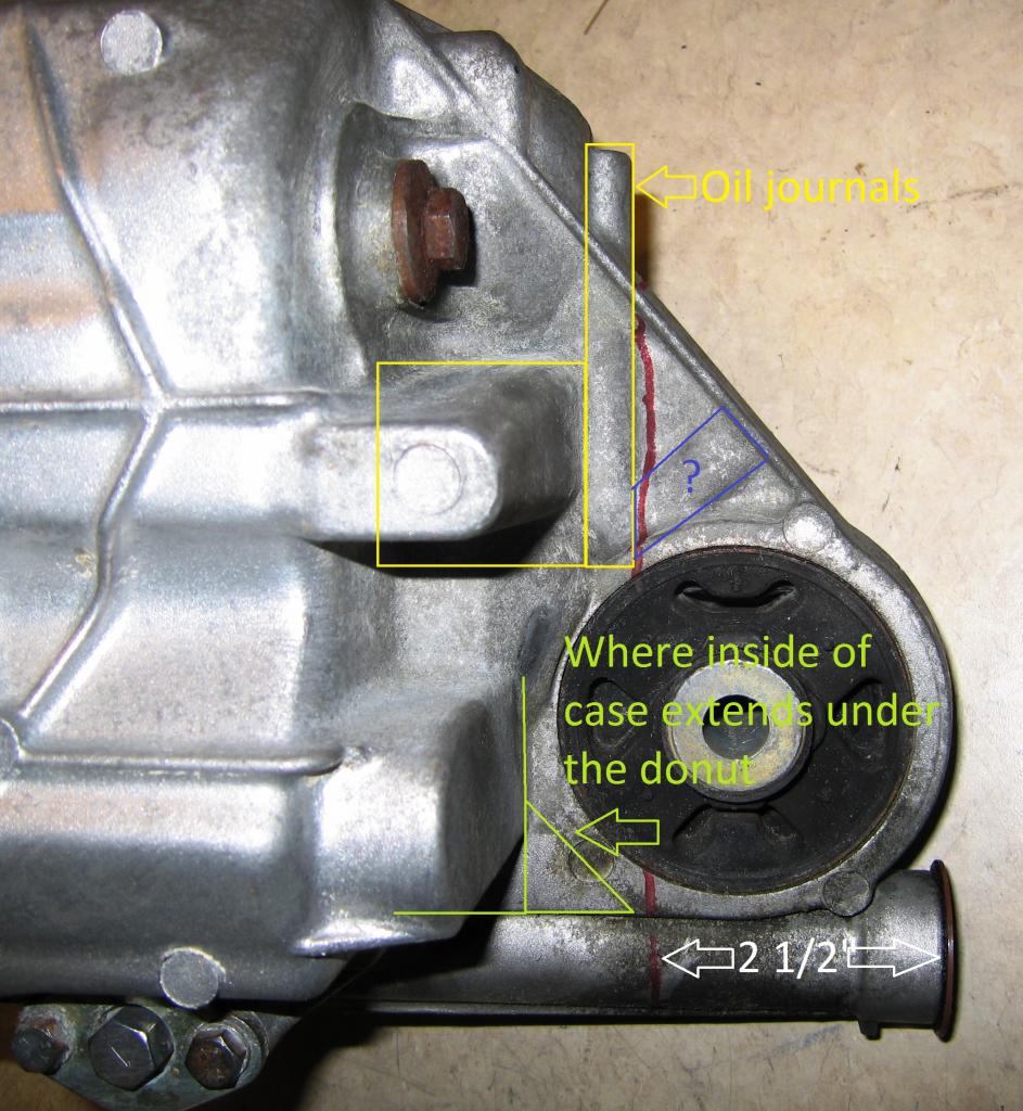

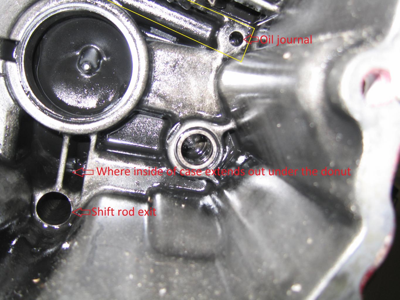

G50 Tail case Surgery
I'm getting ready to shorten my G50 Tail case.
I've plotting a cut line (red) to remove as much as possible, without cutting into something important. It looks like I can cut 2 1/2" of the end without punching into oil journals or the inside of the case.
2 questions:
  1. Is 2 1/2" enough so it will fit in the SLC?
  2. What is the blue area in the PIC below? I think its just a support, and hope it doesn't open up the oil journal
Does anyone have a PIC of their shortened case?

Howard Jones
Bill do yourself a favor and wait until you have the car in hand before you cut off the end of the gearbox. You may want to use the donut as a mount........or not. It would be hard to put back on. You may also find that the grbx will fit fine with it on. You won't know until you have the car.
Waiting until you can measure things will save you a lot of money and give you more time to think.
The end plate or side shift options that CA Motorsports offer look like nice options and would clean the back up nicely as different option also. This way you would not have to worry about cutting the mount off.
Yup, its a G50/20. Its stamped on the case. Its a 6 speed transaxle from a 1995-98 993 Carrera 2.
I have the same exact trans. I was told it was also a LSD. If you figure out just where to drill the holes for the oil cooler in and out let me know. I still have not ordered the flywheel or clutch yet. Soon.
I concur.
Aren't you expecting delivery this month?:)
Howard,
Too late, I already cut the donut off the case. I went the weld-less approach and shortened it about 2 1/4" -2 1/2" . That's as far as you can go with a G50/20 (6 speed) without cutting into the oil passages and other internals.
Bigfoot, Ben & Eglitom,
Thanks for the PICs. They were very helpful.
The case is currently at a local machine shop getting a 2 step bore for the linear bearing and seal. I'll have PICs soon.

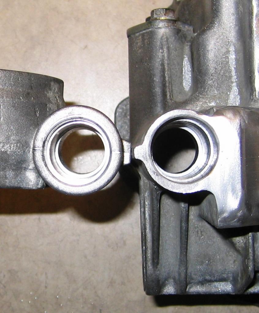

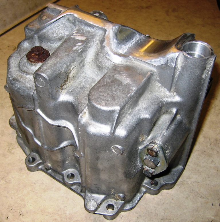

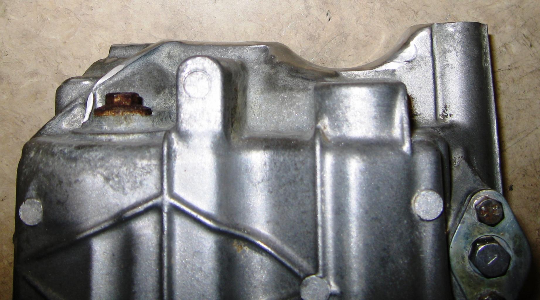

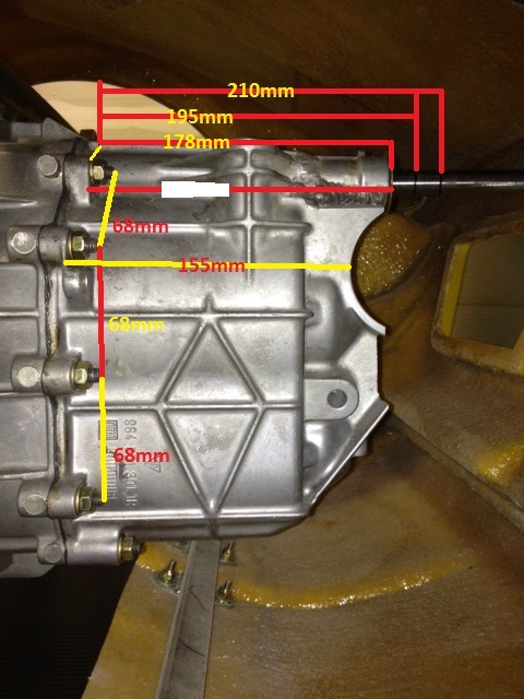

I finished shortening my G50/20 6 Speed.
After I cut the case, I took it to a local machine shop to get a 2 step bore for the linear bearing and seal.
The seal has a “Press” fit that exerts a fair amount of pressure on the surrounding aluminum when pressed into place. After the cut, the aluminum case that surrounds the seal is a bit thinner than the original. To reduce the stress on the thinner aluminum, increase the seal’s bore .001” - .002” (I.E from .949” to .950” of .0951”). This provides a “Bump” fit which means the seal fits snuggly, but does not require a press or hammer to insert it. The linear bearing should remain a Press fit.
The end result is a nearly square cut with the end of the case. The final length of the shortened case is 7 ¼”. I finished it off by grinding down the cut lines for a more OEM look.
I struggled trying to find information on how to shorten the the G50 tail case. So I trolled this forum and other forums/blogs to understand exactly what to do. My apprehension was compounded by the anxiety of cutting into a transaxle that cost more than a used Corolla. Here is a 16 page document below with the information I collected on shortening 5 speed and 6 speed transaxles. I hope you fine these instructions helpful -> https://docs.google.com/open?id=0B2mA517zVglRTHlDZ2c5NUFNb0U
